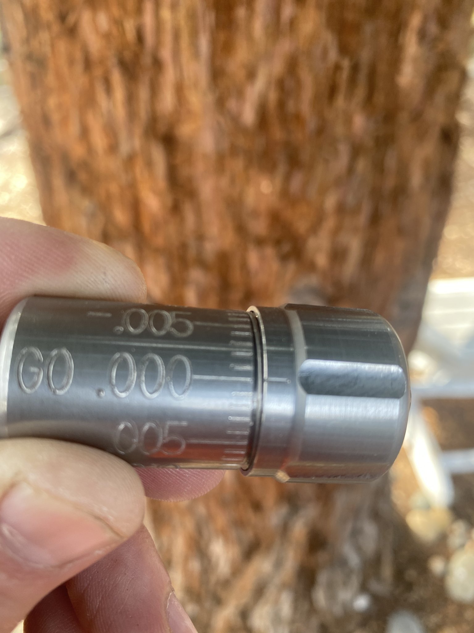

These caliber specific Whidden gauges are the best bump gauge ever! Multipurpose and more consistent than you tool I’ve used- worth every penny.

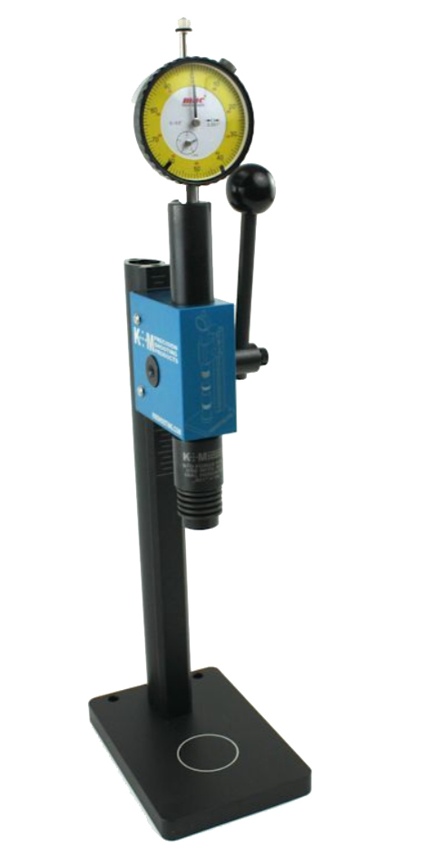

For clarity, it is the same as you are doing with a mandil die. I have a bunch of 21st-century Ti-coated expander mandrels as well. The reason the expanders are available in .001 is NOT so you can change them all the time, but rather so you can choose the amount of expansion; set it and leave it regardless of brass. Remember the custom expander passes into the fired case without touching anything, FL sizing is completed and after the die-body is lifted away from the neck, the custom expander then contacts and uniforms the inside of the neck.
Probably the best source for some is these tools is 21st century or K&M.. Here is a link if someone is interested. http://www.xxicsi.com/products-1.html
The only things a separate expander mandrel and die process does that is better than a FL/B/with custom expander is give the user freedom to use on new brass with the benefit of getting a feel for the variation in setting, before seating a bullet, as that is exactly what you're doing anyway.
