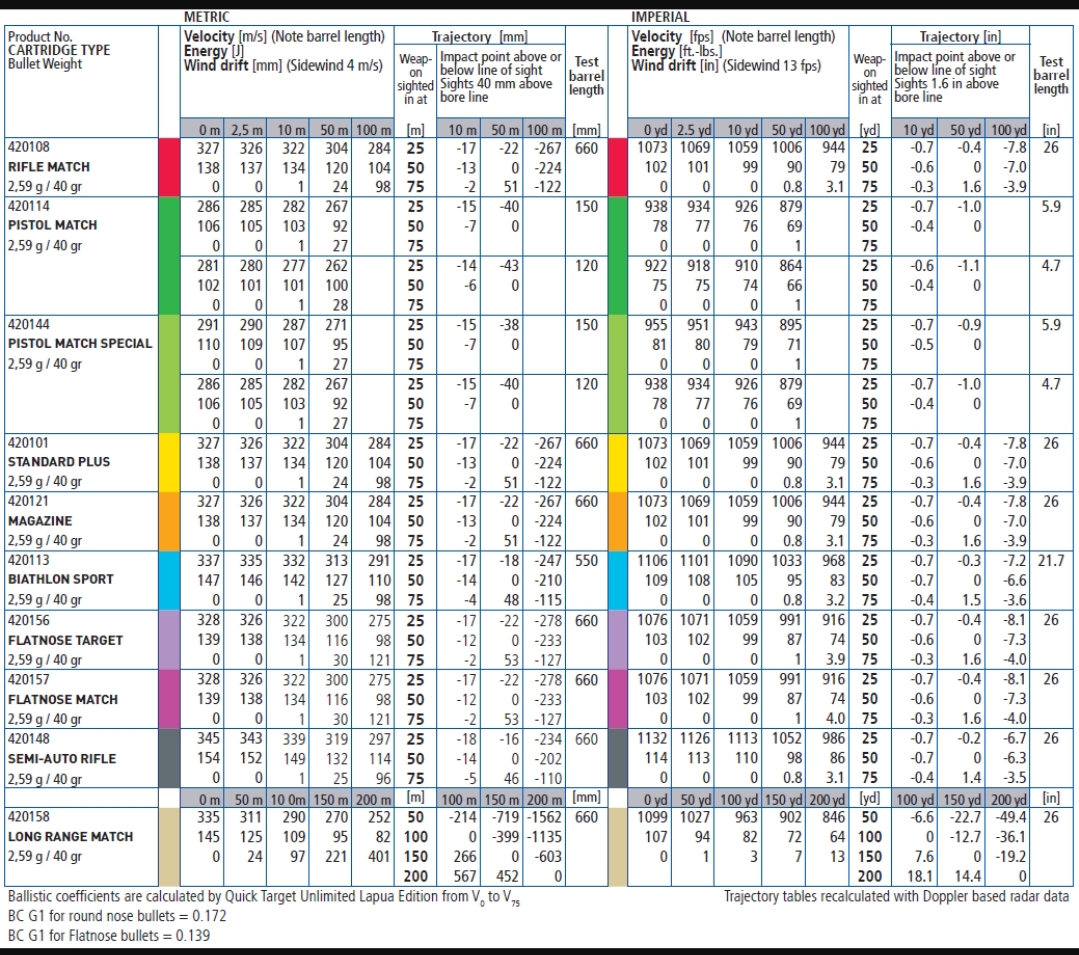

As others mentioned, BC is based on velocity... at 50 yards, the BC of say SK/Lapua is published at .172. By 300 yards, the BC is down to .11 due to the velocity being a lot slower.
Generally if you're not doing a custom curve (varying BC per velocity) then .135 usually gets you to around 200 pretty well.

SK states that bullet is rated at .130
I believe its written on here somewhere...
I would start there and your solid MV. You can edit the b.c. then if needed.

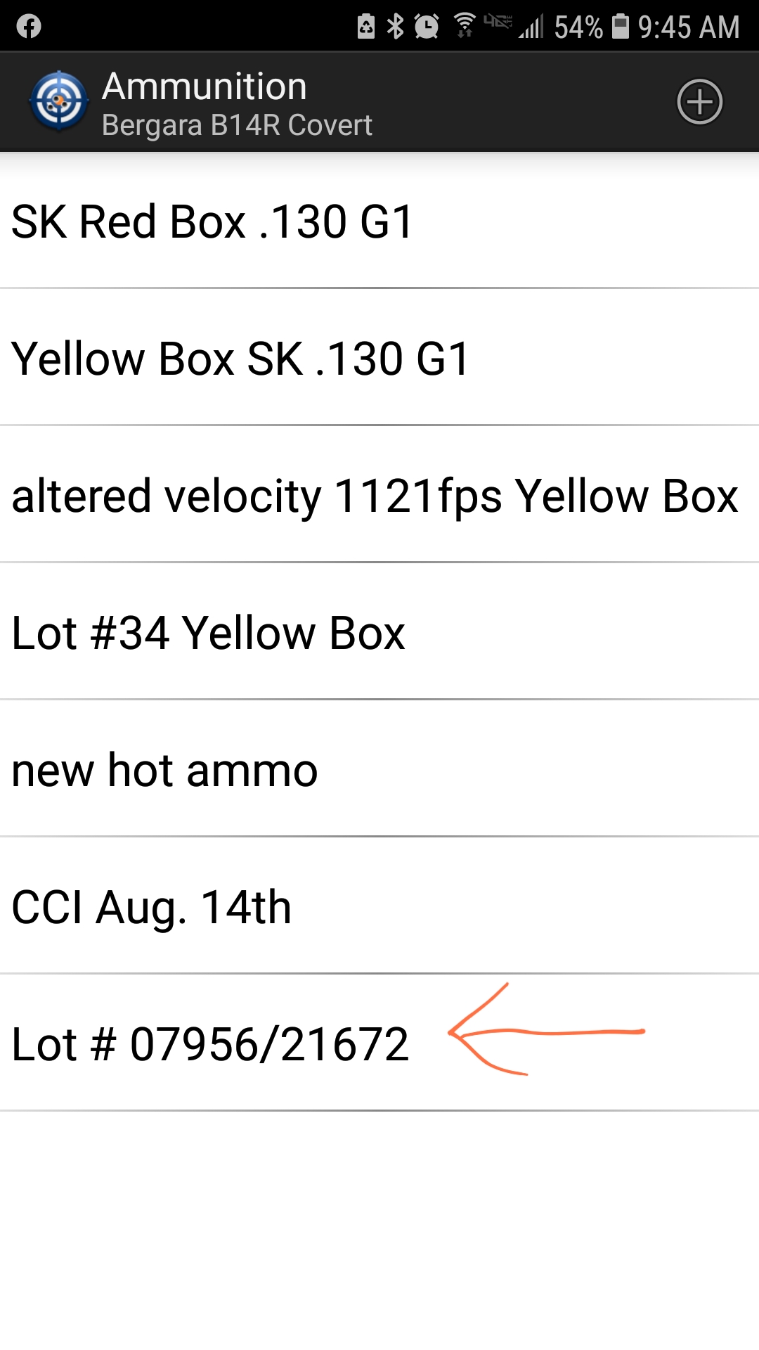

My new plan going forward is simply make a new bullet profile every time I buy new lot/brick and simply label it that lot #. I find it easier to track than going back 9 months when I spent two weeks running some oddball round for whatever reason then having 9 profiles stacking up. And you never know when you might fall into a prior lot.
