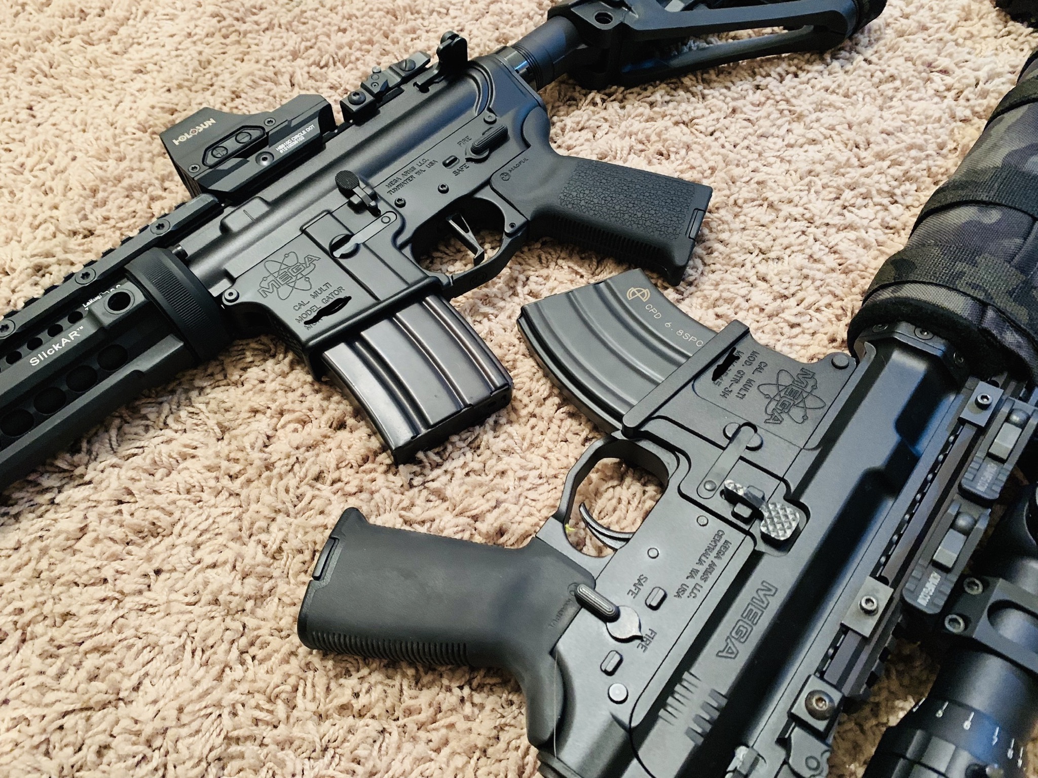

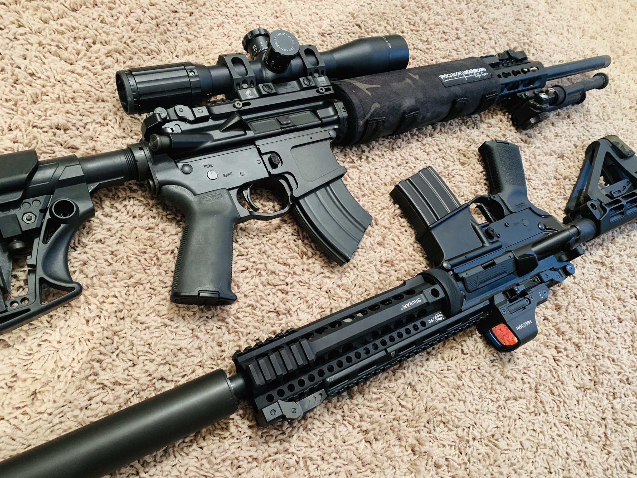

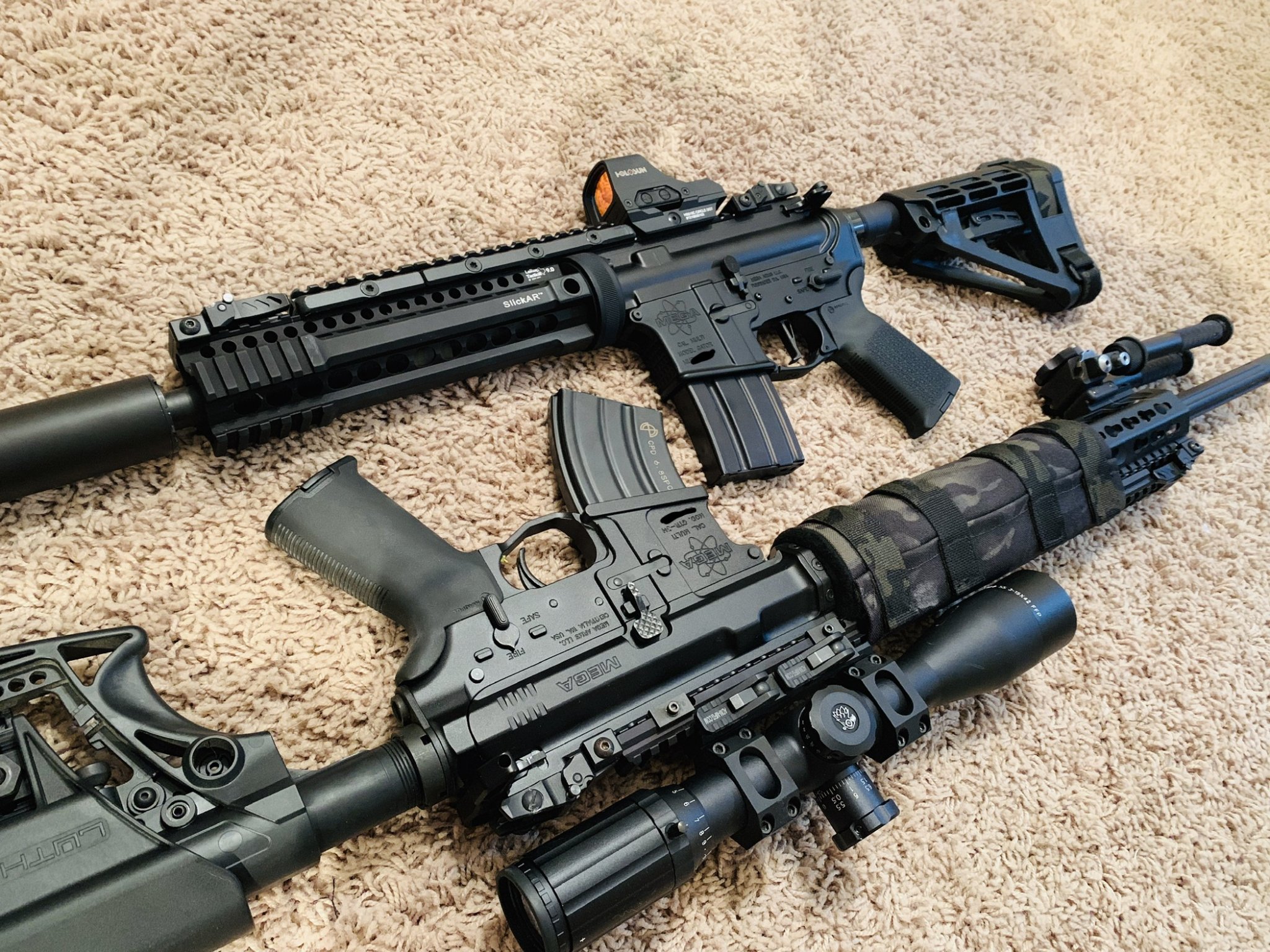

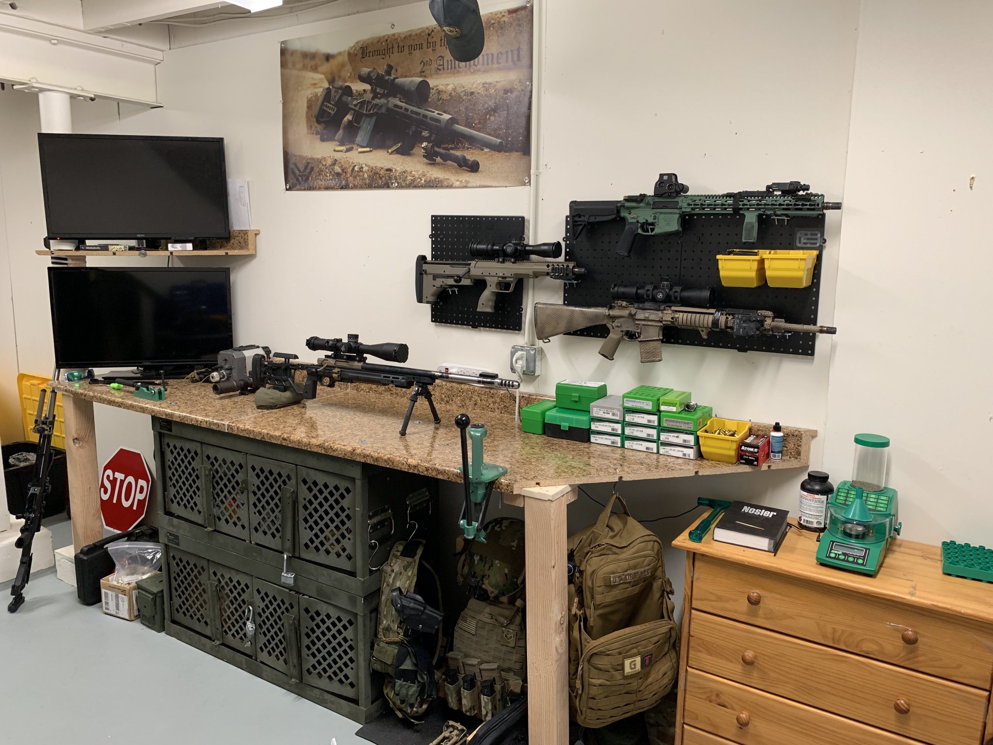

How many AR's do you have? Get some photos up.
Just a Valkyrie and the blackout. I do love gas guns though. I started precision shooting on one and for some reason I find it really fun to stack bullets on top of each other without running a bolt. Maybe I need to build more......?
I just built the pistol and had to pay top dollar for the impossible to find mega lower....because ARs that live in the same house need to match. I have a 6” Form 1 for the pistol submitted so the 8” can go back to the Valkyrie. Hopefully it comes back as fast as my other form 1 did.

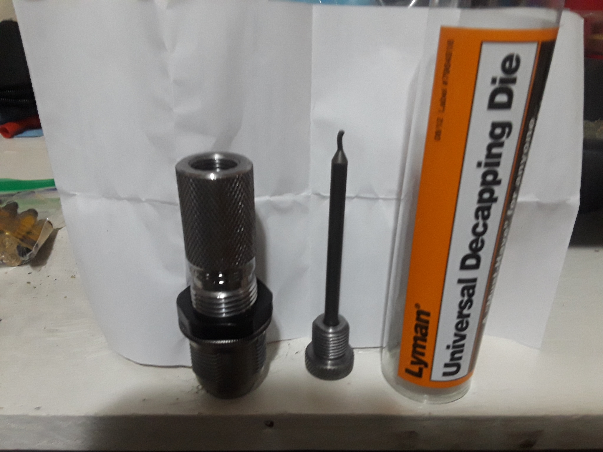

Well grandson proof Lyman isn't.
Has caused a delay as I don't want to change the process.
Afraid will change neck tensions with my hand polished expanders working dirty necks. I like to decap then tumble.
So new universal decapper and hornady swage removal die.
500+ rounds decapped and shoulder got a kink so not much time with the new die.
I think will be easier to set on clean brass.

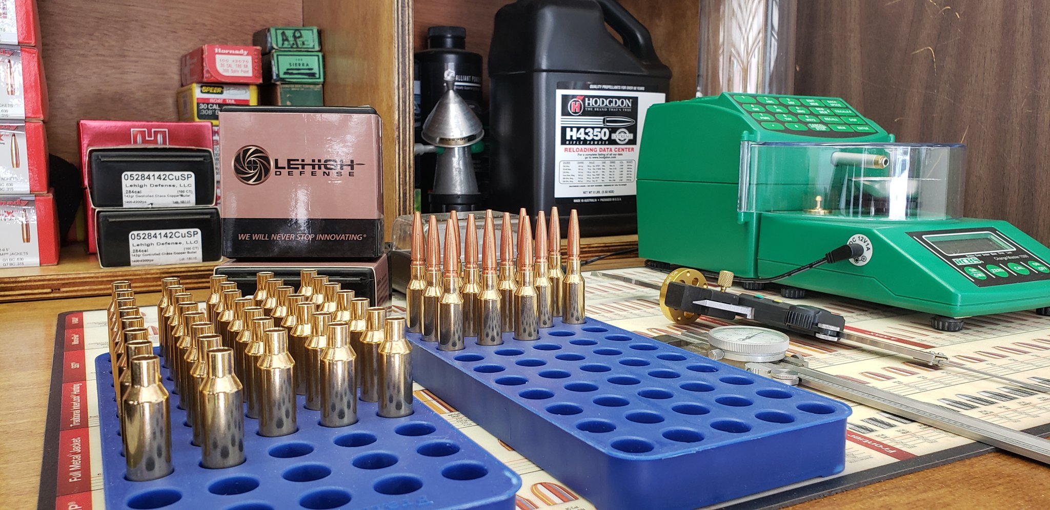

I have a lot of experience with H4350 and INR4451(because at the time H4350 was impossible to find) and both have treated me well but I had yet to try R16.
I bought a pound locally and shot a quick ladder test on Thursday.
The entire ladder test had excellent accuracy and SD’s but one load stood out with same POI as the loads on either side of it as well as an acceptable accuracy and speed(actually faster than my current load) and amazing SD’s.
I tested that load and another that looked promising out to a bit past 1100 and it did fantastically well.
Vertical was excellent and Accuracy was as well with a 20 FPS boost using .7 grains less powder per shot.
I was able to get the accuracy and SD with H4350 but not the speed.
With 4451 accuracy and speed were easy and SD is acceptable and really I don’t have major issues with vertical with that load but the R16 load definitely seemed better in the vertical department.

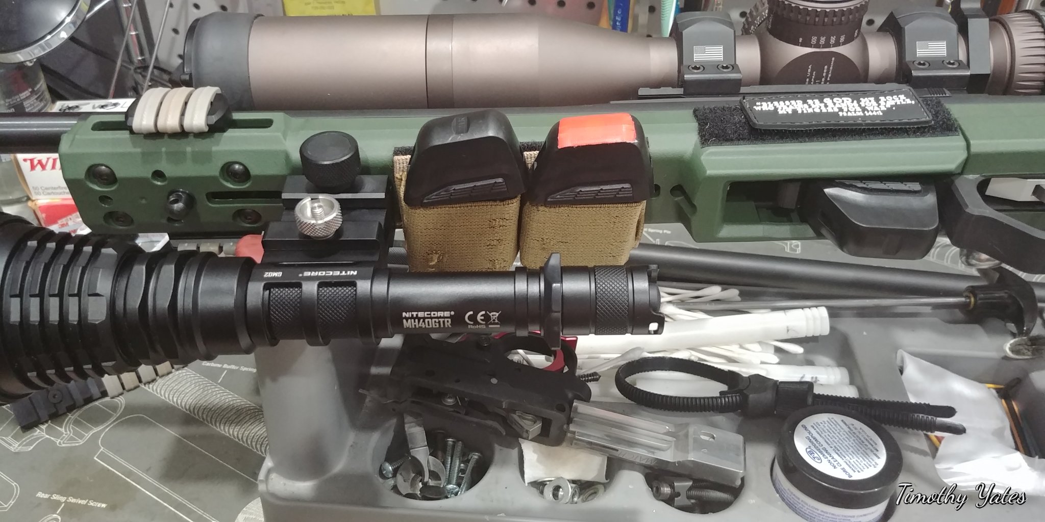

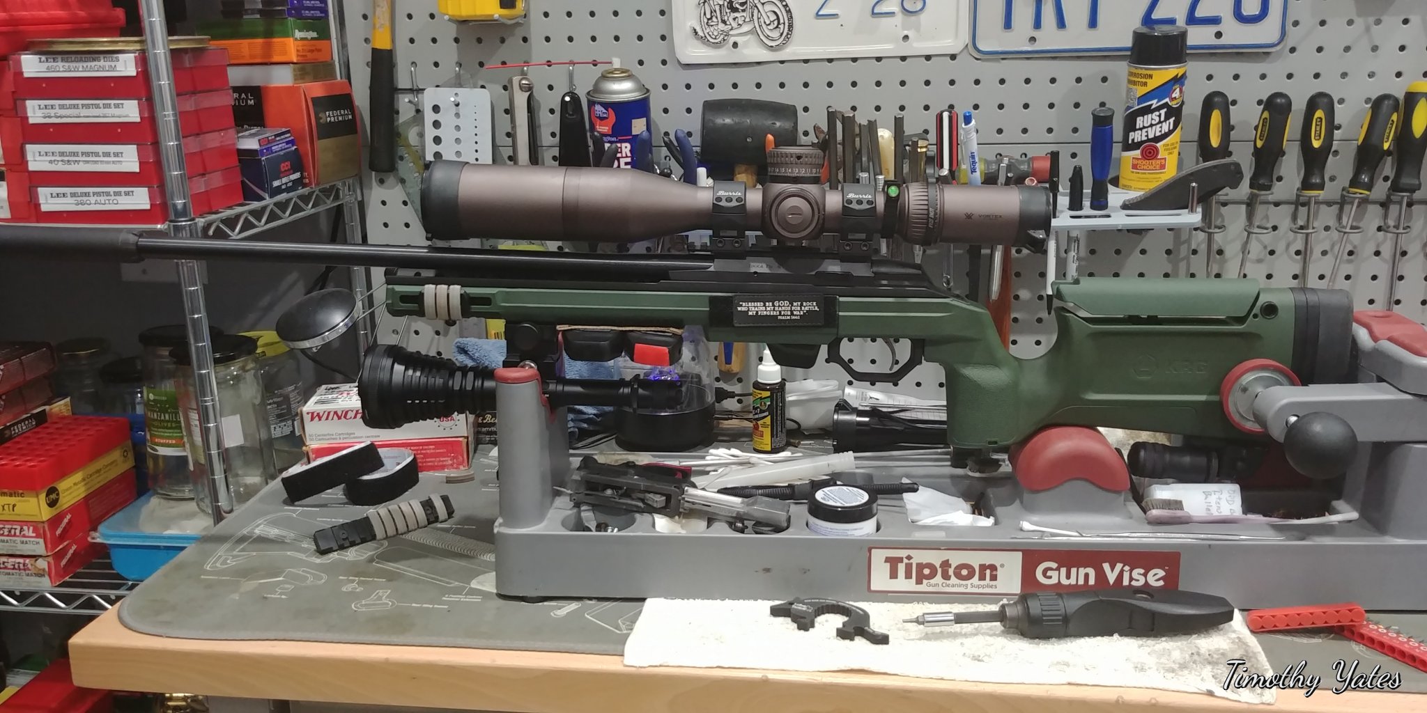

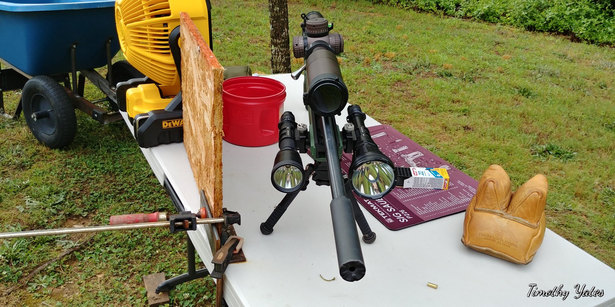

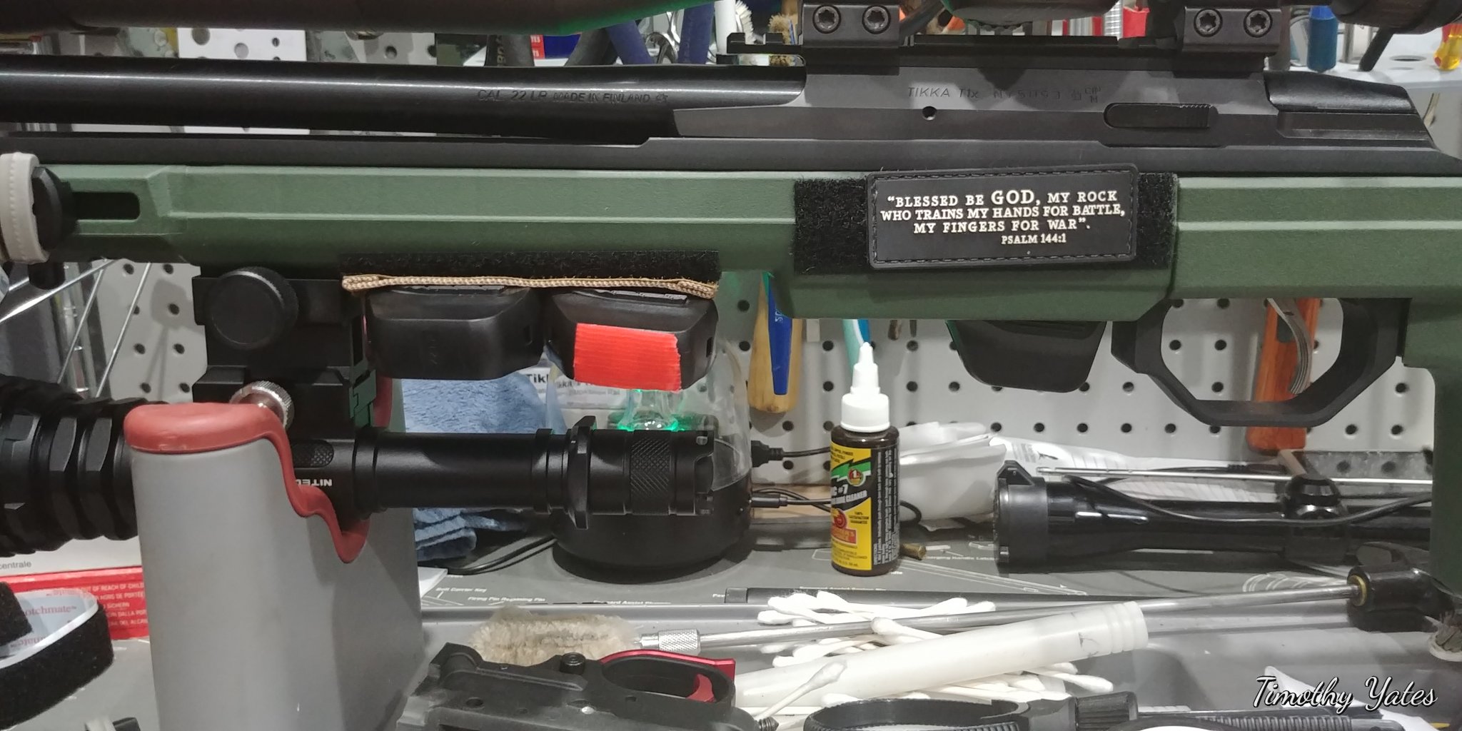

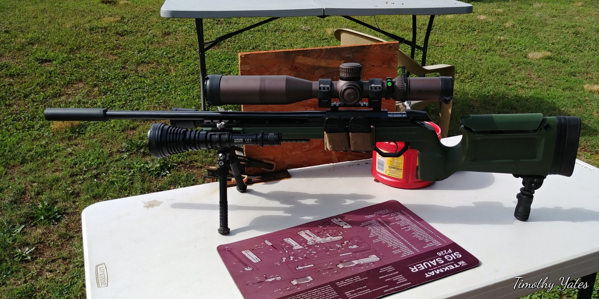

I worked on the new Night Stalker today or maybe reworked is a better description. I wasn't happy with the flashlight location and didn't need two. All the smaller one did was get me a little wider throw. The mag holder location was kind of in the way of my hand for carrying. I relocated the mag holder to a more suitable location and moved the flashlight underneath the rifle for better balance and a much more streamline look. I got the spigot mount from KRG coming to mount the bipod. Relocating the bipod should increase stability by lowering the center of gravity and extending the bipod further out. The flashlight will hang low enough so the beam is not shadowed by the bipod. Here is the old look.
Here is the beginning of the new look.

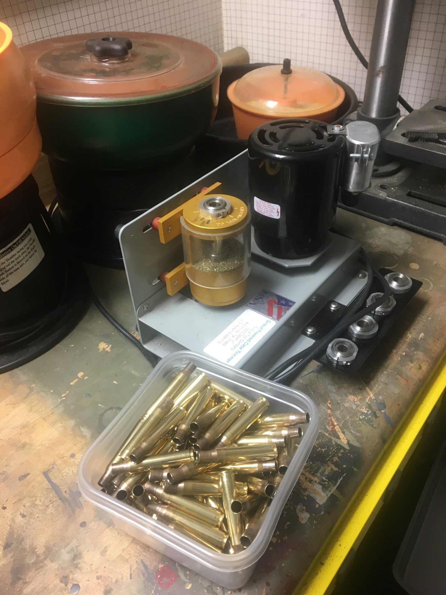

Last minute match prep.... Load confirmation at distance yesterday evening, new Dasher load is hammering. Tumbled the brass and annealed 400 cases last night, sizing, tumbling and trimming those later today, then need to load 300 rounds by Thurs night. Catch a plane Friday morning for CO NRL.

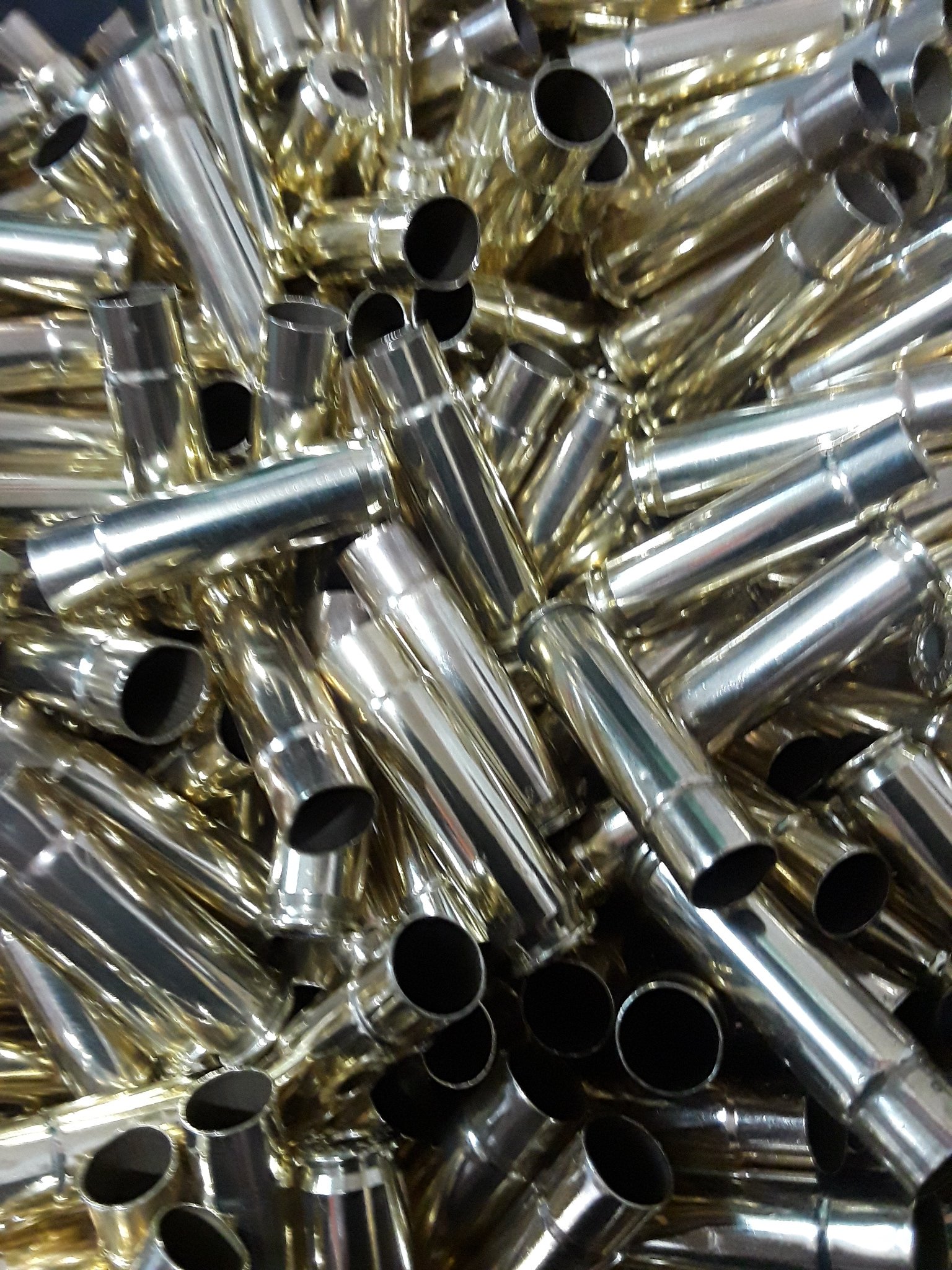

I was only able to size/deprime and then tumble off the lube on 150 .223 cases... once i swage the pockets, trim, and chamfer(hopefully tomorrow)they will be run through the lnl ap and get 24gr of tac with a 55gr fmj. These are just my plinking/training loads so i dont spend too much time on them....
I have ammo cans full of 9mm and 300blk brass that have to loaded... 100 30-06 cases that need to be annealed, sized, trimmed, and loaded..... so much to do, so little time.

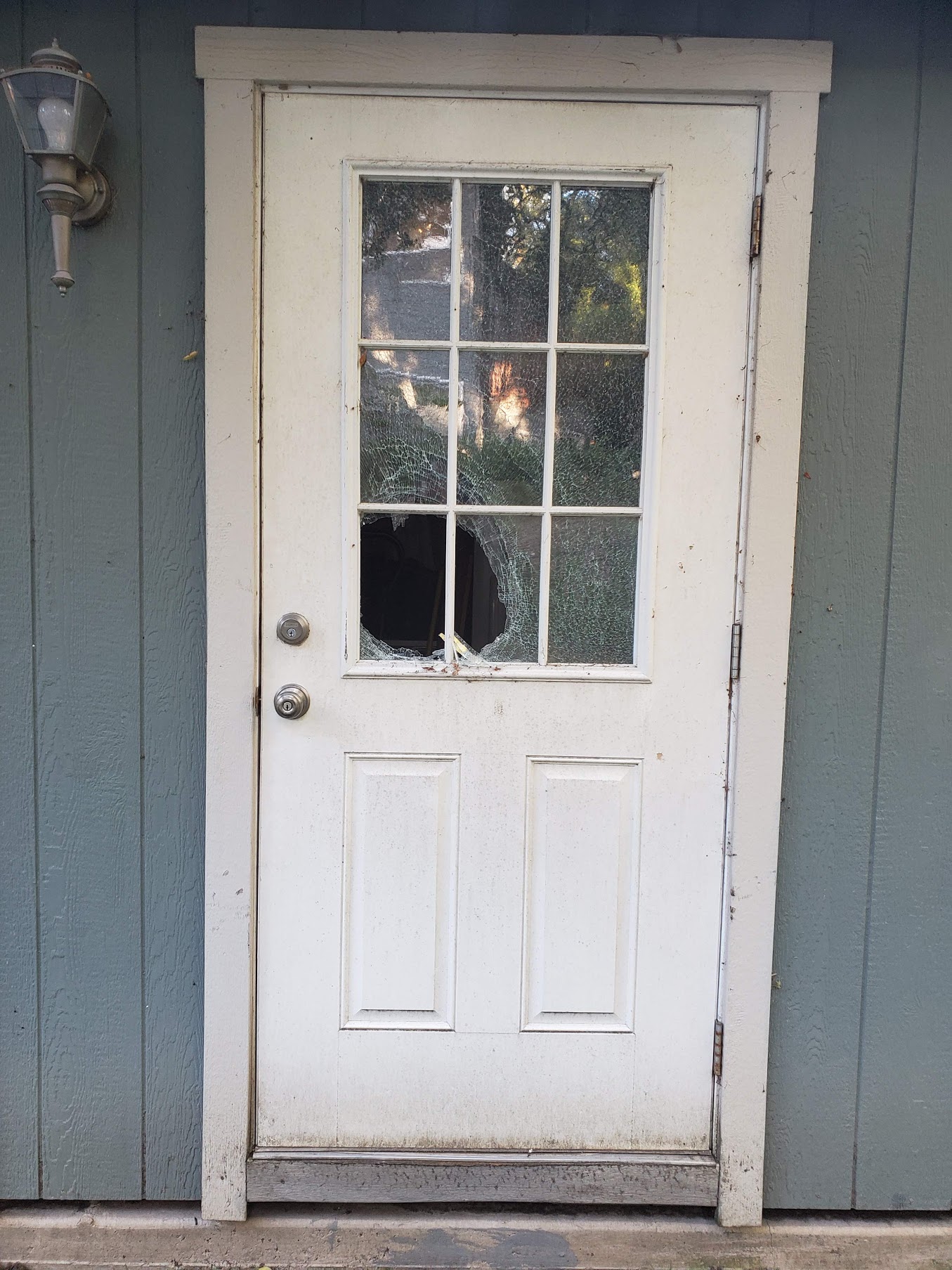

I found that someone broke into my shed where I keep my reloading gear but was dumb enough to only steal a crappy old bike.
After dealing with the police (the policeman was super cool and a hunter / reloader himself), I cleaned up the mess and loaded 100 rounds of 6.5 Creedmoor.
After that I installed a Wyze camera in the shed - it's the coolest thing ever for under $30 and works extremely well. It now alerts on motion detection. I already had exterior cameras but they just recorded the crime and didn't alert in realtime. Even at 1080p, the camera footage at night was pretty grainy.

What a jack ass!! That's a bummer, but it sounds like it could've been worse.

Well that sucks. A crappy bike is really no big deal, but having to deal with everything else is just a PITA.
Just a recommendation; I’d change that deadbolt to one that is keyed on both sides, and don’t leave the key in the lock on the inside.
I hate a frikkin thief. ?
I just did the same thing to my lyman decapper last week. I first assumed it was an undersized flash hole as the pin in my Redding FL Neck die got caught in a couple pieces of the same batch afterwards.
Good news is Lyman is sending me a new insert.
Reactions: Snuby642
You may have had some Lapua brass .
Thier flash hole is in mm, 1.5 mm
That's 0.059 inches and our tooling is 1/16 , 0.0625
Some people sand down the pin others drill out the flash hole.

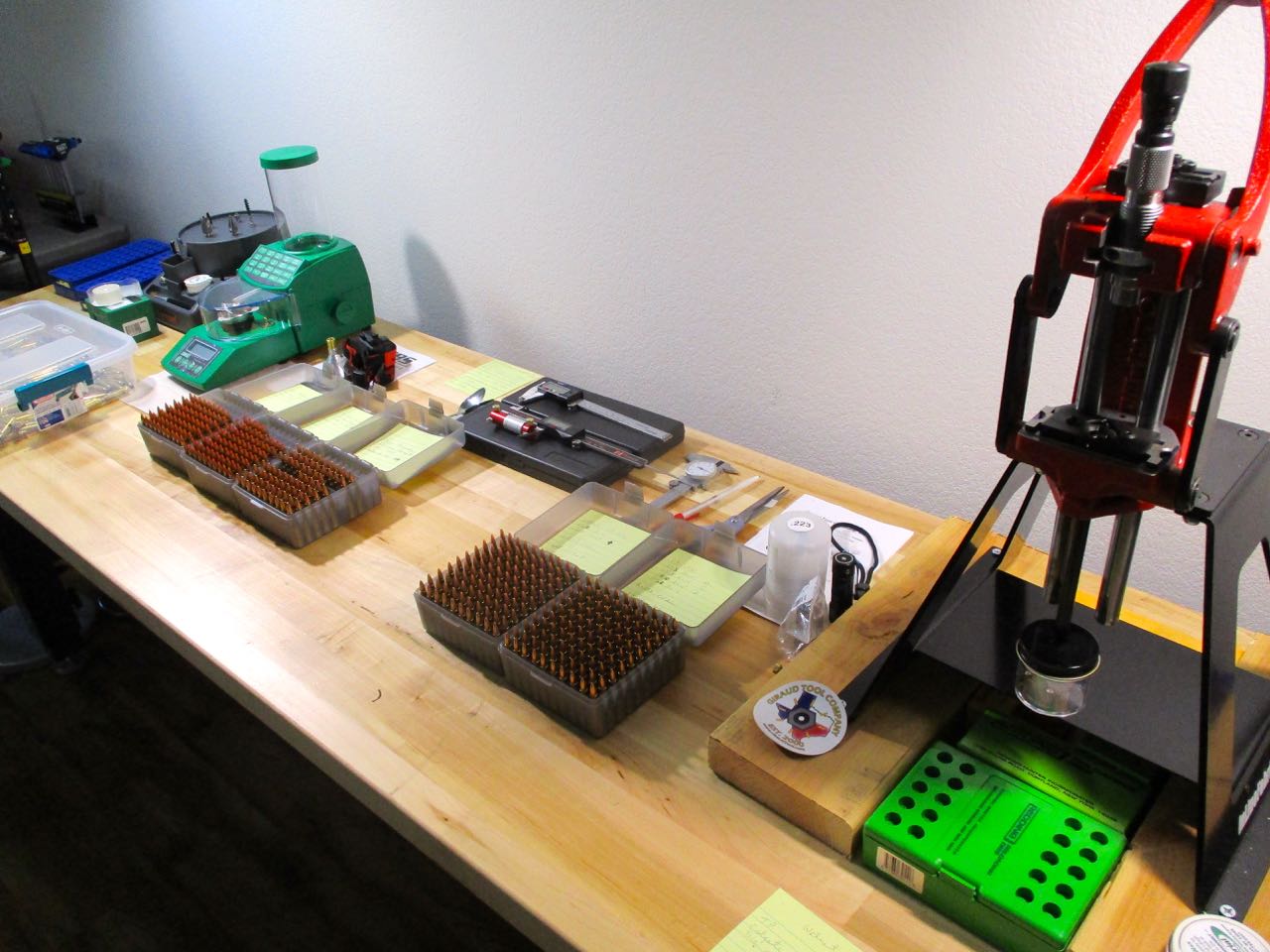

Got my second ever batch finished this AM. 100 rounds of 69 gn SMK and 100 rounds of 77 gn SMK. I'm going to get another Chargemaster to speed things up a bit.
Elster's reloading video series was very helpful. Thanks Todd!!
