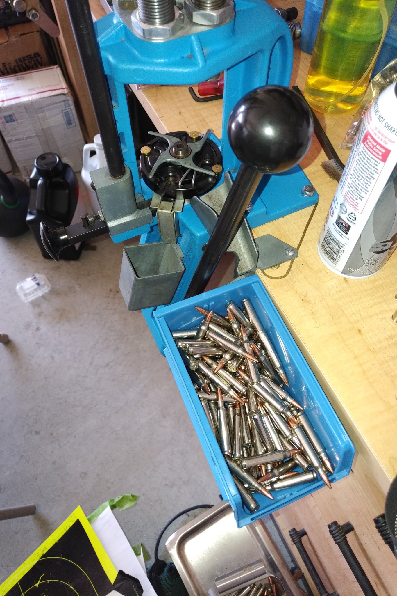

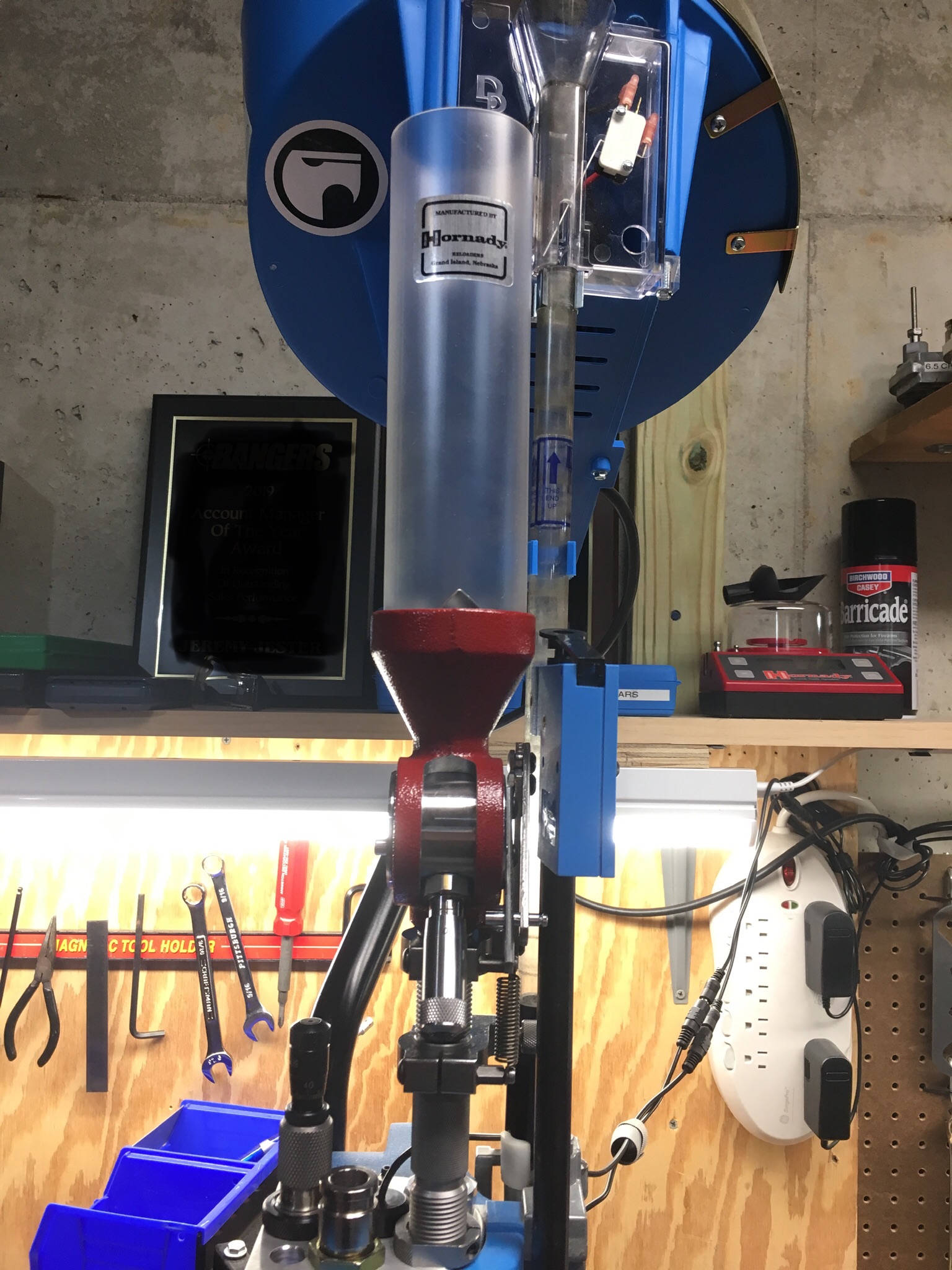

Today I set up my RL450 for 223 and cranked out a few rounds. 100 rounds goes fast compared to my previous Lee Classic Turret Press!! Shoulda done did a progressive press years ago LOL.
And the Dillon powder measure did extremely well with WC844 powder. Slightly better than +/- 0.1 grain on the handful I measured as I was going along.

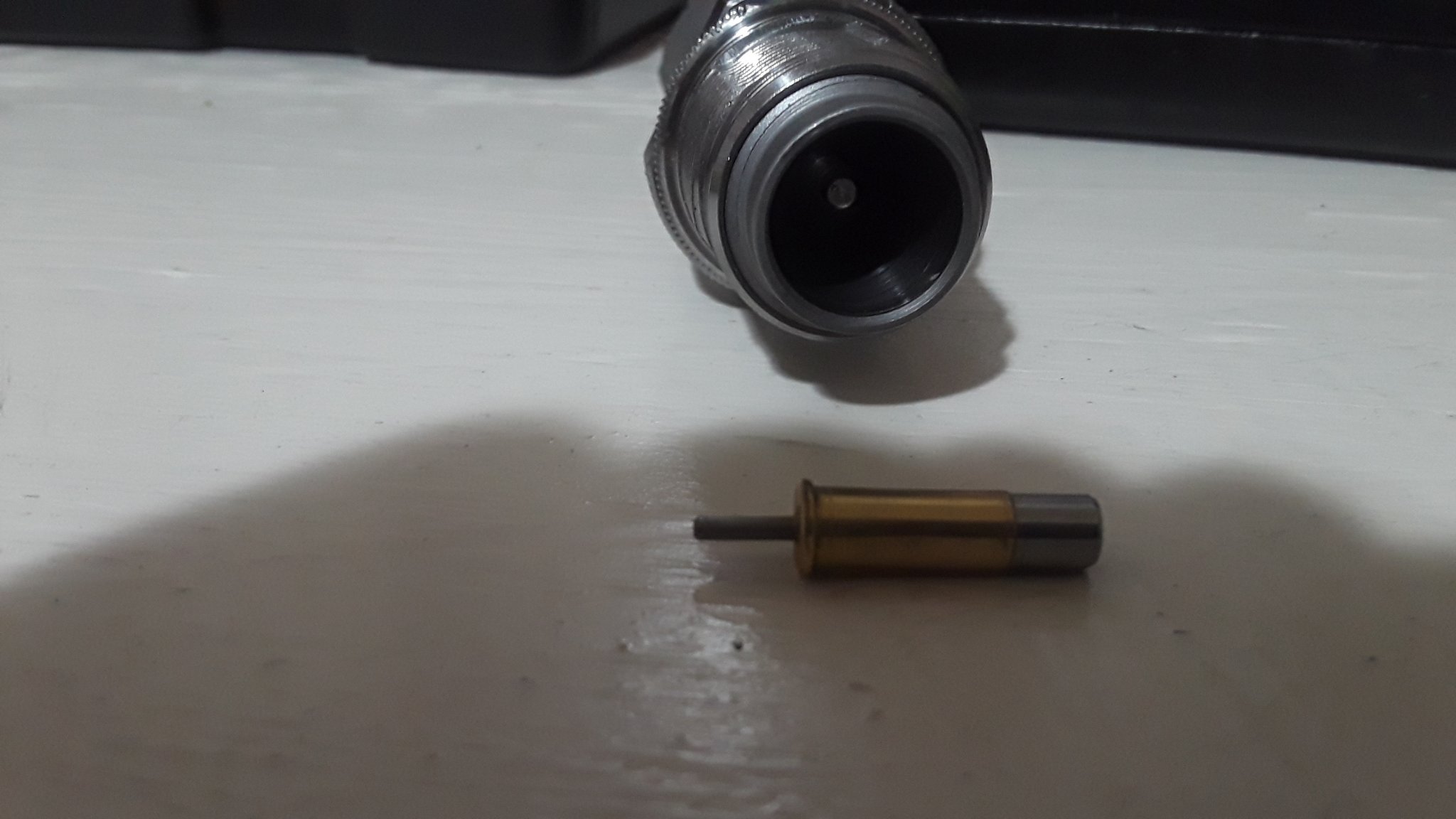

22rf was inside 308 case.
Swaged onto stem.
What a rodeo.

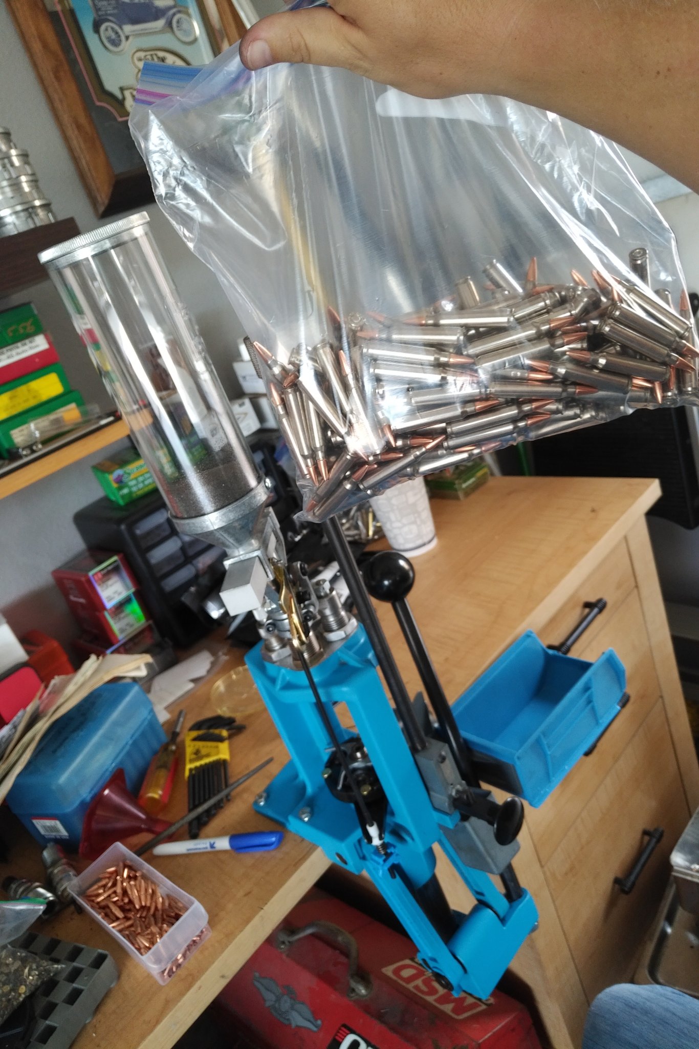

1k of 223 and 200 rounds of 9mm loaded today. The other 800 9mm will get done tomorrow.

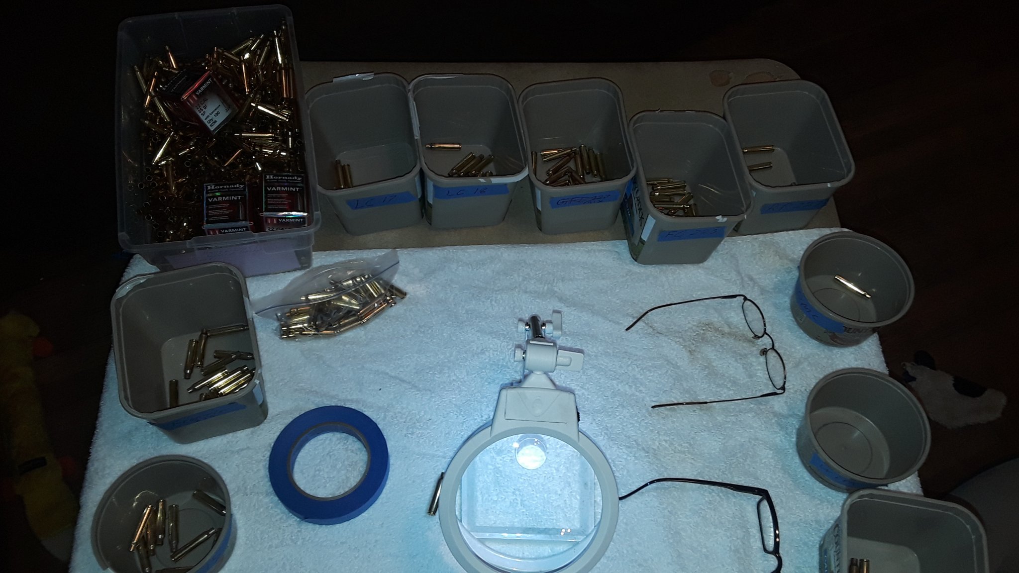

Im just starting out so I looked at my press, worked the handle up and down once. Then sat for a while and pondered how to organize and label brass. Not much but it counts. LOL I need some bins.
Reactions: DubfromGA
@little_scrapper
Clear bins with 3x5 cards on the inside
Incase the blue tape on the outside gets rubbed off.
Make sure they stack when full and nest when empty.

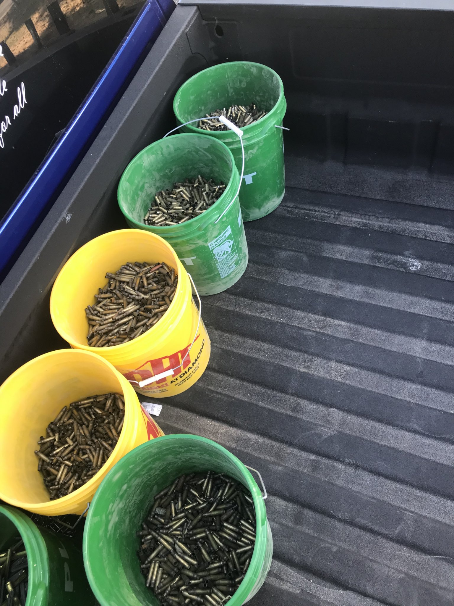

My overflow 223 and 308 may have to go in 5 gallon buckets since all my bins are full for them.

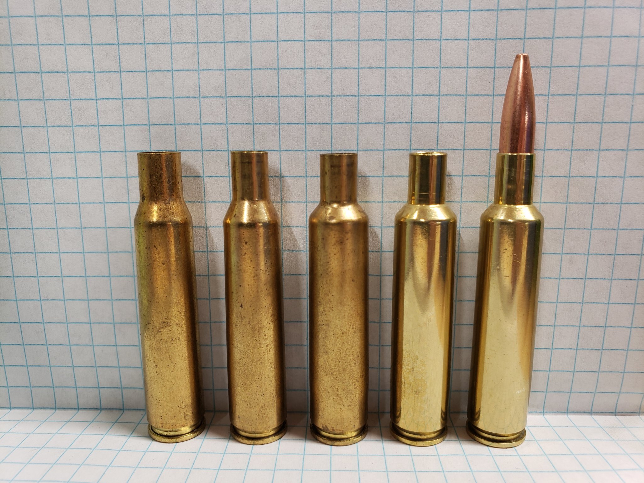

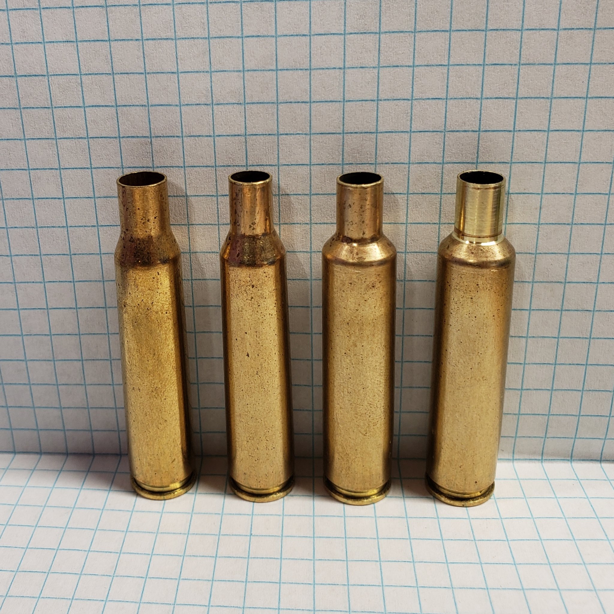

Necked down 7x57 Mauser brass to 6mm, fireformed with a light load, then neck turned.
Loaded some 75gr Barnes X bullets for initial testing.

Loaded 25 rounds of 6.5CM for an OAL test and 20 rounds of 8mm k98 Mauser.
I thought the k98 would like the 196gr but it much prefers a 150gr Hornady Interlock.
Get yourself some of these! I have 2 for each caliber...one is for clean brass, ready to load, the other is fired brass that needs to be cleaned, sized, etc. Put some little cards in each bin on how many times the brass has been fired so you keep them straight.
If organized neatly, this container holds 500 pieces of 6.5 creedmoor brass...and close to 1,000 pieces of .223
Reactions: jetsurgeon and Dpp
Those are a great idea. Not sure I would use that or maybe something similar. Cards are pretty much a necessity. As a beginner I made a quick and dirty spread sheet I can print out 4x per 8.5 x 11. Then cut into quarters for tracking how far along the brass is.
I toss this into the ziplock with the brass I am working and use this to track my batches. I do one step. Do that step to every piece. Check mark, NA or add the number required. Dates are helpful for some reason.

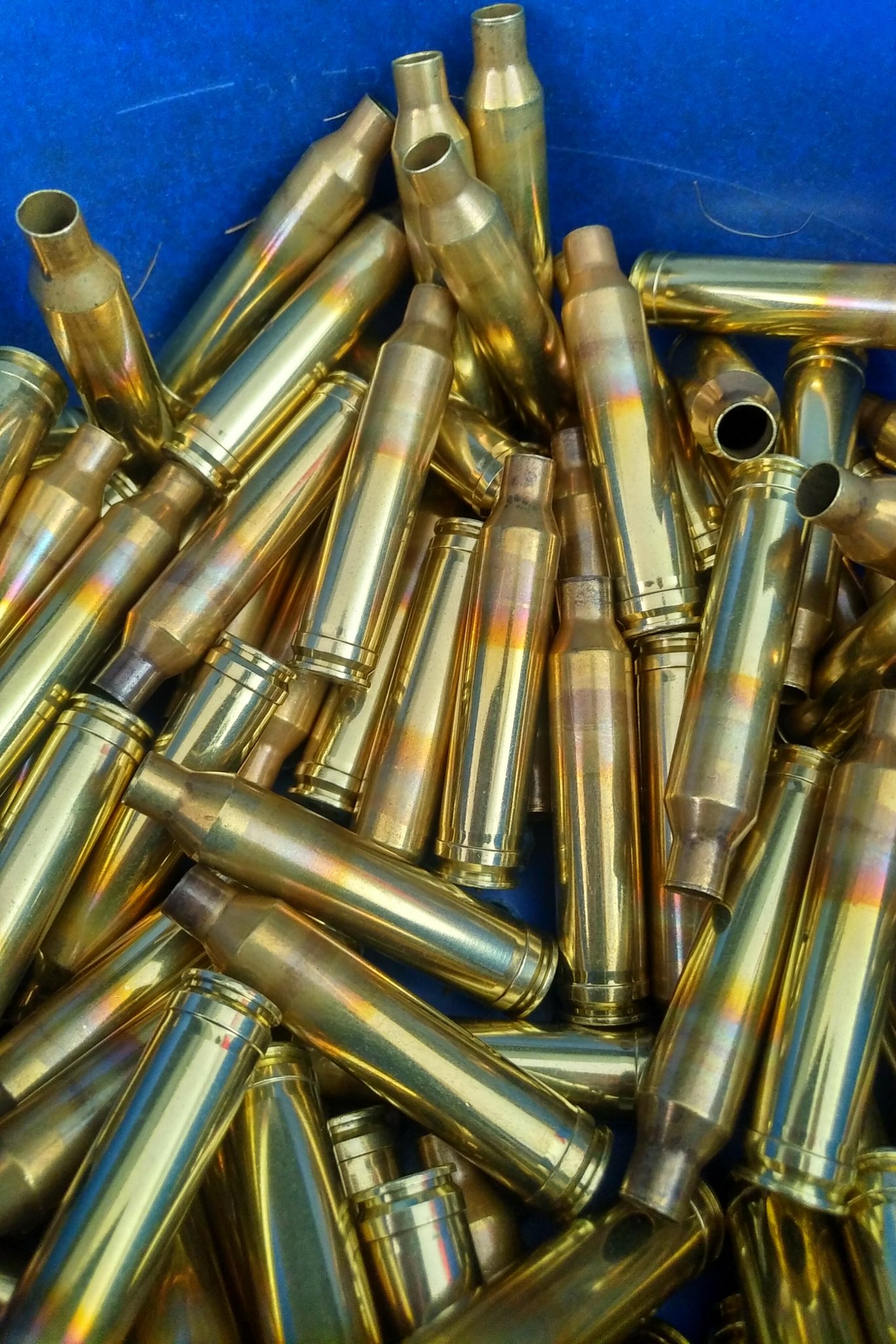

I saw a video on that salt bath annealing and seems to be a very easy, cheap and consistent way to do it.
The "scientific" testing has been inconclusive at best. The normal time is supposed to be only 5 seconds. I've been playing with different times. I do my 6.5 creedmoor brass for 8 seconds because it's thinner brass than my 7mm RemMag brass, so it goes longer in the magma. Will this process I'm doing work better?? No idea, but I did stay at a Holiday Inn Express Last night.
