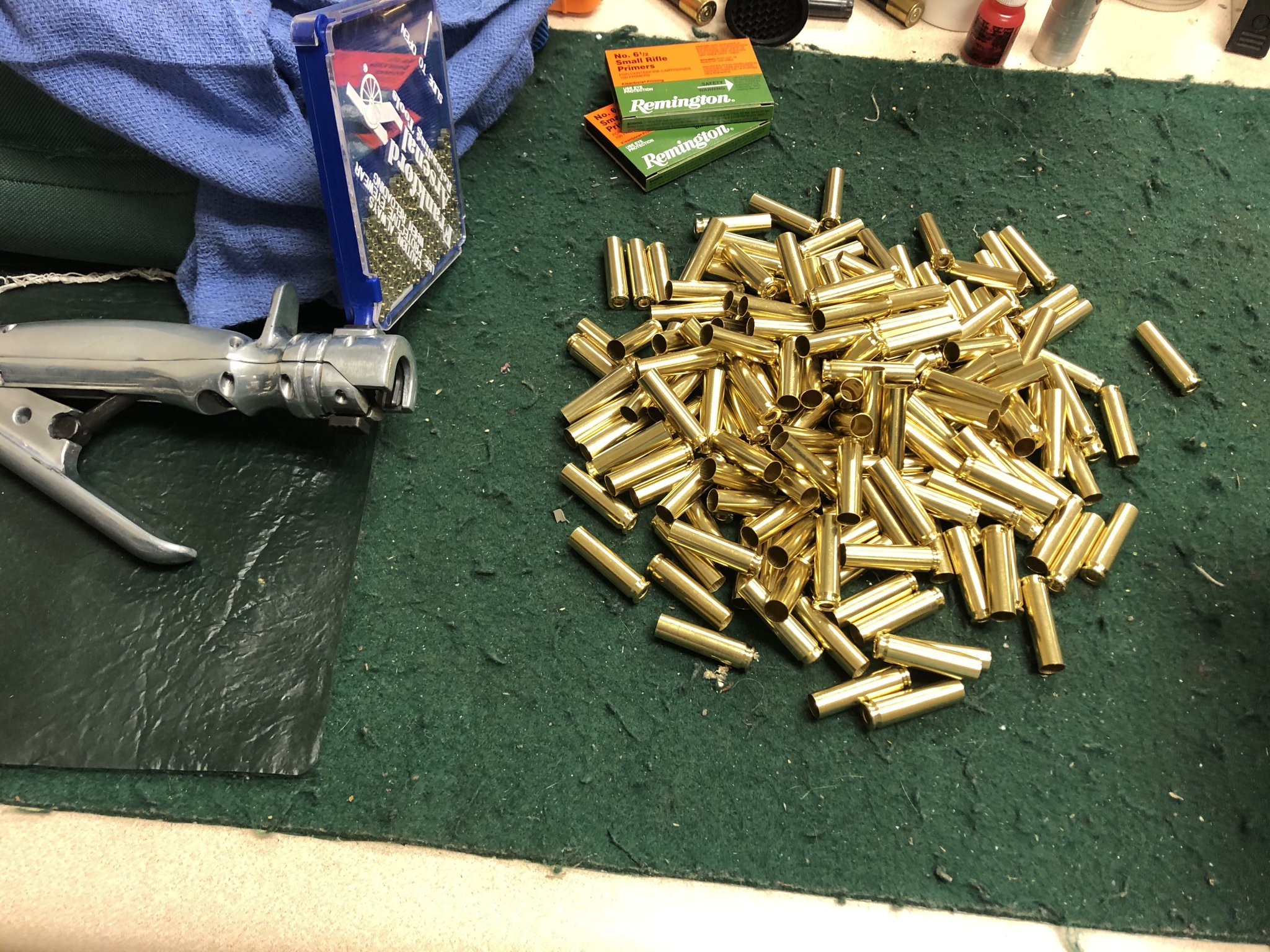

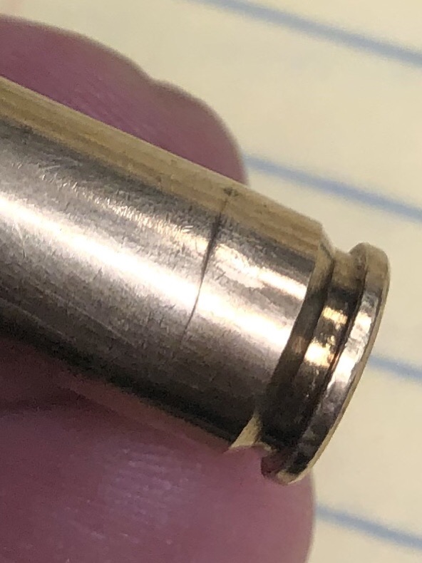

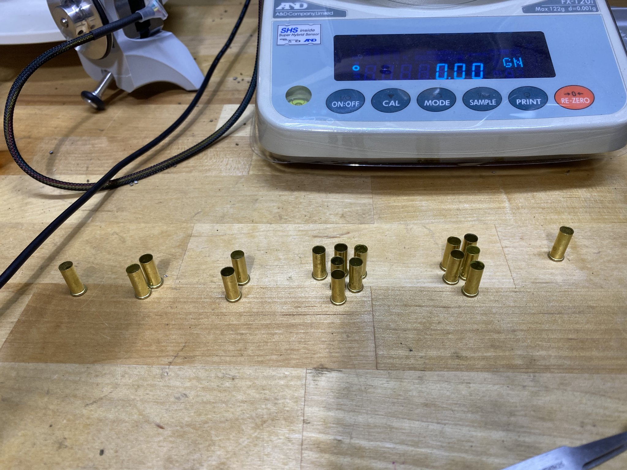

I found some shitty weak brass, so in the process of culling it all. Aguila 30 carbine brass all bulged but the PPU didn’t. Have some Starline to play with and see what happens

Well, this conversation just got a whole lot more interesting.
Tell us more about this process.
Why you choose to load rimfire vs purchasing, how does the cost compare vs performance?
Where do you buy virgin rimfire brass?
How do you deal with the primer challenge?
What projectile and powder are you running?
Cutting Edge is putting out primed .22lr cases and dies for seating bullets now, or should be soon.
I chose to load my own in an effort to squeeze the most capability out of the tiny little rimfire case. Cost of primed cases was under .06 each delivered. I’m not sure what primer challenge you are referring to?? Projectile is still a prototype so I’m not at liberty to discuss it just yet. Powder is yet to be determined but I’ll start with clays or universal.
Good luck with the effort. The primer question was assuming that you were priming cases but I guess the cases are primed when you buy them.

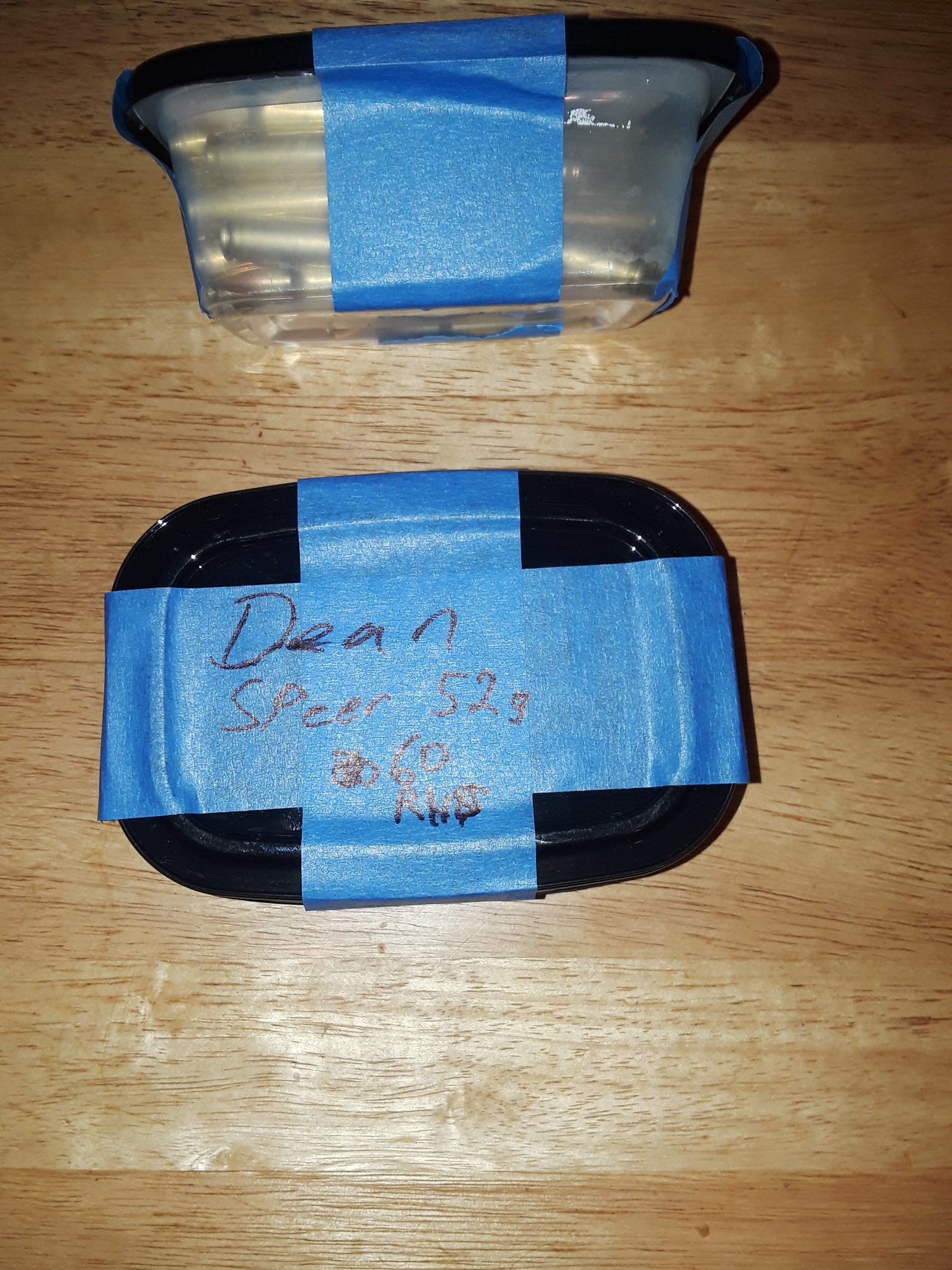

So a cheep manuver today.
Wallmart dog food containers.
Will hold 60 rounds 223 (2 mags) plus room for a small desiccant pk.
Short term storage.
Long term, vacuum seal.
Use better tape for travel.

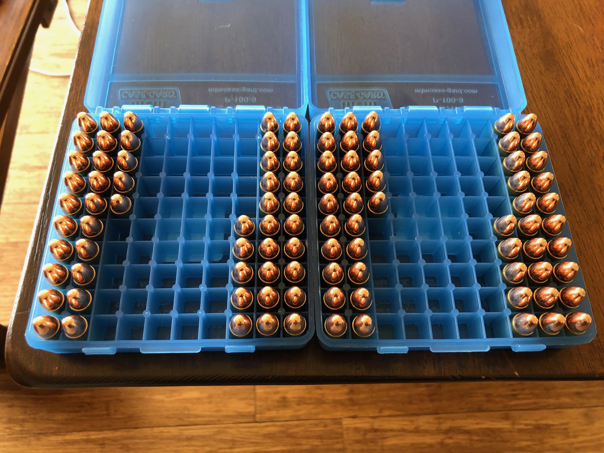

Finished my *first* complete cartridges today - 100 9mm rounds with 115gr Xtremes and CFE pistol (50 at 5.0gr and 50 at 5.2gr with two different case lengths).
Went to the range and shot 'em all. All of them fed just fine in a CZ 75 and G34. Think I like the larger charge a bit better, waiting on the pistol rail adapter for my Magnetospeed to come in to get real data.
Prepped 100 cases of .45 tonight for the finishing touches tomorrow.
Hooked.
