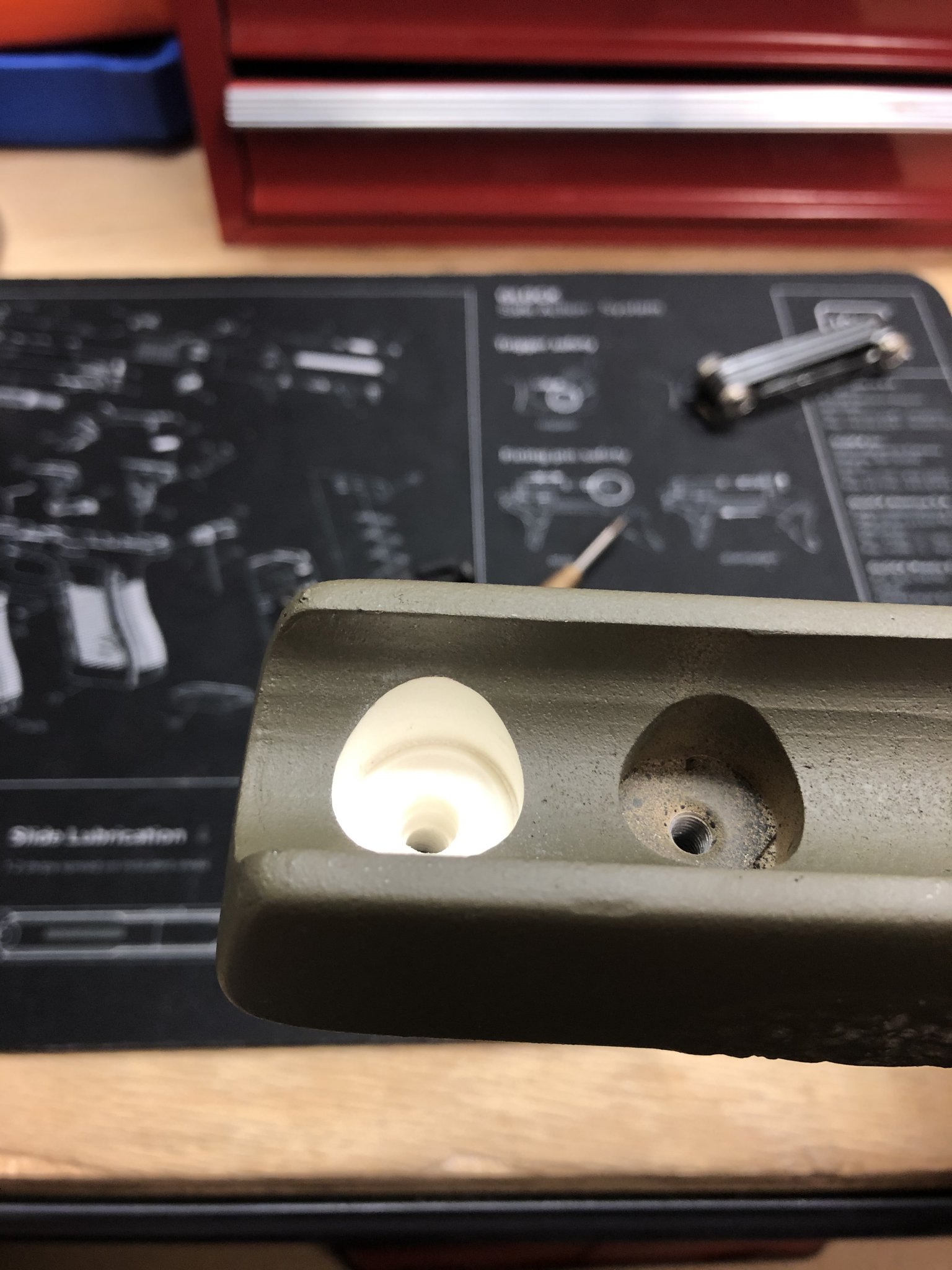

Adding a B&T rail to my new MCS EH-4. Got it mocked up, drilled, and realized I didn’t have any usable epoxy to set the T-nut, so it’ll have to be a 2-day project.
Now on to figuring out what caliber I want to fill it with. Thinking hard about a 20” 7mm-08 in #3B or Light Palma contour.

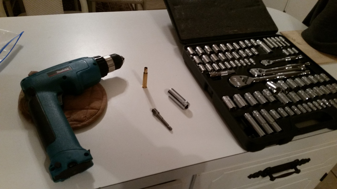

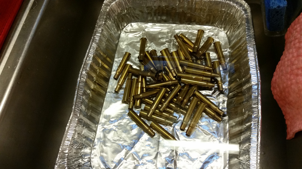

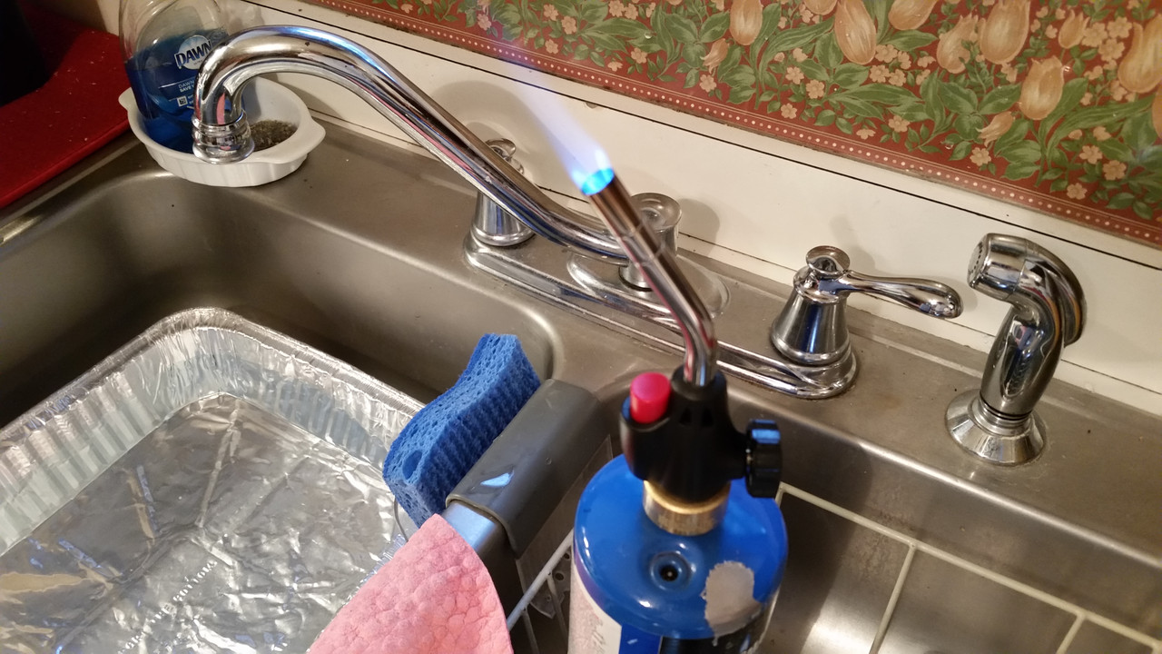

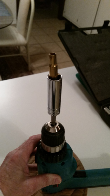

Started on getting the brass I'm using to form 40-70 Sharps Straight cartridges processed. I am using 30-40 Krag for the donor brass, I just got the dies in yesterday so time to anneal the necks and shoulders for fire forming so as to remove the bottleneck shoulder, and to resize the base down to the size of the sharps. I use a cordless drill and a socket to spin the case in front of a torch and then dump the case into a water bath. Then I dry them in the oven at 235 for one hour, I then lube and run them through the sizing die to get the base of the case sized to the dimensions of the Sharps case, then I'm forced to wait, which I hate. I will not be able to do the fire forming for the shoulder removal until I get the rifle back with the new chamber cut to the Sharps cartridge. Oh how I hate waiting for this type of work to be finished, I'm always so in a hurry to have these projects finished so I can go play with a new shooter.

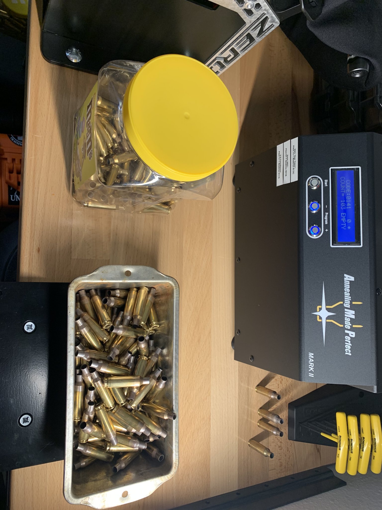

Was finally able to anneal the 1st hundred rounds of Hornady 6.5 ELDM’s after unboxing over a week ago. Between in-laws visiting, work and other family obligations I had to put the initial run on hold till after 🕛 tonight.
This AMP Mark II is definitely sweet and very quick. I can only imagine this with an auto feeder.

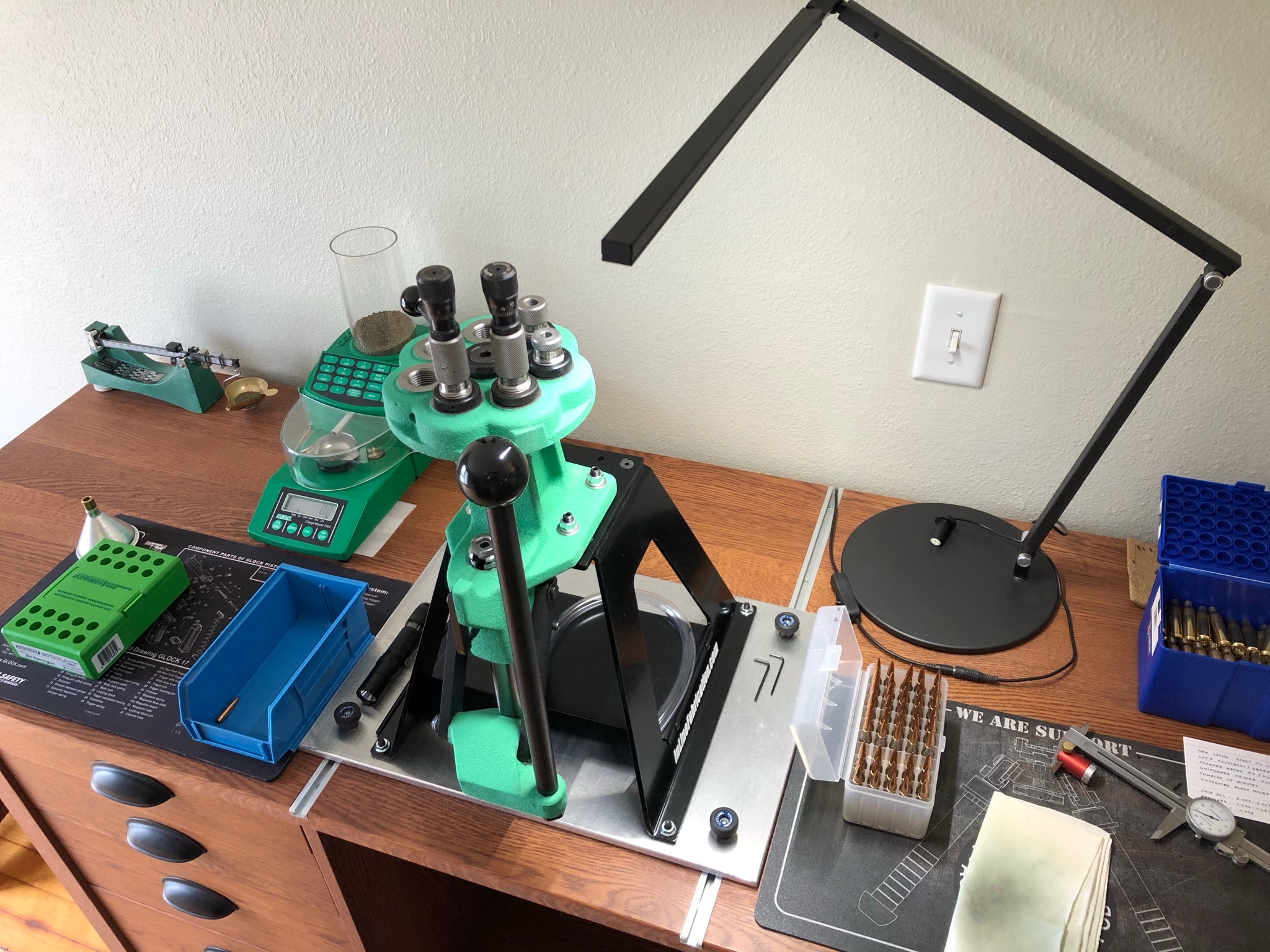

Primed, powdered, and seated some 260 Rem today.
Wow, I really like how you set up your press on the plate and rails. I'm guessing that you counter sunk the bolts holding the Inline to the plate?
And what rail is that, please.
I'm hard mounted to the bench but I hate perm mounting stuff....I only so much bench space. Saw a vid where a fella reviewing Henderson trimmer put threaded inserts into his bench...I think they are often called furniture screws maybe....and then had nob handled bolts for hold down.

Correct, counter sink for the Inline to plate interface. I posted pics while I was doing this plate not too long ago, but don't recall if I posted them on this thread or "What's Your View" over in Maggie's. I'll see if I still have them and post them if I do. I went this route as I have limited space as well. I have 2 Dillon 550's also on plates.
The track is Rockler T track if I remember correctly. It's commonly used in hobby wood working circles.

I also used the T-tracks in my bench. I combined them with the Inline Fabrication plate so I can quick change presses, and templates to quick change tools.

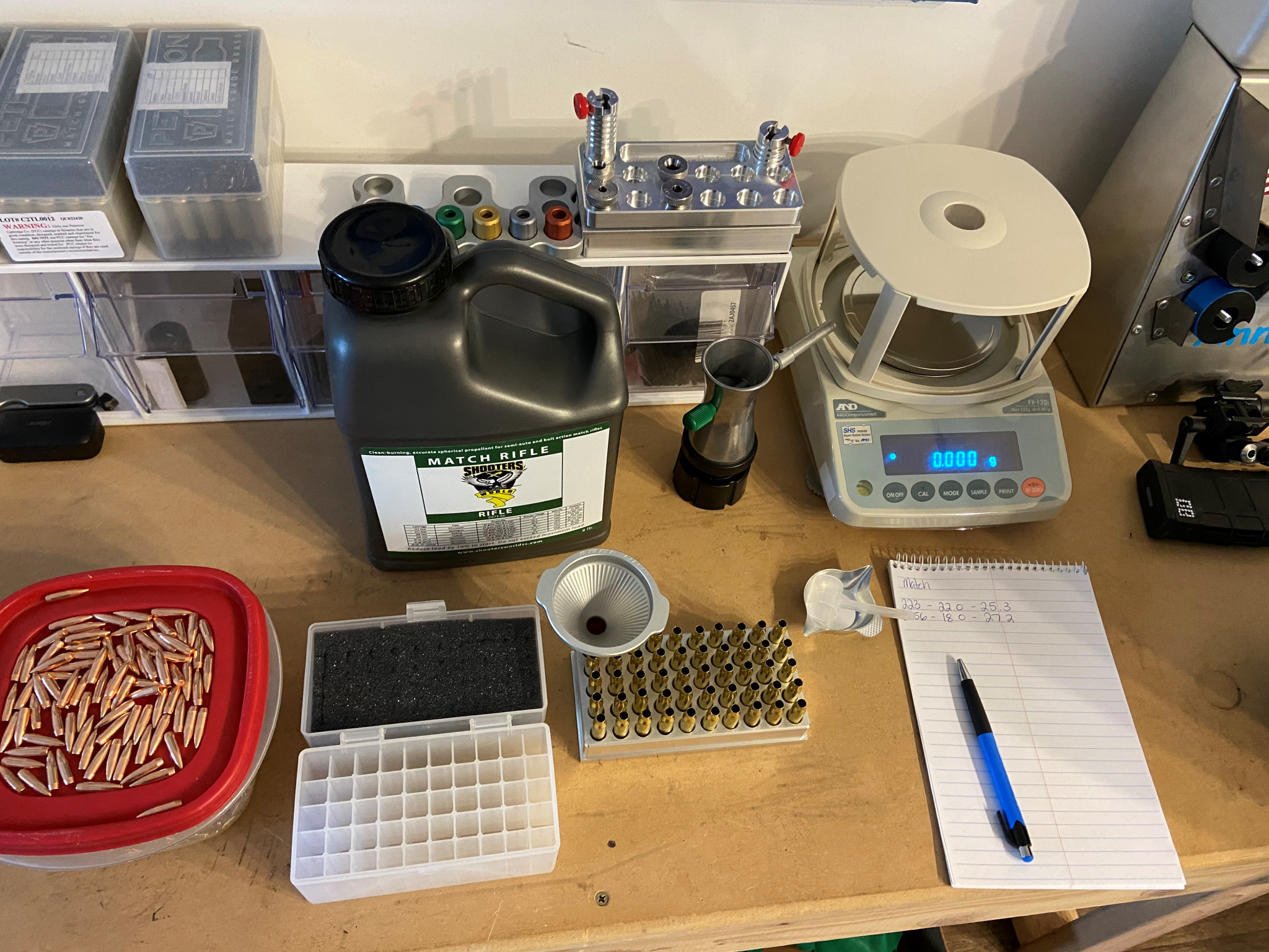

Waiting on the V4 so... using a small scoop and powder trickler... :(
From the look of it, SW "Match" is a ball powder. For a small investment, while you're waiting for the AT V4, an RCBS Uniflo measure (or similar) will net you very repeatable powder drops, with little need to trickle. I will say that how you manipulate the lever can affect charge weight, but you have the scale to figure out how to be consistent.

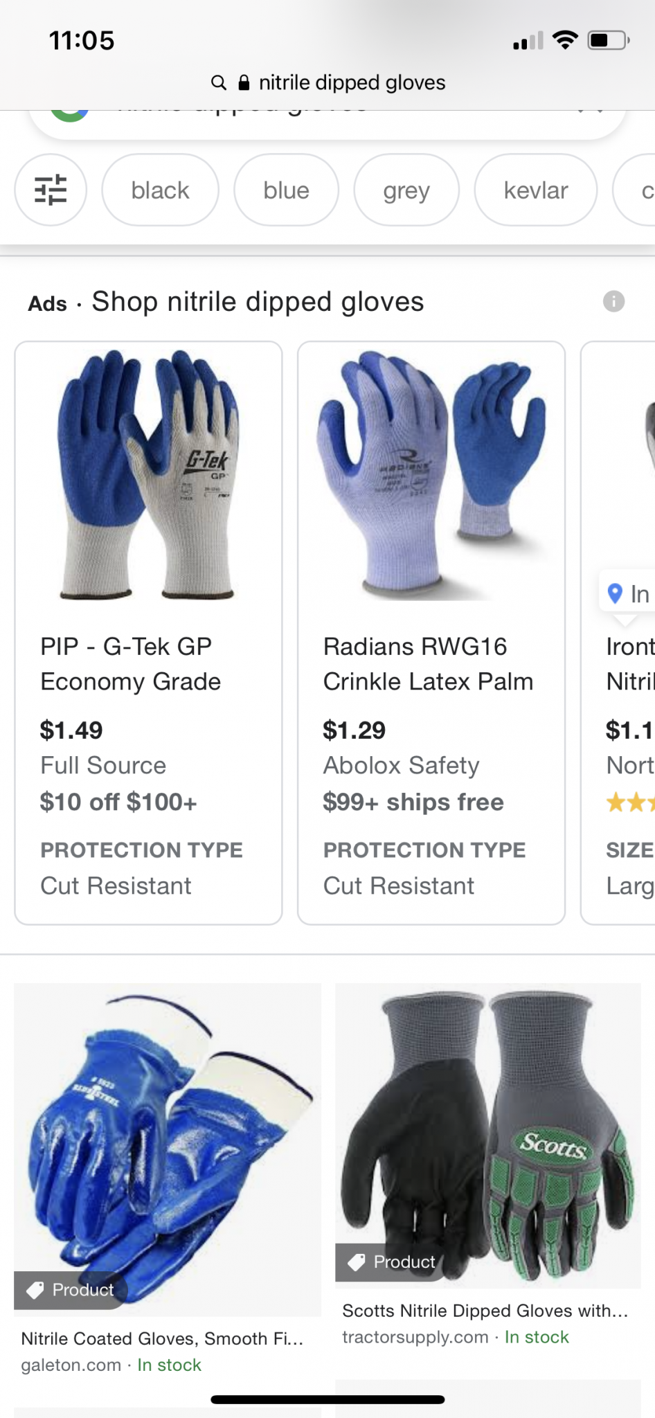

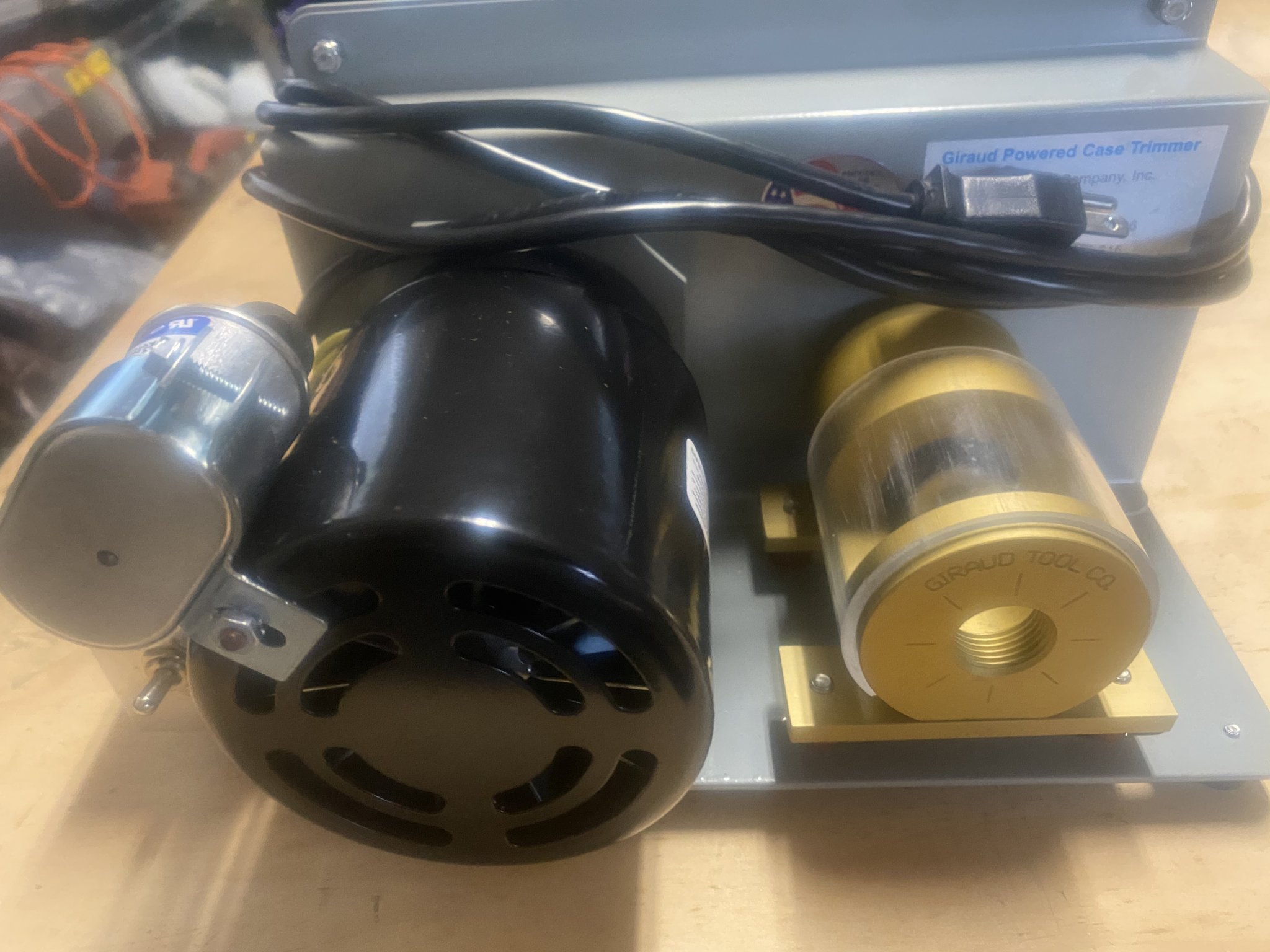

My fingers were numb this morning from trimming 200 cases on the Giraud. I used a light weight glove but it's not cutting it. Think I need something made of leather to protect my fingers better. It's from pushing a case in then rotating it a few times.
Sized 300 peice of 223 and started trimming. Man that Giraud trimmer is looking nicer and nicer...
Reactions: camocorvette
I find the cheap nitrile dipped cotton gloves are the best for it. Like the little ones they sell 5 pairs of for 3 bucks on the end cap of an aisle at Lowe’s. They are thick enough under the nitrile to where the little 300bo cases that can only be held by the very end don’t dig into the fingers too much but the cases aren’t slick in them like with my leather gloves and they are flexible and breath so your hands don’t get all sweaty like with a rubber glove.

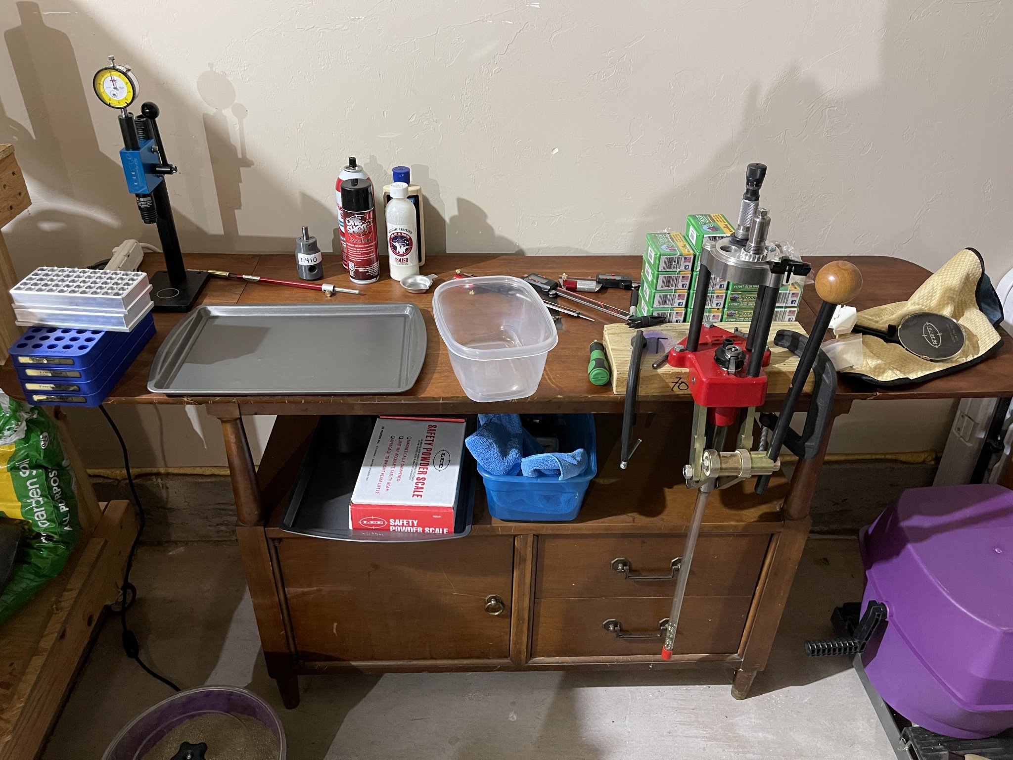

I went from this crappy old microwave or tv stand (whatever the hell it is, and wherever the hell I got it from) in the garage...
To a halfway legitimate setup on one side of a spare bedroom. The other side of this room is my amateur radio room. Still not finished (will it ever be?) But pretty proud of myself, heh.

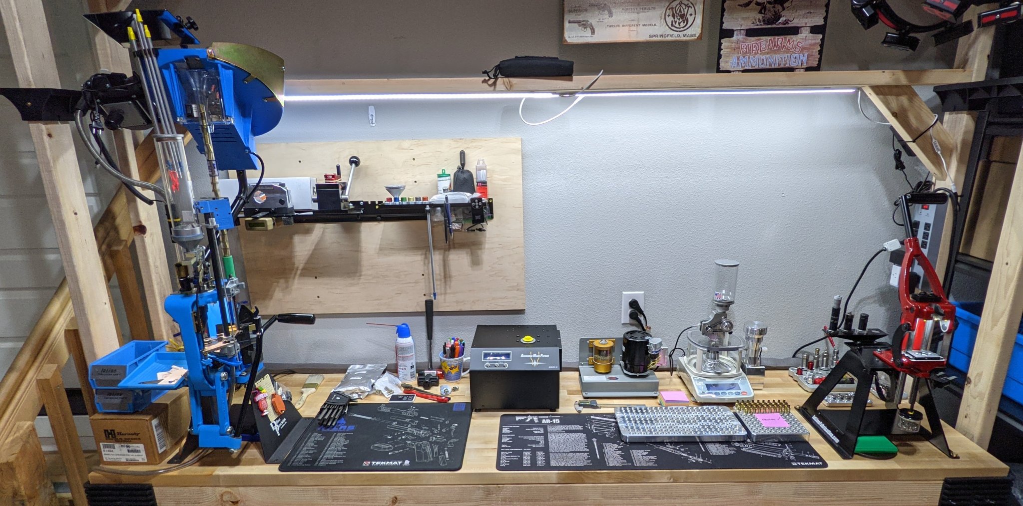

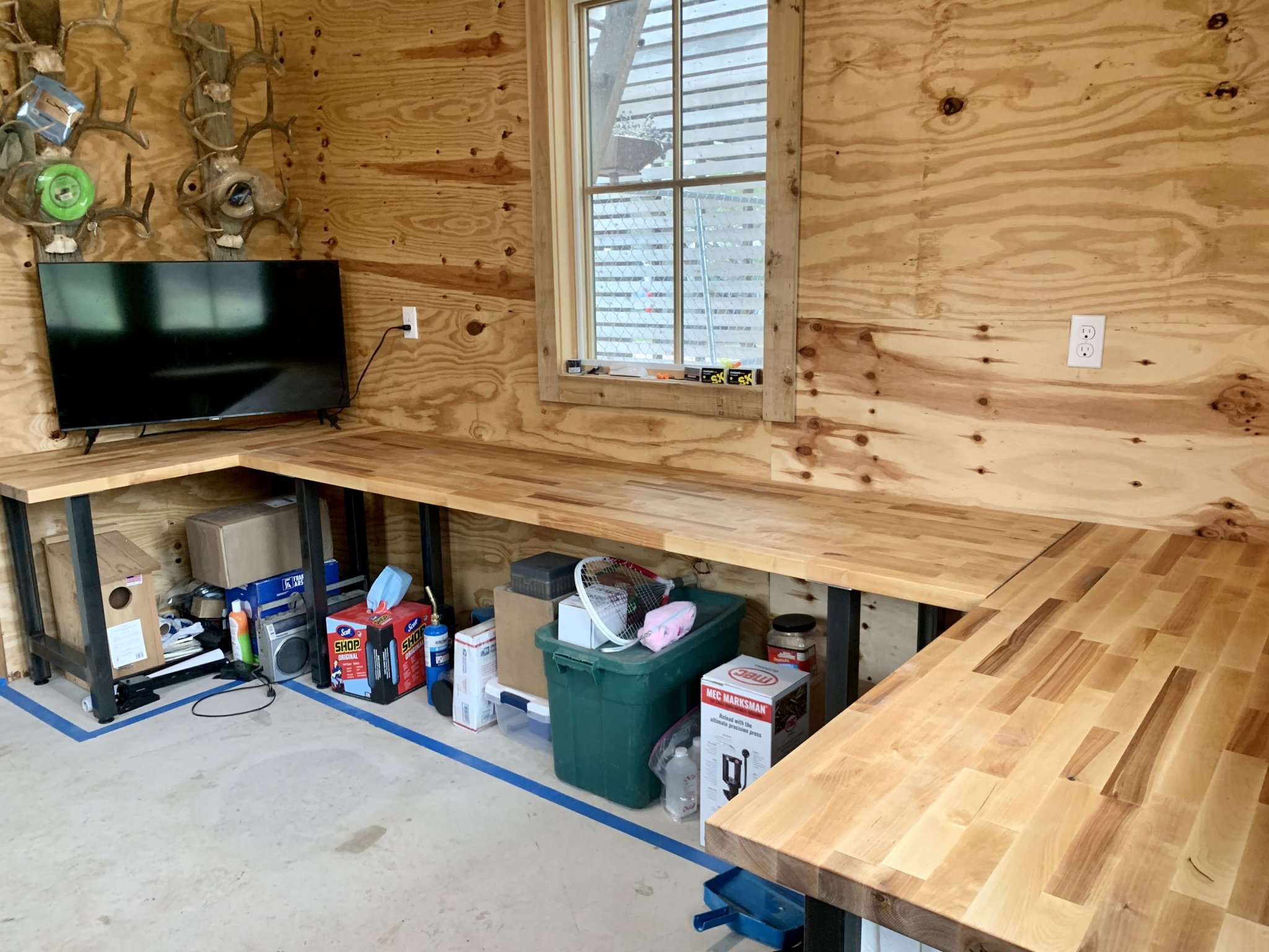

Does anyone want to offer layout suggestions on my new reload bench?
I have a U-shaped area to work with. 3 tables. In this photo, L to R they are: 4ft short side, 8ft long side, 5ft short side.
I’ve got 2 presses with Inline quick release plates on a 9” riser. A&D scale. Tumbler. Henderson trimmer. Torch annealer.
Pretty well want spots for everything to be out since I have the room.
Note: TV will be mounted to the wall, not on table top
Layout thoughts?
Layout thoughts?
I’d just set stuff up on bench’s and move around to your liking. Once u like start drilling!
Everyone seems to have little different workflow.
