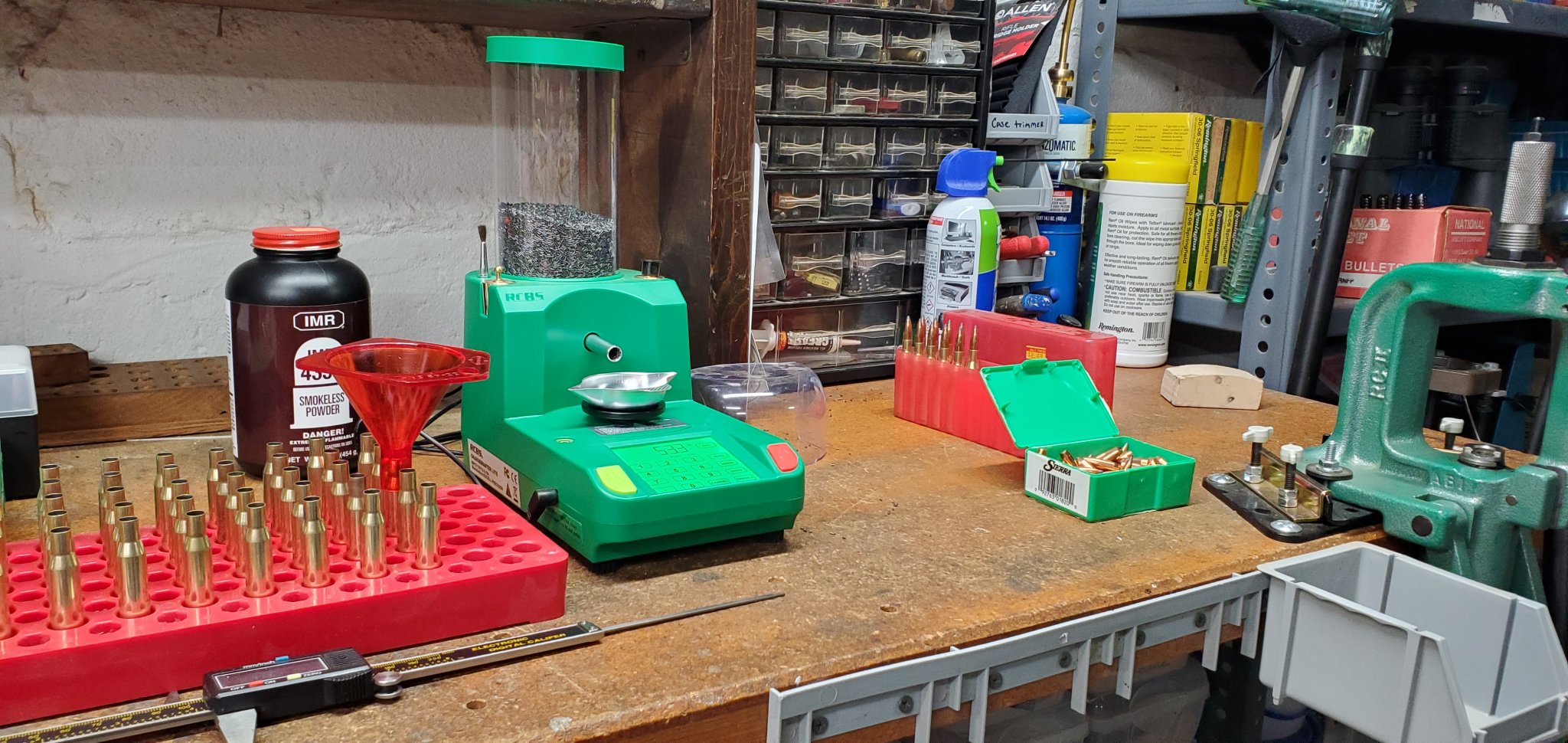

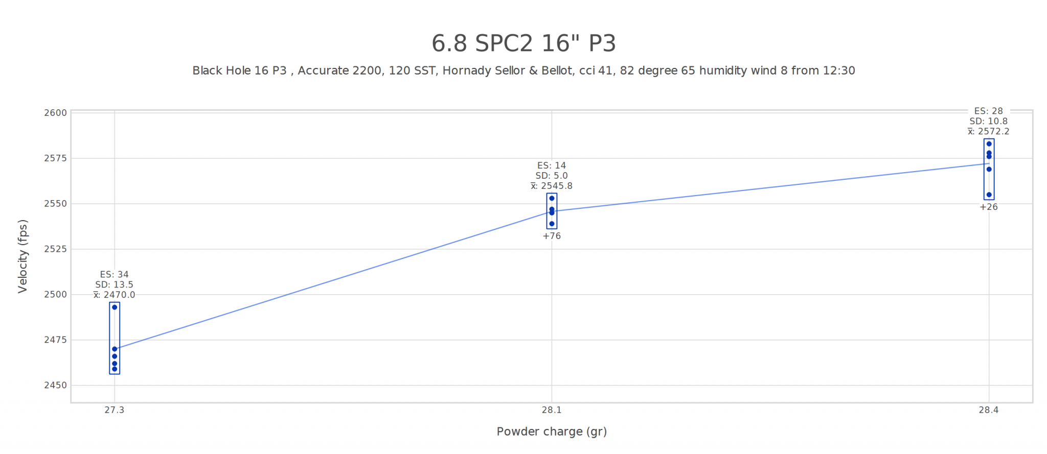

Got the 6.8 SPC dialed in with 120 SST's Shooting 2550fps just under 1 moa @ 100. Gave up on the 130 Nosler BST. Groups just started to tighten as the load got to hot & I don't want to switch powders for the SPC. The 8lbs of A2200 is pretty much just for the 6.8.
There were 2 loads between 27.3 & 28.1, but I brain farted and combined them on the magnetospeed. 28.1 is higher then the std 27.5 everyone praises on the 68 forum, but SD is good, brass looks good, primers look good, & gun functions well, brass cumming out @ 3:00.

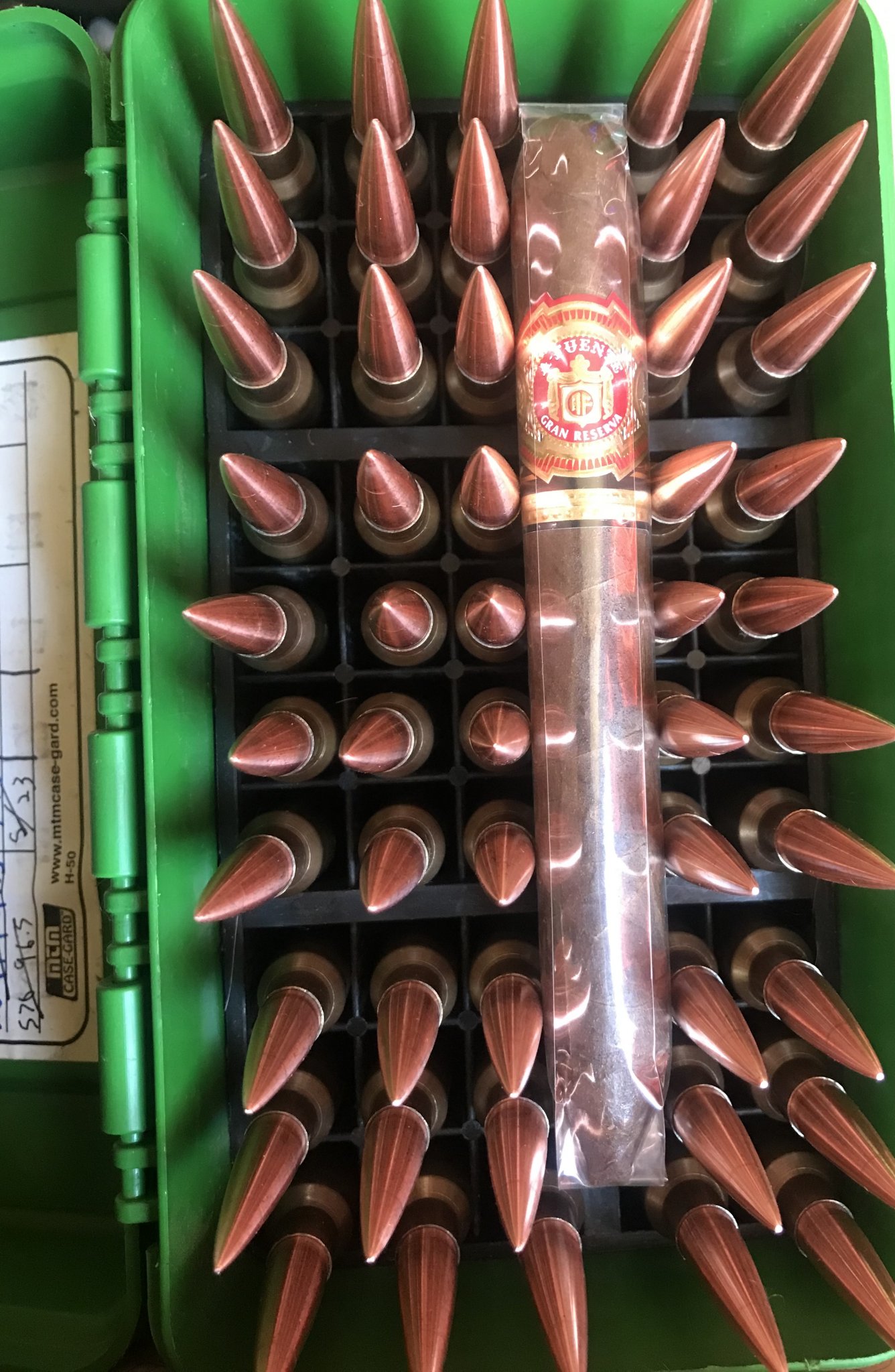

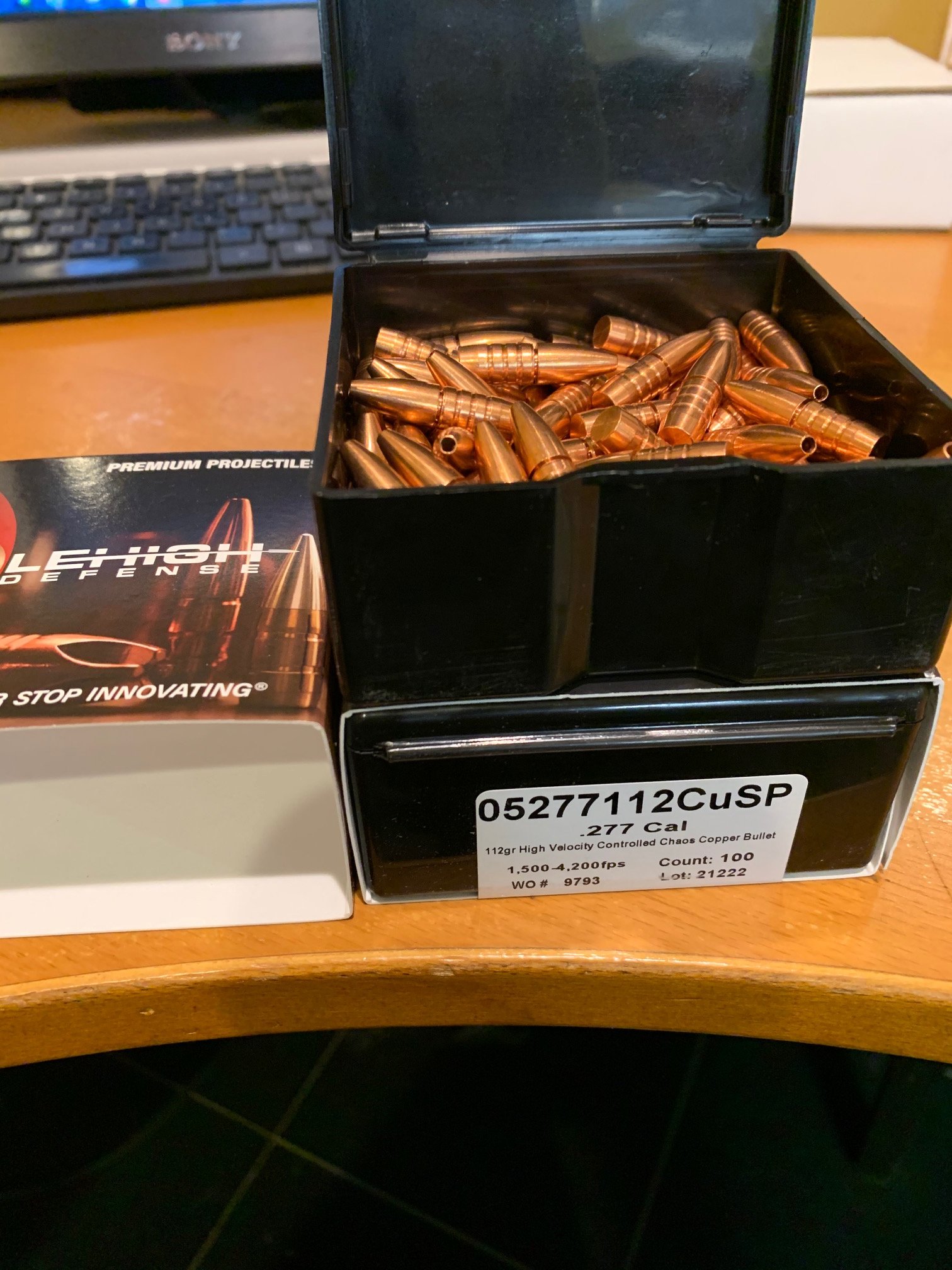

Next up - Size some 1x fired Barret 6.8 brass & give these a try. Hoping to see 2625fps with the A2200 from this 16" barrel. The Lehigh's are a pretty good deal IMO for $55.00 per 100 for solid turned copper.

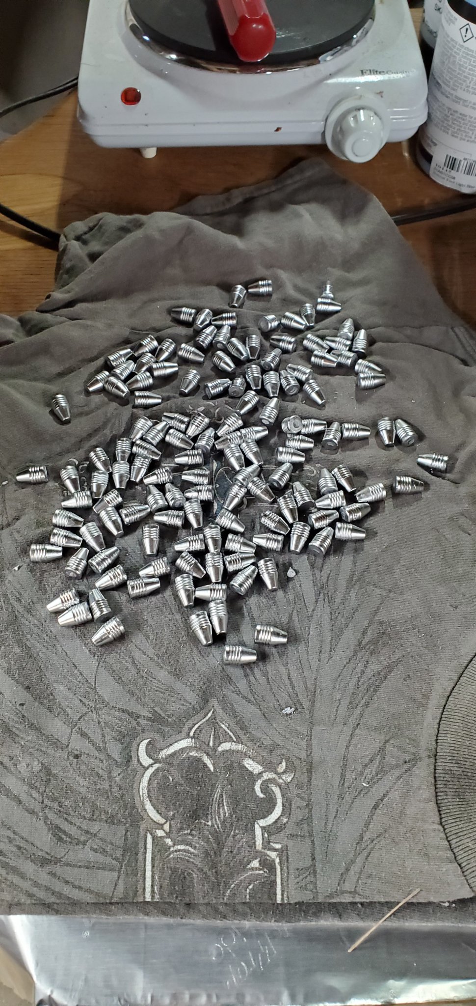

Multi-tasking! While completely rewiring / replacing lights on a utility trailer....was melting down wheel weights pouring ingots. I would periodically leave the trailer work, go to the barn and remove the “unwanted stuff”, flux the metal, and pour the ingots. After hunting season....casting season begins! memtb

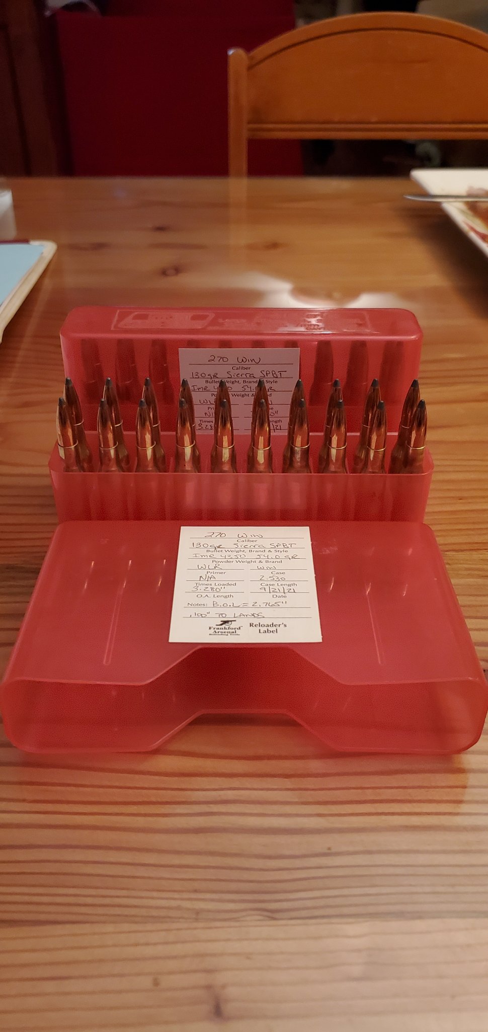

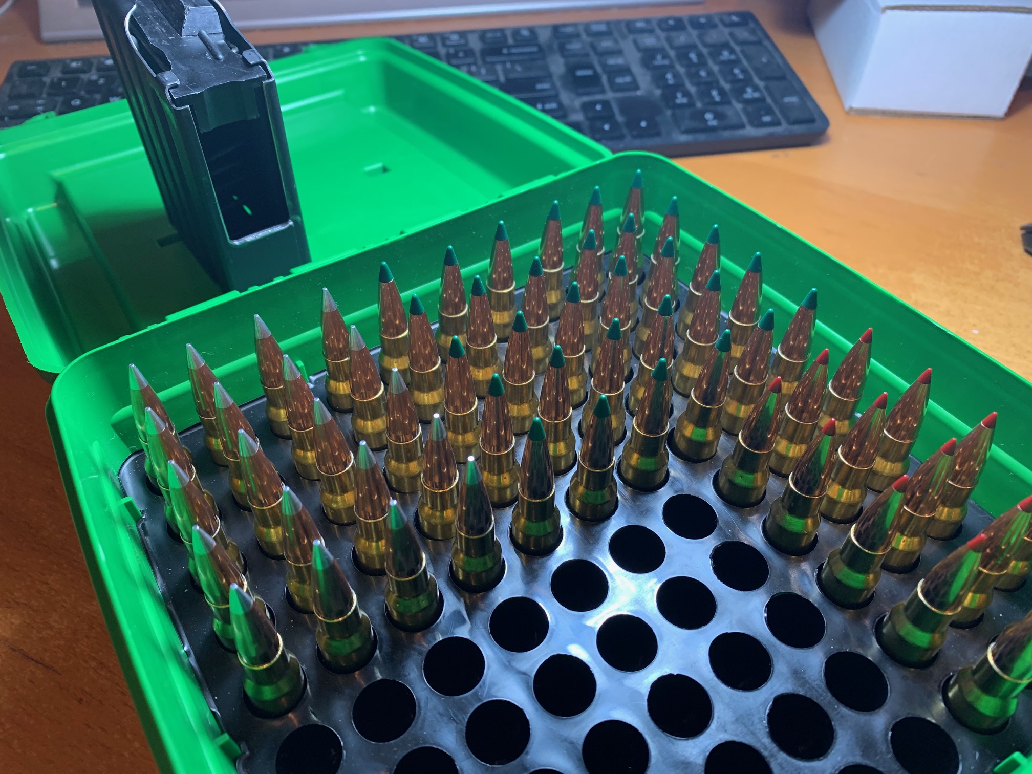

Finally got the 7 SAUM swap back from the gunsmith and put together a little load development to see what she's gonna like. I think I'm just getting old cause I used to just wanna shoot more than anything and anymore I get excited to play with my firearms in any fashion... Finally scored some powder I been waiting on and damn near got hard over it :ROFLMAO:

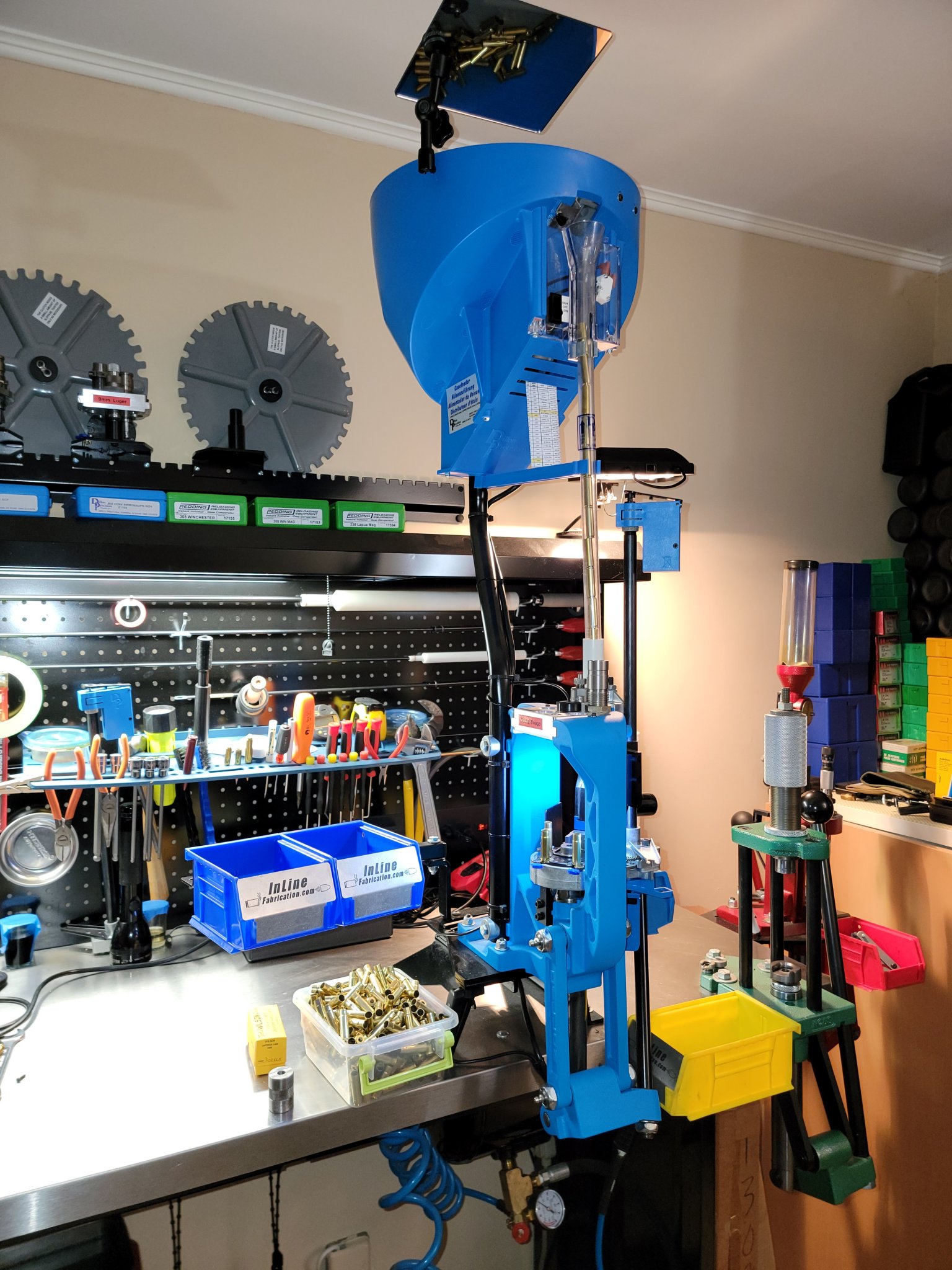

Been getting the intellidropper and frankford case prep center setup. Kinda needed since I broke my elbow and only have one usable arm and a ton of free time. That's the excuse I used to convince my wife anyhow

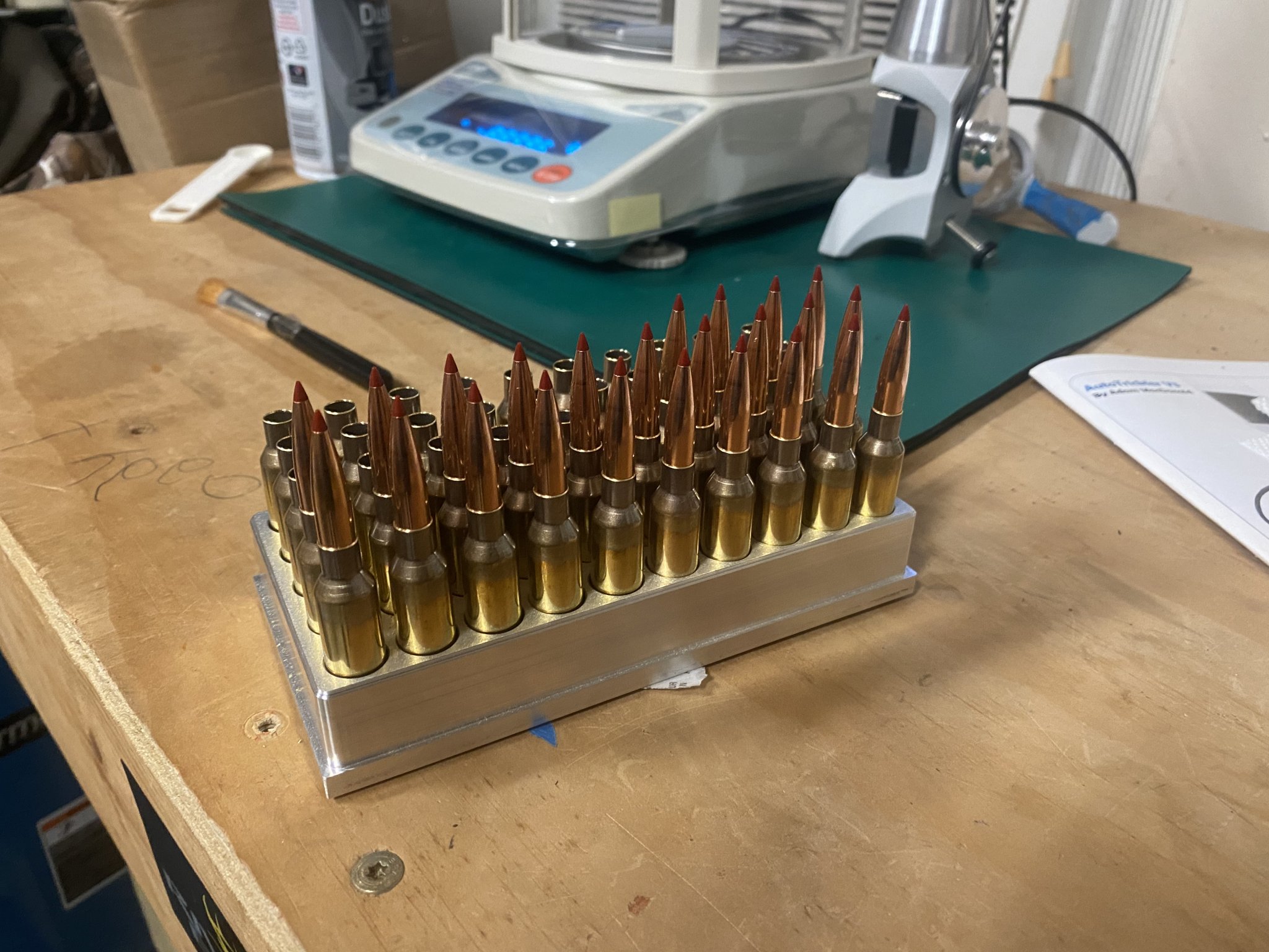

Spent the weekend organizing. (Last 4 days off and on if I’m being honest.) Wholly shit can I be a messy person… Turned my V2 AutoTrickler into a V3, broke out the RCBS Matchmaster, and made space for a V4 AutoTrickler as well. Primal Rights CPS shipping notification came in. Pretty stoked about that. Got a second CoAx plus SAC barrel vice all put in. Hopefully work slows down soon…

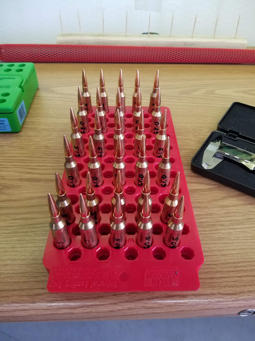

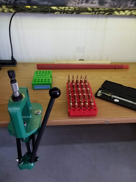

I finished my week’s project. The trilogy was the 6.5CM.
Here….sizing
And then priming on the press…
Charging and seating…yeah, yeah….yada-yada.
This took a week to complete… L to R: .308win, 6.5x47L, 6.5CM
Enough (220 rounds for each caliber) for …a lot of shooting.

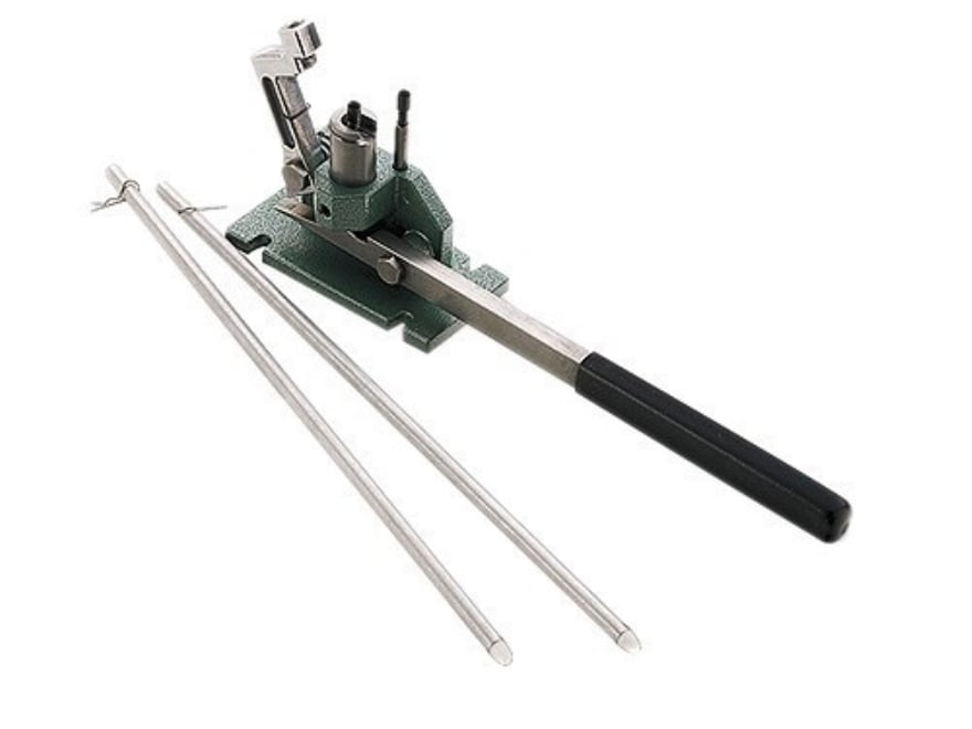

Primed 99 small rifle primer cases.
A bit of a backstory. Reloading for many years (decades actually) it is wondrous thing of all the tools and parts one collects. When I purchased the MPA (in 6.5) I wanted to keep the cases separate from the 6.5 cases I was using in the RPR. Small primer cases solved this issue. However, all my .308 sized cases utilized large primers (since I sold my one and only 7mmBR XP-100, going with all small case rounds for our half dozen bolt action pistols. ). So, the single stage Redding was set up for large primers and it was a pain to convert. The two Dillon’s were set up, one for large and one for small primers but everytime I wanted to use it to load the 6.5 small rifle primer cases I had to move the faceplate over. While none of these are major time consuming issues, it was just a bother to have to mess with. Especially since so much of my reloading was built around getting the job done effectively and efficiently. Finally, my newly rebuilt Orange Crush Single Stage that I sized these cases on, did not have the small primer setup available.
However, I had this old RCBS Bench Mounted Automatic Primer tool sitting aside. While it was the goto tool I depended on years ago, it had since fallen into disuse. I tried it again not too long ago and it totally locked up. Had to destroy the case just to get it free. But it was just too darned convenient, mounted easily to the RCBS base plate and if it would work, it would solve a whole lot of problems regarding loading small primer 6.5 cases.
Well the Primer Tool and I spent quite a bit of time this evening, diagnosing its issues and repairing each one along the way. Got er going and primed all my cases perfectly.
