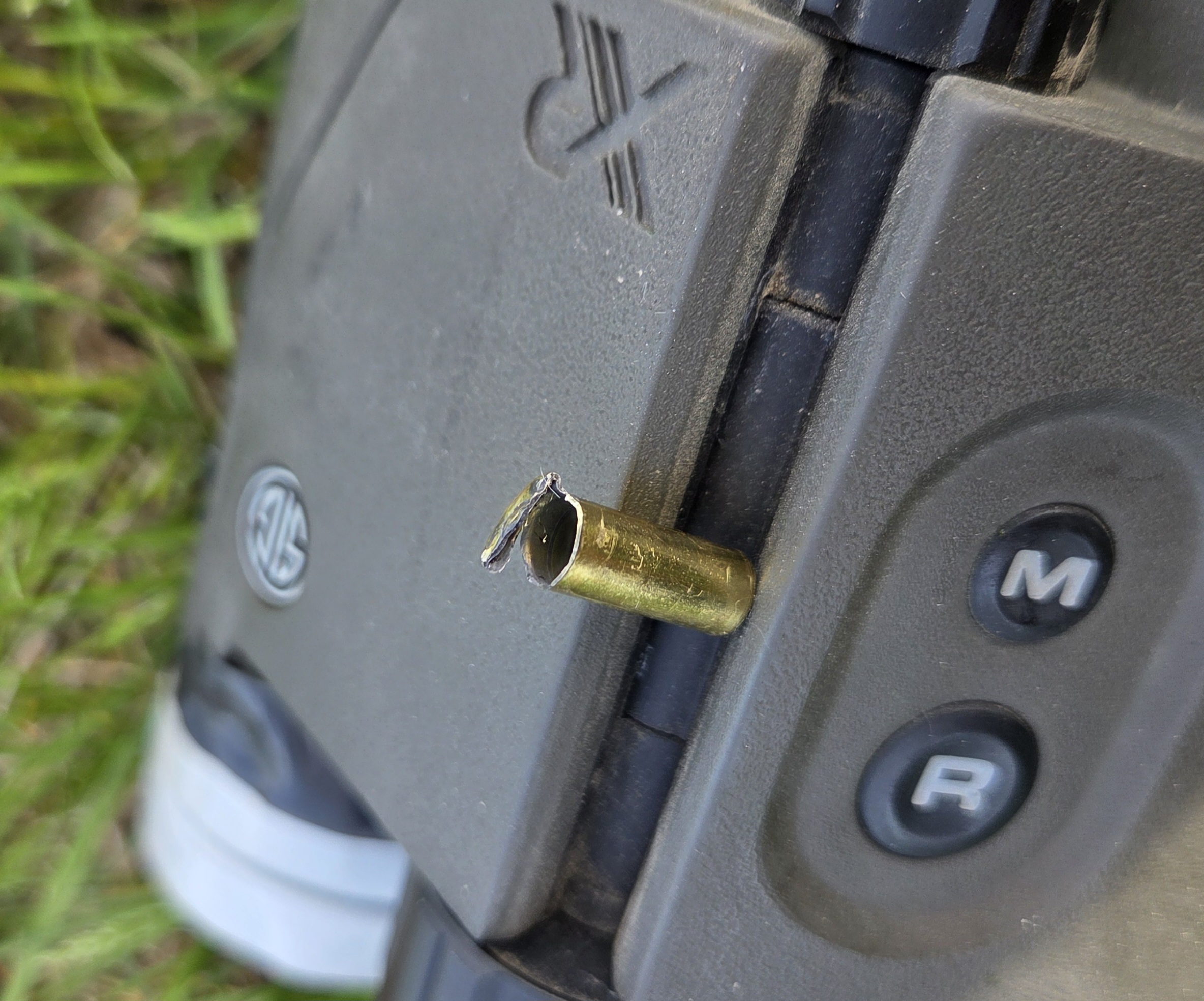

I was popping gophers with my T1X using CCI Standard ammo and after about fifty rounds I felt blast on my face and heard what I thought was glass breaking. I think the sound was the baseplate flying off the mag.

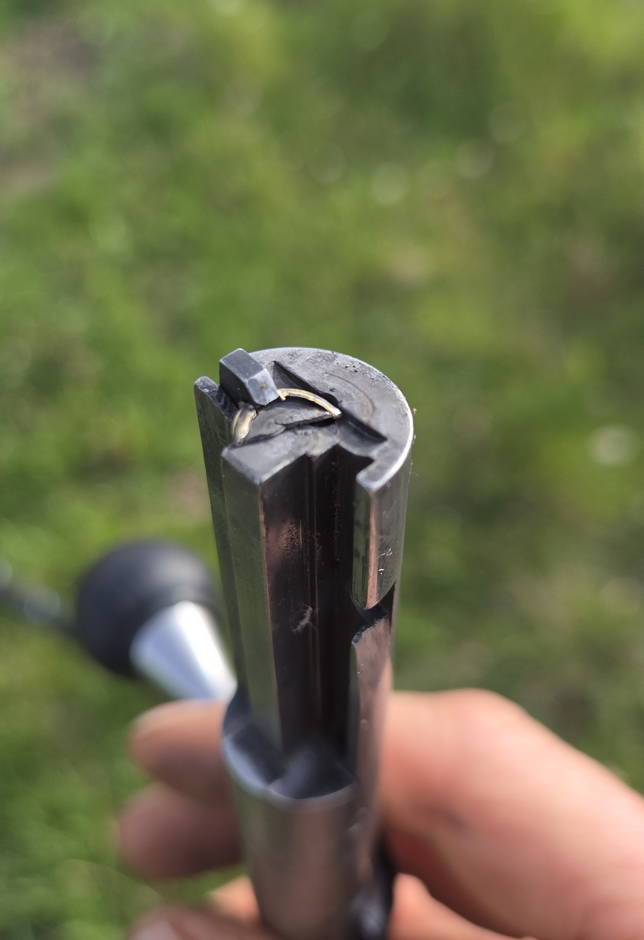

In the chamber I found a case with half the base tore off and stuck under the extractor. I pried it out with a knife.
Sorry the pictures aren't the best. Just wondering what causes/caused this? I have had a case rupture shooting reloaded 9mm years ago but never a .22 in the thousands on thousands of rounds I have fired.
Only real loss was I couldn't find the mag spring in the grass.

Squib and a follow up or two is my guess. Barrel was obstructed
I didn't remember the previous round lacking at all but I will admit between being focused on gophers, wearing earmuffs, and shooting subsonic .22s it could have.
If that is what happened the next round cleared the obstruction and I didn't think that was likely to happen but I am no expert.
My youngest daughters 22/45 had a squib about 3/4 of the way down the barrel. I’m sure the next round would have punched it out, but likely would have caused pressure issues. Too bad you didn’t look close to the muzzle on the ground to see if you had two slugs laying around, I doubt they would have gone far

Was the bolt closed or did it fire out of battery?
Well I had been shooting a lot that day so I can't swear to the exact details of that particular shot other than to say it happened when I pulled the trigger not before.
That said if I have a round chambered and am not shooting right away, glassing or the gophers are hidden or whatever, sometimes I lift the bolt handle as that is what is required at matches and I want to be consistent.
It is possible I pulled the trigger with the bolt handle lifted but the whole purpose of lifting the bolt handle is to prevent a problem from happening. I would not think the rifle was capable of firing out of battery.

Its a case failure. Thats it. Nothing more. It happens
Agree here. Also you felt that hot air on your face which is why I HIGHLY recommend any time you shoot wear eye protection every shooter every time. It drives me nuts seeing people shoot rifles without eye protection especially young shooters who should be mentored to do so. Things like this will happen if you shoot enough, plus things like bounce back off steel targets, rocks etc. you should only have to see one shooting related eye injury ( and I have seen at the range and treated professionally in medicine a good number of them) to make eye protection a 100% habit
Improper annealing of the case with maybe an over priming/double priming issue.
People forget priming mix is adjusted for the powder blend being used in a lot of ammunition with rimfire. So it's a variable as well.
