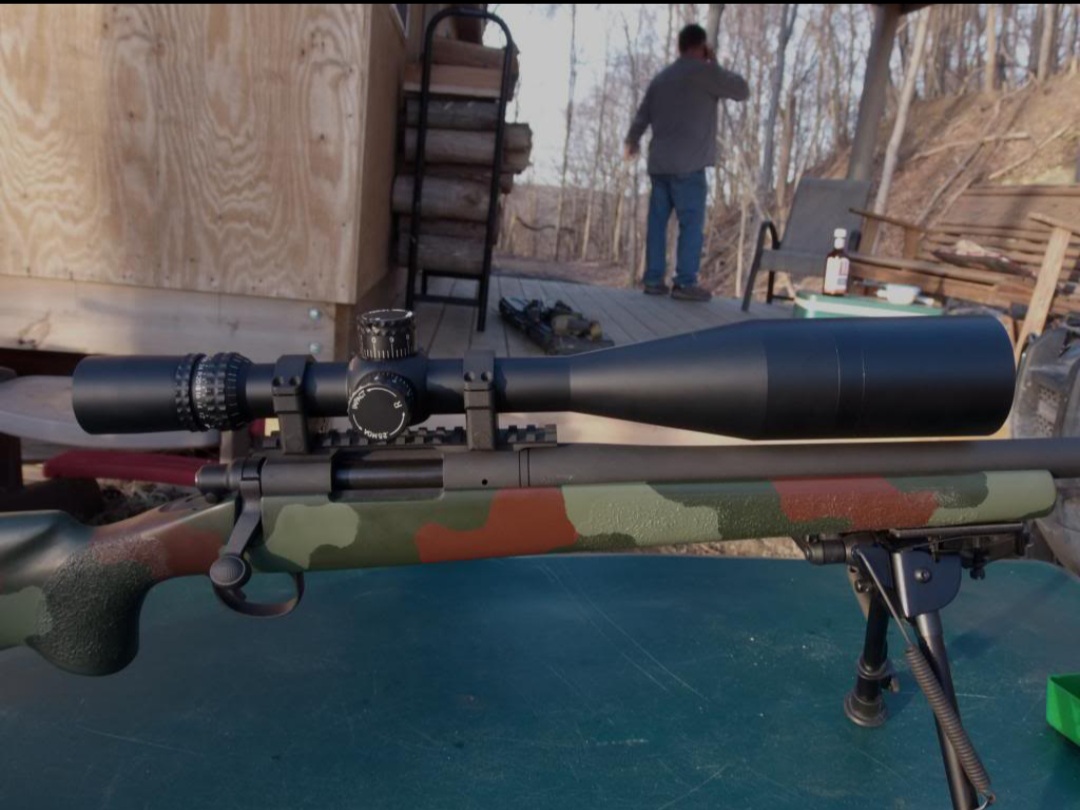

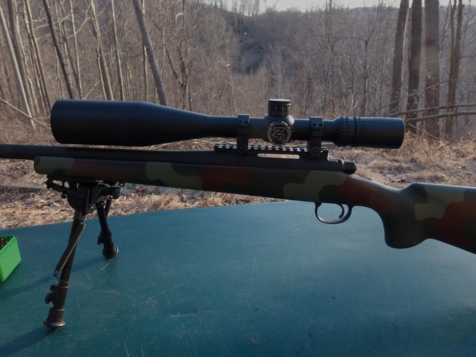

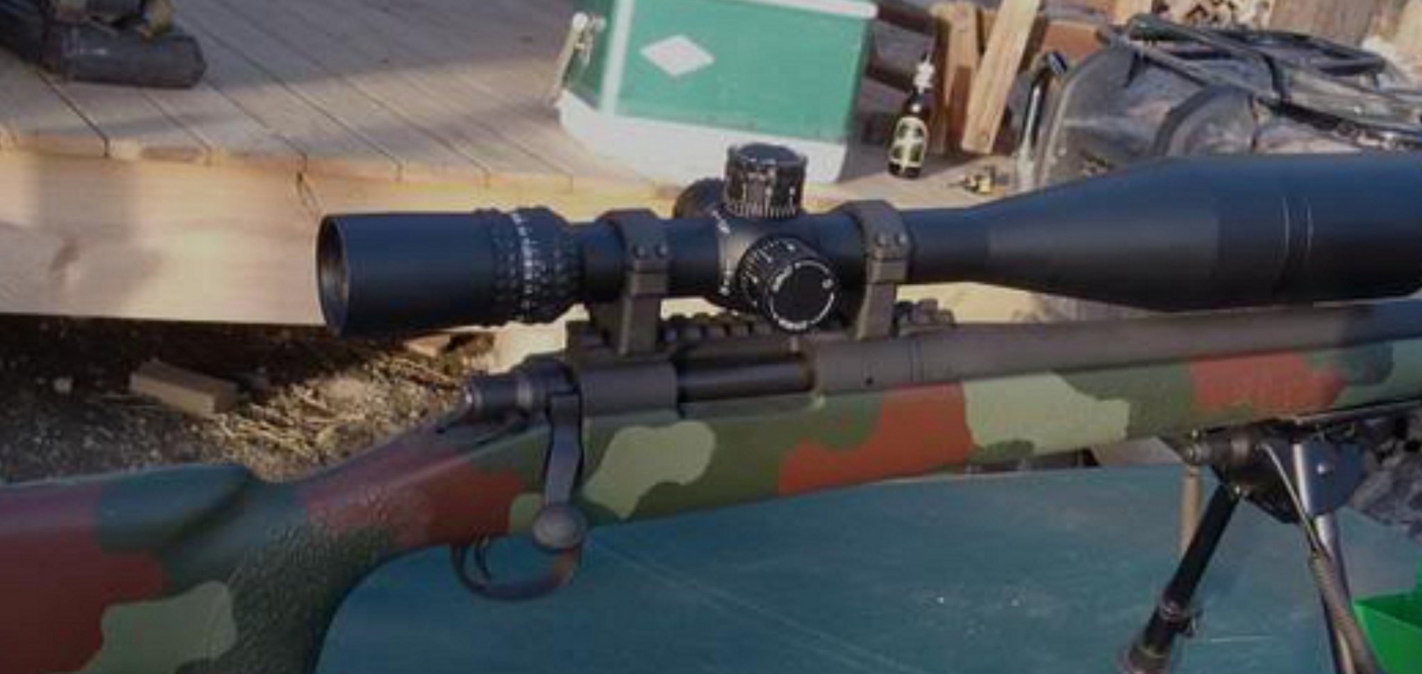

This rifle was a stock 700P barreled action in a McMillan stock with a 8-32x56 NXS with Badger rings. Anybody got an idea what height those rings are?
Based on length of bottom ring portion I'd say Ultra High. I have Highs and those look taller.
Reactions: winxp_man
Agreed. Leupold steel rings or aluminum are super high. The high don’t usually work with the 56mm objective lens scopes. All of this is a statement for 34mm rings.
