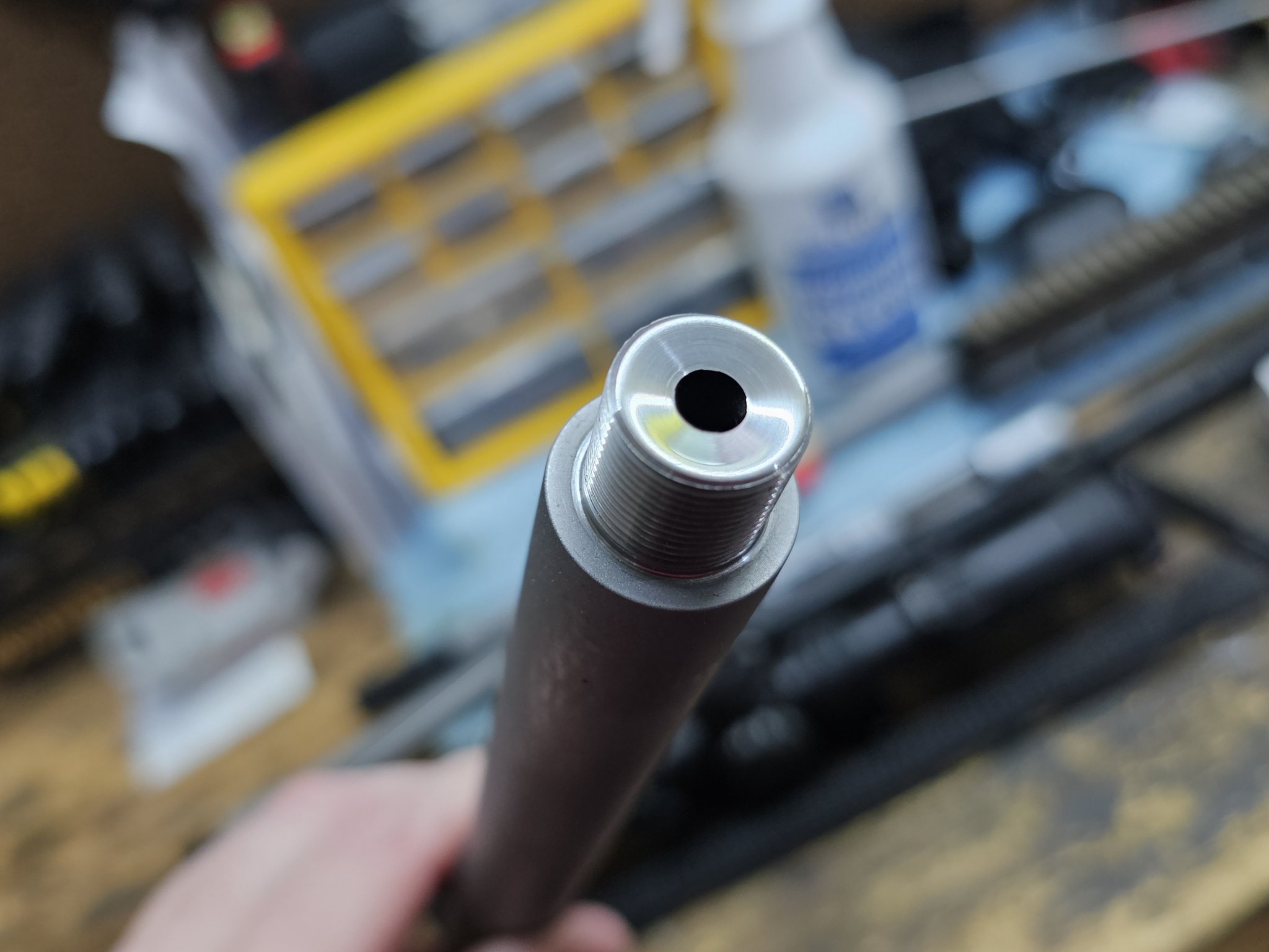

I did notice the gas port looked like there might be a burr, but I’m not sure. I know my Bartlein (1300 rounds) does not look like this.
Is the Bart drilled through a land or groove?
I also found that the handguard was touching the gas block, and I have since corrected that issue.
I’m going on the assumption that the issues were with the handguard touching the gas block and it will shoot better now. I’m going to do a “put out or get out” test with it the next time I’ve at the range.

The Bartlein was made by CLE and they centered the gas port in a groove and beveled the port. It was impressiv.

Yup, that's top notch. There isn't a consensus on the gas port placed in the groove, but it sure makes sense to me. Less protrusion to misshapen a jacket sure sounds like a winner to me.
Your gas port look pretty good compared to others though. Am I seeing some gas block misalignment with the hole? Some gas blocks require .025 from the barrel shoulder. I use a bore scope to align mine.

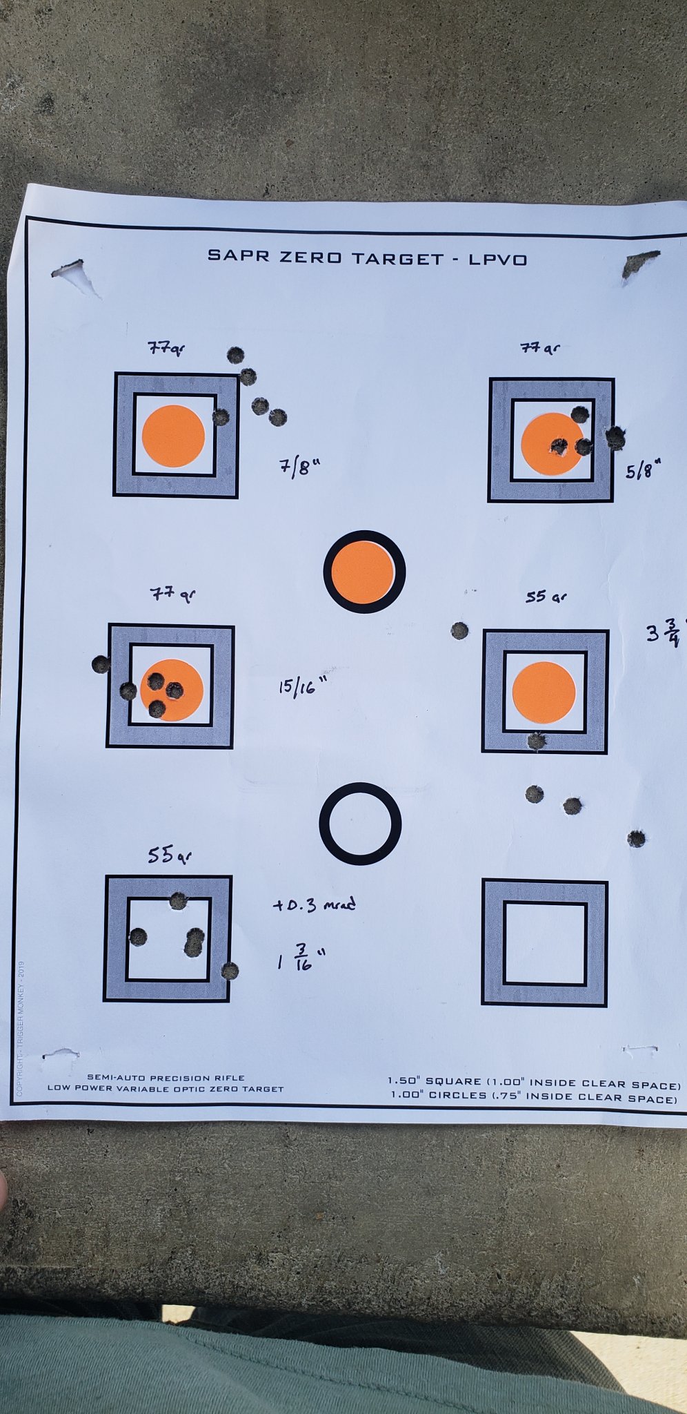

Not a 5×5 but just got one of my carbines zeroed at 100and the barrel did well. 16" WOA midlength shooting 77gr Razorcore using a NF 2.5-10X24, average for 15 rounds is about .82". The 55 gr is PMC ball ammo and did about how you'd expect at 100.

Mine hasn't been particularly impressive but recently has seemed to improve a little bit. 77s with 22.6gr AR comp.
I would like to see a little better but have only tried a couple powder charges and not messed with seating depth.

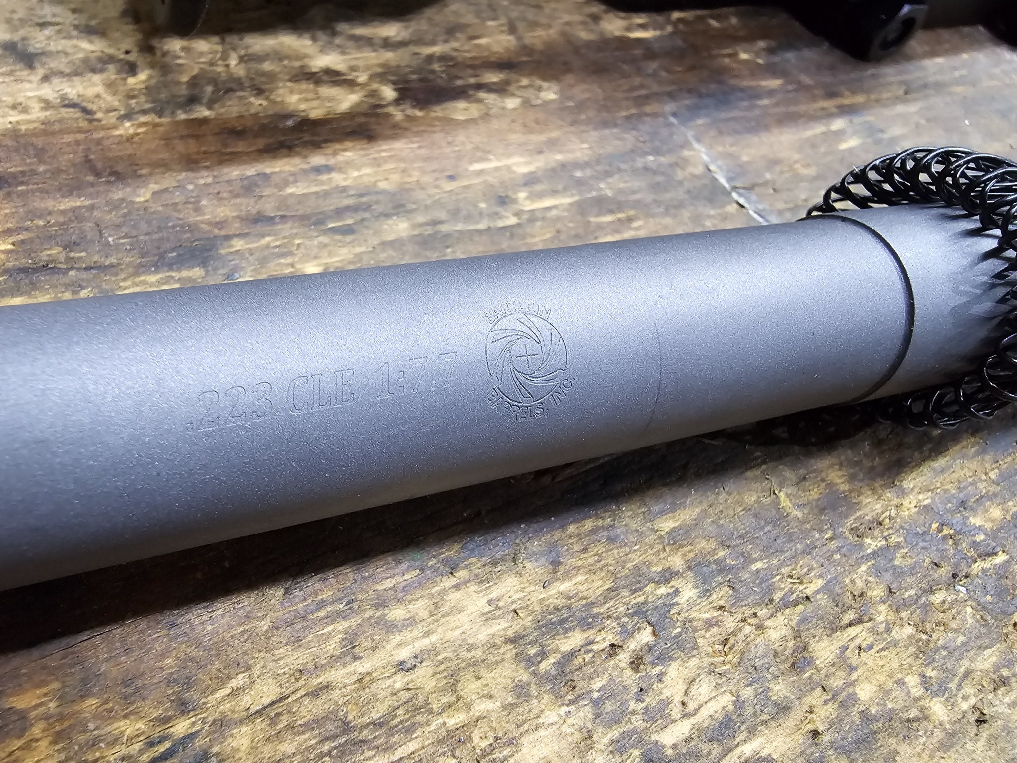

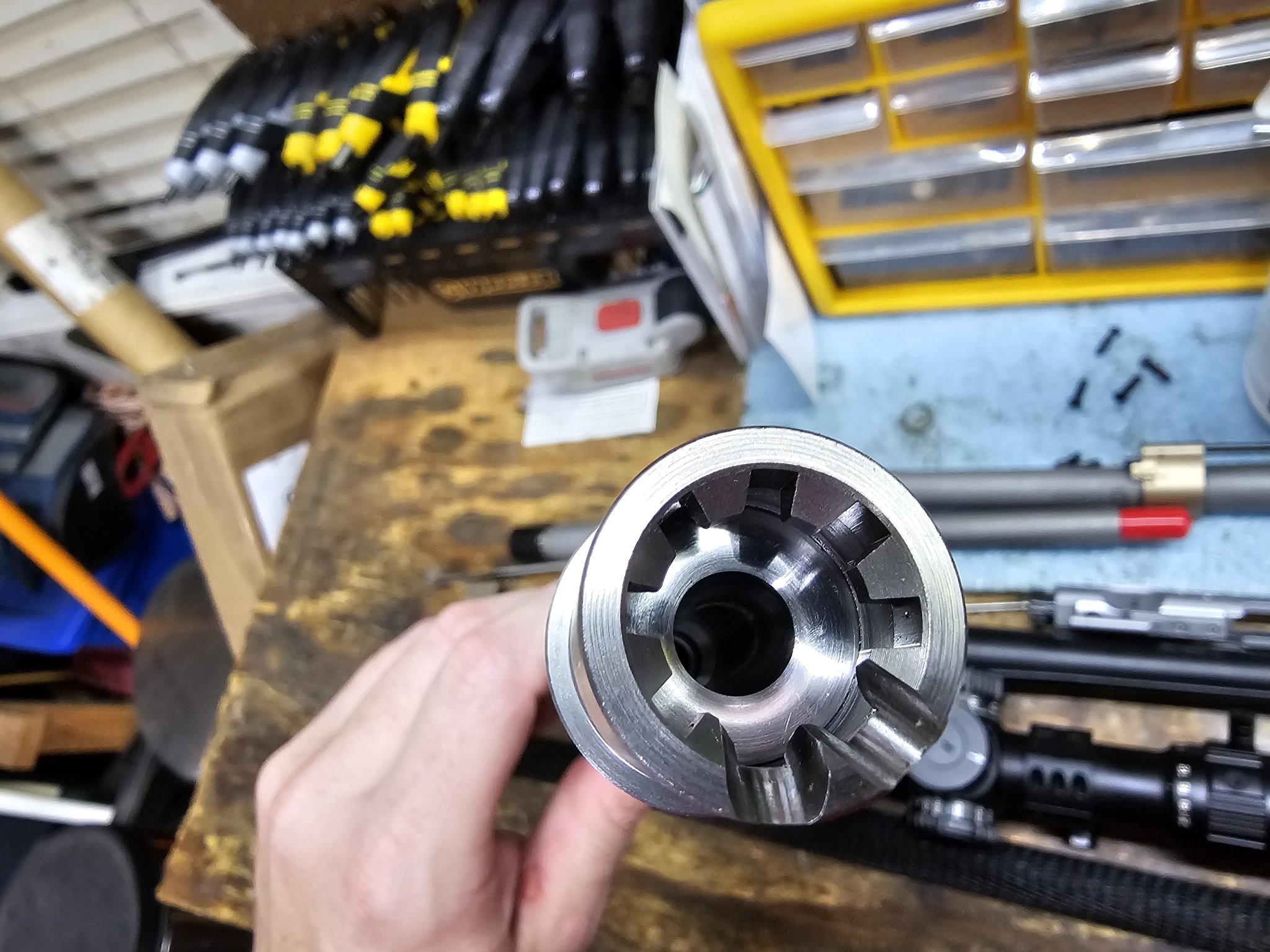

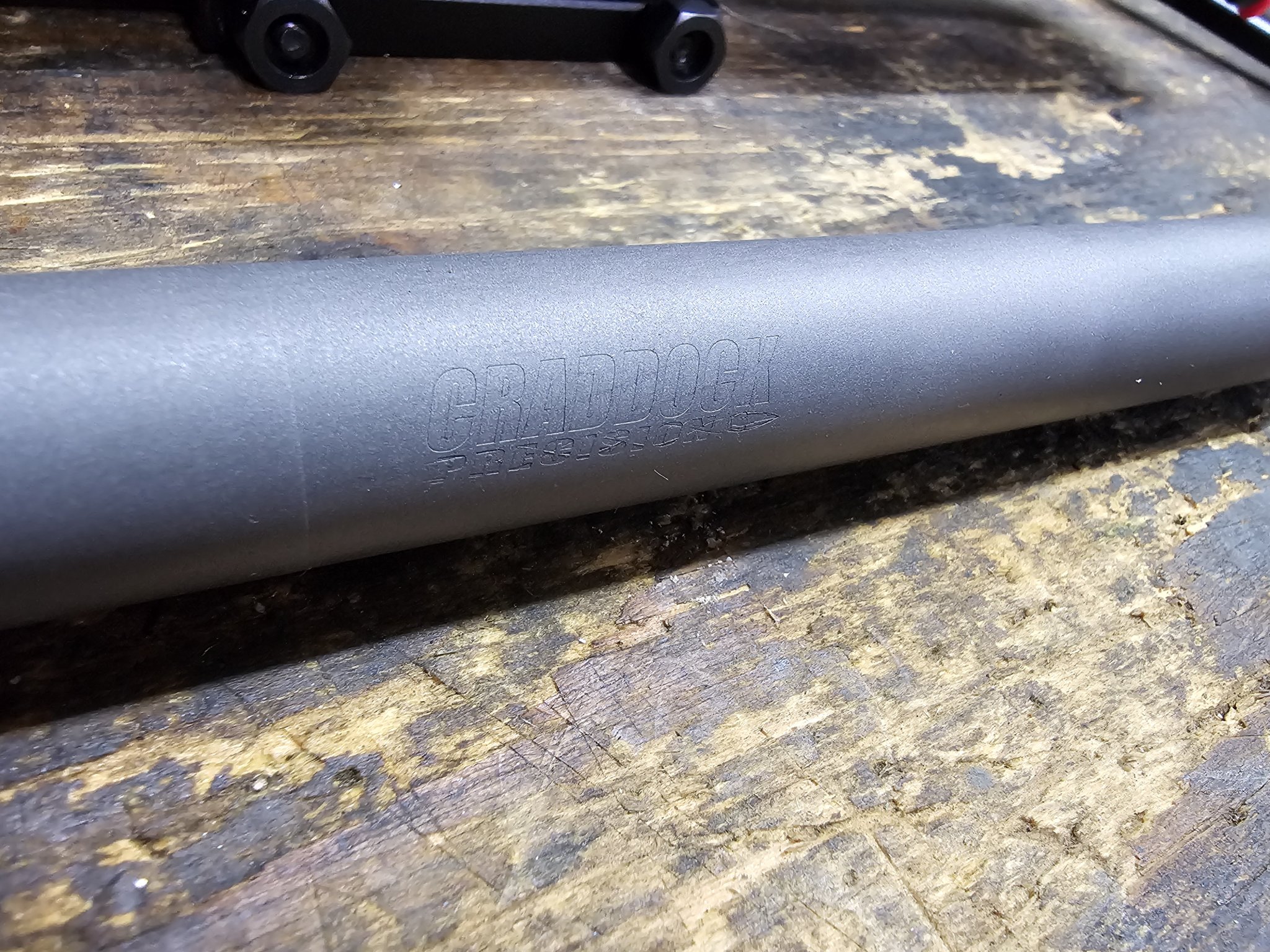

Paul Craddock of Craddock Precision also offers the CLE chamber. I just received a 20" Bartlein Chrome Moly 1-7.7 Twist with the CLE chamber.
He's talking about John Hollinger of White Oak, and yes he will do a CLE Chamber in his Kreiger and Bartlein blanks.
Frank White of CLE hasn't turned any barrels in a few years.
Paul Craddock of Craddock Precision also offers the CLE chamber. I just received a 20" Bartlein Crome Moly 1-7.7 Twist with the CLE chamber.

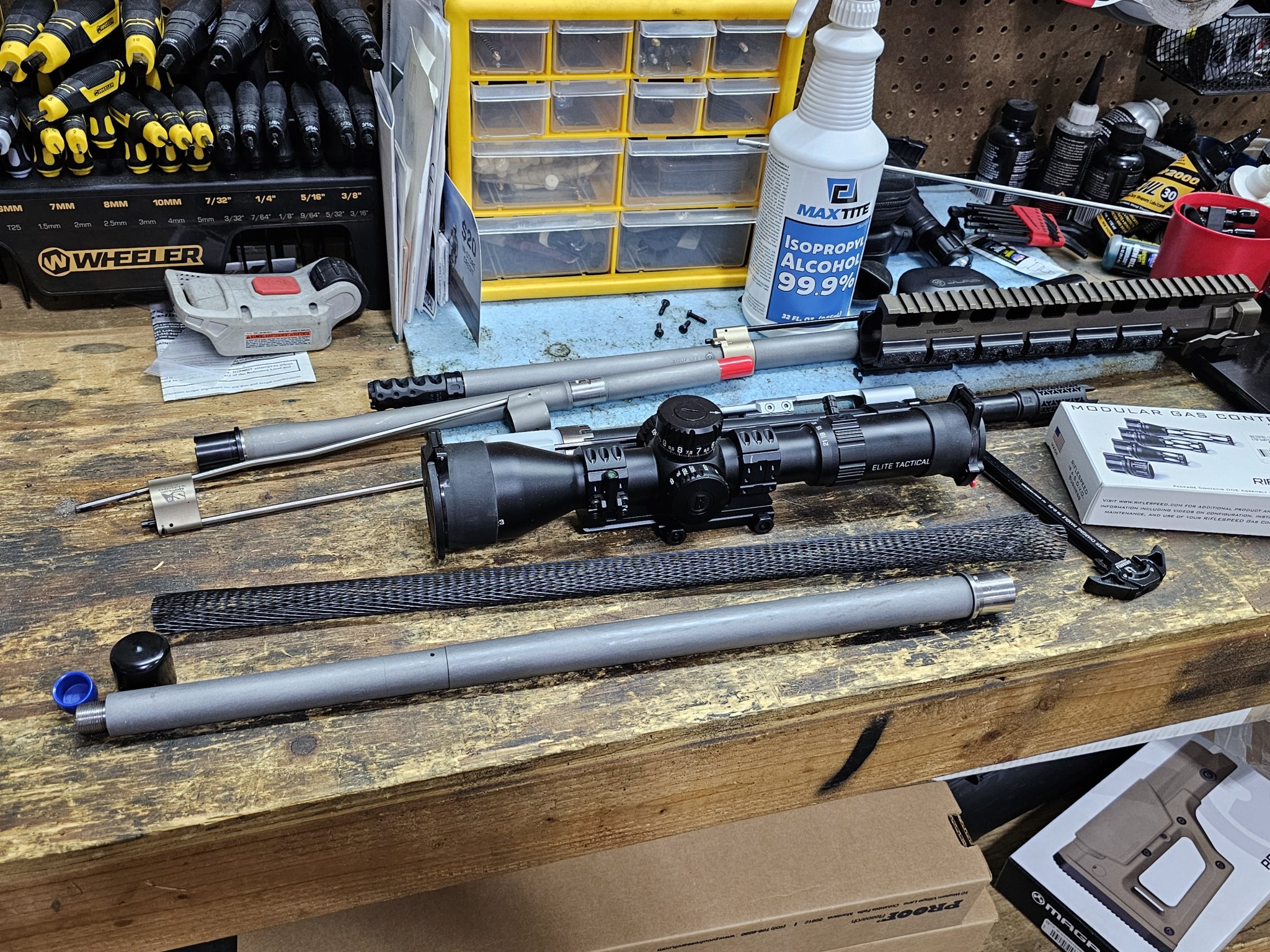

View attachment 8478839View attachment 8478840View attachment 8478841View attachment 8478842View attachment 8478843
They do CLE in their house blanks too. Had them do it many times. Also, Paul makes wonderful stuff and is a stand up guy.
Reactions: stanley_white
How does it shoot?
I haven't shot it yet, but it's a Craddock Bartlein sooooo im sure it will perform.
The barrel still needs to go to Cryo and cerakote. The Chrome Moly Bartlein is going to be a Data Collection and Comparison Barrel for the effectiveness of Cryo, SS Vs CM. The foundation that both barrels will be tested on will be the JP SCI-20.
I had mentioned in another thread that I would be willing conduct a POI shift test utilizing the JP SCI-20 Semi-Monolithic Upper and Handguard so this will be a "Three Birds one Stone" Evaluation also incorporating the Precision Armament Hypertap Muzzle Brake.
