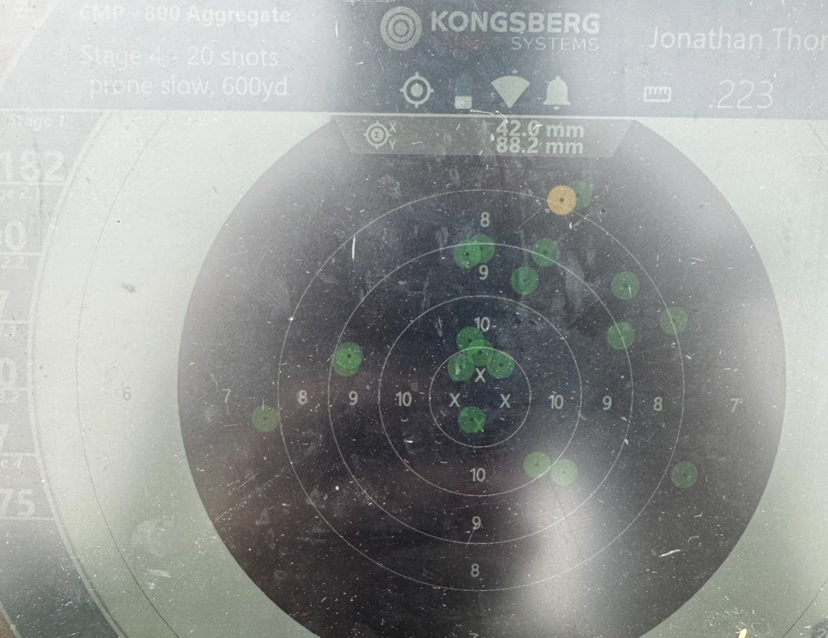

This was in a Krieger 7.7 Twist with a CLE chamber from CLE. Based on my experience it really liked mk262 and hated our team 80smk white box. I even had some problems with 80.5s, but a lot less than the 80 SMKs.

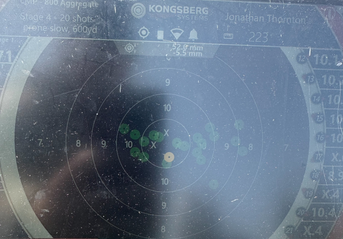

First picture is with 80s and that barrel on the 600 yard line and second picture is 600 yard line with mk262; both at Camp Perry last year. My barrel would shotgun 80s at 600. Now I run a modified Wylde chamber that has a different lead angle among a few other things.

My son had similar problems with a few other premium barrels from decent 'smiths until we talked about it in some detail. He lost a boat-load of primers and was blaming his ammo before we brain-stormed and trouble-shot.
I was loading his 80s and 80.5s to USAMU 5.56 length (2.500" COAL) and his barrels were set for Wylde and CLE throats (around 2.445" - 2.450" with sharper leade ange). Knowing that I reamed the Wylde and CLE with Ned Christiansen's 5.56 throating reamer, which seems to have fixed the problem.
Your second photo shows me you must have great hold and consistency because your MK262 group has excellent height (sub X-ring high) but you're getting blown from outside 10 on the left to inside 8 on the right. You seem to be missing left-to-right winds with pick-ups and the 77s are getting pushed around a bit.
Your MK262 performance shows why 77s and the CLE chamber are the preferred combo for rapid-fire Rattle Battle.

Yup! All on me for missing pick-ups/wind angle change. 77’s can easily clean targets at all the yard lines, you just really have to be on top of the wind at 600 in comparison to the 80/80.5s . Holding for prone hasn’t been a weakness of mine, usually I forget to check a condition when I zone out or lose patience waiting for my condition to come back. The team is now moving everyone to Nez’s “223 Eldridge” chamber which has been pretty successful for the team so far.
I knew that year going into Perry that 80s didn’t work in my barrel well, but I needed to prove so to team leadership. When I shot the first day of the CMP cup I knew “this isn’t me” and tested the mk262 on day 2. My current barrel is a mullerwork 1:7 with that modified Wylde 223 Eldridge.
