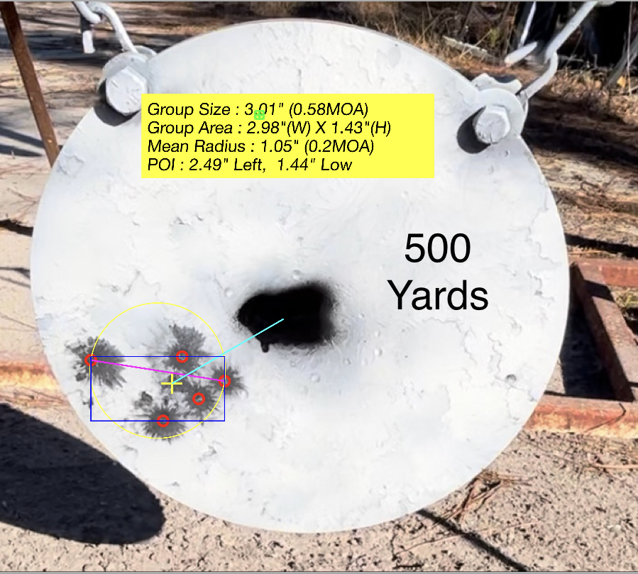

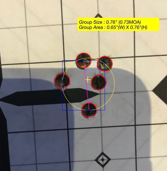

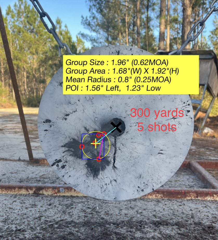

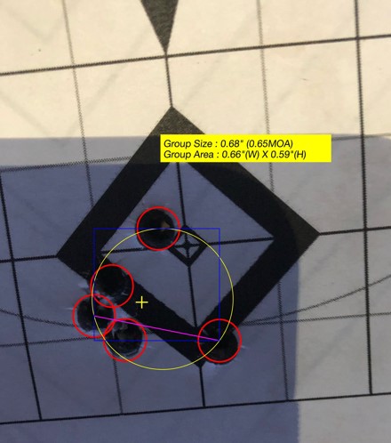

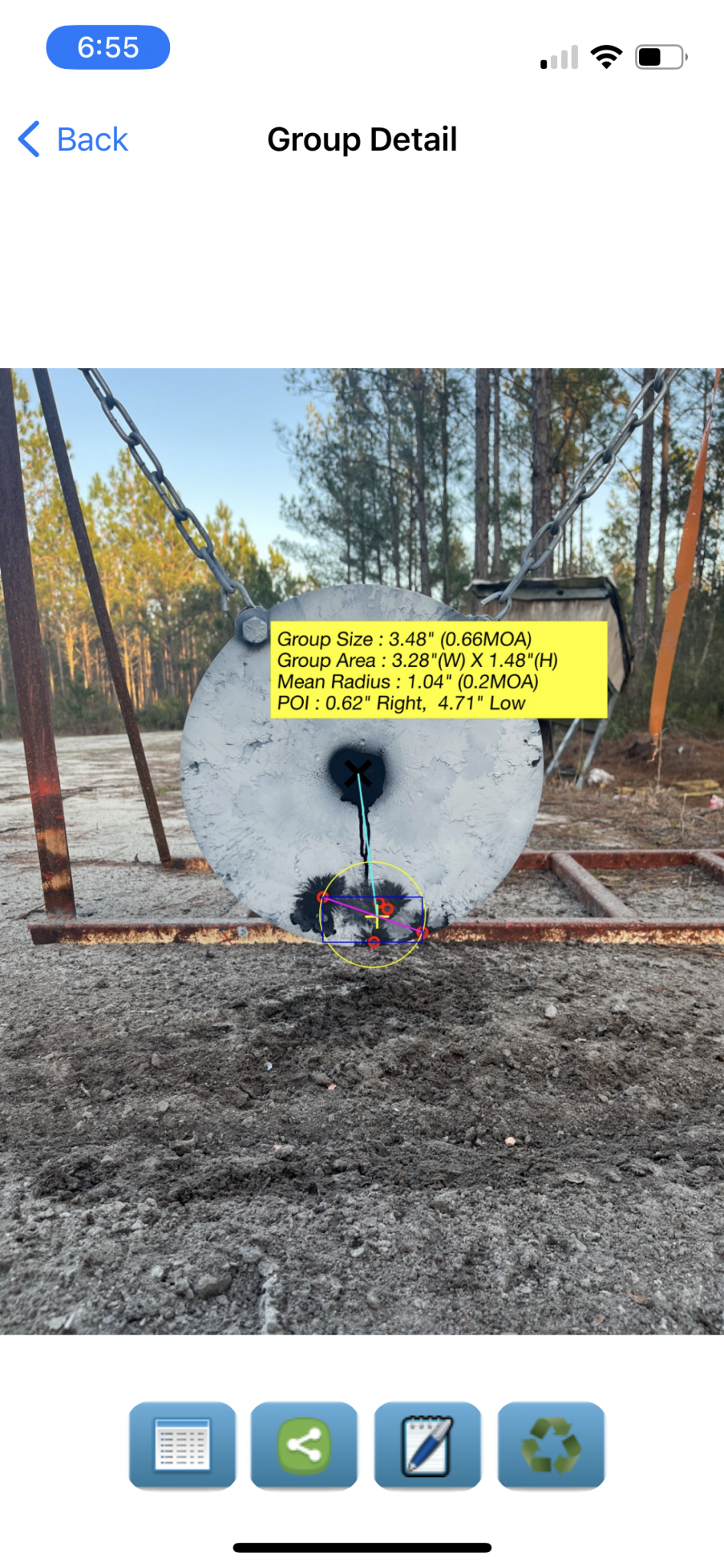

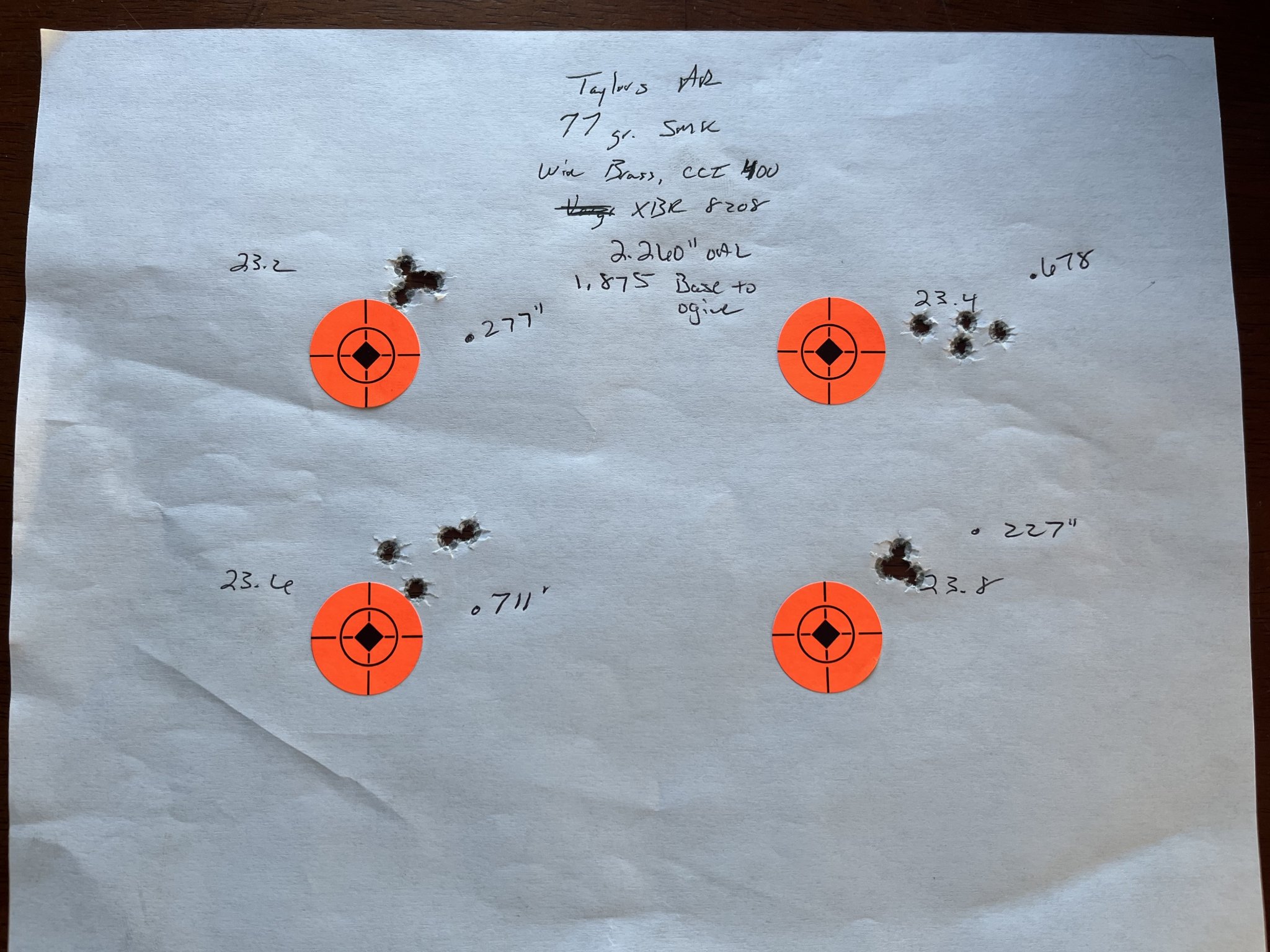

24"WOA with 77smk@2880fps/ramshot tac/starline brass/cci 450s . Minimal load development

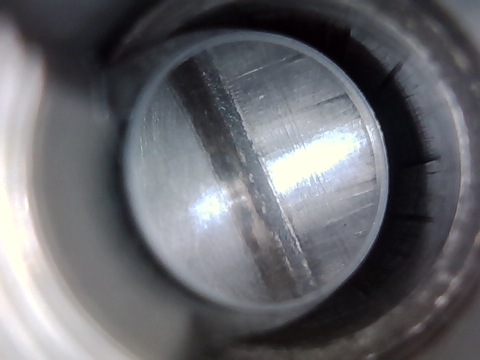

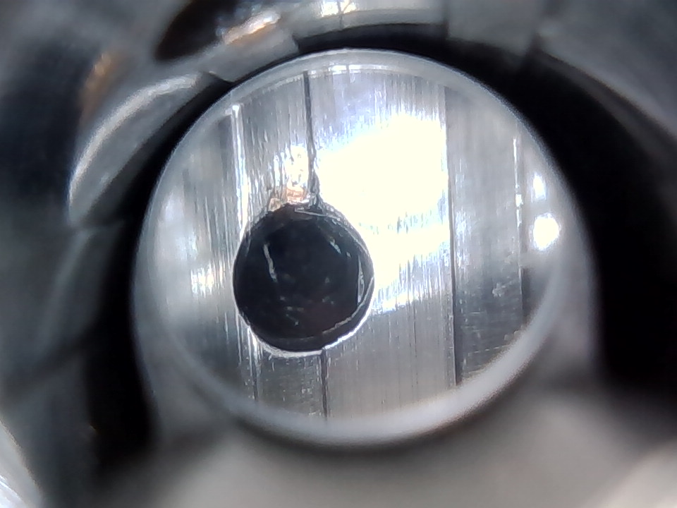

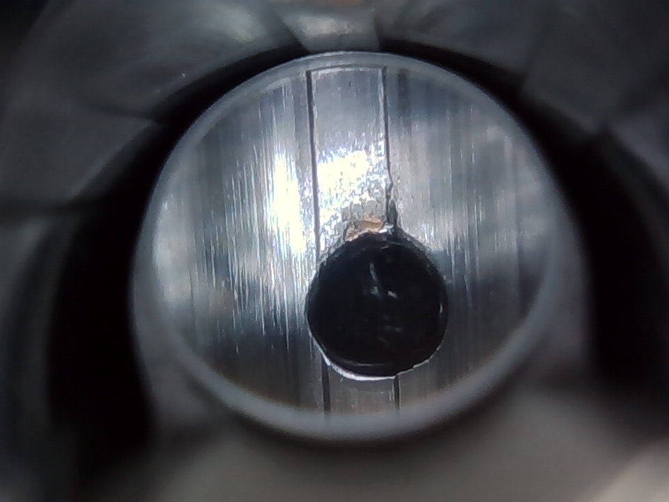

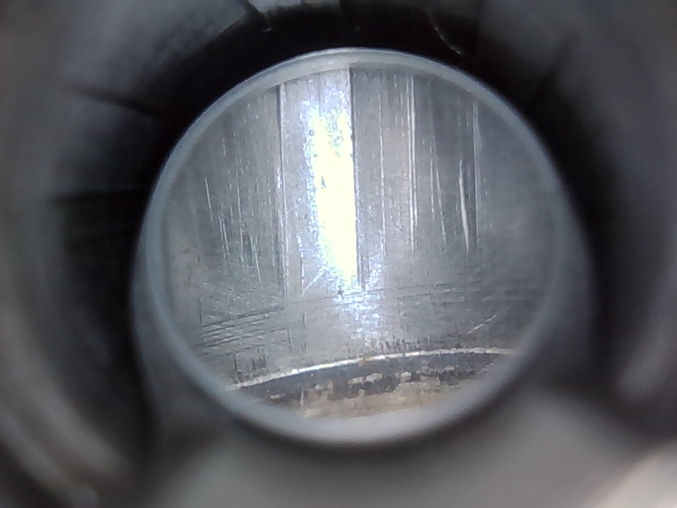

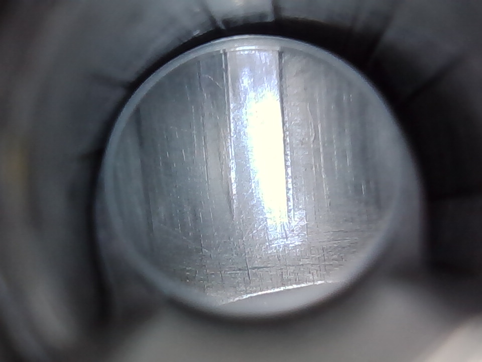

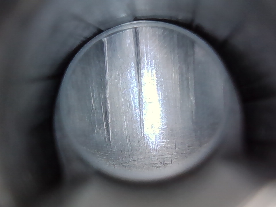

This picture shows some rough marks in the throat…. I think.
WOA. You get a Wilson blank cut without lapping. You will need a Tubbs final finish kit to get it shooting sub MOA. I would buy 10 barrel batches from WOA. Shooting 77gr SMK 2700fps in 16" uppers, I would get MOA before shipping the uppers. That was my warranty. Switched to Faxon as a barrel supplier. 4150CMV shooting .25-.5 MOA same ammo. Just noticeable difference in accuracy across the board.
With that being said. Faxon are some pricks that I can't get in contact with as a dealer on the phone, email, fucking smoke signals. WOA, Jane answers every time.

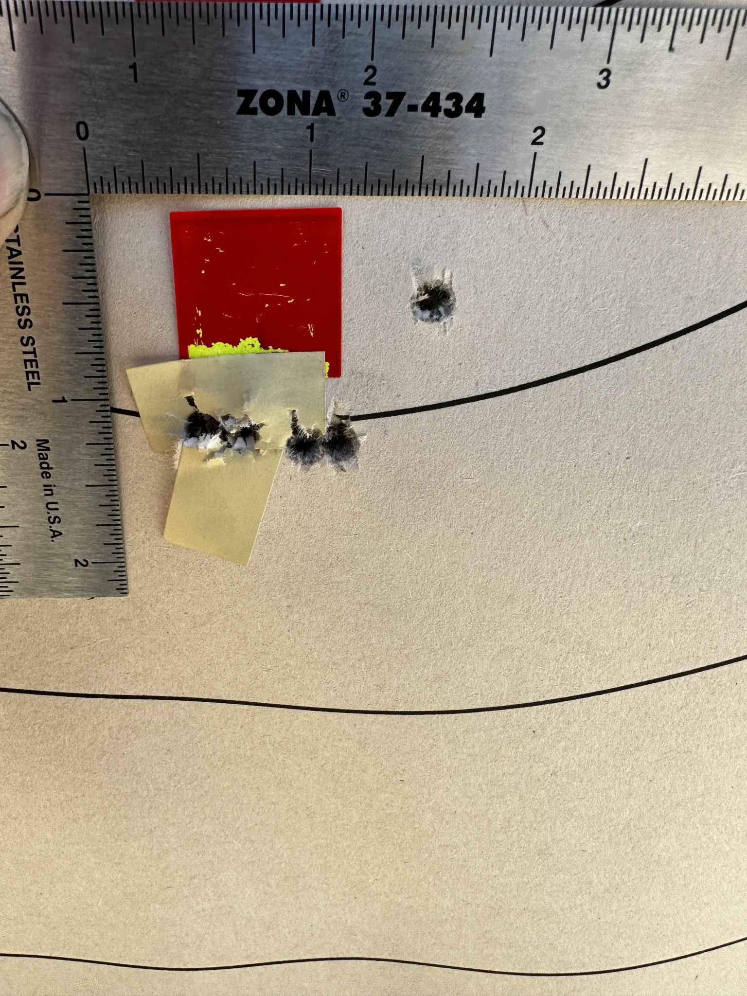

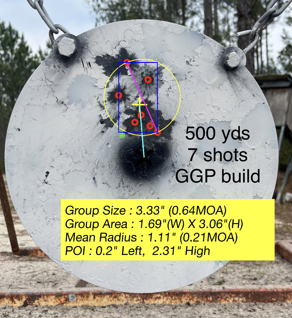

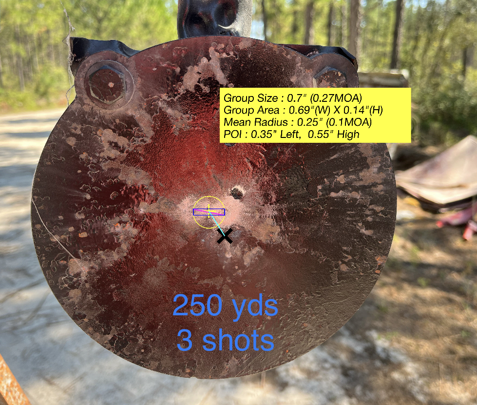

I don’t think that I’ve posted a target on the hide previously & full disclosure I’m not a competitor or anything like it. I’m slowly working on both my skills at the reloading bench and the shooting bench for precision. That being said this is from last week out of a WOA barrel, 2x fired LAke City , Ram Tac powder & 69 SMK at 100 yard doing a seating depth test.
Yeah this was the best of the 10 I tested that day but it is indicative of the results I’ve seen with WOA - I’m sure the barrels can perform & perform better….

Looks like those concentric rings might be giving you problems. Does the barrel copper badly?
I haven’t noticed it coppering much, but then again, I’ve only got about 200 rounds through it.
I did notice the gas port looked like there might be a burr, but I’m not sure. I know my Bartlein (1300 rounds) does not look like this.
I also found that the handguard was touching the gas block, and I have since corrected that issue.
I’m going on the assumption that the issues were with the handguard touching the gas block and it will shoot better now. I’m going to do a “put out or get out” test with it the next time I’ve at the range.
