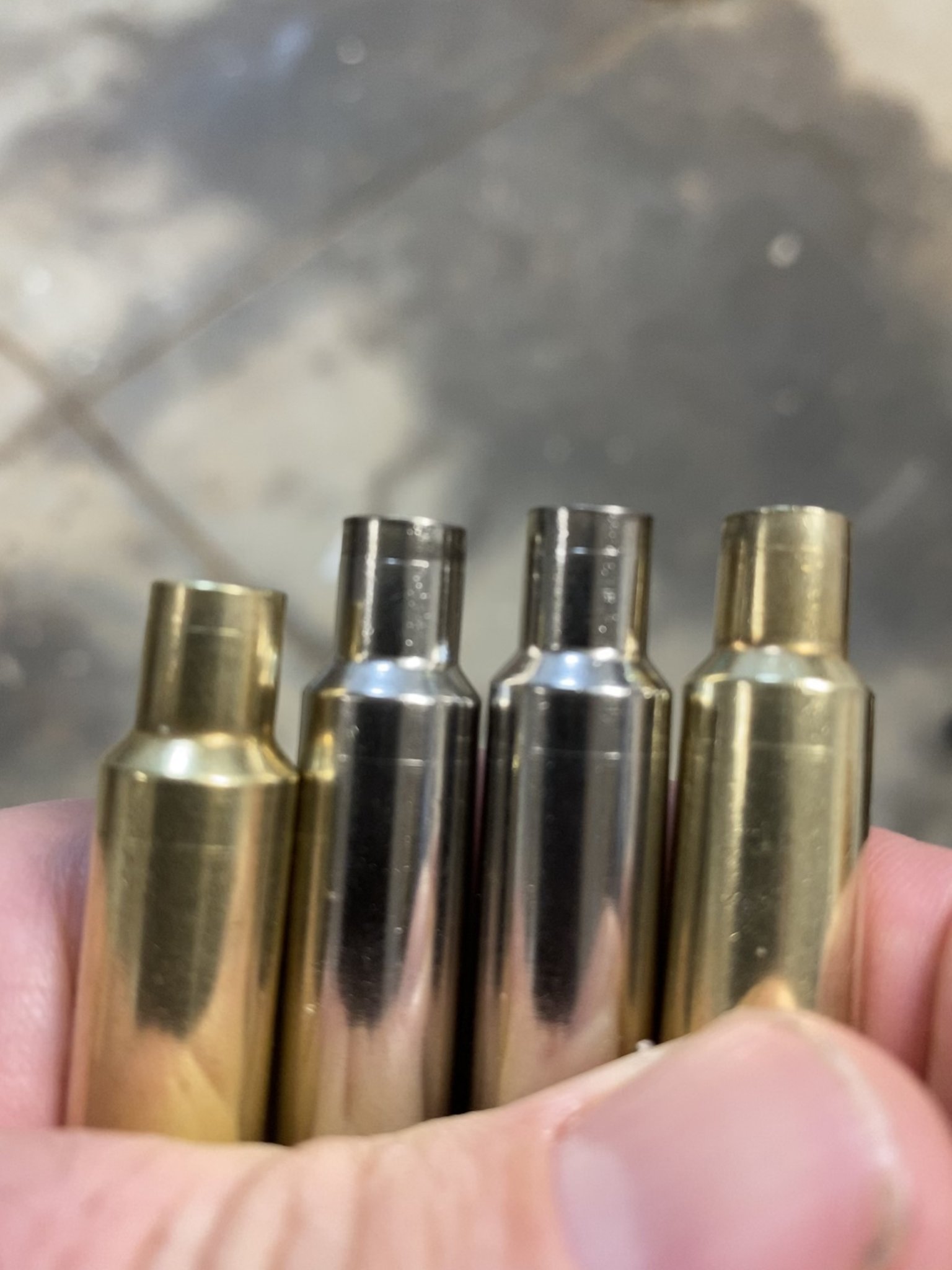

    I too had one with a bad chamber, was having two rings on the brass after firing on the neck and a little down past the shoulder. They replaced and the replacement hasn’t had any issues. View attachment 7692618
    I had a barrel recently chambered by gunsmith and have the same ring below the shoulder as you. He said he would chamber a new barrel at his cost. I said no. I will have barrel re-chambered by a gunsmith that does great work. Do you know what caused the case rings?

    I would guess a chip got stuck on the cutting edge of the reamer. I have only chambered about 10 barrels so I would not consider myself to be an expert maybe a knowledgeable rookie, my barrels out shoot me so I am happy with my results and I have no rings like that.

    No only the ring but all fired cases were about .004 larger in diameter that the SAAMI chamber specs. My fired cases would not even fit in my full length sizing die.
