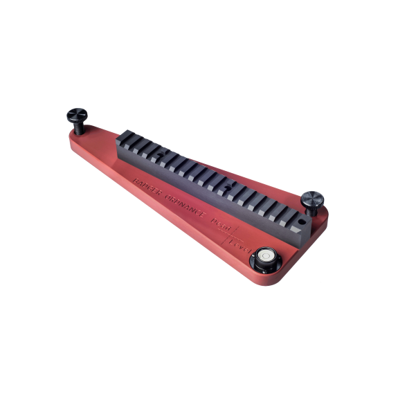

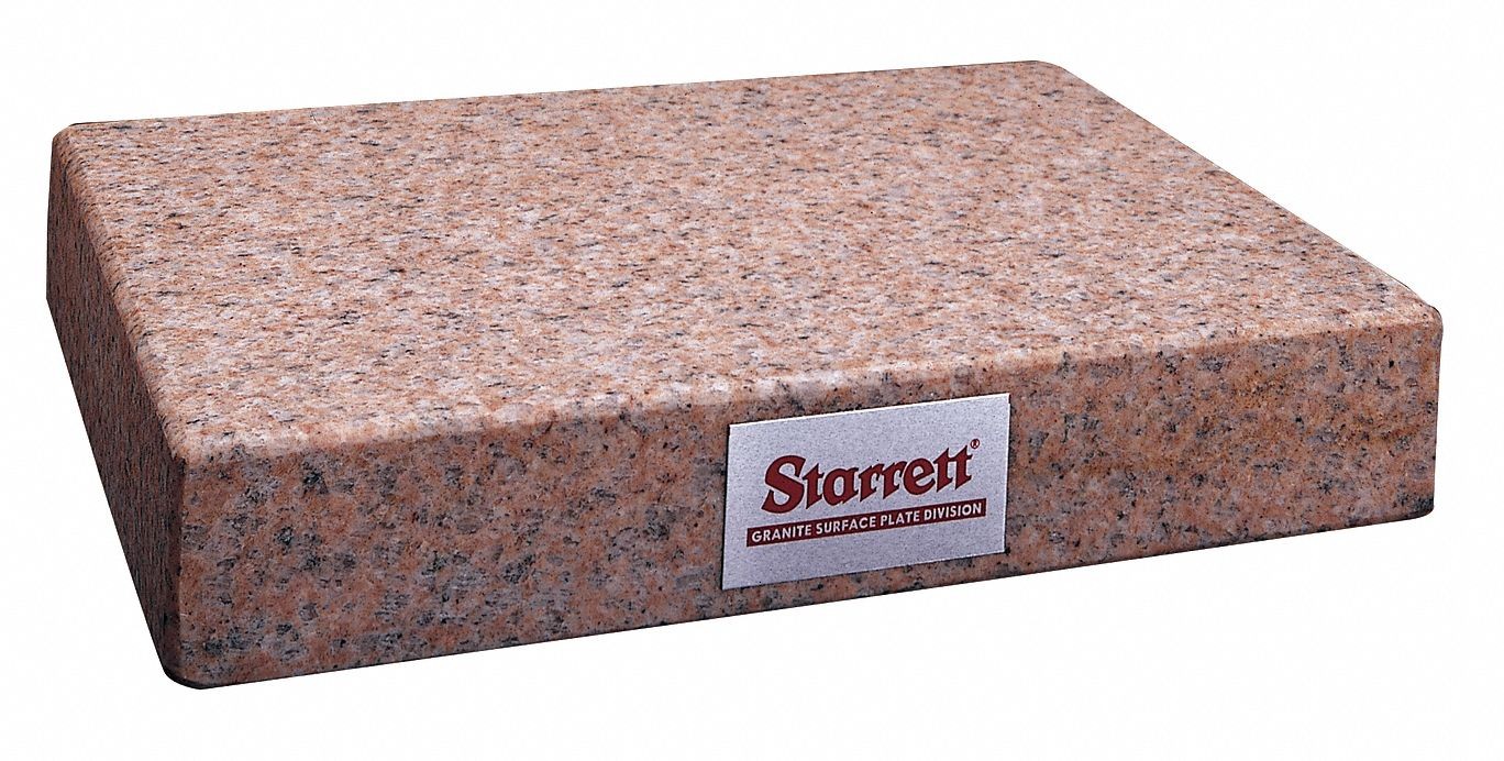

Why isn't it common practice to put the ring/mount setup on a known, flat surface then just install and level the scope in the mount/ring setup? Short of some major mfg defects, the pic rail on the gun will be absurdly flat.

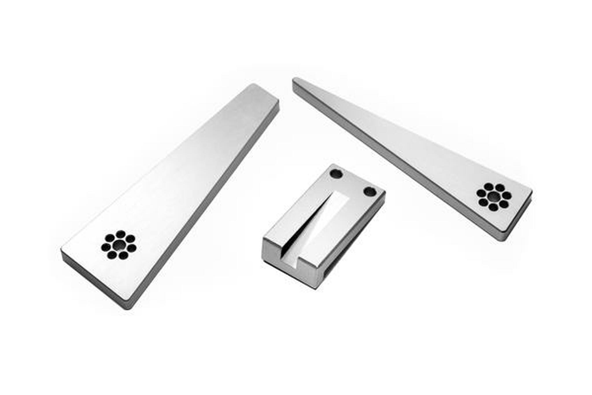

Badger Ordnance sells a Dead Level device for mounting scopes in rings off the rifle. I use all the time with great success.
DEAD LEVEL​
200-50
The Dead Level levels your reticle in relation to the Earth taking out any margin of error of the reticle not being perfectly level with the scope body. Simply attach your scope to the Dead Level, level the device with the precision thumbscrews to center up the bulls-eye level, then just level the reticle with a predetermined level line or plumb bob. Aluminum Mil. Spec. Anodized Hard Coat Type III, crimson and black. Instructions included.
FOR USE WITH MIL STD 1913 COMPLIANT RINGS AND MOUNTS
Reactions: HenryTheAce

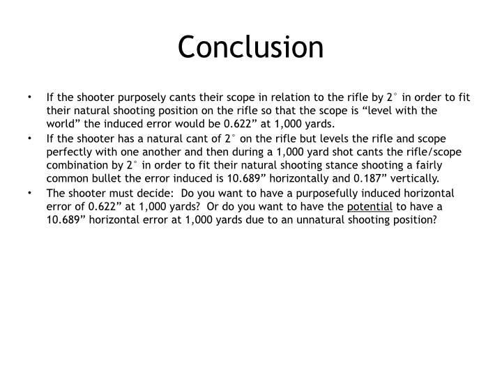

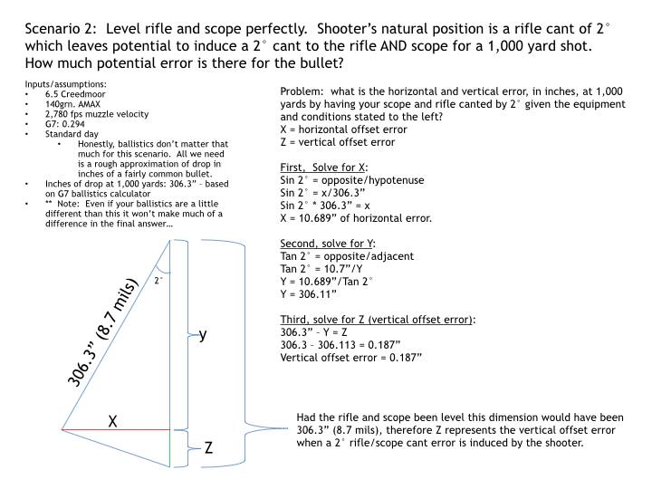

“Level the rifle”....how many times do we hear that, when it has no bearing whatsoever. The reticle when firing is the only thing that needs to be level/plumb.
I'm confused (not surprising :)) If you don't level the rifle, how do you know when the bore and the vertical crosshair are in the same vertical plane?

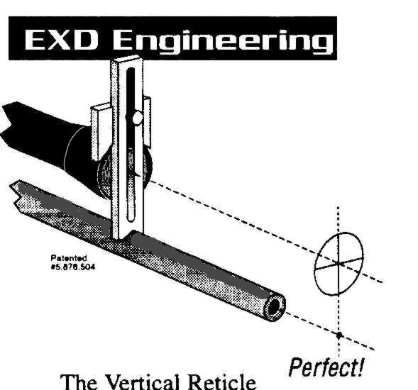

About the vertical plane thing: you could use the EXD tool from Brownells. See it below. I have one, it works, but the assumption one makes is the bore is concentric with the outer surface of the barrel, which I hear is not a sure thing. Plus it probably doesn’t matter, results-wise for most of us.

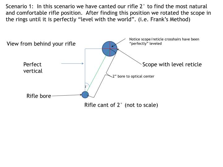

After reading about this mind-numbing topic a bit and taking in some of Frank’s online training, I finally stopped worrying much and just slap the scope on my gun, slap the gun on my tripod, get the gun eyeball leveled, then level the reticle with said neighbor’s garage corner and call it good. Lots of slapping.
I’m way happier as a result, and it hasn’t seemed to change my results. I’m not a PRS shooter, though.
Because it doesn’t have much of an effect if the rifle is slightly canted. In order for the rifle to fit your shoulder it might need to be canted a bit. Now, when we say rifle, we mean rifle. We adjust the rifle to fit the shooter, then level the scope to the shooters position, not the rifle. As long as you are shooting with the scope level you will be just fine. As seen in this demonstration
I level the vertical axis of the rifle...that is, level the rifle to gravity....and then level reticle to gravity which will align the two.
But there seems to be a valid school of thought that this is wasted energy, that for many shooters the gun is NOT level to gravity when mounted and in position, and therefore all you need to do is ensure that the reticle is level and over the center of bore....and I assume that this works only with fairly small angular differences between reticle and vertical axis of the rifle (which will also the vertical axis of the erector and if the angular difference is very much you will shoot low and to one side or the other, right?).

The precision happens when you level the reticle before you fire the rifle. Where it is when you lock it down is irrelevant. Set your rifle up to you and level the reticle to the earth. Then make sure it’s level when you engage a target and you’re fine.

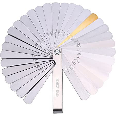

Just set up another scope today using feeler gauges. A very quick and easy process!
You still don't get it. The rifle needs to fit the shooter, this could induce a slight cant. Then you adjust the reticle to be level.
Feeler gauges just get you the scope body parallel aligned to the scope rail.

The rifle doesn’t have to be level for good fundamentals. I’d say the rifle probably needs to NOT be level for perfect fundamentals unless you have a perfectly vertical shoulder pocket. I’ve never measured exactly how much but all of my rifles are canted toward my head a pretty good bit. Try it and if you do everything else right you’ll find it’s much more natural. Not only does it fit the shoulder pocket better but it also moves the scope toward your face which means less head tilt is needed. This is a classic misconception that gets hashed out 3 times a month on here because it seems like the rifle would need to be level. It doesn’t need to be level. As long as the reticle is level(plumb is a better description) you’ll be dialing straight up when you add elevation. That’s the part that matters.

That's not what is being discussed. The reticle needs to be brought up to the eye. Canting the rifle slight inboard reduces the amount you need to crane your neck towards the rifle and actually makes it easier to get square behind the rifle.
Canting the rifle (and knowing the dope to correct for the cant in the days of iron sights) is something highpower rifle competitors learn how to do early on.

Yes, it most definitely is. The rifle gets canted in prone and sitting as well. You shoot the rifle that way and adjust the sights till impacts are at POA then write that down in the logbook since the sights can't normally be leveled to the horizon like a scope can be.

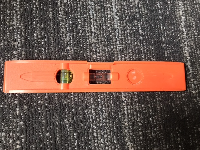

I take my little orange level and level the rifle, then level the scope as it’s mounted and then level the scope mounted level and then shoot my rifle. Never an issue with cant. I think I have to make it more complicated so it works into this conversation. Lol

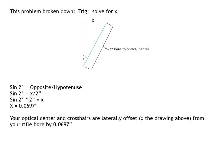

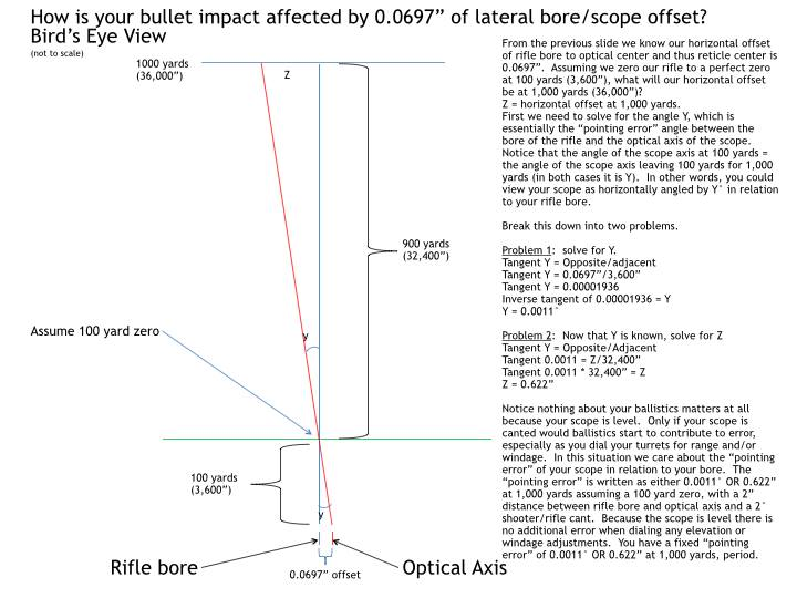

Please explain
Anytime you add slope to a rail or mount, you no longer have the bore of the rifle, and the scope in parallel. If you induce cant to the equation, then you have the bullets flight path travelling at an angle (azimuth plane) away from your target.
Maybe your little orange level matches you natural poa ? My levels don't, took me quite some time to understand. Now they are all somewhere in a drawer and my shooting improved.
You win Einstein, but I'll still use my string and weight ;)
Did you seriously just suggest you had a BUBBLE level accurate enough to detect manufacturing variations in a pic rail?
I'm sorry, but if indeed there were some discrepancies, a bubble level ain't finding them unless the piece in question has been beaten with a sledge hammer.

Maybe your little orange level matches you natural poi ? My levels don't, took me quite some time to understand. Now they are all somewhere in a drawer and my shooting improved.
Lol well I guess my natural poa is level.
How canted the rifle needs to be to comfortably fit MY "natural point of aim" tends to be a little different in difference circumstances. Prone tends to be a little different than sitting, kneeling, off a tripod or when shooting from sloped ground on a mountainside. I don't have a public range nearby, so do all of my shooting up in the North Cascades.
So, I just split the difference and level the bottom of the scope body to the pic rail. I don't give a shit if it's not perfect. The magnitude of any error due to a fractional degree of cant, is usually alot less than the accuracy of my wind calls and range estimation anyway.
Perhaps some shoot to such a higher level of precision that it needs to be perfect, but to me it's just not a big enough deal to give a shit about.
