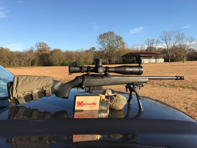

Here's mine after moving it from the .338 to the Tikka:
