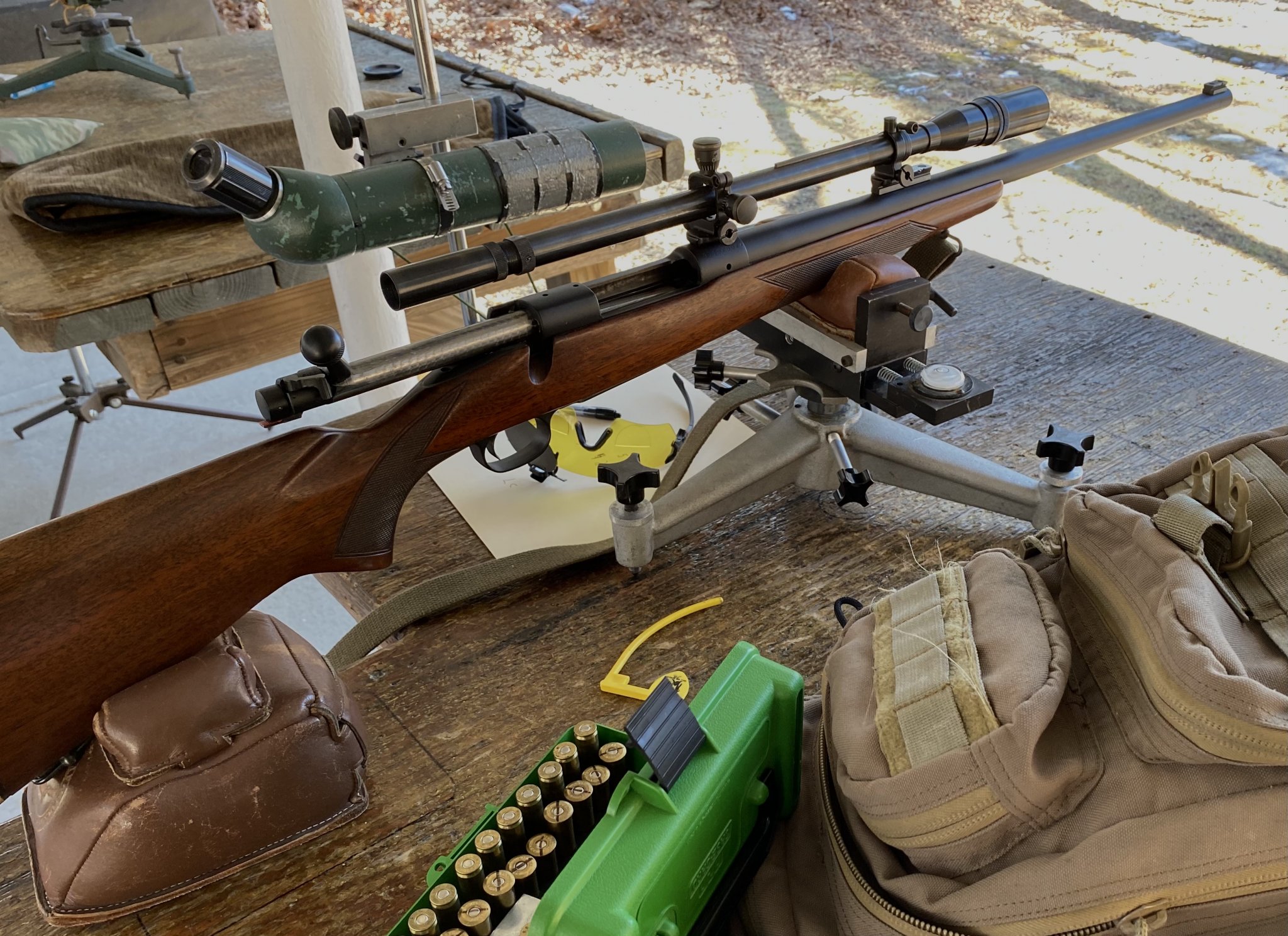

Scope installed.
Seems like most of the USMC pictures show the front mount using the forward position on the front block.
That's how I shot it last time.
If I remember right 7.2 inches between blocks is supposed to equal 1/4 MOA adjustments.
That one picture though of the Lance Corporal in the sitting/kneeling that everyone thinks is Hathcock....He has his front block on the rear position........Im thinking thats just Lance Corporal shit.
Scope installed.
Front position, 7.2 inches, lock em down, squeeze off some rounds.

My sights look like this....
I slipped the windage drum to "zero"
I think the red mark was my 100 yard zero when I had this scope on my M1941 1903.
What do you Unertl guys look like at 100 yard zero?
Think I should do some block swapping?
Most typical distance I can expect would be 600 yards.
I toy with the idea of taking it to 1000 though.

Toying w/ the idea of taking it to 1000.
You will definitely be block shopping. You might want to find a two step block for the front (high step for 600, low step for 1000)... and a much higher rear. Just sayin...
I cant shoot mine to 1000 with a hundred yard zero because it puts the windage adjustment "point" below the usable centerline down the curve, almost under the scope. Gets wonky.
I took my .308 M40 to 1000 using reticle holds and dialing down to 4.5X to double the reticle off a 2 mil under 100 yard zero.
It was fun in close and though I made hits at 1000 it was a challenge.

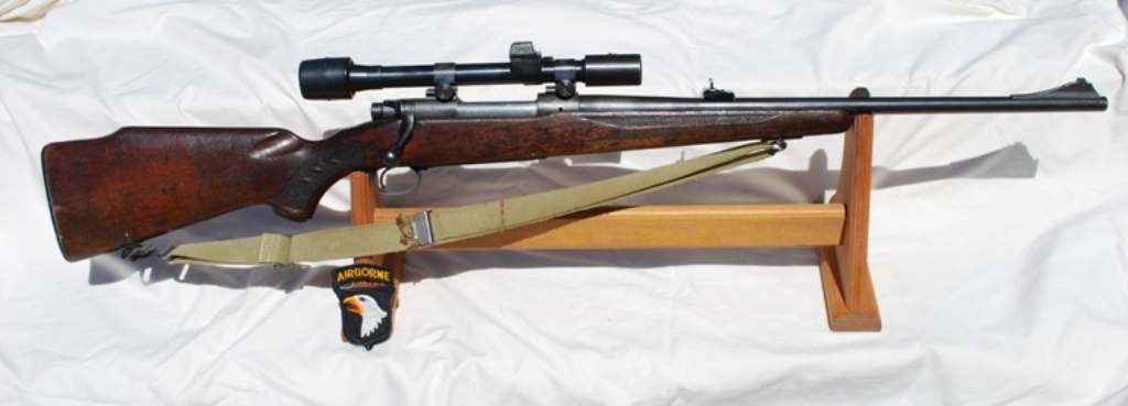

A US Property 1941 M70 in .30 Gov't 06 showed up in the last RIA auction and I bit on it. I put in a silent bid before the auction and believe I was the only bidder - I picked it up for the opening bid price. The serial number is not documented by Chandler & Chandler, but the CMP cert that came with the rifle indicates it's one of the missing numbers. This one fits nicely between two of the Chandler documented numbers. Should be here in a couple weeks. Definitely a rack rifle, but glad to snag another part of Winchester / USMC history with this one.
Back in the day when people were treated like adults and it was assumed they were inclined to do good not bad the morale and recreation units on base held these for troops to sign out and use for recreation purposes.
I would be inclined to think this would be one of those.
Dang! I wish I would have seen this one... you would have had some competition! : )
DW
Its not a PreWar Model 70 and has the high comb stock.
