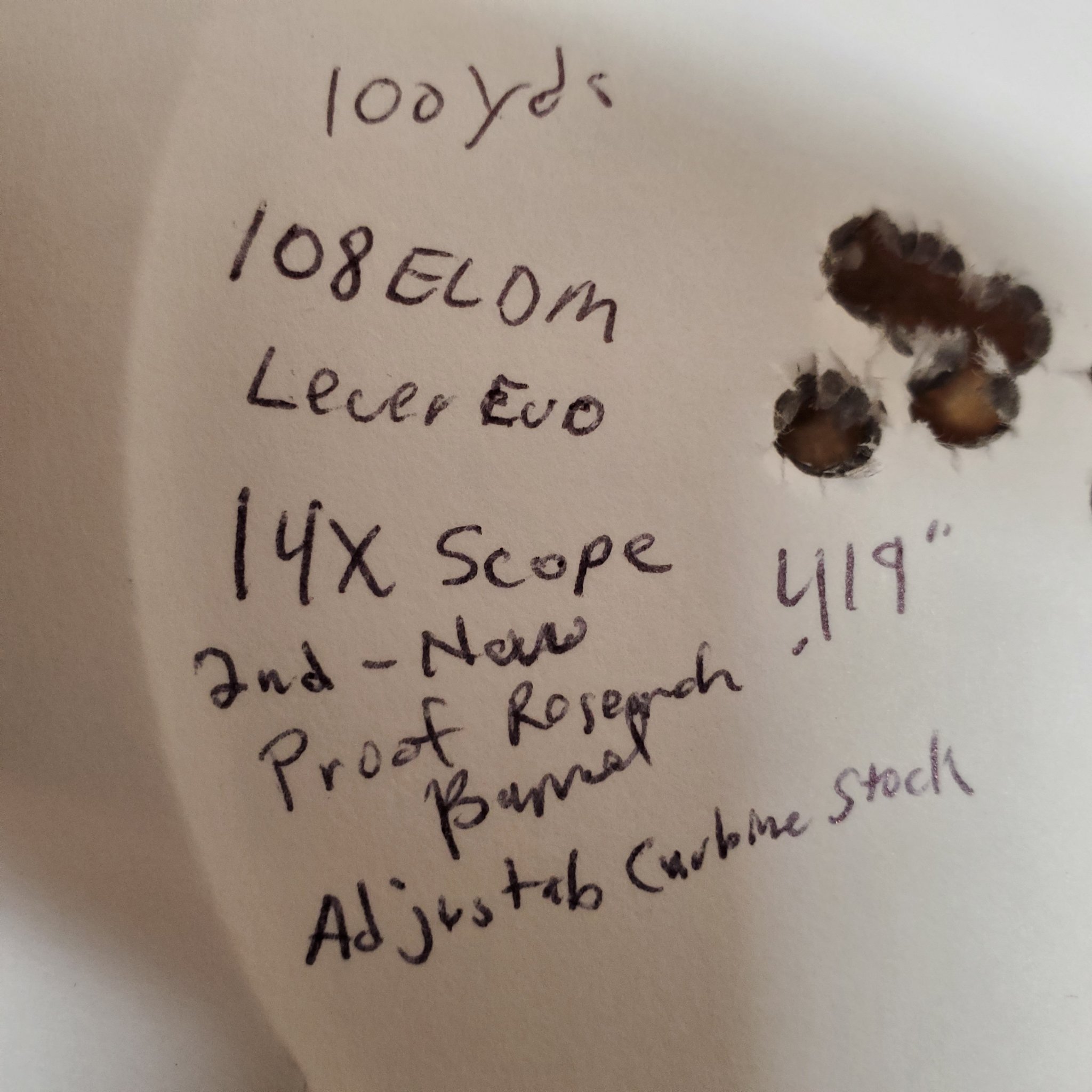

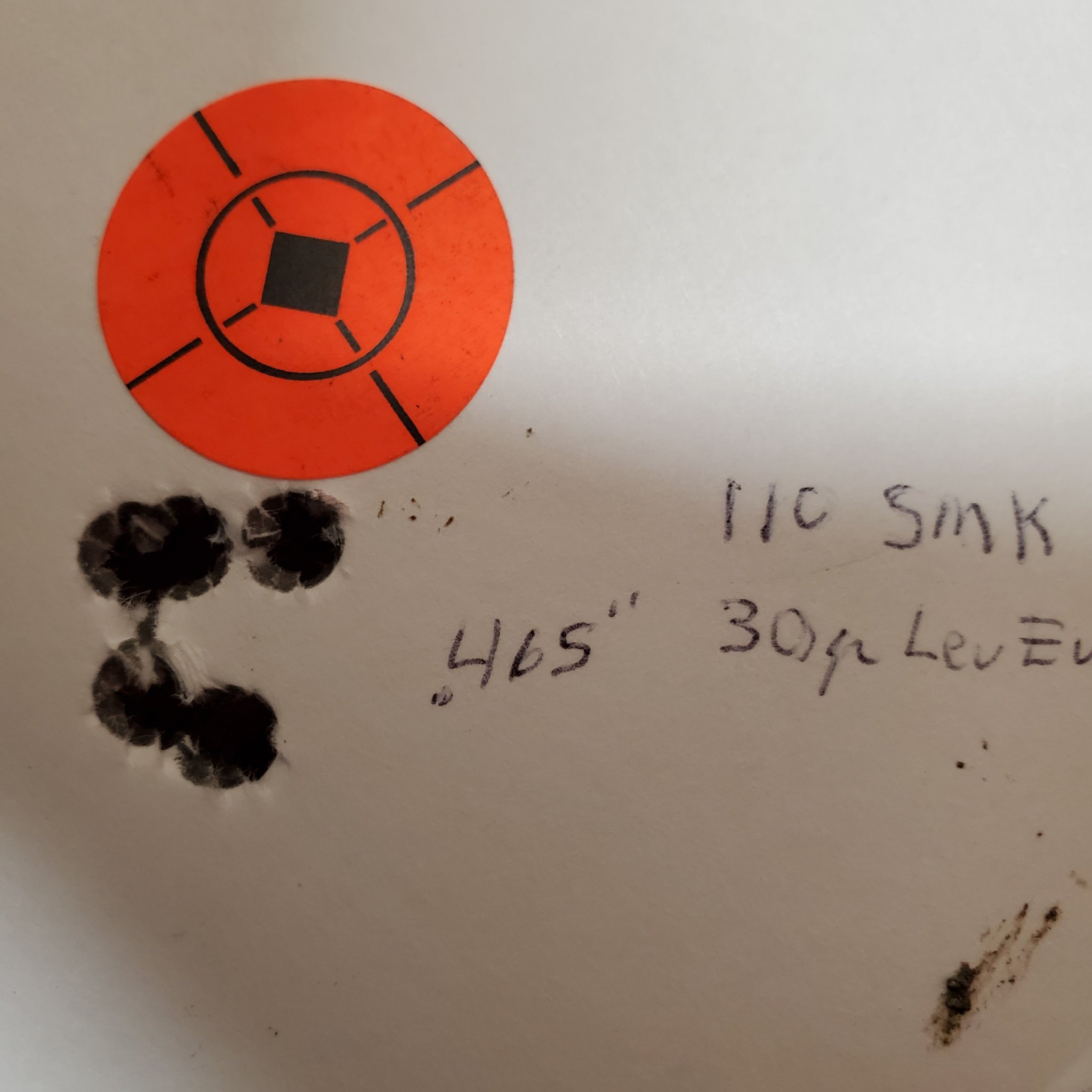

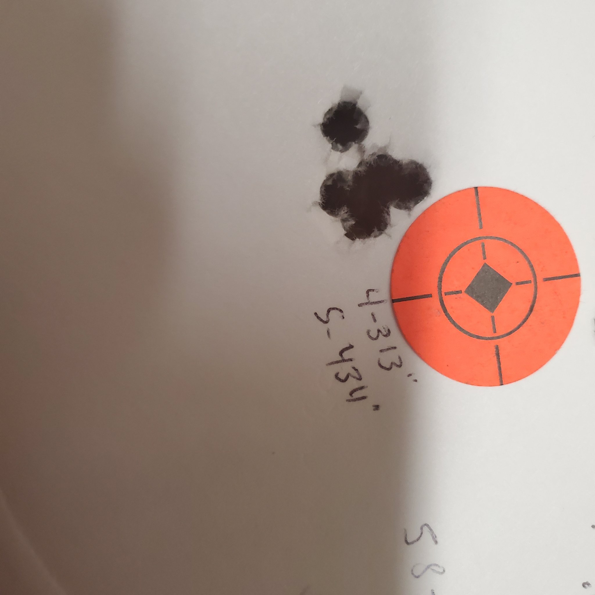

I am running 2, 18" Proof barrels in ARs, all loads, are handloads with Leverevolution.
I polish all barrels in a fixture, before installing them no matter who makes the barrel, and do no barrel break in. Just go out and shoot as many as ya want, then go home and clean.
The 6mm ARC is an accurate cartridge in the AR platform, with Proof barrels I own, I like the heavier bullets 107, 108, & 110 gr. The Berger 108 is an excellent performer, for tiny groups.

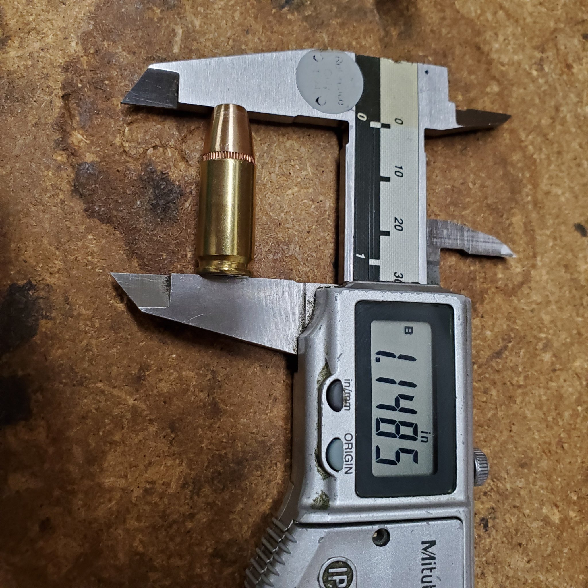

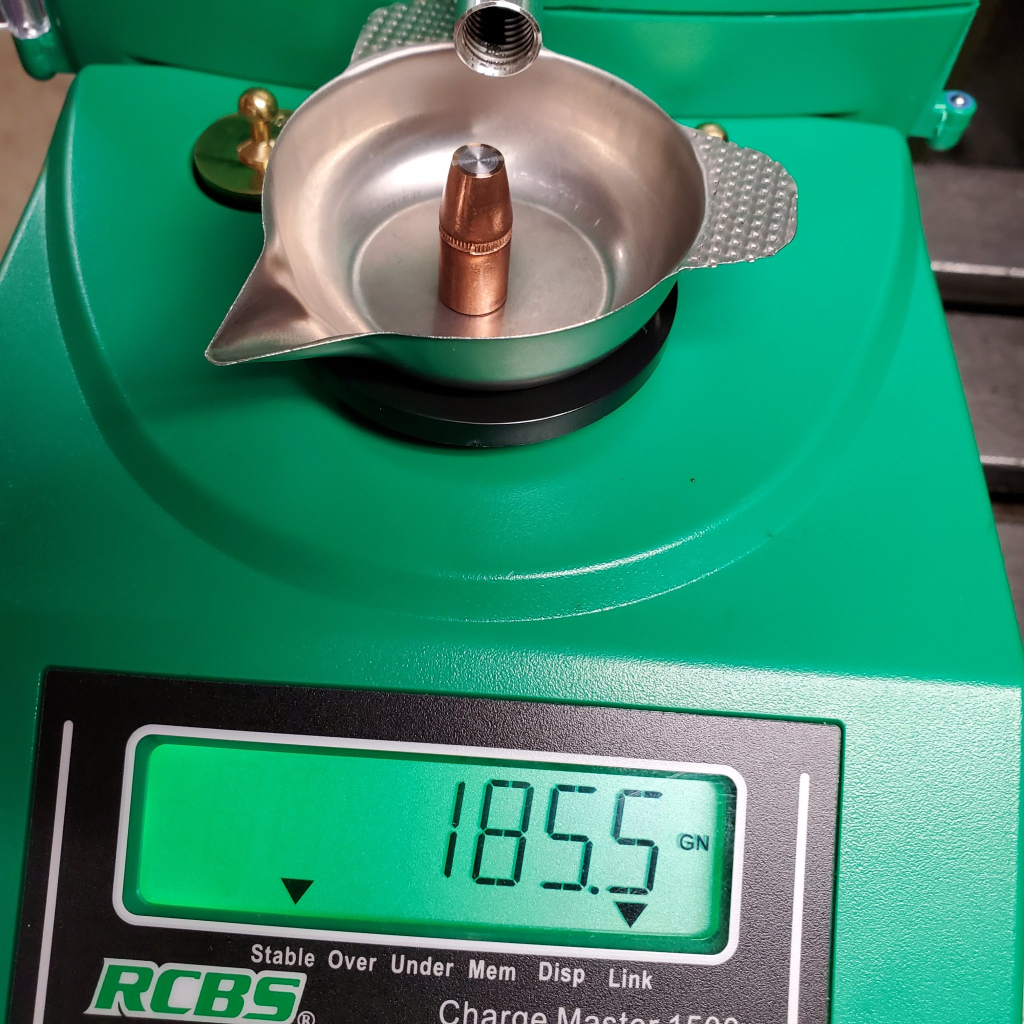

Subsonic...the 9mm luger beats the 6.5 Grendel up close, .355" hole & more weight available ..with 185 gr bullets out of tbe AR platform. I ran them in a 10" barrel before changing all the pistols to rifles. The 155 gr to 1200 fps if ya want, and 165 9mm available too...cases are free, or almost, bullets cheap, powder cheap...it's a pretty good sub round up close...easily extended to 200 yds with supers...
High velocity over 2600 fps in 9mm Luger 16" barrel, but sheds velocity fast. Plus many of the bullets are made to expand at 9mm velocities...
Making the 9 mm a pretty good sub round, at 50 yds or so. No problem with supers hitting steel at 200 yds, but energy is way down.
