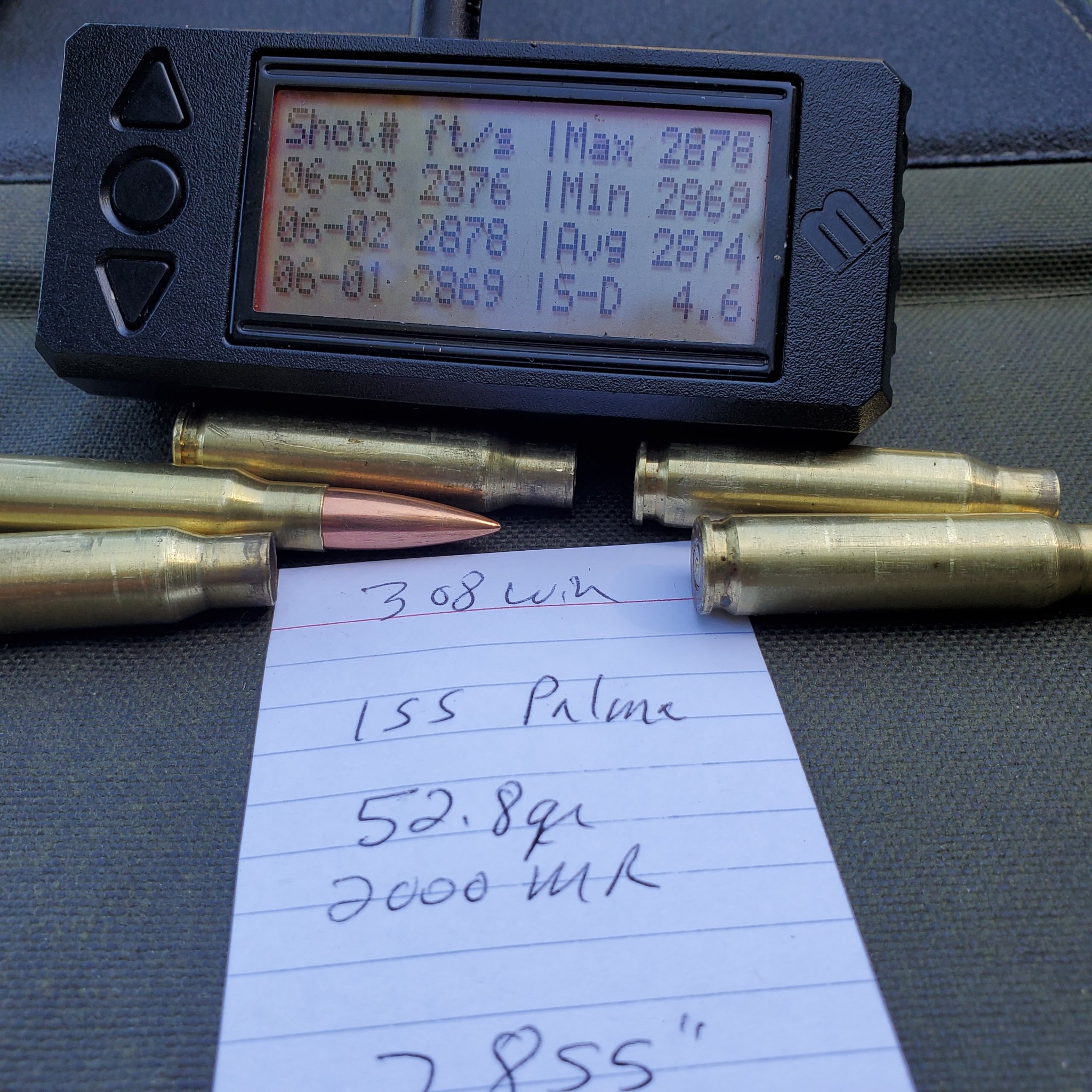

Not even close to the 308 with something other then anemic 70 yr old poor BC 168 SMK which everything seemed to beat, and most cite when they want to bost about the latest new cartridge. There are many new 308 bullets that have higher BCs with new powders.
My 16" AR 10 6lb 3 oz lbs 308 runs 168 eldm .523 BC to 2752 fps with excellent groups.
208 at 2442 fps .691 BC out of the mag
Various match 155 grs running velocities 2820 to 2900 fps. That is just a light weight AR 10, 308 Win with 16" barrel, just "modernized" up, with handloads, using the same bullets used in the 6.5 grendel and 6 mm ARC, in Hornadys ELDM category, and 3000 ft lb of muzzle energy for hunting, available in 16" 308 AR.
The 30" bolt 308 2856 fps with 200 gr SMK .715 BC 7.34 mils to 1000 yds. #1 rifle #1 load.
I have 2 big 300 mags, in 300 WM and 300 RUM, 6.5 CM, 6 ARC, and a host of others. So I'm familiar with what they will do, when handloaded.

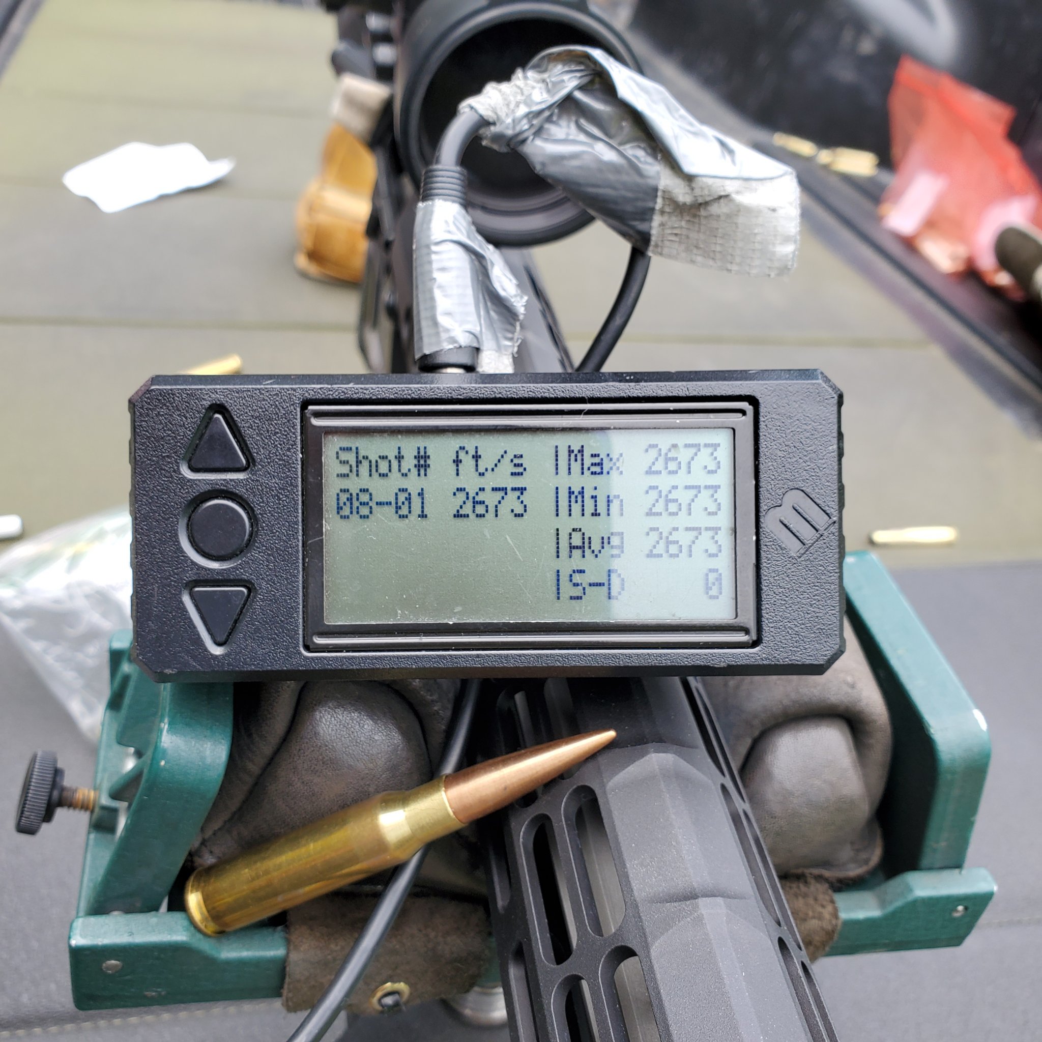

If I load the 18" AR 10 with 200 gr SMK .715 BC bobsled single load it runs 2673 fps, in AR 10 as shown...here my 6mm ARC is not even close in trajectory.

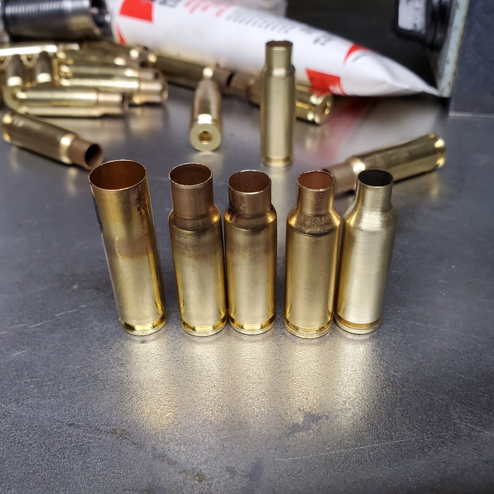

I am a fan of the 6 mm ARC and formed 1200 rds of brass before it became available, 250 were from grendel basic a .430" dia straight wall necked to 6 mm ARC, a lot of work, no head stamp.

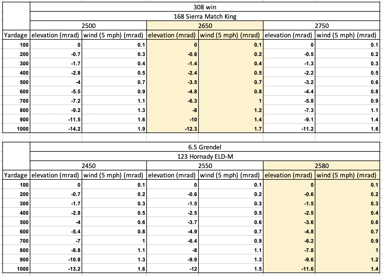

Here are the values that I get from JBM Ballistics, at 59F and 1000 ft elevation, with a 5 mph full value wind. I used the bullet library provided, 10 twist barrel (8 twist for Grendel), with 1.5" sight height.
I have highlighted the "box values" in cream. Note that the Grendel and the 308win have "similar" trajectories, with a slight edge to the Grendel.
As far as real world velocities, the 16" 308 Win hangs with the 18" Grendel out to 500 yards, then the Grendel pulls ahead slightly.
Finally, the 308 win, build using mostly "bog standard" parts and an A1 stock measures 37" in length, and weighs 9.8 lbs wearing a Vortex crossfire 4-12 variable scope. The Grendel sports a 90's vintage Leupold Vari-xII 3-9 scope, and a magpul CTR stock. It measures 34" fully collapsed and just over 37" fully extended. It weighs 8.6 lbs as configured. Neither rifles were built with "exotic materials" (titanium, magnesium, carbon fiber, etc) but both were built to not be absolute pigs.
To wrap up, the 18" 6.5 Grendel is shorter, lighter, and has equal to slightly better ballistics than the 16" 308 win.

Dang. I’m looking at Hornady’s 22” Service Rifle data for .308 Win with 168gr ELD-M and they max out at 2600fps.
You’re beating them with 6” less barrel, same bullet, by 152fps.
Are you using Lapua Palma brass and Superformance?
Either way, I won’t even try to match those speeds in a gasser. Hornady’s data shows 2700fps max with a 22” bolt gun. You’ve exceeded that by 50fps from a 16” AR-10. All it takes is pressure I guess. How often do you bend Firing Pin Retaining Pins?
Yeah, but it ain't a service rifle...its a light 16", 6 lb AR 10, running 168 ELDM at 2756 fps with excellent accuracy. Also the new 169 and 177 SMK are higher BC and excellent shooter. Or 208 gr at 2442 Ave fps for heavy bullet.
Or go to the heavier 18" 308 AR 10 with 200 gr SMK .715 BC at 2673 fps for your 1500 yd encounters.

Then there are military 6.8× 51 hybrid cases fromed to 308 for added performance, used only in bolt guns. Like 3256fps for 168 gr bullet, as a maximum effort in 30" 8 twist.
As a retired machinist and 30 years firing many thousands of 308s, and still experimenting with them, to change and improve on this caliber. Changing everything and anything, so many rifles are not standard, just the 308 case is standard...but some are, like the light 16" AR 10 308, and the 18" & 24" are all standard, but their performance is not...the rest not so much.
