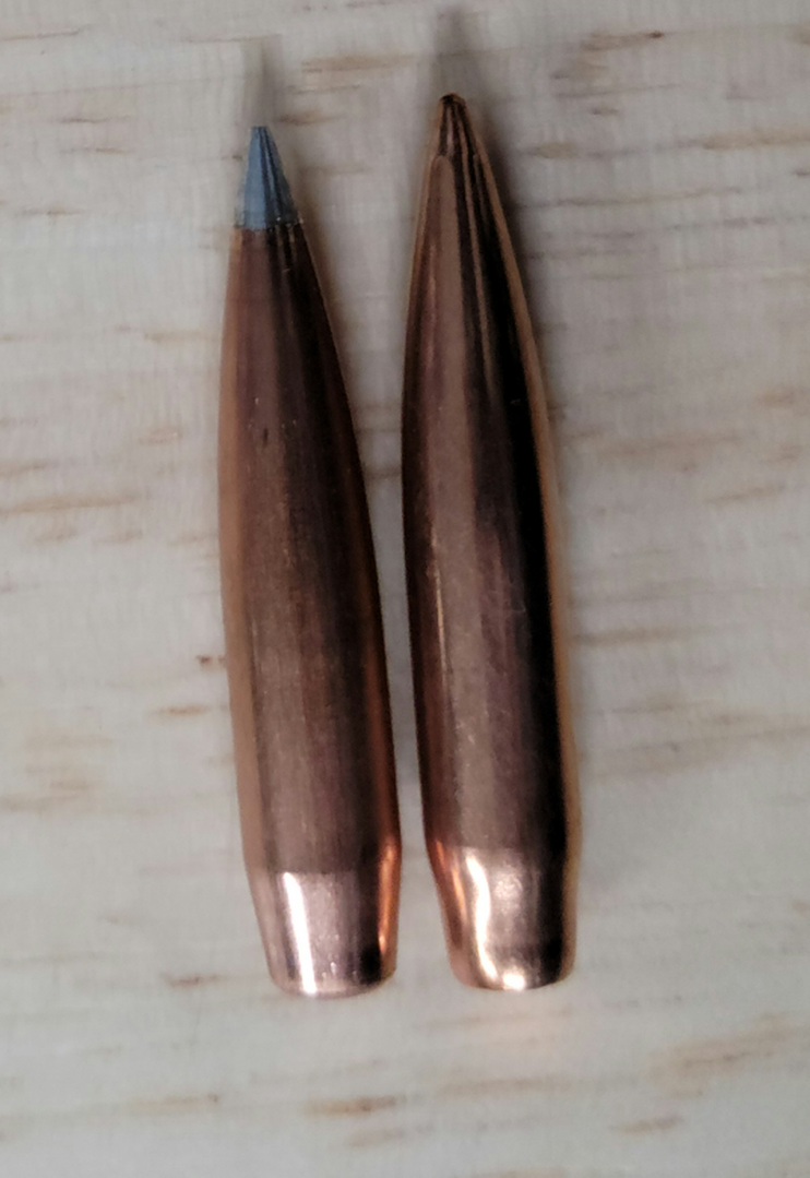

Modern bullets in 6mm have a much higher BC than the old ones pictured.
Most are .520 to .604 BC So that is an invalid comparison, for 6 mm to 6.5 mm

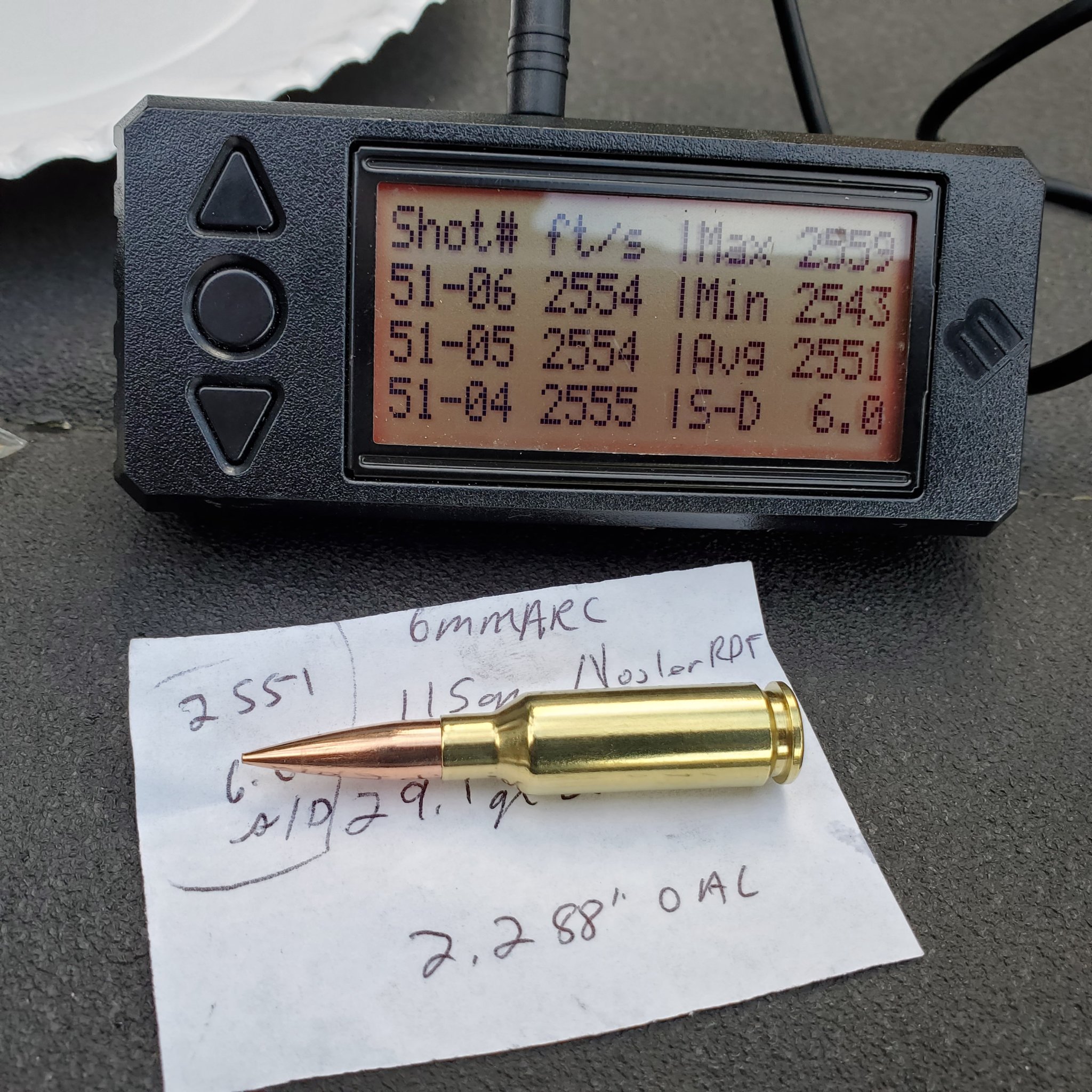

I run those,high .6 BC bullets including the 115 DTAC, 112 gr Barns, and 110 SMK & Atip.
The 6 mm ARC is very accurate for an autoloader.
This is one of two 18" AR 15s with Proof barrels, both are accurate.
Bolt guns can add several hundred fps, because they run at higher pressures than tbe the autos.
I prefer the 6 Dasher in a bolt gun, and the 6 ARC for the AR 15 platform.
And it out performs the Grendel there, because they are both limited to the weak bolt pressures, and mag lengths.
You'd have to get a 140 class or 135 gr Atip going 2600 fps in an 18" barrel AR 15 with its magazine and pressure constraints to slightly beat the 6 mm ARC trajectory, in the same platform and barrel length. The 115 pictured has a .634 BC printed on the box at 2551 fps the other 115 gr DTAC is 2532 fps fps average velocity...from the 18" AR mag feed.

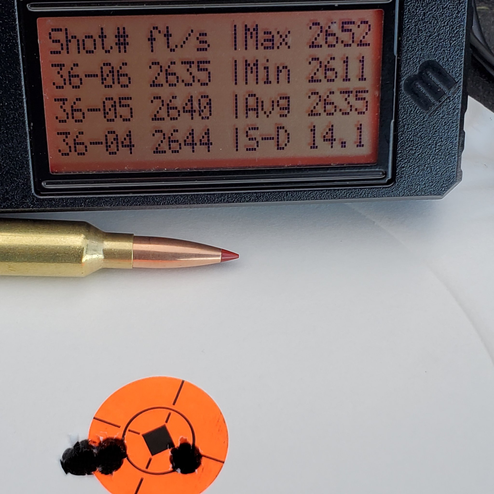

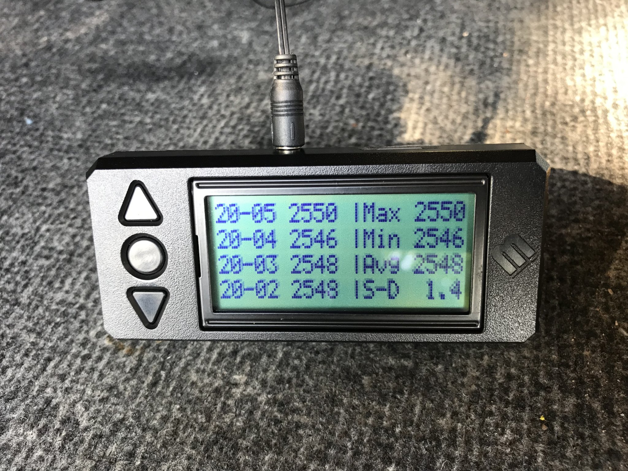

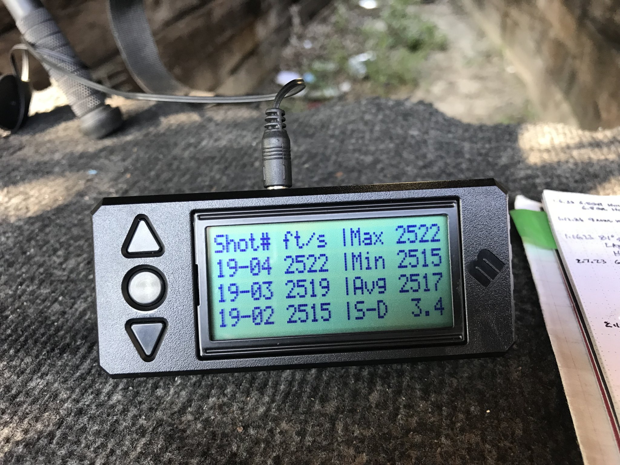

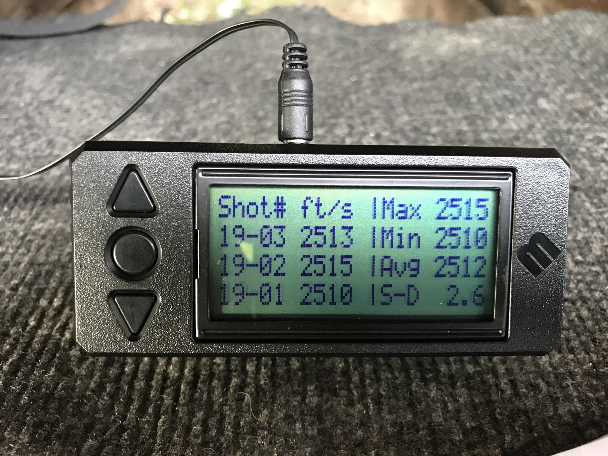

My only reason for having any 26cal is it's my favorite caliber (6.5gren, 6.5creed, 260rem, 6.5prc and 264wm). All but the wm is in AR. I prefer the 6.8spc over the 6.5gren every day.
This was an exceptional string for SD, and most others run 5-7 SD, but 2550ish is my everyday load using 120 Scenar L, 27.0gr AR Comp, CCI450 at 2.225 OAL, which is about .020-.025 off lands in 20” Proof CF barrel. Not a universal load for all my Grendel’s, but damn close. Velocity varies by chamber specs and barrel length.IMG_6962.jpegIMG_6954.jpegIMG_6961.jpeg
Reactions: LRRPF52 and 45-90

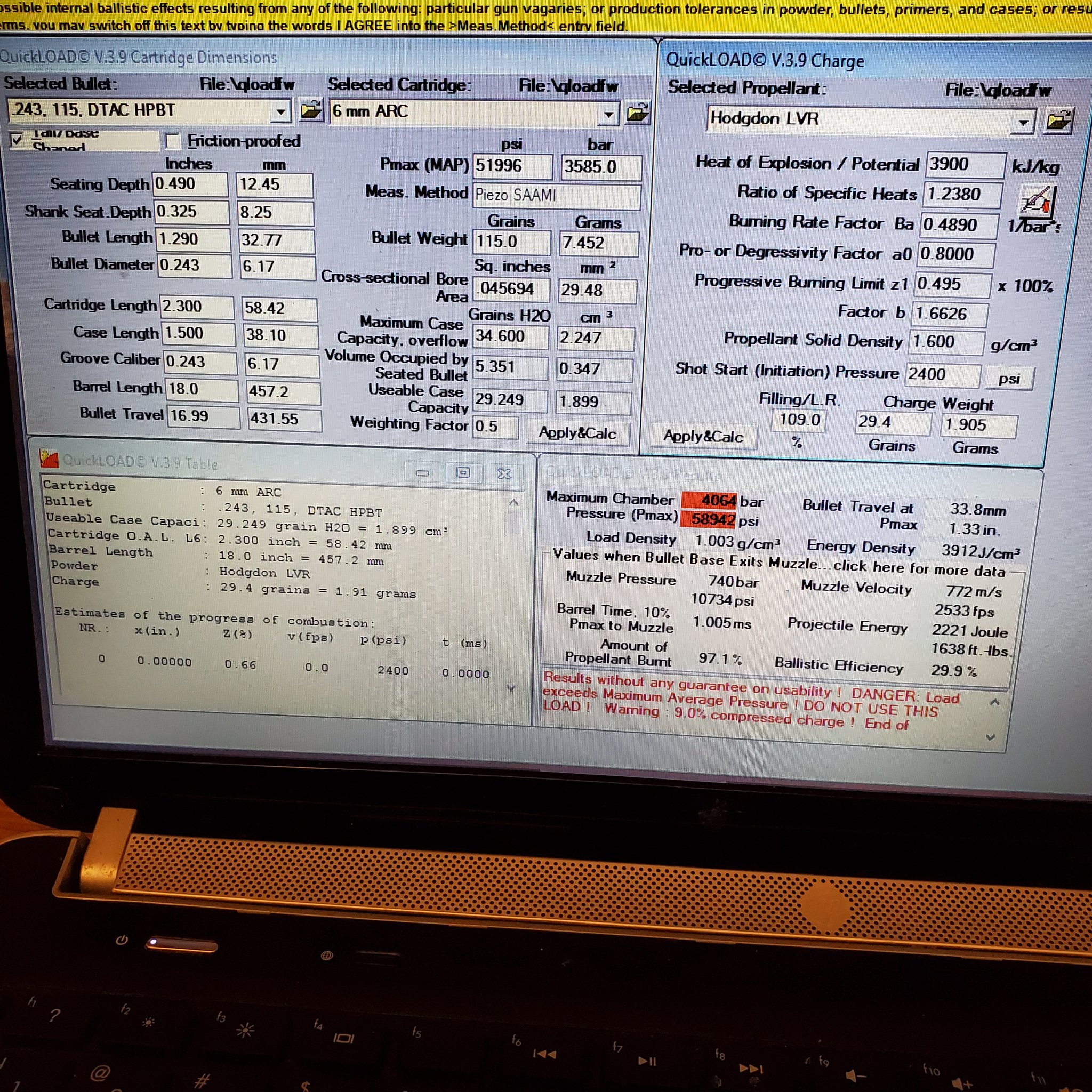

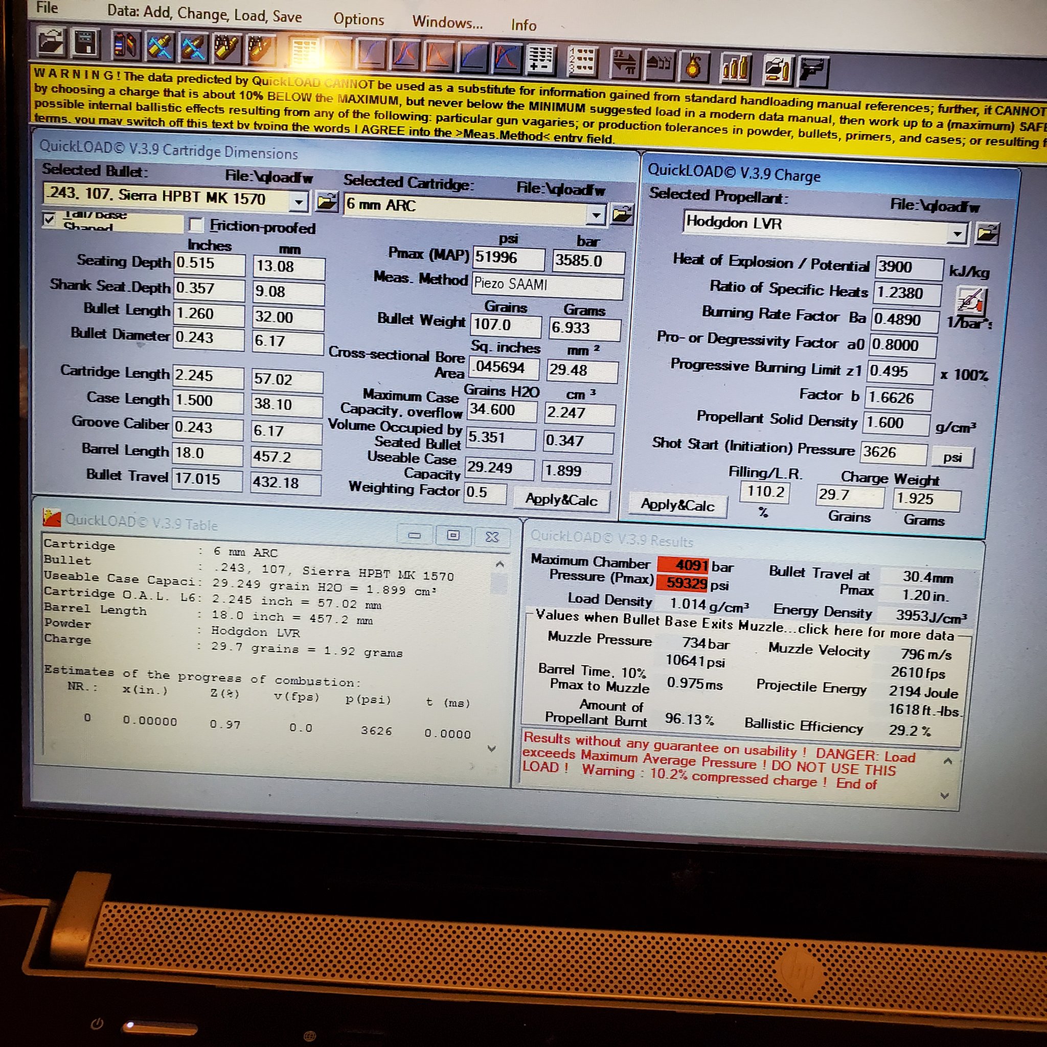

2550 with 115 out of an 18" barrel is well past 52kPSI, more like 62kPSI. AR based Grendels don't handle pressure very well for long.
The Hornady manual for "Gas Guns" says, for an 18" barrel 110 Atip 2575 fps ...
Total face plant, dude! And it beats the Grendel with a .604 BC and higher muzzle velocities... IN THE HORNADY RELOADING MANUAL 11th edition.
Like I said, ,..."the Facts"... If you can't push a 140 gr class or 135 gr Atip past 2600 fps in an AR 15, with 18" barrel, feeding out of the mag. ... Then the 6.5 grendel can't beat the 6 ARC period...Fact.
In a 24" bolt gun for 110 Atip .604 BC the Manual says 2850 fps... way out of reach of the 6.5 grendel...from the manufacturer... Not me.

Last I checked 115DTAC and 115RDF aren't 110 Atip
Cartridge : 6 mm ARC
Bullet : .243, 115, DTAC HPBT
Useable Case Capaci: 28.678 grain H2O = 1.862 cm³
Cartridge O.A.L. L6: 2.260 inch = 57.40 mm
Barrel Length : 18.0 inch = 457.2 mm

This was an exceptional string for SD, and most others run 5-7 SD, but 2550ish is my everyday load using 120 Scenar L, 27.0gr AR Comp, CCI450 at 2.225 OAL, which is about .020-.025 off lands in 20” Proof CF barrel. Not a universal load for all my Grendel’s, but damn close. Velocity varies by chamber specs and barrel length.View attachment 8319895View attachment 8319897View attachment 8319896
The 120 gr Senar L has a published BC of .497.
I'm running 115 gr bullets, just 5 grains less with over .6 BC with similar velocities from a shorter 18" barrel...2" shorter. So down range performance would be in favor of the 6 mm ARC.
But... none of that needs to matter, only for the sake of a ballistics discussion, and which has the edge.

I have Quick Load too...it is for reference only.
The reason is sometimes is off..alot..just a helpful tool...kinda.
Example 6mm ARC 110 gr Atip "From the Manual."
SO IF ya just plug Hornadys Manual information into QL with the 110 gr Atip with 29.7 gr of Leverevolution 2.245" COAL ...QL has ridiculously high pressures and velocity.
Then plug in the 108 ELDM, same charge, same wrong conclusion.
Obviously...Wrong!
Did the manufacturer of QL say for reference only ...use the loading data from the powder companies, and bullet manufacturers.
And my DTAC loads are .3 under the manual for the 110 gr Atip, and the 115 gr with the BN coating. ..when corrected it comes out to 51,800 psi.and the same velocity.
QL is way off on this one, as it is quite often...fuge the numbers to get some correlation to represent actual testing from manufacturers & from actual chronographed load data. Trust the loading manuals more than QL and even the manuals have had a primer blowing load in them from time to time.
These manual top loads have been running in my 6mm ARC for several years, and a few thousand rds, no problem. That’s why Hornady separated the gas guns from the bolt guns with different maximum charges.
Think of the liability Hornady would have if all these loads were seriously way over pressure as QL would suggest.
Go to the loading manuals if in doubt about any load you encounter, including mine...don't like it, don't use it simple...stay within your comfort and /or accuracy zone...absolutely, your choice.
No matter how ya slice it the 6mm ARC has a better trajectory than the 6.5 grendel, and that may not be of concern to many.
I doubt if anyone cares, which you choose, as your cartridge.
Reactions: LRRPF52
Obviously...Wrong!
You're kidding yourself. 6ARC in QL matches relatively closely to all of the load data published by Hodgdon. 110Atip has a substantially shorter bearing surface than both 115 Dtac and 115 RDF. hBN doesn't change the pressure enough to make your loads safe either.
Welll, its working for me, and my main bullets are the 108s Berger and Hornady, with a loading data max charge, and the 110 gr SMK and 110 Atip, both the same powder charge, and the 115 gr .3 below.
So my 115 load has slightly lower pressure than the 107 & 108s but both over pressure according to QL... but book max According to the Hornady manual. So Hornady manual loads are considered safe and tested with actual expensive measuring equipment.
So I'm going with QL suggestions and using the manual data, as max with QL suggested pressure, as a reference.
Then if I get the same pressure with both loads and its reasonable, it would then be suggested as a safe maximum load. ...and it works well for me in in my rifles. You don't like it, do it your way.
Reactions: LRRPF52

I get lots of overpressure warnings when using ql with printed data from sierra, berger, nosler and many others and not just on rifle, but pistol also. I'll readjust usable volume to meet "x" amount of charge percentage and still not the same result as printed data. Some reach 80k+ on 50-60k max pressure for cartridge. So, yes it's just a tool and can be helpful to a point. Being able to adjust for ALL parameters including atmospheric conditions along with primer charge/type of and brand of makes a difference in outcome! Knowing what case volume is a start and confirming powder volume/density (and being able to adjust for it) and not just bullet length, but drag (bearing surface which isn't part of the program) for proper results! What you CAN'T adjust for is lead/throat which CAN lower pressure (not any different than seating a bullet further out to make more room for powder which at a shorter length would have more pressure especially with more charge). Trim length is not an adjustment for shoulder bump, but does show lower pressure!
My 18" Grendel gets 2485 with 123 Scenars and 28gr 8208 XBR. I get some slight pressure marks on the brass, but nothing over the top.
I'm using almost the exact same load and getting almost the exact same velocities. No pressure signs on my 1x or 2x fired Hornady brass, FWIW.
18" 6.5G Larue suppressed w/ SDN-6
123gr Hornady ELD-M
Rem 7.5 SR primer
1 x fired Hornady brass
28.5gr 8208 XBR
OAL 2.250”
5rd group from load dev
Lo: 2442
Hi: 2468
Avg: 2457
ES: 27
SD: 10.1
24rd group to get more ES/SD input
Lo: 2446
Hi: 2494
Avg: 2466
ES: 48
SD: 14.6
20rd group b/c I had the LabRadar setup already
Lo: 2464
Hi: 2517
Avg: 2487
ES: 53
SD: 11.5
25rd group b/c I had the LabRadar setup already
Lo: 2456
Hi: 2510
Avg: 2483
ES: 54
SD: 15.6
Reactions: LRRPF52
The reason QL is saying A-Tip and 107SMK have similar pressure is because A-Tip has the bearing surface of a 105gr class bullet. Anyone with experience loading Grendel, and Grendel wildcats, in an AR should know it doesn't show traditional pressure signs; velocity is the pressure sign. DTAC out of an 18" barrel going 2550 is the pressure sign and your load isn't safe. Your load doesn't have less pressure than 107's, it has more. Now it seems like you're backpedaling from your chronograph post which clearly shows velocity that correlates to unsafe pressures. Hornady didn't publish load data saying your DTAC and RDF loads were safe, you foolishly assumed two different bullets will have similar pressures.
In the end it is your choice how you load ammo. Your post needs a warning though, and you may want to keep a spare bolt on hand.

Quick Load is almost always at least 9,000psi higher than reality compared to actual pressure test breeches from Hodgdon’s and Western Powders published data. Keep in mind that ballisticians at these companies will calibrate their test breeches over significant periods of time before taking large sample size readings, then get at least 10-shot averages for each of the loads they publish. Ammunition manufacturers have to do this as well, with multiple samples of the lots taken regularly so they don’t put out excessive pressure loads that exceed the SAAMI MAP, MPLM, and MPSM standards.
A thing people need to keep in mind with QL is that the developers of QL don’t have any test breeches for all these cartridges. They have theoretical chamber models that they run burn rate and projectile resistance calculations against, none of which have been accurate for 6.5 Grendel over the years. We have run comparisons between actual test breeches and the published data, and it’s generally 9,000 - 15,000psi higher in QL.
Unless you know how to calibrate it based on your own test breech readings and tweak your own internal ballistics model, the QL numbers for Grendel and some other small cases with 30˚ shoulders is basically useless, highly erroneous.
For example, we have seen loads that only produce peak pressures in the mid-high 40ksi region manifest as 62ksi and higher in QL. If you've seen anyone publishing QL numbers for these cartridges, be aware of this. This isn’t me just posting something I heard from a retard on Barf, but actual real-world data from calibrated test breeches in multiple companies who have been doing this for generations.
Reactions: Yondering and 45-90
For example, we have seen loads that only produce peak pressures in the mid-high 40ksi region manifest as 62ksi and higher in QL. If you seen anyone publishing QL numbers for these cartridges, be aware of this. This isn’t me just posting something I heard from a retard on Barf, but actual real-world data from calibrated test breeches in multiple companies who have been doing this for generations.
I had QL when Grendel was first added and the pressure estimations were totally inaccurate. In recent years QL has released updates that are much closer to what users observe. Here is the data from both Hodgdon and QL. In this case, QL is estimating less pressure than the powder manufacturer, not more. QL underestimates Hornady's data too. When you substitute DTAC for A-Tip you significantly increase the pressure. That is what more bearing surface does.

Twist: 1:7.500"
Barrel Length: 24.000"
Trim Length: 1.480"
Bullet: 107 GR. SIE HPBT
Diameter: 0.243"
Case: Hornady
Primer: Federal 205M, Small Rifle Match
Starting LoadMaximum LoadAvailability
ManufacturerPowderC.O.L.Grs.Vel. (ft/s)PressureGrs.Vel. (ft/s)Pressure
HodgdonLVR
2.260"25.42,40037,700 PSI28.22,66951,800 PSIBuy Now
Bullet : .243, 107, Sierra HPBT MK 1570
Useable Case Capaci: 29.319 grain H2O = 1.904 cm³
Barrel Length : 24.0 inch = 609.6 mm
Powder : Hodgdon LVR
Predicted data by increasing and decreasing the given charge,
incremented in steps of 1.0% of nominal charge.
CAUTION: Figures exceed maximum and minimum recommended loads !
Step Fill. Charge Vel. Energy Pmax Pmuz Prop.Burnt B_Time
% % Grains fps ft.lbs psi psi % ms
-10.0 94 25.38 2354 1316 35658 6590 91.4 1.453
-09.0 95 25.66 2381 1347 36822 6676 91.9 1.434
-08.0 96 25.94 2408 1377 38028 6761 92.5 1.412
-07.0 97 26.23 2435 1408 39276 6844 93.0 1.392
-06.0 98 26.51 2461 1439 40569 6925 93.5 1.372
-05.0 99 26.79 2488 1471 41908 7004 94.0 1.351
-04.0 100 27.07 2515 1503 43296 7081 94.4 1.332
-03.0 101 27.35 2542 1536 44735 7155 94.9 1.312 ! Near Maximum !
-02.0 102 27.64 2569 1568 46226 7228 95.3 1.293 ! Near Maximum !
-01.0 103 27.92 2596 1601 47773 7298 95.7 1.275 ! Near Maximum !
+00.0 104 28.20 2623 1635 49378 7366 96.1 1.256 ! Near Maximum !
+01.0 105 28.48 2650 1669 51045 7431 96.5 1.238 ! Near Maximum !
+02.0 106 28.76 2677 1703 52774 7494 96.9 1.220 !DANGEROUS LOAD-DO NOT USE!
+03.0 107 29.05 2704 1738 54570 7554 97.2 1.203 !DANGEROUS LOAD-DO NOT USE!
+04.0 108 29.33 2731 1772 56432 7612 97.5 1.185 !DANGEROUS LOAD-DO NOT USE!
+05.0 110 29.61 2758 1808 58375 7666 97.9 1.168 !DANGEROUS LOAD-DO NOT USE!
Results caused by ± 10% powder lot-to-lot burning rate variation using nominal charge
Data for burning rate increased by 10% relative to nominal value:
+Ba 104 28.20 2762 1812 59865 7331 99.7 1.163 !DANGEROUS LOAD-DO NOT USE!
Data for burning rate decreased by 10% relative to nominal value:
-Ba 104 28.20 2443 1418 40248 7007 88.5 1.376
His numbers all look good to me. He’s loading longer than the book COLs which increases volume, and therefore decreases peak pressure.
His 110gr A-Tip data is within Hornady’s published gas gun data, but at longer COL so as long as it’s not jamming the lands, it should be fine.
115gr DTAC is a Sierra-made bullet for Tubbs if I recall, so the jacket thickness and core ductility have been similar to the Hornady AMP jackets at least in 6.5mm, only 6.5mm SMKs are a lot longer than 123gr Hornady bullets, whereas the 109-115gr 6mms are very similar. The 115gr DTAC does appear to have more bearing surface, but again, he’s loading longer and using a very forgiving powder that has optimum burn rate for the heavier 6mm VLD bullets.
LVR does really well at generating velocity without going crazy in these small cases with 30˚ shoulders. If I was shooting 6mm AR, Turbo, or ARC, I would be shooting the same bullets he is at the same COLs, with the same powders, but I would make sure to not use Elanders. I would use CProducts or the newer ASC mags made in the last 5 years. Elanders will constrain your usable COL, though they are very smooth inside with follower-to-body coefficient of friction.
If I was shooting 6mm ARC chasing 52,000psi loads, I would get either a SixFive Outfitters/Rexus Ultrabolt or the SOLGW AerMet 100 bolt just to alleviate any concerns about that. With AerMet, I would want an AerMet barrel extension too though. You don’t want to overpower the extension with bolt thrust.
Reactions: 45-90 and JS8588
