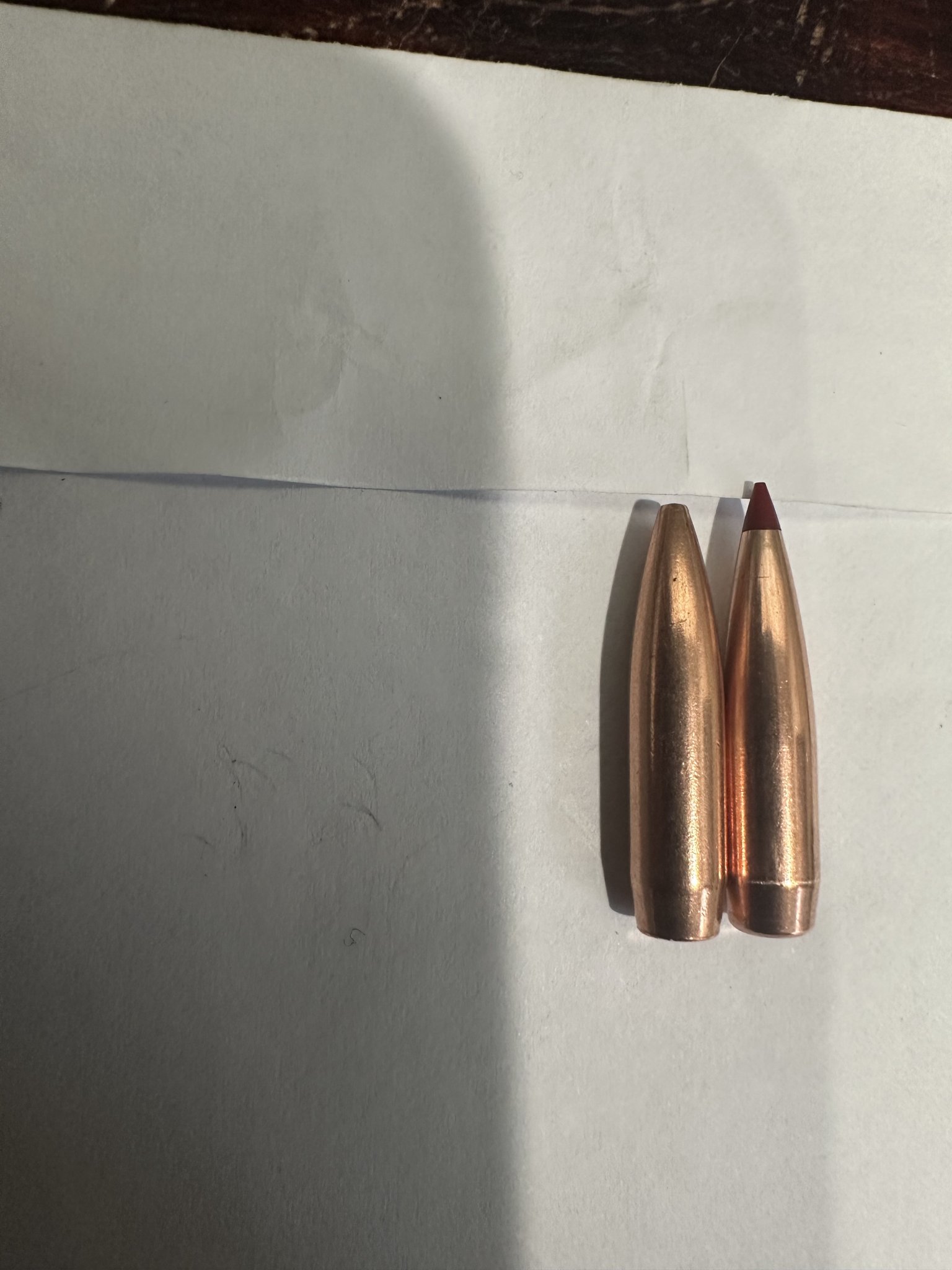

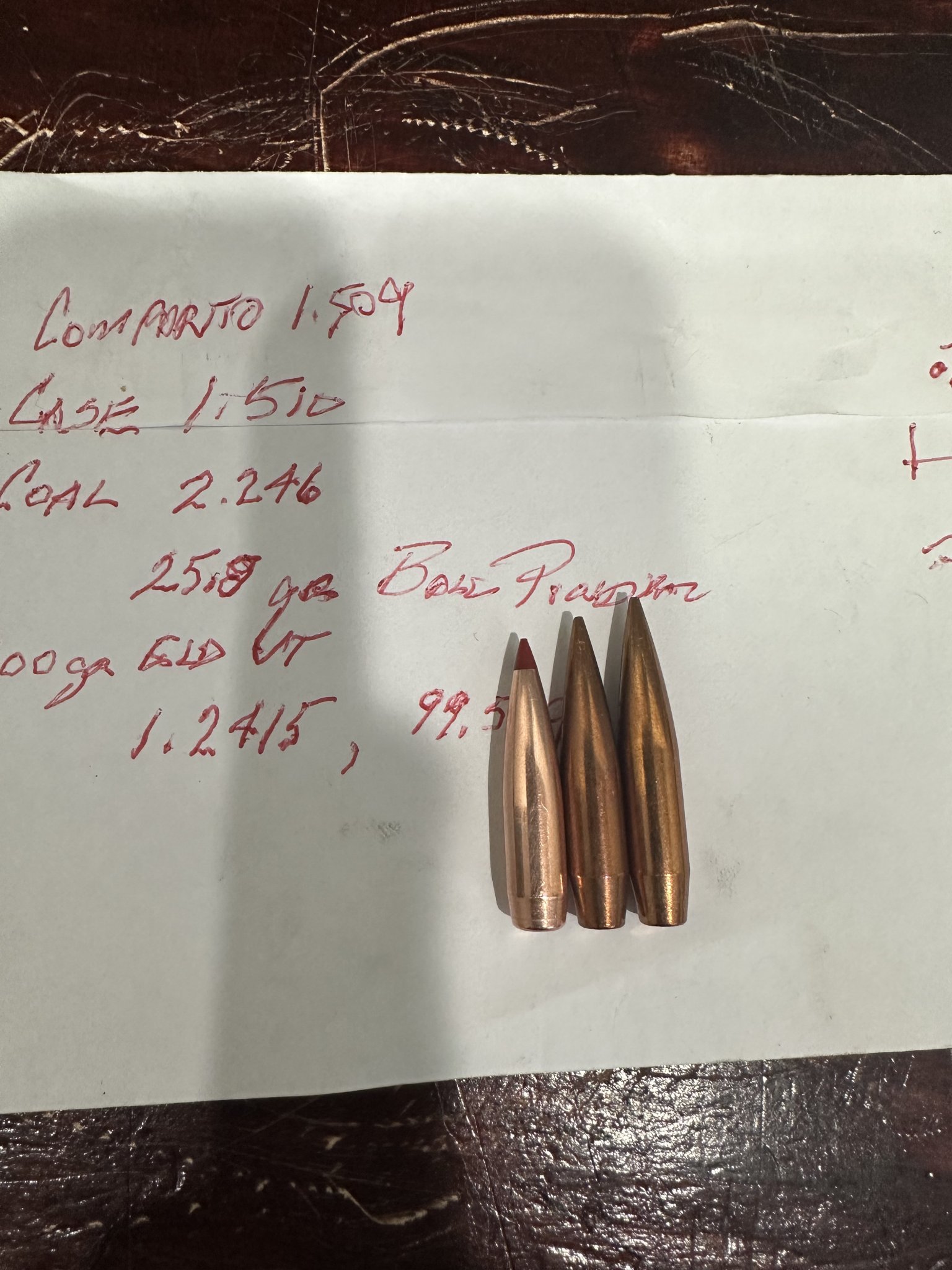

I just picked up some boxes of the new Hornady 100gr ELD-VT from Scheel’s. They had it for $29.99/box.
The ogive and tip look just like a 123gr ELD-M to my eyes. Case head markings are finer than 123gr ELD-M.
It’s going to be a flat-shooting option.
Hopefully will get some trigger time with it this week.

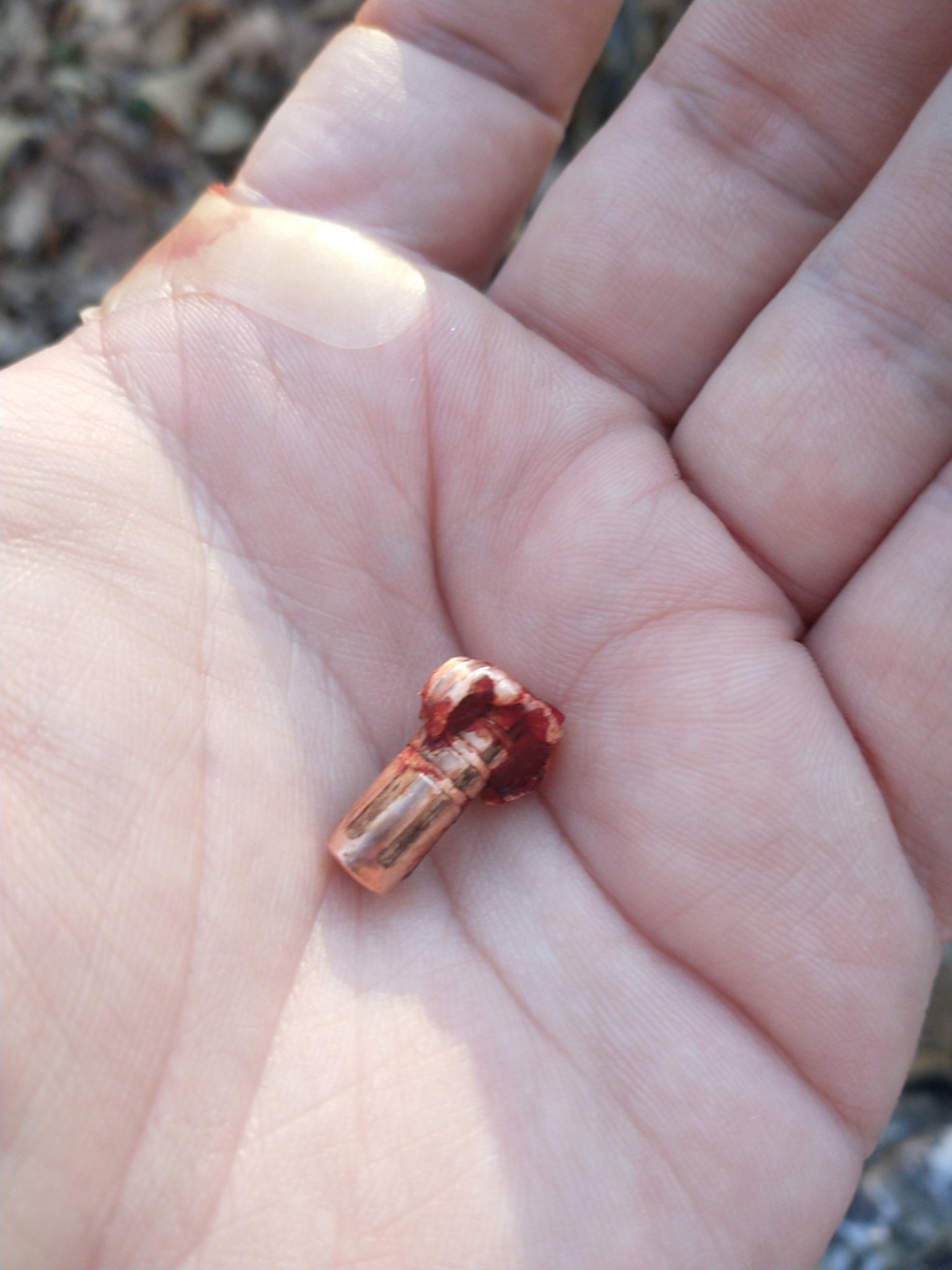

Picked up a 6.5 grendel 18" upper from PSA and put it on top of a PSA lower that I assembled last year. Killed my first deer (doe) last week. With everything that I had read and understood....it was the right choice. Would I go with 6 ARC...maybe. But happy with my choice and with my current hunting for whitetails in VA.....it'll work. Was a 115 grain Barnes ammo. Also wanna say thanks for all the continuing sharing of knowledge and experience on this board. Appreciate it!
Congrats on the kill.
Where was the shot placement?
And where did you recover the bullet from?
Thanks Bakwa...appreciate it! Doe was roughly broadside...maybe quartering towards me...aim point was shoulder...don't remember whether it was on the crease or not. Recovered the bullet on the same side of the hide as the entry wound. No pass through. I think the deer died due to lung filling up with blood because the joint was destroyed along with the "shock" was transferred to that shoulder which continued on....might have nicked the lungs....but I don't know. I didn't think to grab more pics of that...something I'll try to remember for next time. And it was only about 50 yards....so wasn't far at all. Thanks for the questions. Hope I answered em.

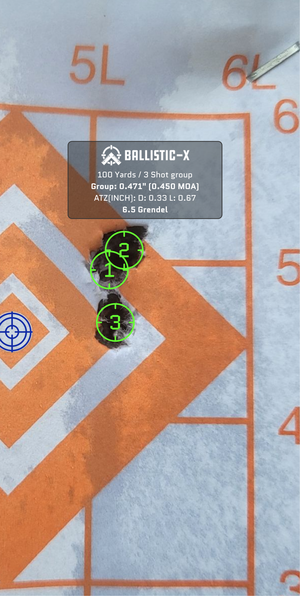

Just picked up 60 rounds from Schell’s last week , I have a 20” 1-8 BHW barrel with 150 rounds down it , and a 24” 1-8 BHW barrel never fired. I took it to an indoor range just to chrono them. 20” barrel shot about 2,625 and the 24” about 2725. The SD’s were extremely low , shot about 4 round out of each rifle, The rounds on out of each barrels were all within a few fps.
Since the 20” has been broken in I’m not expecting any increase here forward. On the other hand the 24” at 150 rounds I would guess maybe 30 to 50 more fps. So say max at 2,775. fps out of the 24” . Not crazy velocities but can’t beat the SD.

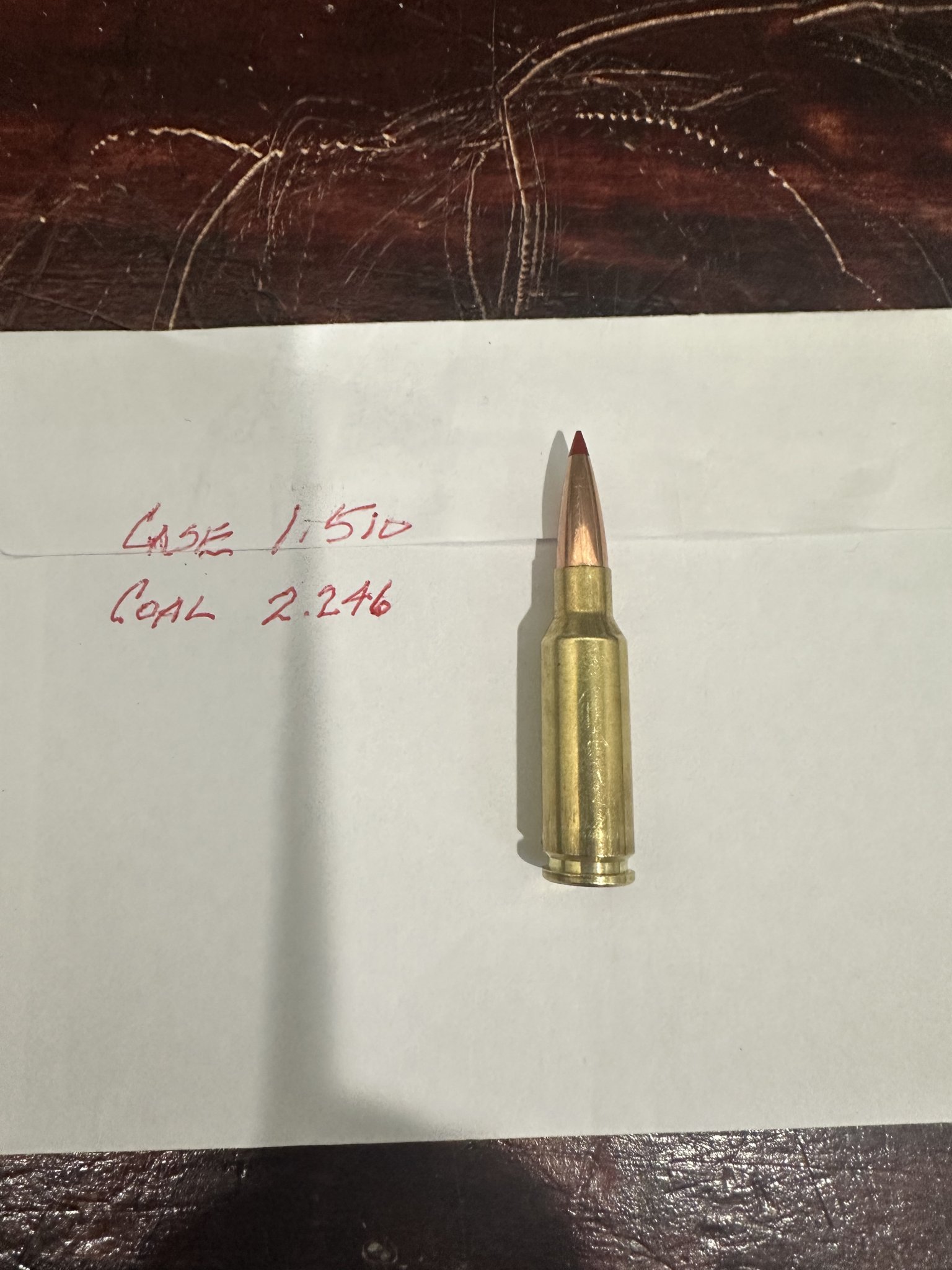

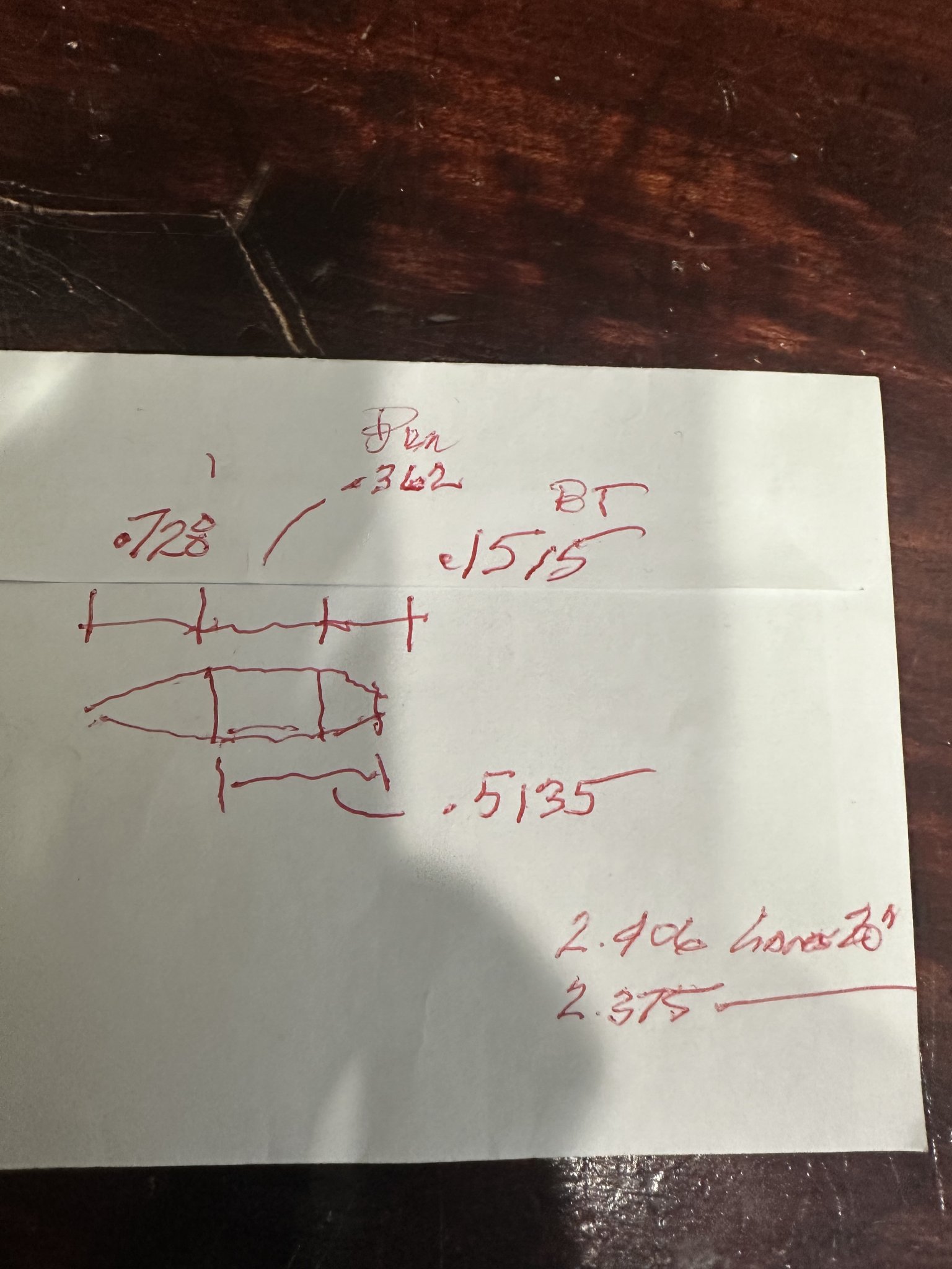

So I pulled the bullet on one of the Hornady 100 gr ELD VT Match rounds today. First the bullets current COAL = 2.246”
The bullet I pulled weighed 99.5 gr boat tail was .1515” base to ogive.5135” bearing surface .362 tip was .728”.
For its weight the bullet is long 1.2415”. Here is a pic next to a 107 gr SMK. The nose is long , where it is loaded at 2.246 the ogive is basically right at the end of the case.
I measured 25.8 gr of ball powder. Not sure what it is . But the SD’s are crazy low.
I put the bullet on a Hornady lands measurement tool. On my 20” BHW 1-8 had a COAL of 2.406 to the lands. My 24” BHW 24” 1-8 had a COAL of 2.375” my ACS magazine can load 2.30 my widowed PRI magazines can load 2.385” in the 24” barrel , I had to file down the barrel extension so the oversized cartridges would not get hung up.
Just for reference here is a pic of it next to a 130 gr RFF and a 140 gr RDF
