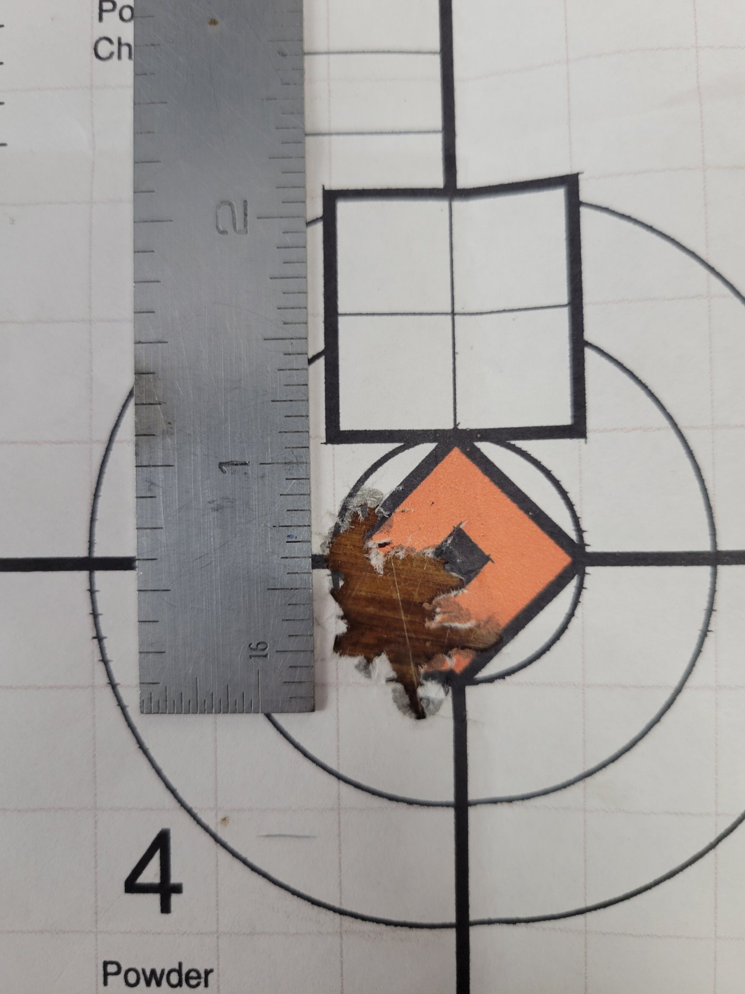

Just to add to the PVA experience, I am extremely happy with my barrel. I picked up a 6CM barrel on the July 4th sale, sent my action off (Mack Bro Evo) to have barrel cut for this action. I do like how they keep my action print on file and sent me a blueprint card so for my next barrel I just need to send them my serial # and the picture of the blueprint card and I do not need to send off my action.
I did the barrel break in per PVA which was very easy. I used some left over ammo which was loaded for my previous proof barrel and printed this 20 round group just so I can use of the ammo to reload for this barrel.

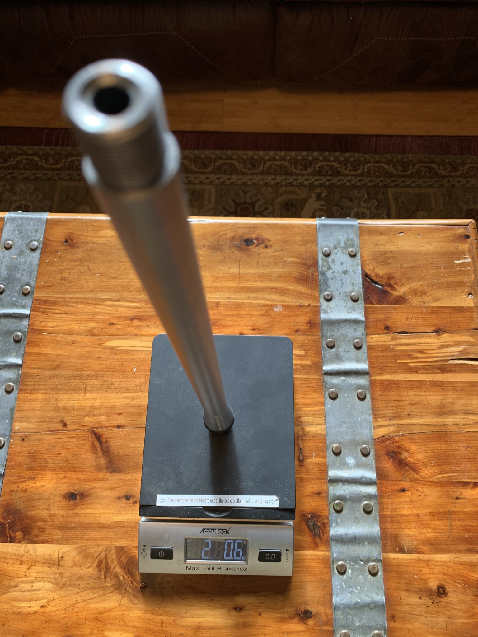

At 27" long the carbon blank, unchambered, weighs 3lb exactly for a 22 caliber barrel in the M24 variant
The Light Palma is close to 4lb
At shorter lengths the carbon loses weight slower than the heavier contours because you're cutting away steel that's 0.64" in diameter and carbon that weighs almost nothing. The Light Palma cuts away steel that is 0.75" or bigger
I don't know what a 20" carbon M24 is going to weigh without cutting one, but if I had to guess it would be somewhere around 35 oz
