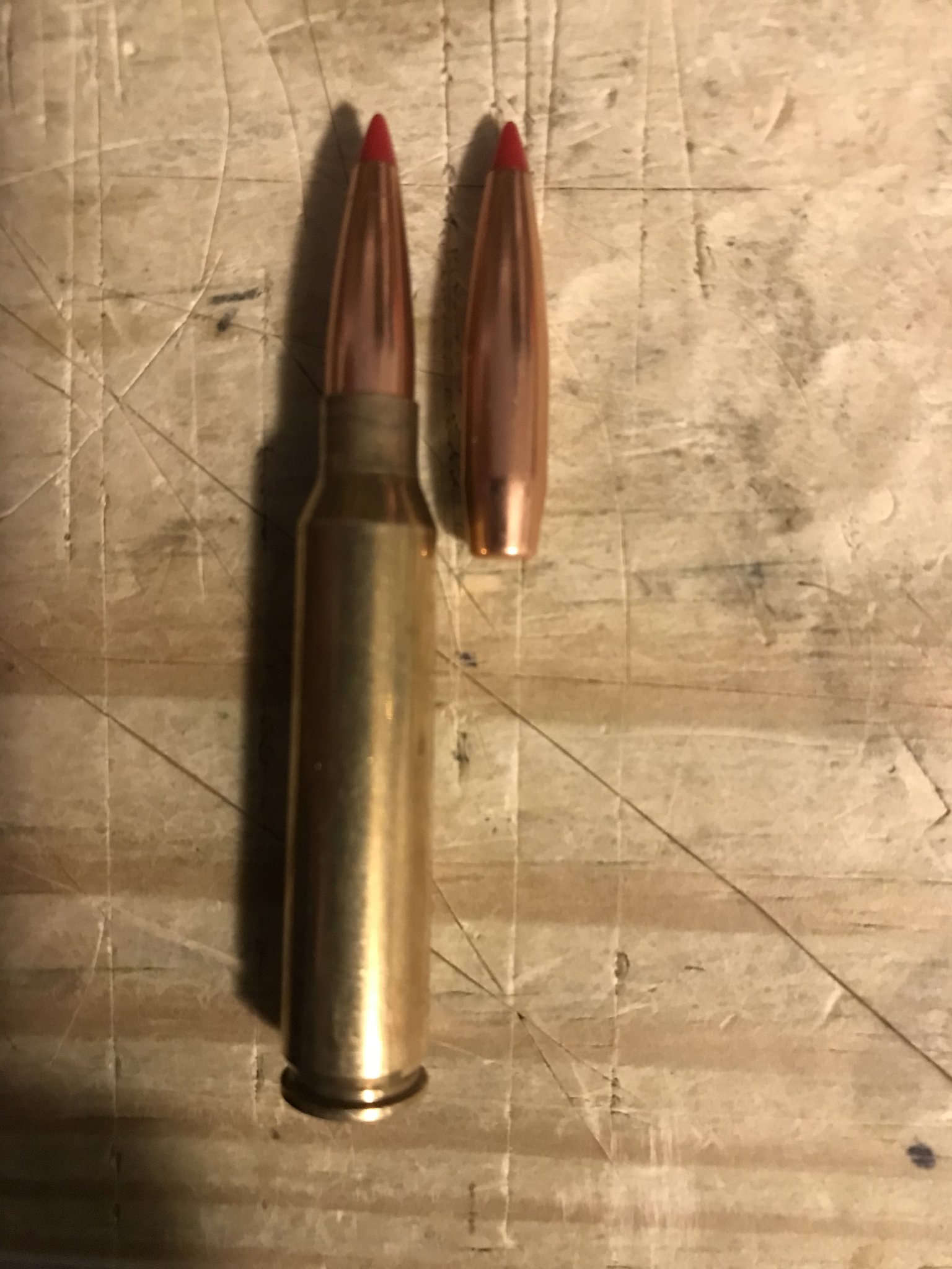

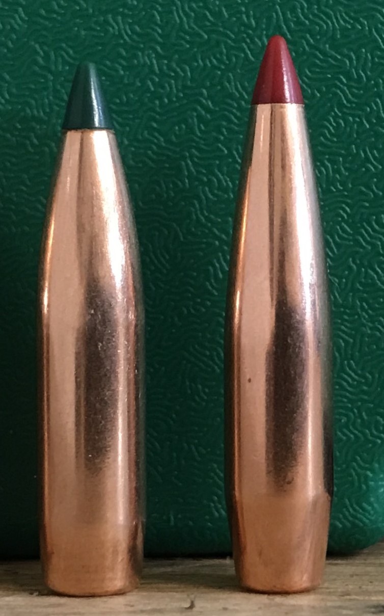

For reference here is a 77 TMK next to a 75 ELD-M. The .100" should work with the ogive being farther forward on the TMK.

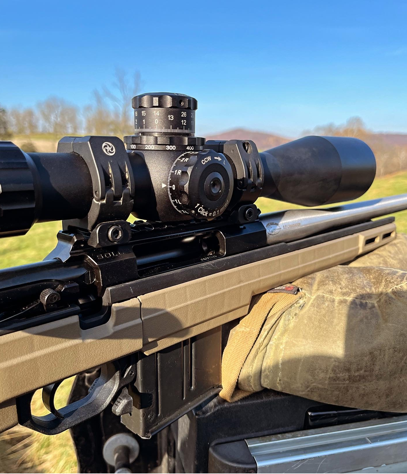

Finally shot out my PVA Rock Creek prefit and got a chance to put on the Osprey that I picked up from the FFTC sale. Ran 50 rounds through it on Tuesday, using a good shooting load from the last barrel and it didn't disappoint. Conditions were miserable, still managed to shoot small groups and hammer that 1/4 IPSC at 600 yards. The Ospreys seem to shoot just as well as the Rock Creek prefits so I'm sold. At this point, all 3 or 4 of my PVA prefits have shot identical, sub 1/2 minute when they're fresh and near the end open up to about 3/4 minute. Plenty good for most uses.
Glad you like it so far, the Osprey will continue to get better.
