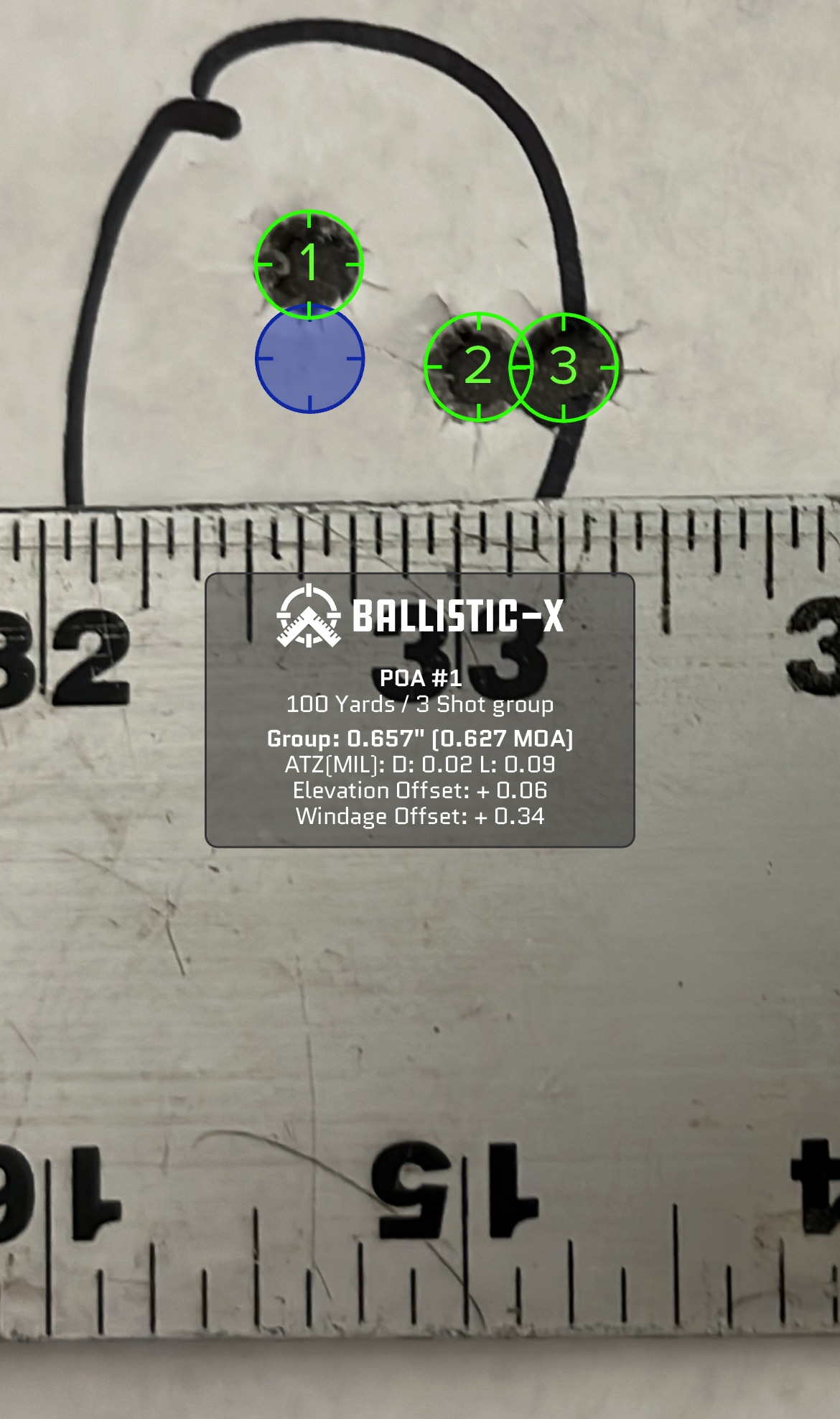

Finally got to take out the Tikka with the 6.5 barrel on. I was strapped for time and only packed 100g VM.
Suppressor to no suppressor no shift for this small sample and only this ammo.
Only one outing but very happy! Thanks PVA.

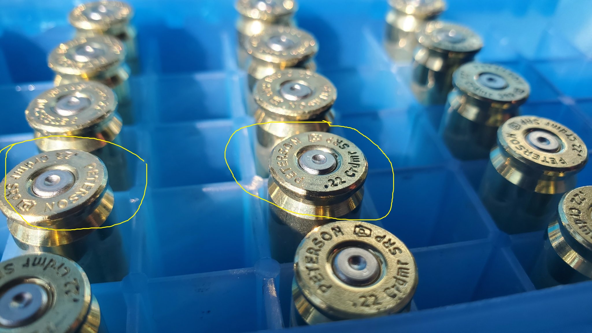

H4350. Barrel sped up 70fps and wasn't in previous node. I wasn't seeing any pressure signs on primers, so I tried 42.0, 42.3, 42.6, and 42.9. Here's the 42.6 primer row and chrony data:
I need to play with seating depth but this load was .5" and if you give me a mulligan, it was hi .3s for 4 shots. Here's 2 at 750:

Those are some Cratered Primers with that powder charge. Is the firing pin / firing pin hole in the bolt face clearance excessive ?
Yeah, we must not be looking at same pic. There is no raised crater around fp hit, smooth as glass. Edges of primers are still rd, they would be flattened at elevated pressure. First flattened edges, then blanked primers, then ejector swipes. Catered primers, ala factory rem 700, are really a poor indicator of pressure, more an indicator of fp clearance as you say. I'm not trying to be smart, but I honestly don't see what you're referring to.
Edit: here's another pic
Edit: here's another picView attachment 8403137
Perhaps this one from your original pic....rest look fine, this one....not so much. No?
Much better photo.
The CCI "B" stamp isn't smashed flat, and the corners of the primers aren't anvil-ed flat, so I wasn't thinking a gross overpressure situation.
I was looking at the two primers that were in focus ( Yellow Circles ) and the shading in the photo made me think excessive firing pin / bolt face clearance.
Lighting makes it look weird, easy for me to dismiss because I've got cases in hand and can drag a finger nail across and not feel any crater ridge.
