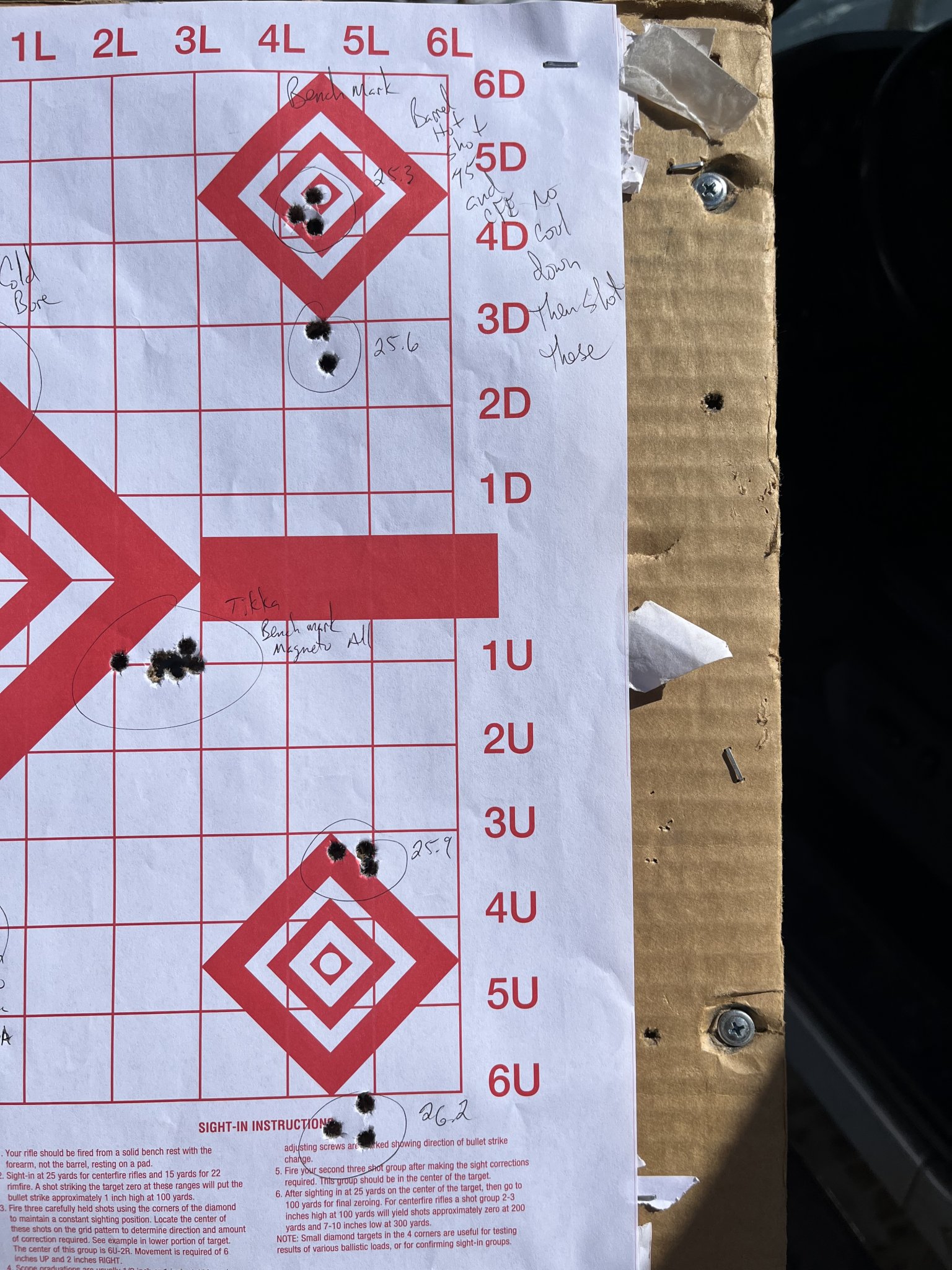

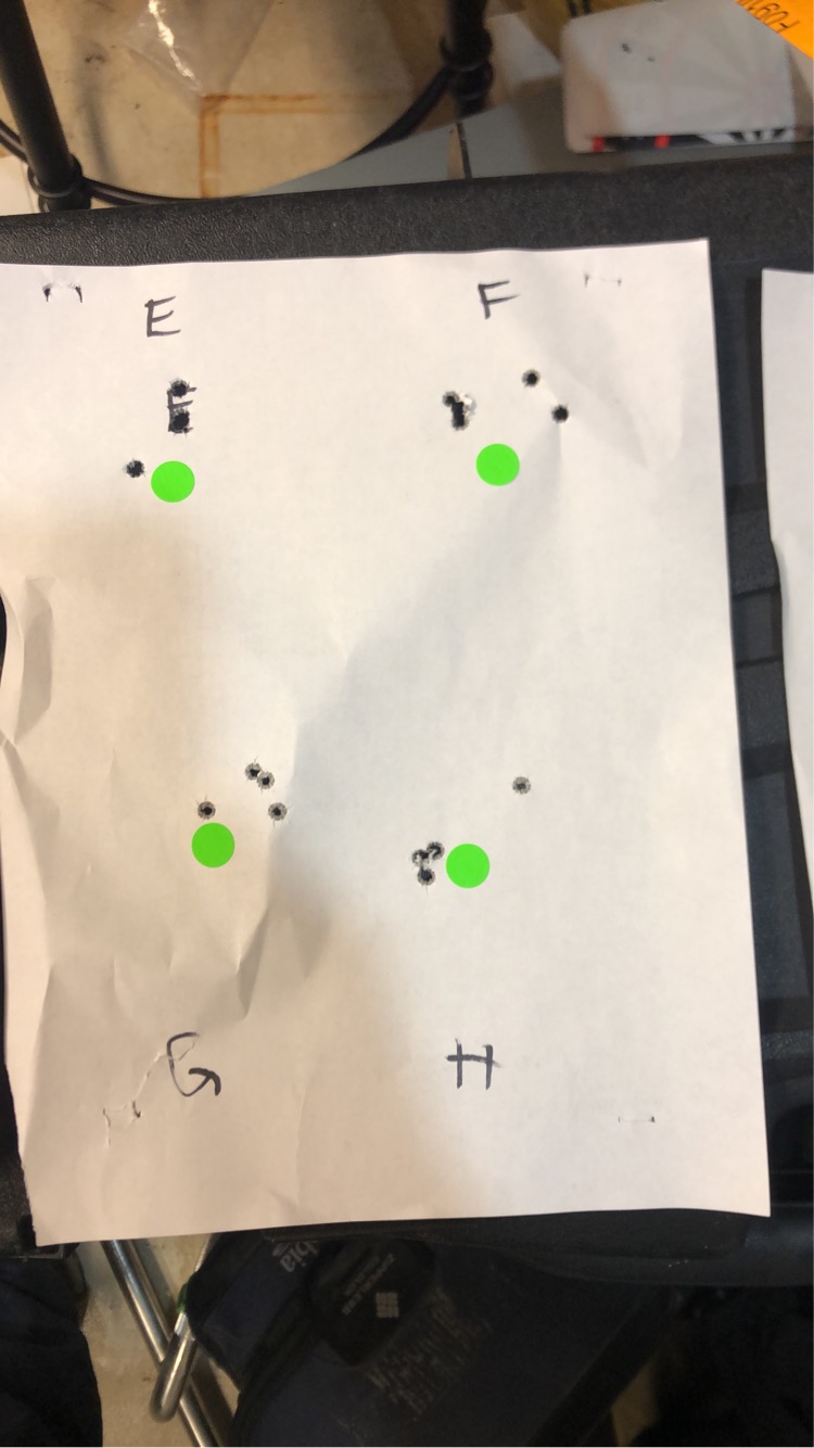

You’re going to love it. Trying a new powder today with my 223 PVA. 4 different charges and the middle left group is 2 rounds from each powder charge at 100 yards with my magneto speed.
These were shot after shooting 23 rounds straight and no cool down, the last group would be 35 rounds straight. The magneto speed group was probably 40 rounds later and was allowed to cool down before that.

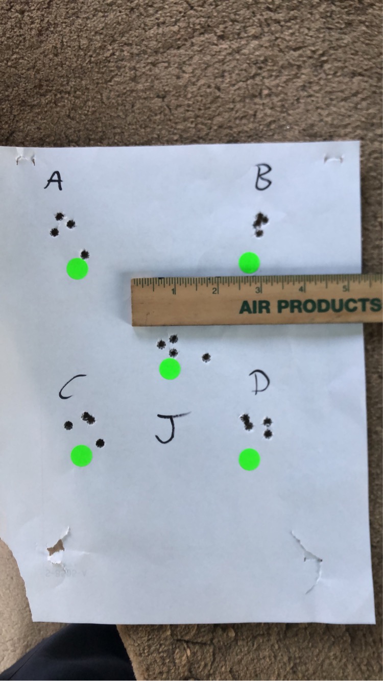

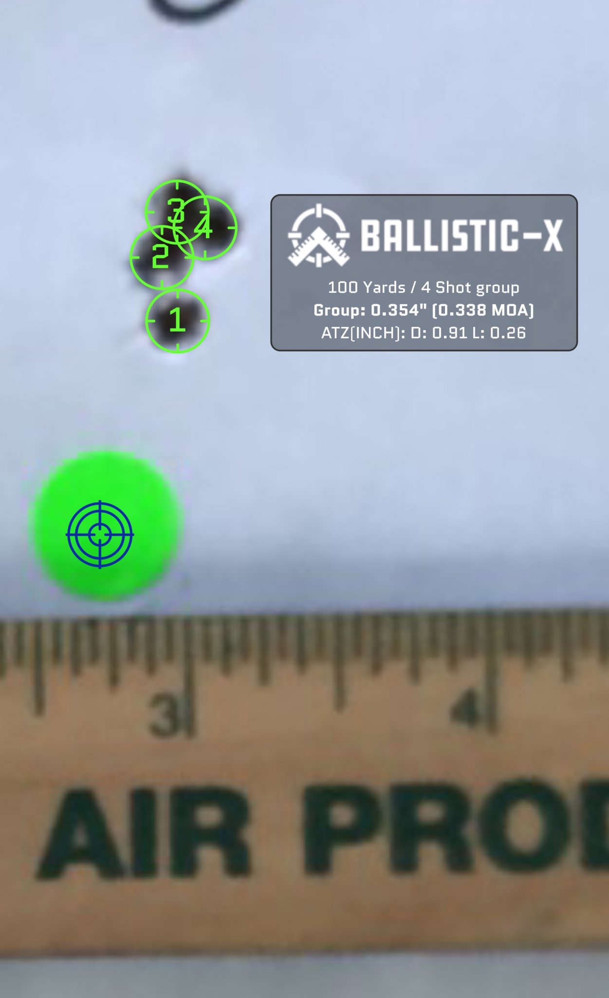

Put the first batch of varget and 75gr eldm’s down the barrel. 4 shot groups. One is really promising but only going a little over 2700 FPS according to the book , load b in the pictures. Another promising one is load h, going a hair under 2900, but again I didn’t chrono these. Load h also had a huge flier. I’m not the best shot but I dont think that was me, and Iv gotten good groups from rifles before. Should I load up h and do different seating depths or scrap this combo all together? A-h is .3 gt incrimemts.
If you're changing powders or bullets while you're doing load testing you should be cleaning the barrel, fouling a couple shots, then testing the load. Switching bullets and powders during load development without cleaning can make you want to put bamboo shoots under your fingernails. I've learned this the hard way.
Reactions: kampr
Ok, thanks for the tip. For this barrel I broke it in per the website, then shot some 77 grain black hills through it. I then took all my measurements and then cleaned the barrel like the break in with just patches to make sure nothing got in there. I loaded 5 rounds of each snd used 1 shot from each to foul/check for pressure. Then I did 4 shot groups with the remaining ones from each load. There’s about 90 shots down the tube now. I think I’ll try my load H again with a few tweaks in each direction and if that doesn’t show promise I’ll clean the gun and switch things up.
Reactions: Narf
You're making me question my life choices now....

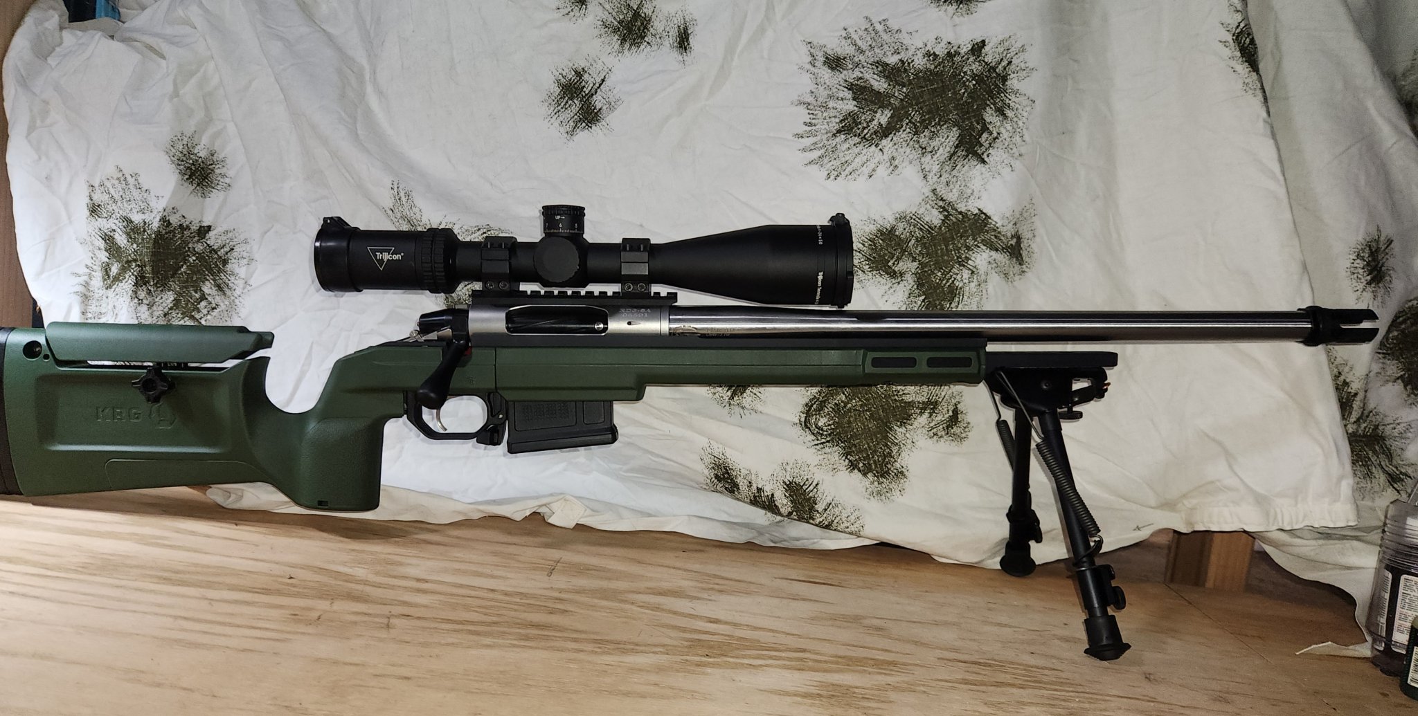

Got the barrel Thursday, had it torqued on that afternoon. First time using a shouldered barrel. Checked headspace and it was perfect.

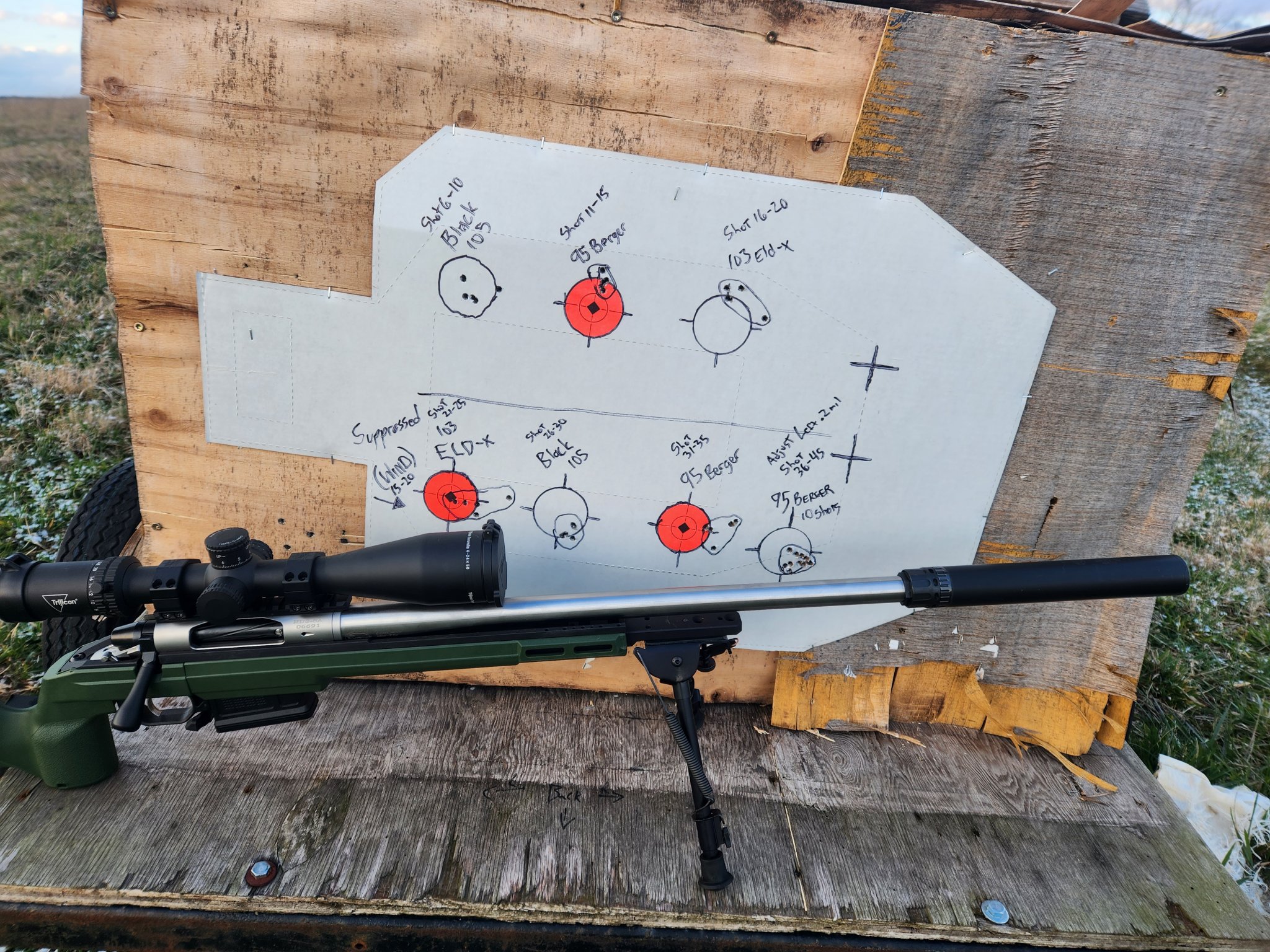

Out now breaking it in as per PVA recommendations. First 5 shots at 100yards. Red circle is eyeball boresite. Adjusted and next 4 shots are just left of the bull.
Needless to say I'm very happy so far, especially in 20mph crosswinds. Hornady Black 105gr
Shot 45 rounds total today. Barrel seemed to like Hornady Black 105gr and the Berger 95gr Classic hunters. Didn't seem to like the Precision Hunter 103eld-x.
But the weather got pretty nasty during break in, so hard to be 100% blame goes to the ammo or the shooter. Wind was constant from 9 o'clock changing back and forth between sunny 10-15mph and gusting 20-25mph with snow. Kept blowing off my orange stickers

Yes I read the post about the cleaning and foulers. I did clean every 5 rounds for the first few groups for break-in.
Shot 1-5 Black - Cleaned
Shot 6-10 Black - Cleaned
Shot 11-15 Berger- Cleaned
Next 2 groups , (Shots 16-25) were all Eld-x
So the 105 Black and 95 Berger showed potential shooting good 5 Shot groups during break in, after cleaning (without fouler)
103 Eldx - Shot the two 5 Shot groups after cleaning and both were larger groups when cleaned+fouled but could have just been ill timed wind gust that opened them up.
Yesterday was mostly about barrel break in, and getting some rounds down the barrel before load development. Which is one reason I bought the Berger factory rounds was for the Lapua brass, the loaded ammo on sale wasn't much more than virgin brass. It shooting nice is a great plus.
I think the initial outing showed the build and barrel have nice potential.

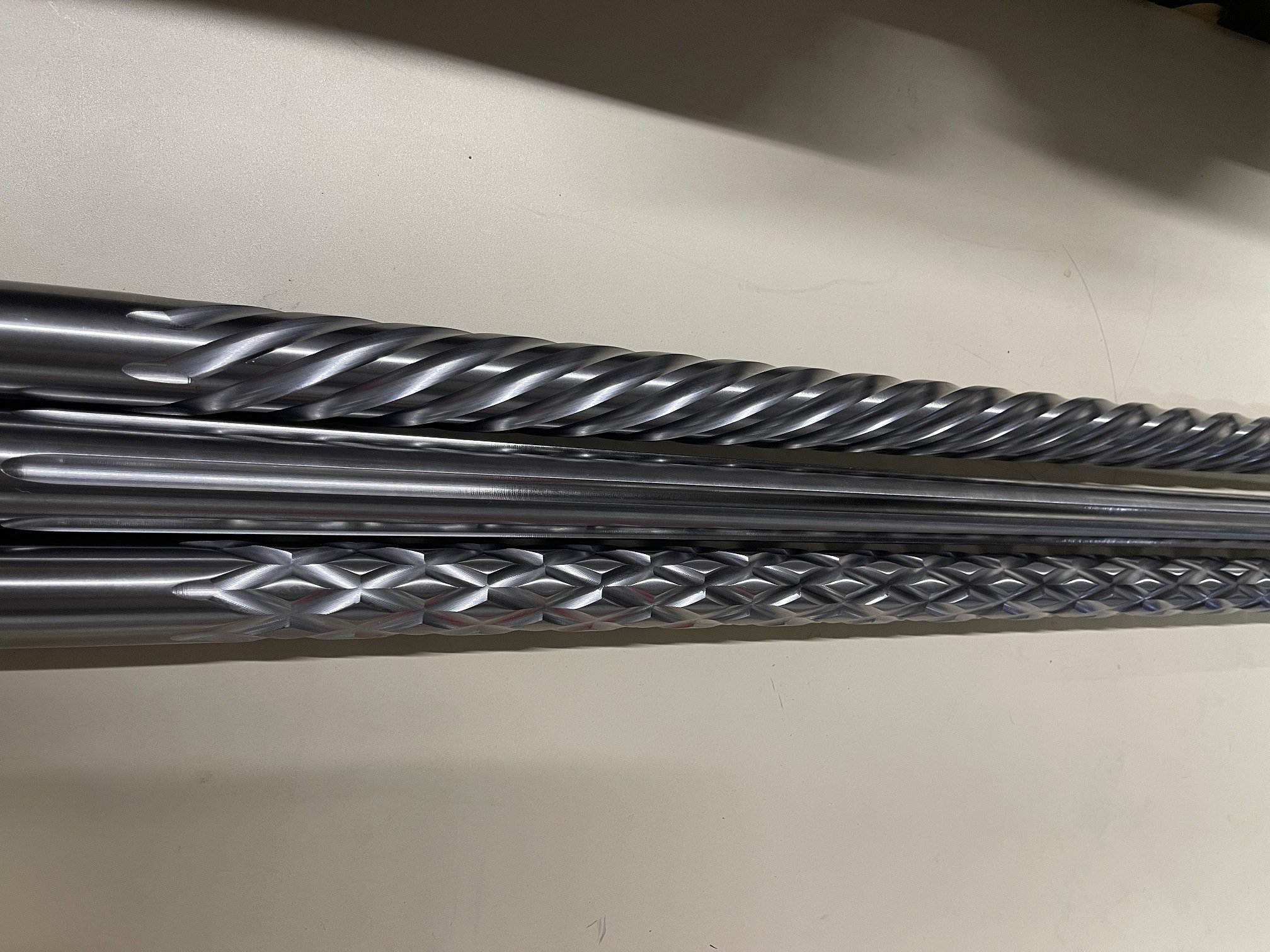

Next product/service announcement:
Fluting is available for all prefits and for customer supplied blanks. We are not fluting factory barrels.
