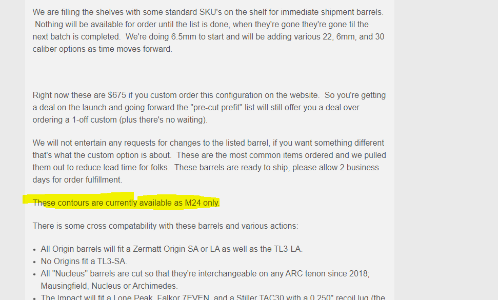

Does anybody know what countour the “ready to ship” osprey prefits are?
m24
Reactions: nrspence
Mostly they're M24
There are some 6.5 PRC's in Light Palma that were done as hunting barrels, we probably won't do them again as the few that are left sat for 6 months.

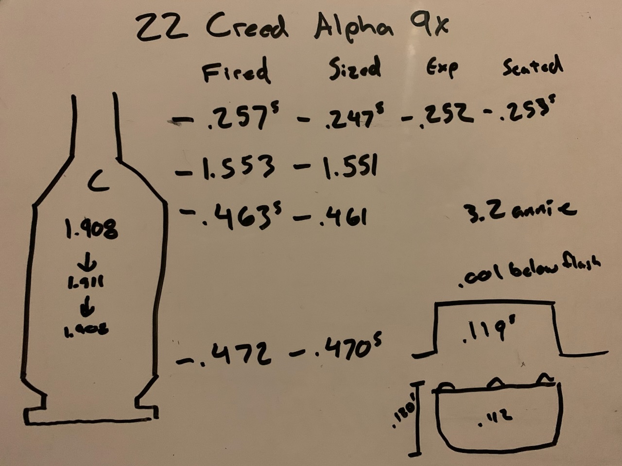

Anyone have a 22creed PVA prefit?
Looking for info in regards to the neck diameter it’s reamed to. Wondering if I’m going to have any issues using alpha brass at approximately .252 loaded diameter.
Alpha works fine in it. Our 22 Creed is a little bigger in the neck than some might think is necessary. This is not an accident or mistake, there are deliberate reasons why the reamer is setup as it is. The results are excellent.

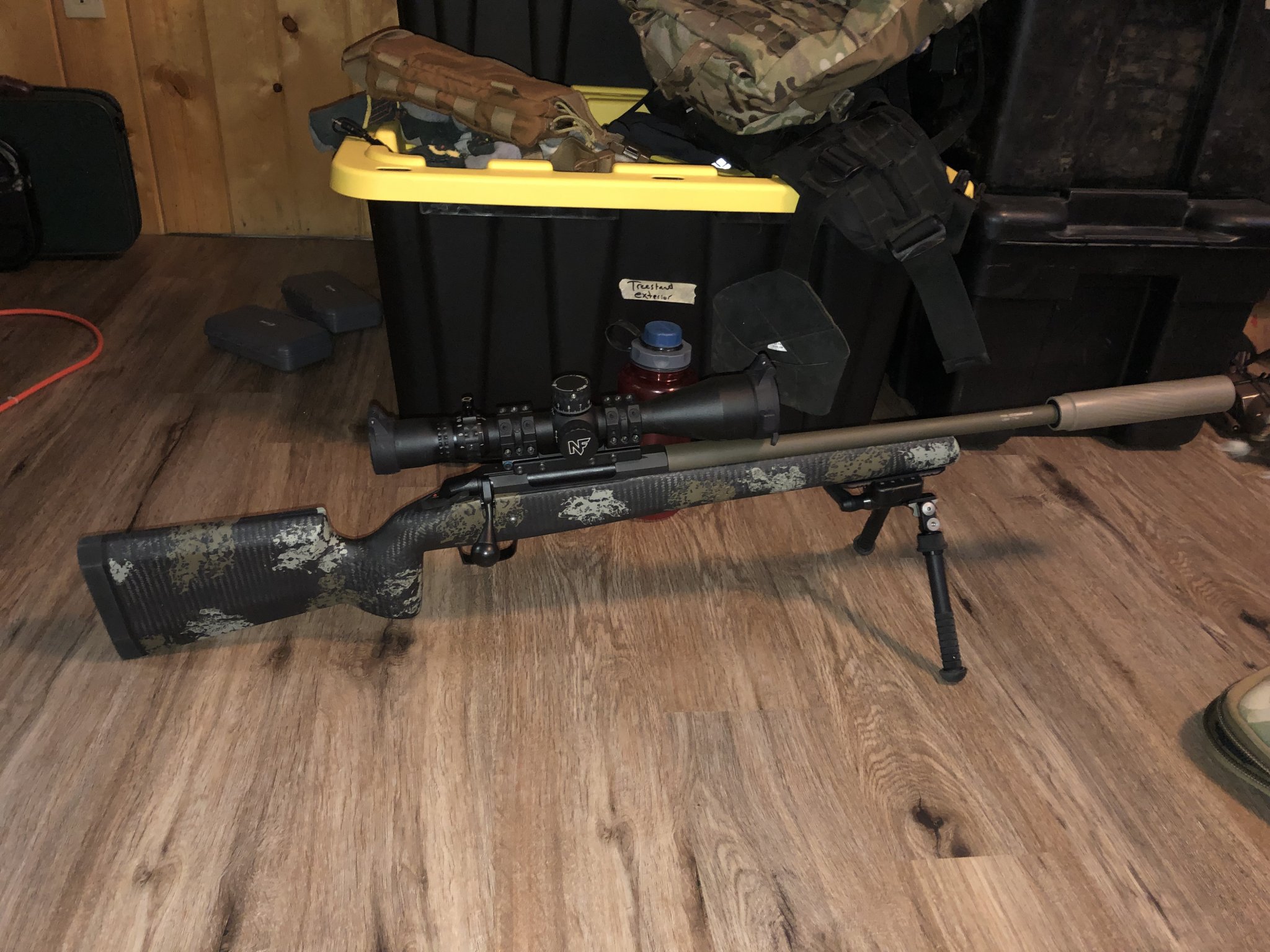

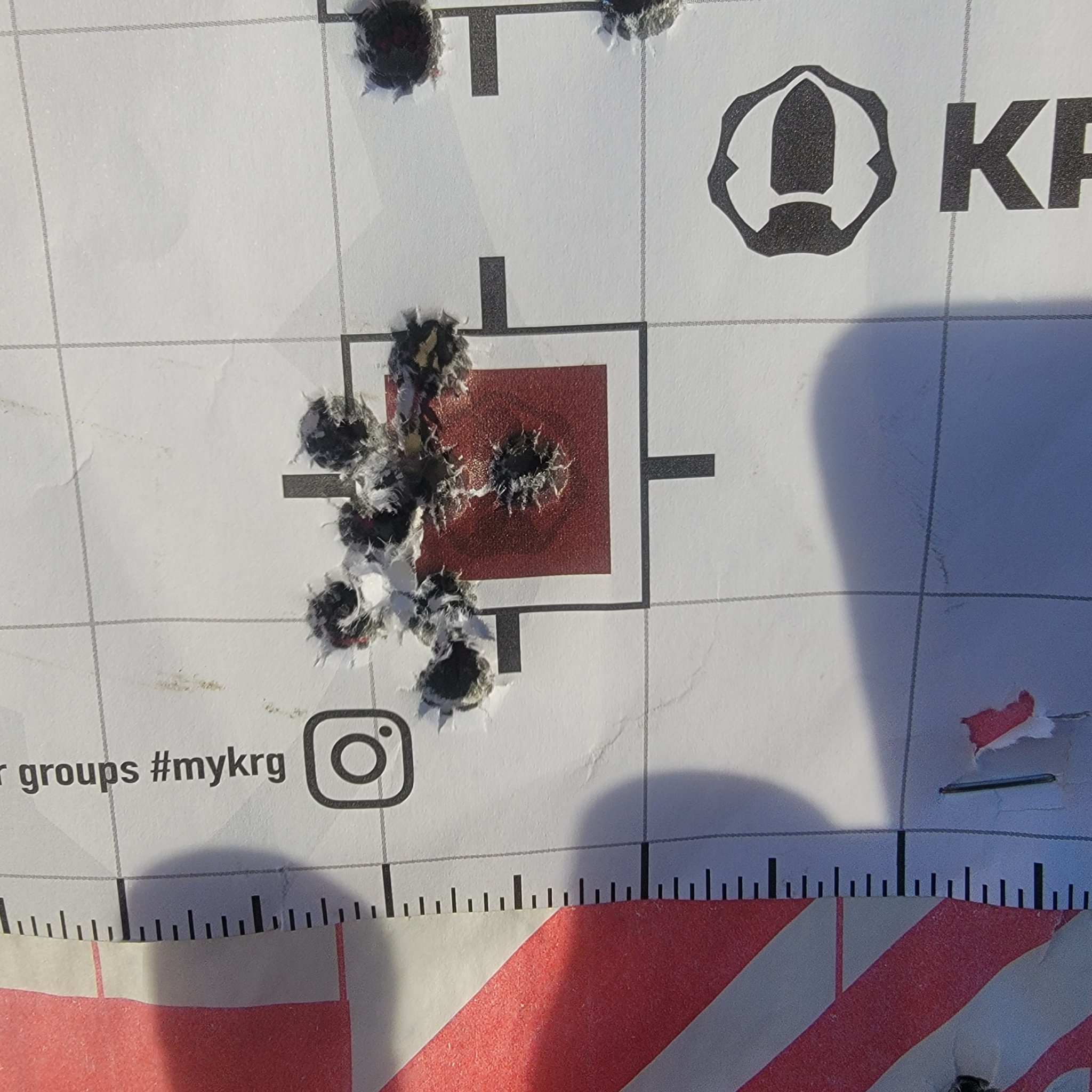

14 plus shot group with my 7mm prc prefit. Most with supressor and a few with a brake. 180 eldm factory ammo. Testing handloads soon. Those are pretty much the first shots besides getting on paper and zeroing in.
