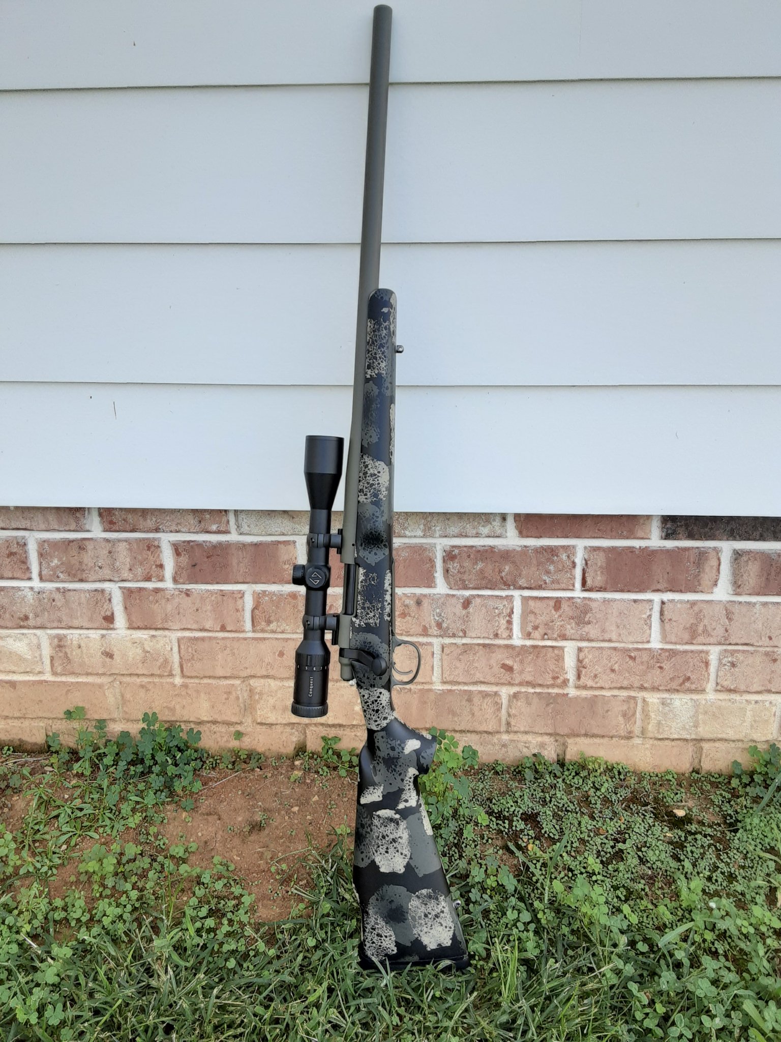

    I had mine built by Meredith rifles on a single shot 700 action using Jeff Hankin's breech plug and modules. Looking back I should have had Tooter thread the barrel for my Origin since our muzzleloader season is only two weeks long. Shooting a Pittman 278 grain bullet with H4198 at 2610 fps. It will go faster but it's more recoil than I care for.
