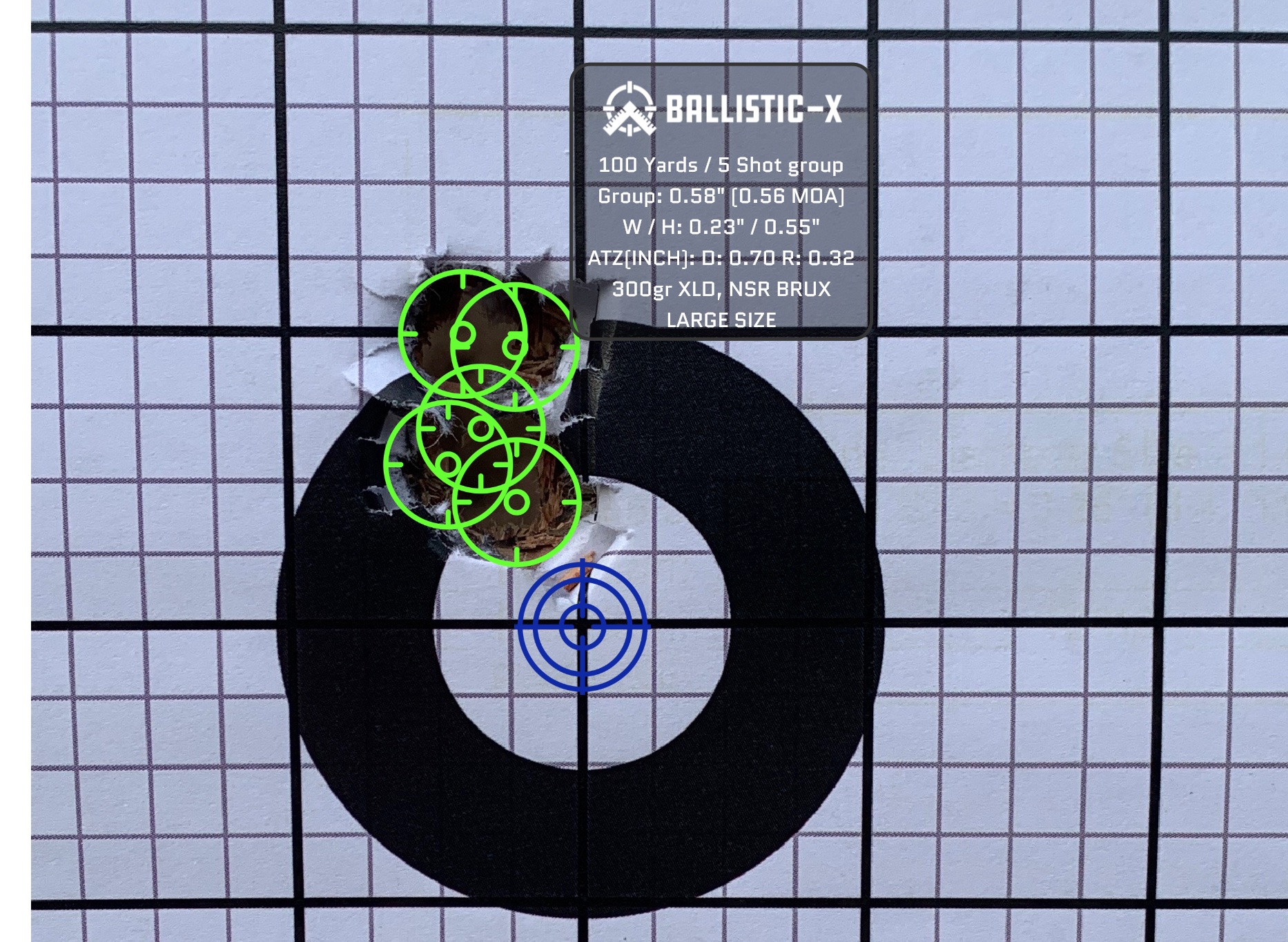

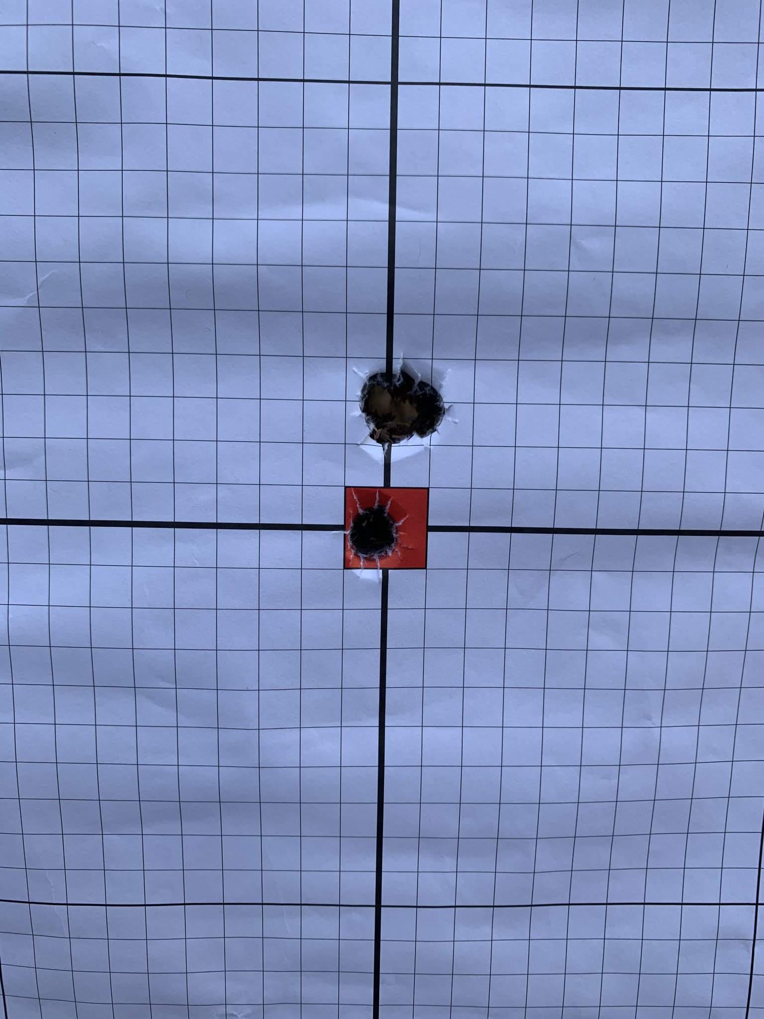

I started with 80 grains of H322 and never had to adjust on my arrowhead build.

I am designing based on an 18tw because of the commonality of it. Most 45 caliber rifles are 18s
The pistol based bores are slower, usually 20s and 24s. I might put something together for them down the road but for now I am focusing on the most prevalent rifle caliber twist rate.
