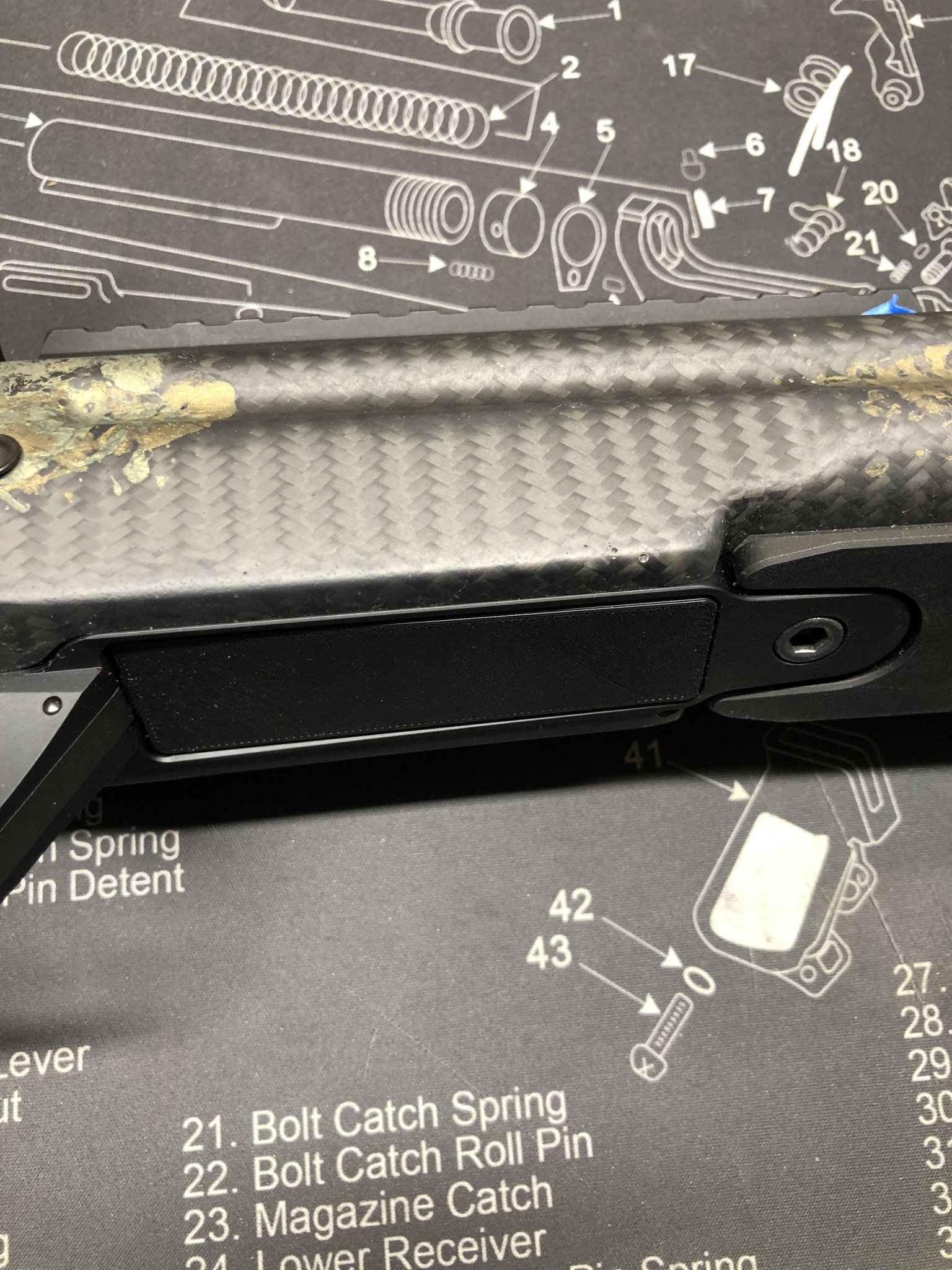

I'll be building one of these on an Origin with an HLR T3 lug. Got an EH1 w/ M5 minichassis at Manners for a couple additions and modifying the barrel channel for this. Got a Hawkins hunter dbm on it so I can spin on another caliber barrel In the meantime. Also mocked up a single shot sled to fit flush(close enough) with a Hawkins hunter DBM. (Pic is the same bottom metal on an LRH).

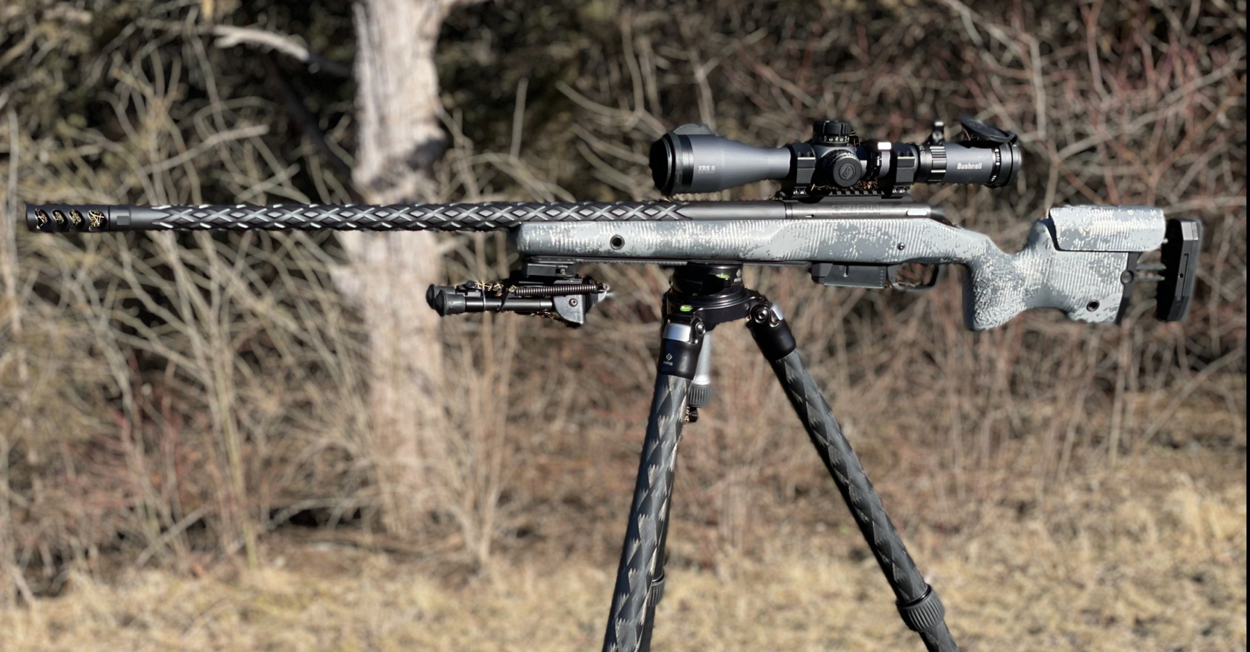

I never posted a pic of the finished product, got it back from LRI around February for fluting and cerakote. I can’t wait for the Kansas Muzzle-stuffer season in September!

I never posted a pic of the finished product, got it back from LRI around February for fluting and cerakote. I can’t wait for the Kansas Muzzle-stuffer season in September!View attachment 7866207
That thing is sexy. What barrel Contour/length did you go with?
