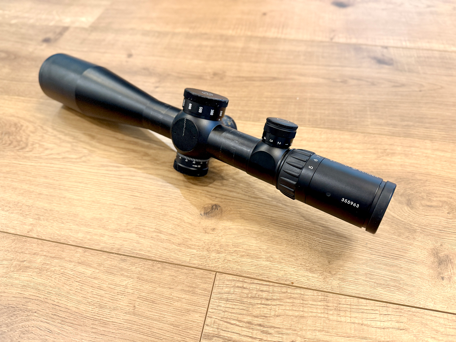

SOLD Schmidt and Bender PMII 5-25x56 P4FL
Selling a Schmidt & Bender 5-25x56 PMII with illuminated P4LF reticle and mil/mil double turn turrets. The scope is in great condition with a few exterior cosmetic blemishes from normal use. The glass is flawless and the turrets are crisp. Comes as shown.
SOLD
No trades please.
