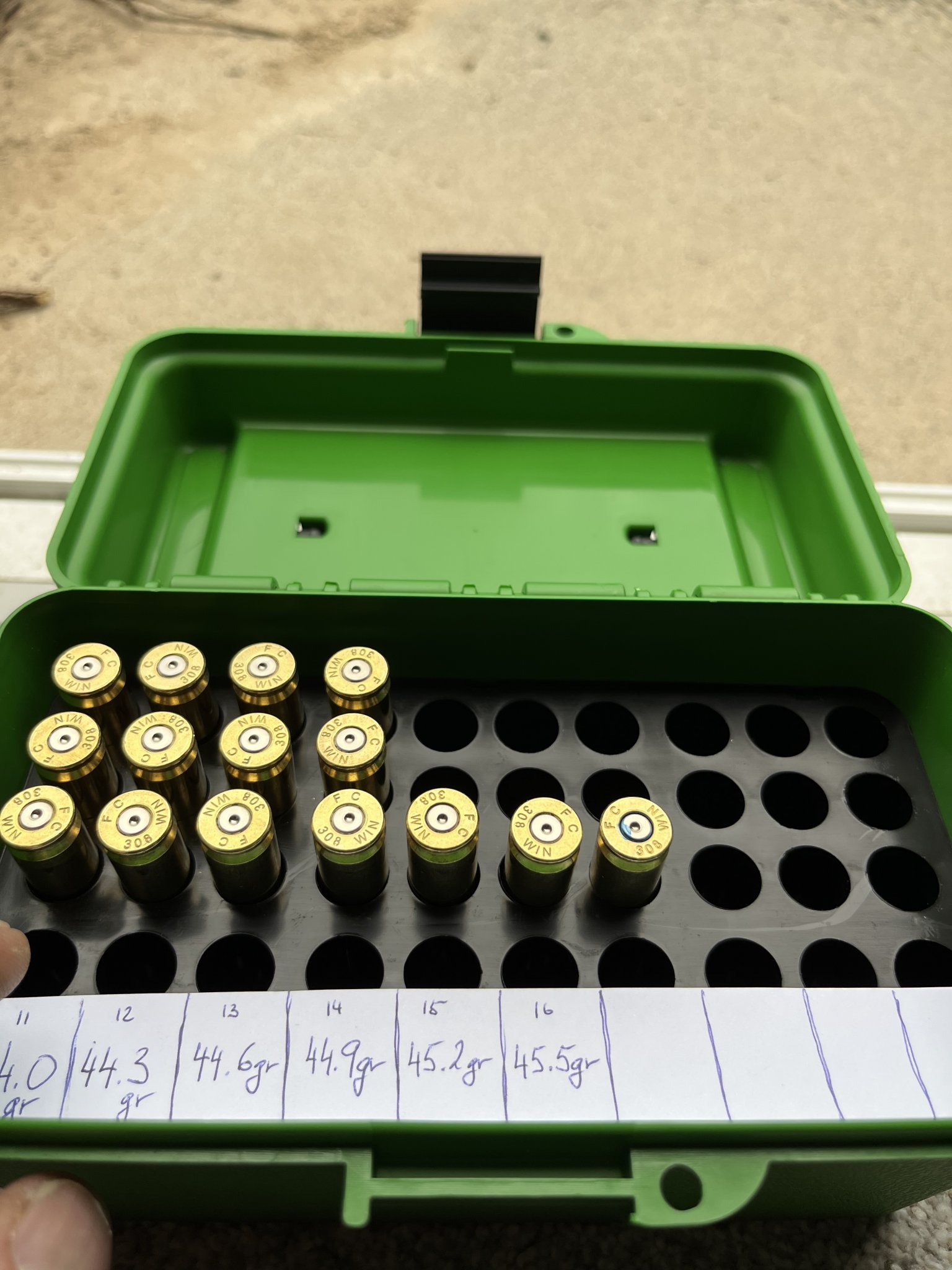

Ammo:
I used the Berger 144 LRHT, 4350, CCI BR SRP, @2780fps.
Reloading:
-1F & 2F brass Cleaned with 2X 1hr in steel pins with dawn & lemishine.
-Sinclair primer pocket uniformer. VLD interior neck chamfer only.
-Lube was hand rubbed 25:1 99% isopropyl and "One" brand pure lanolin brew.
-Dies were cleaned every 50 rounds, with a fat swap dipped in isopropyl. "Once per tray, every step of the way".
-Bump shoulder to free bolt drop, neck bushing to .2620 inside diameter, expanded to to .2630 inside diameter. Whidden dies, Sinclair expander die.
-Necks were cleaned religiously with a 9mm nylon bore brush in a drill. 4 swipes at full rpm.
-Charges dropped with an Autotrickler, and yes, I dropped single small grains to get within .01 grain. It matters.
-I used a single sacrificial bullet with jewelers rouge compound to blend the Whidden seater tip to the bullet profile. Bullet in a drill, took 10 minutes.
-Seating 20 thou off lands. 15 thou had pressure, 24 thou had group dispersion. ****Your settings will vary.
-Bullets were handled with lube wet fingers prior to seating, to ease seating effort. This works, and resulted in ES's 2-3 fps lower than dry necks and bullets. This did not effect average speeds.
-All rounds wiped with microfiber cloths damp with diluted isopropyl prior to final measuring and boxing. This matters.

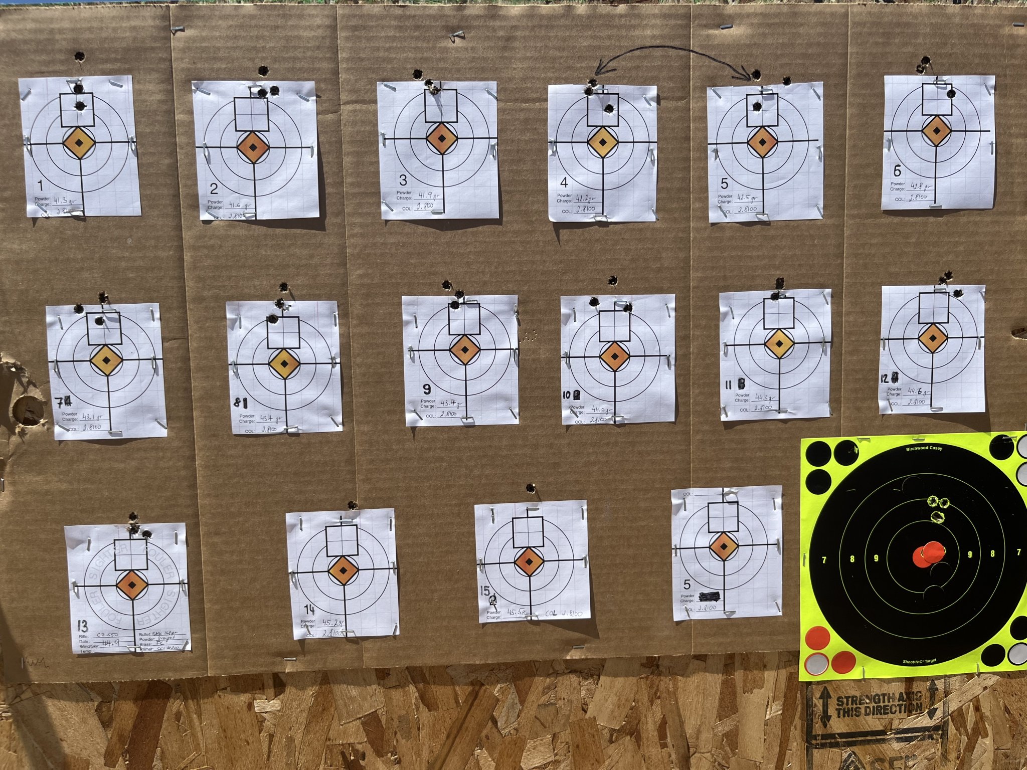

Full load development was almost 200 rounds of testing. 20 shots averaged 2870, and I adjusted the load for each brass type to get stable velocity between brass types.

-Velocity plotted for cold bores after 50 fouling shots. Cold bore is +100FPS. Max velocity at 10 rounds from fouled cold. Stable velocity at 80 rounds fouled.
-Accuracy spreads at 240-280 rounds, from 1/8 moa to 1/2 moa, so I clean at 200 to give me a predictable 160-ish round window, enough for a 2-3 day competition.
-Carbon on the barrel interface with the shoulder seemed to be the biggest cause of velocity swings and pressure signs, barrel not so much.
