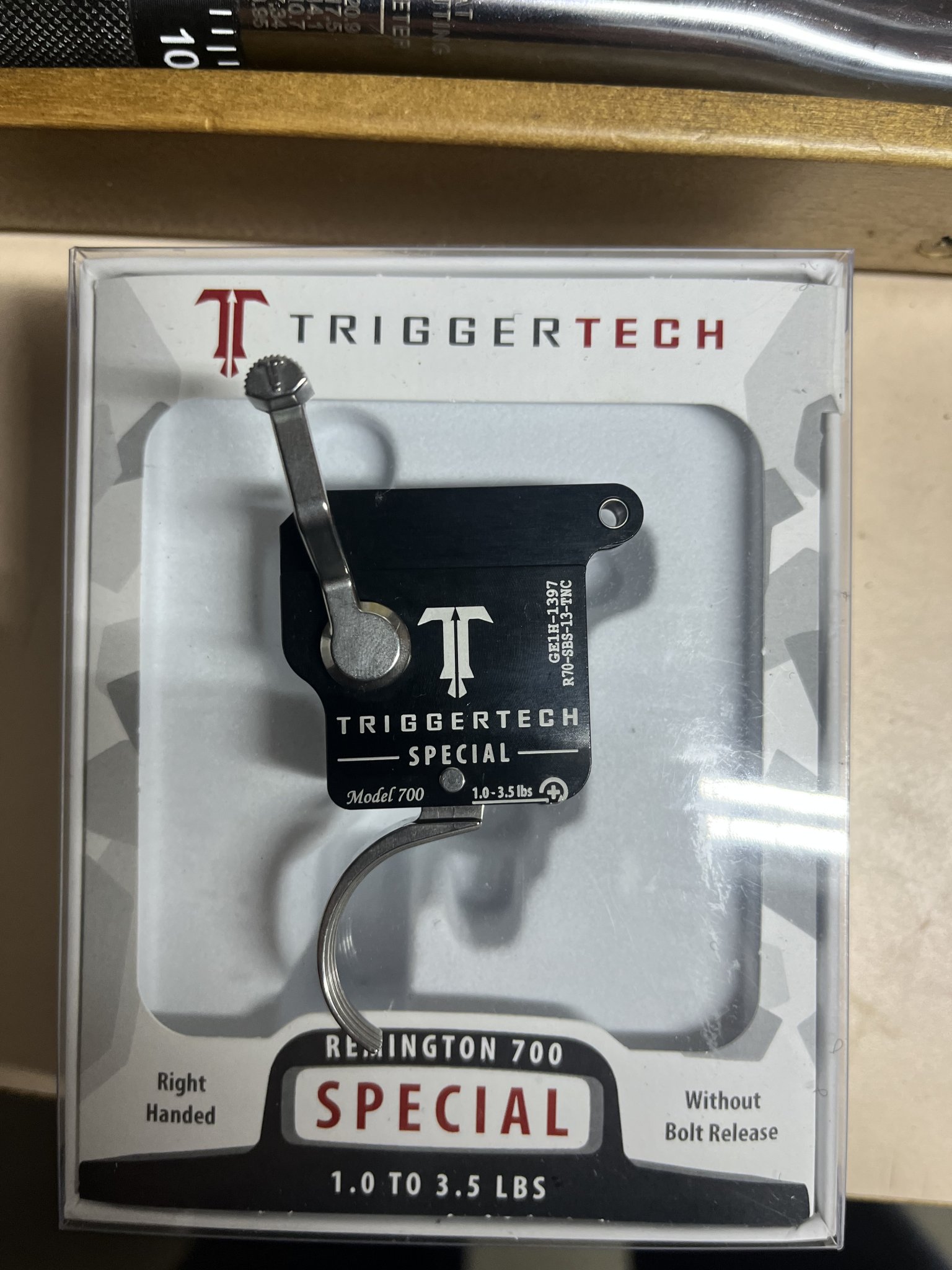

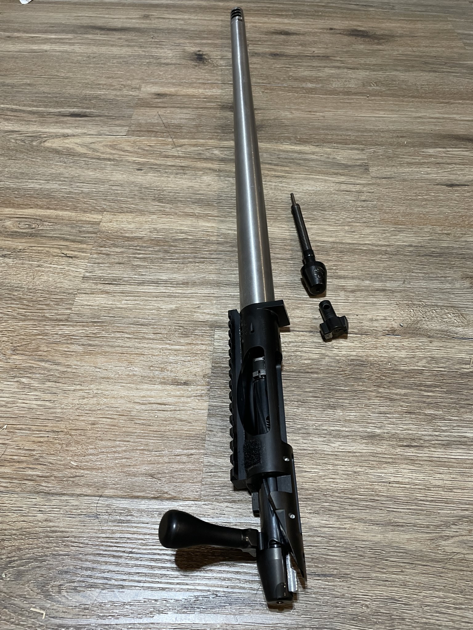

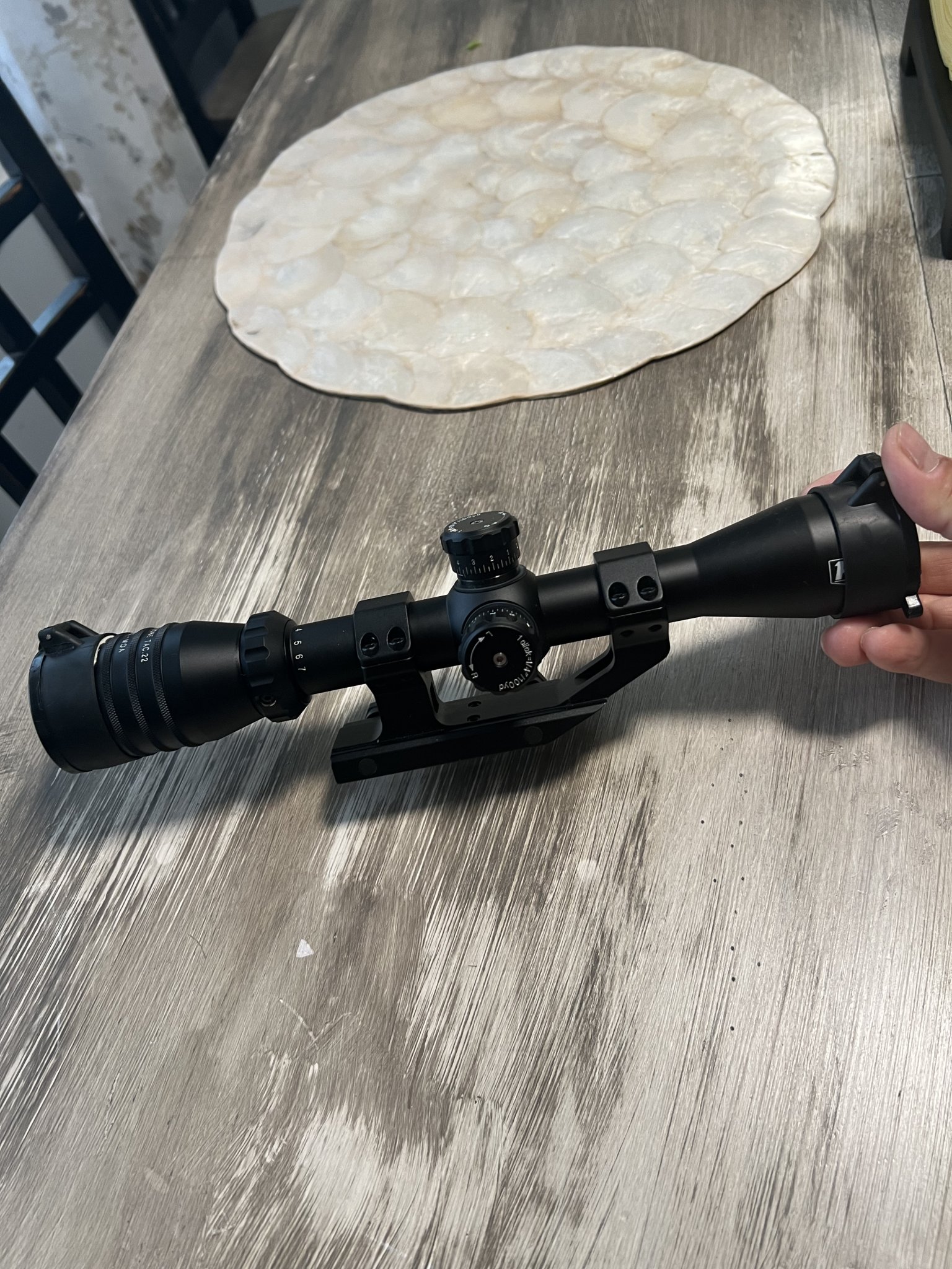

Manners t2a with mini chassis
Bighorn origin. With tactical know in 308 win zero rounds on the action
Krieger m24 1 in 9 twist 26"non threaded
Trigger tech special flat face
Harris 6-9"
10 round metal mag ai
Vortex viper pst 6-24 mrad
Wheeler rings
It won't fit in the case fully assembled so I separated it from the manners
It has 0 rounds on it
Looking to trade for a full size nighthawk custom 5" 45

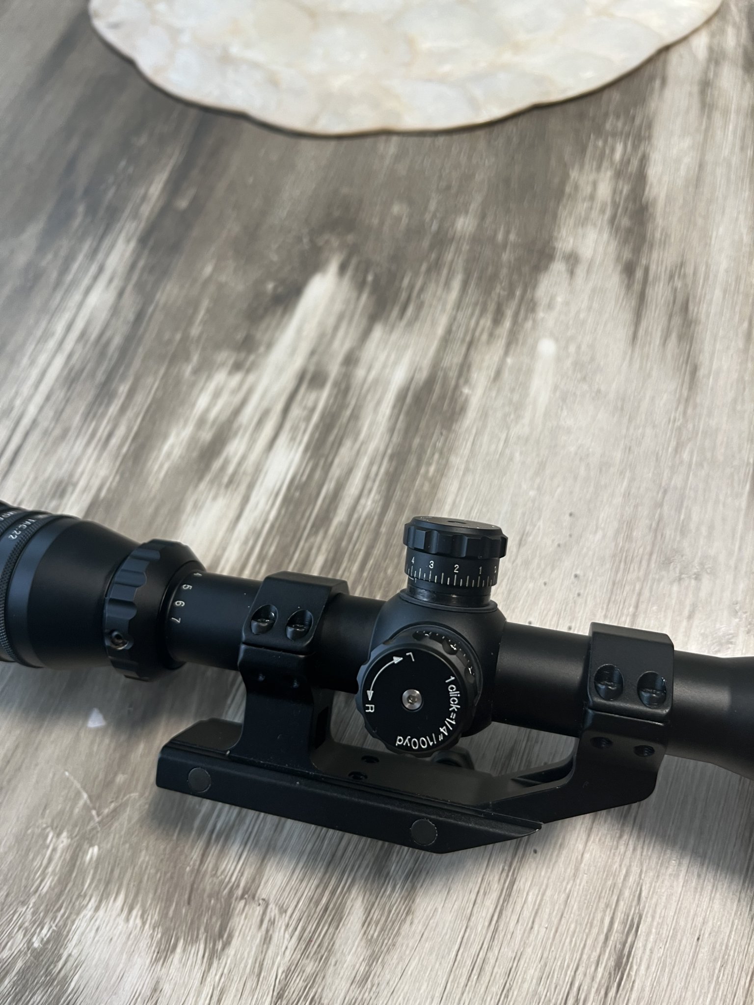

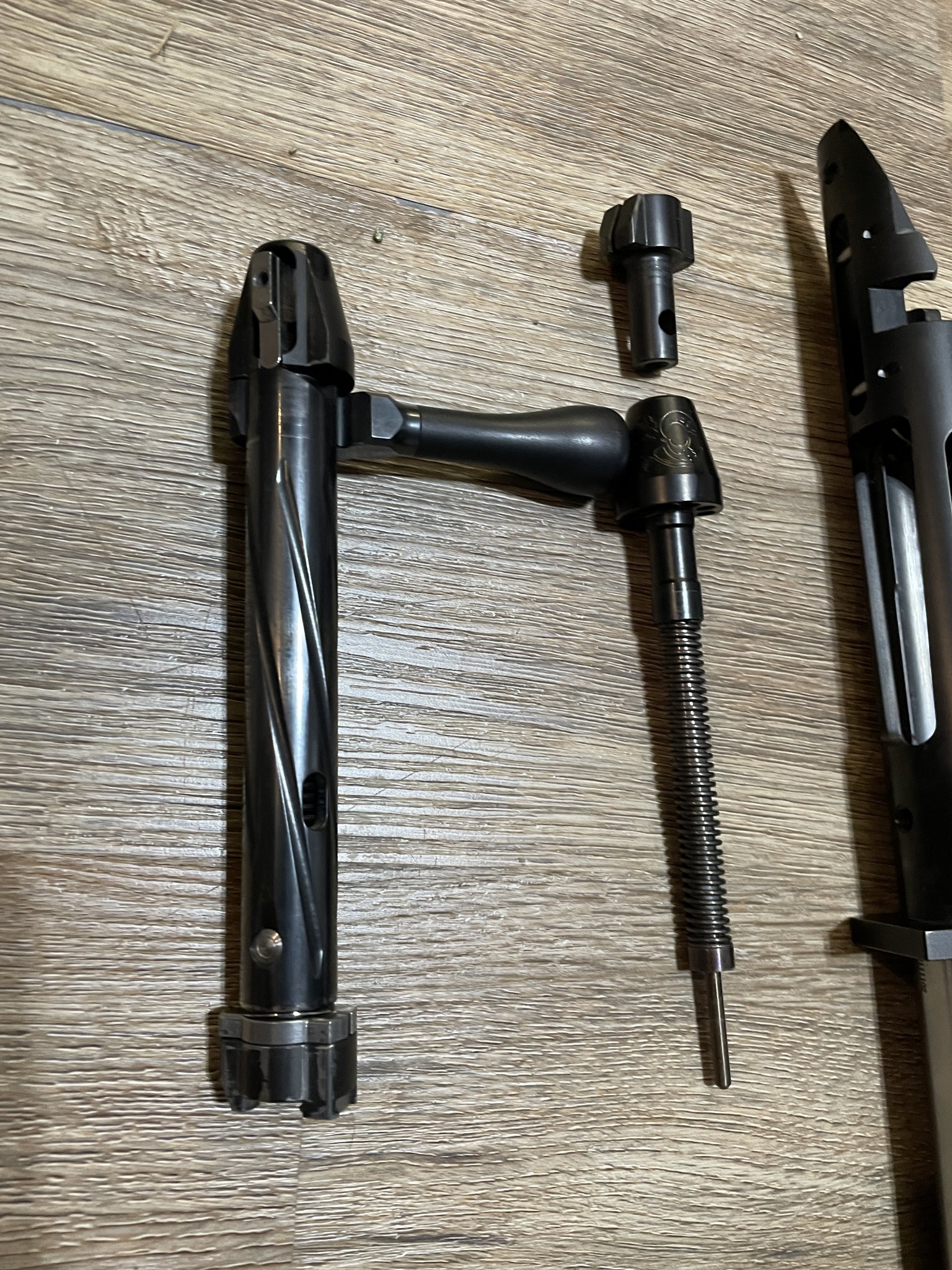

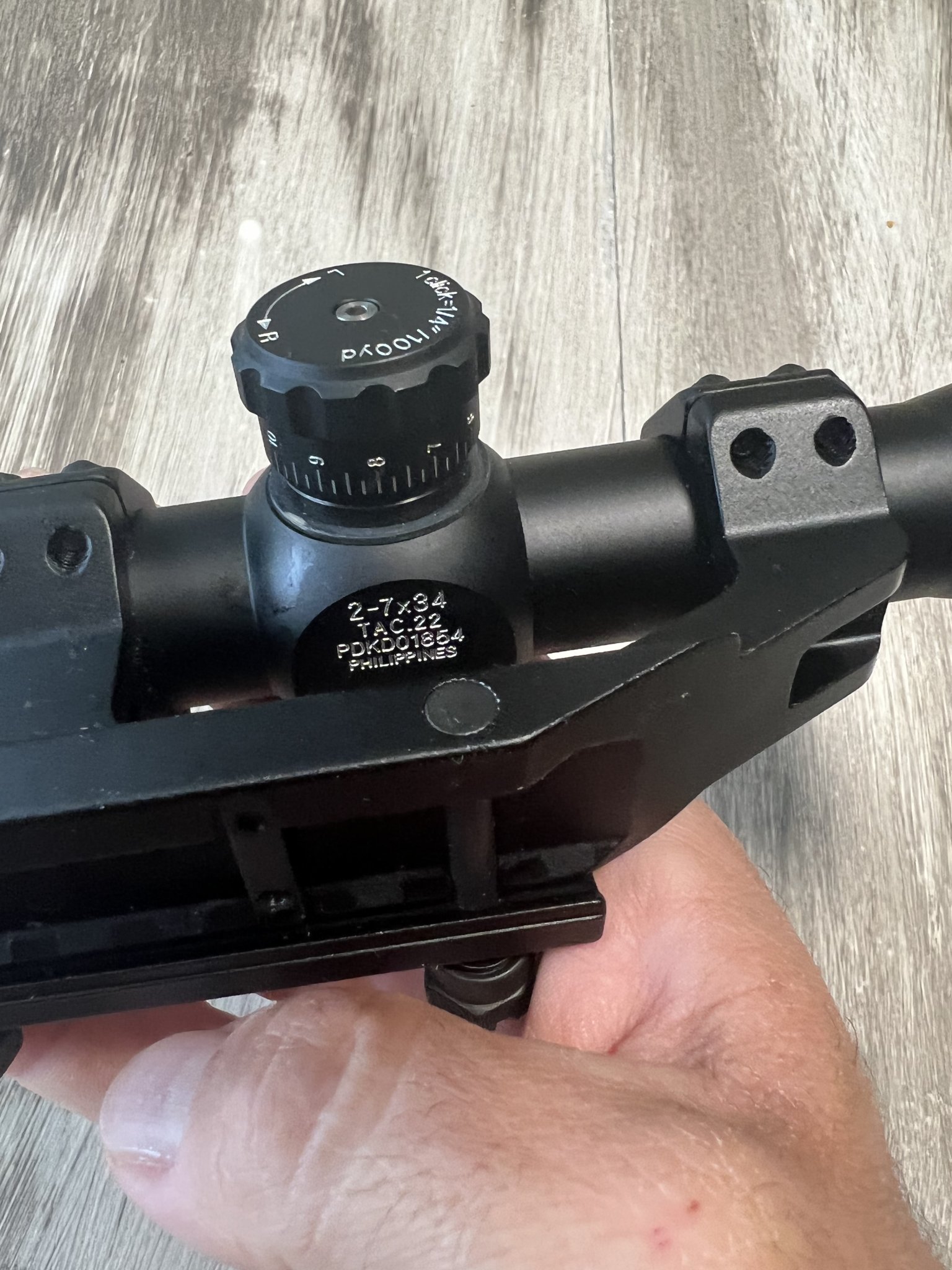

Rimfire Vudoo v22 Sold
Vudoo V-22 for sale with a Bix n Andy Tac Sport pro set around 6oz.
This has a 22” B barrel Threaded 1/2x28. I’ve had it almost a year and haven’t even shot an entire brick through it.
$1850 shipped CONUS
PayPal friends or family or add the fee.
