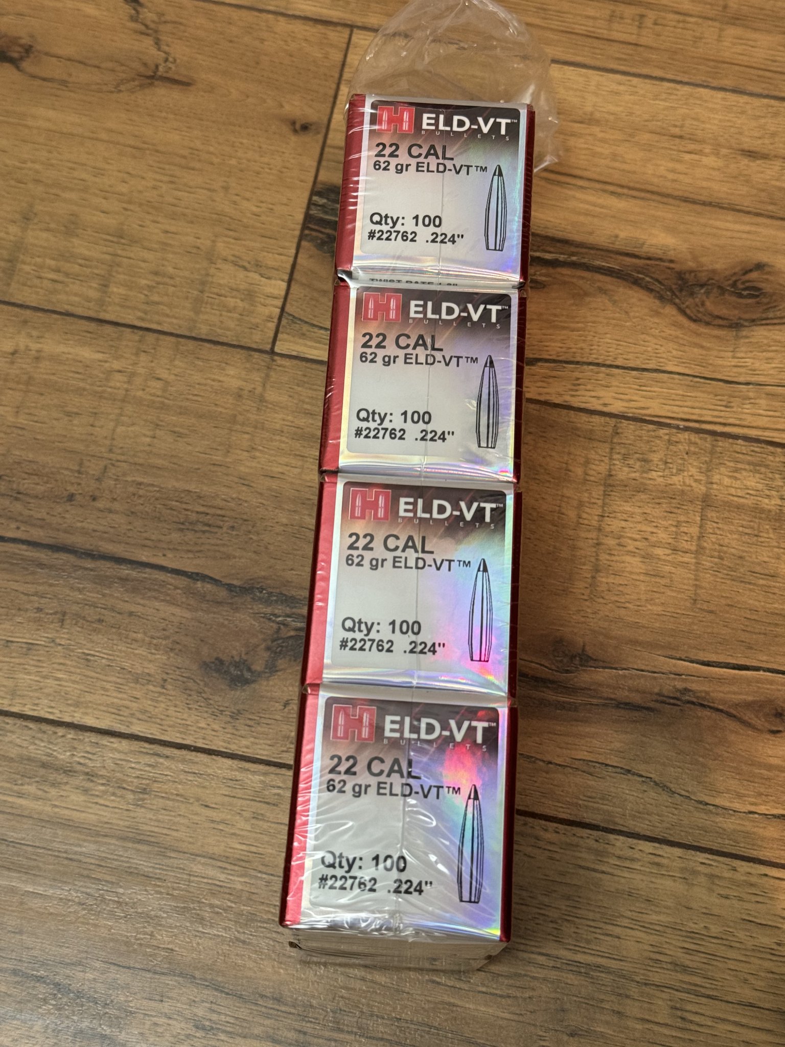

SOLD Hornady 62gr ELD-VT bullets - 400 same lot
Too many calibers, so removing this one from the stable for now.
Prices are shipped, payment to be via PayPal FF or Venmo or Zelle.
  1. Craddock RTR barrel, gas block, and gas tube. 1:7 20" Rifle+1 5/8x24; Less than 100 rounds. - $sold shipped
  2. Rainier Arms Ultramatch barrel, gas block, and gas tube - 1:7 22" Rifle+2 1/2x28; Less than 200 rounds - $sold shipped
  3. (4) boxes of Hornady 62gr ELD-VT bullets - 400 same lot - $SOLD shipped
  4. Hornady 22 ARC custom dies; sizing and seater - $sold shipped
  5. 40 rds (two boxes) of Hornady V-Match 62gr ELD-VT ammo - $sold shipped
