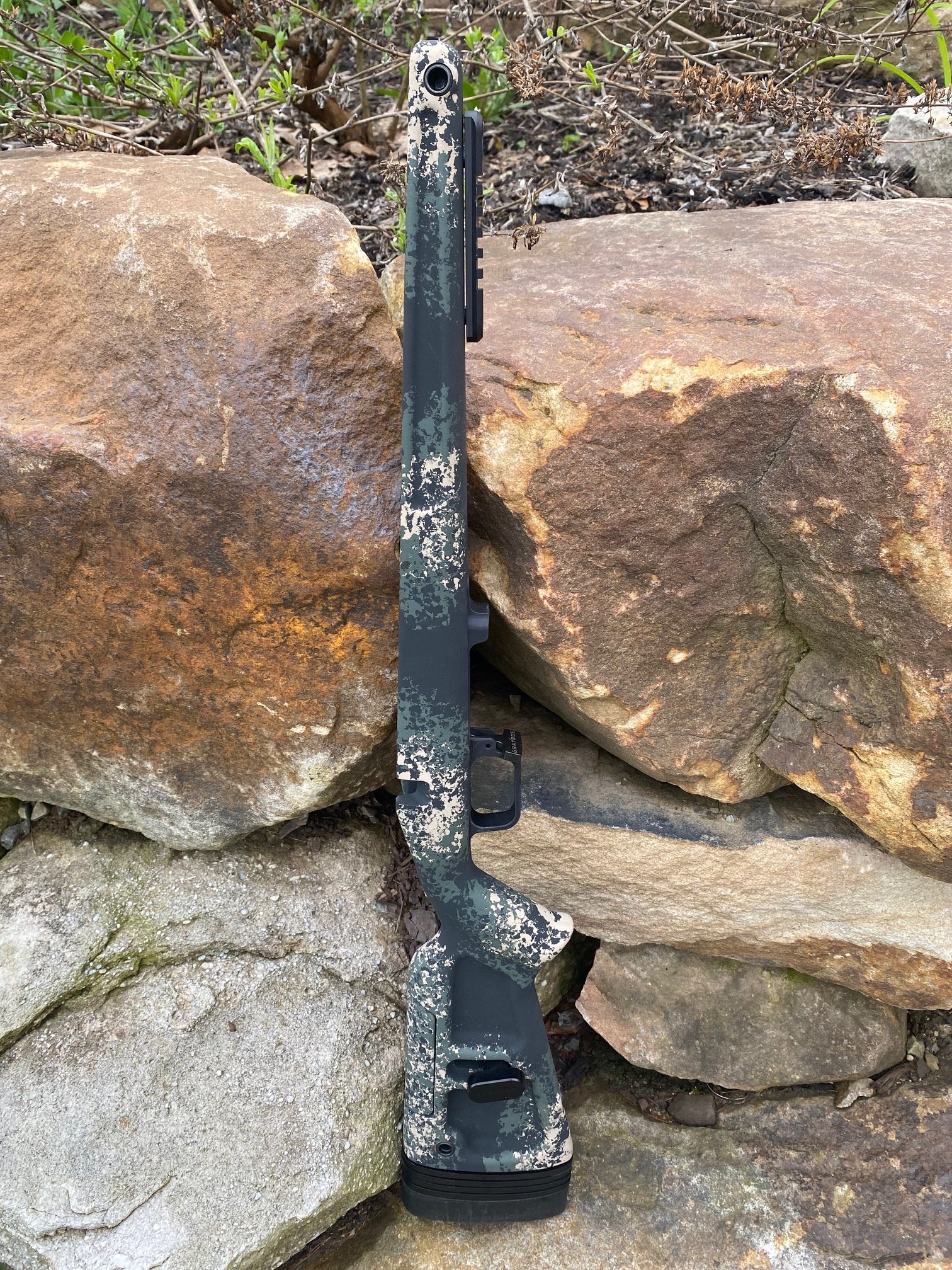

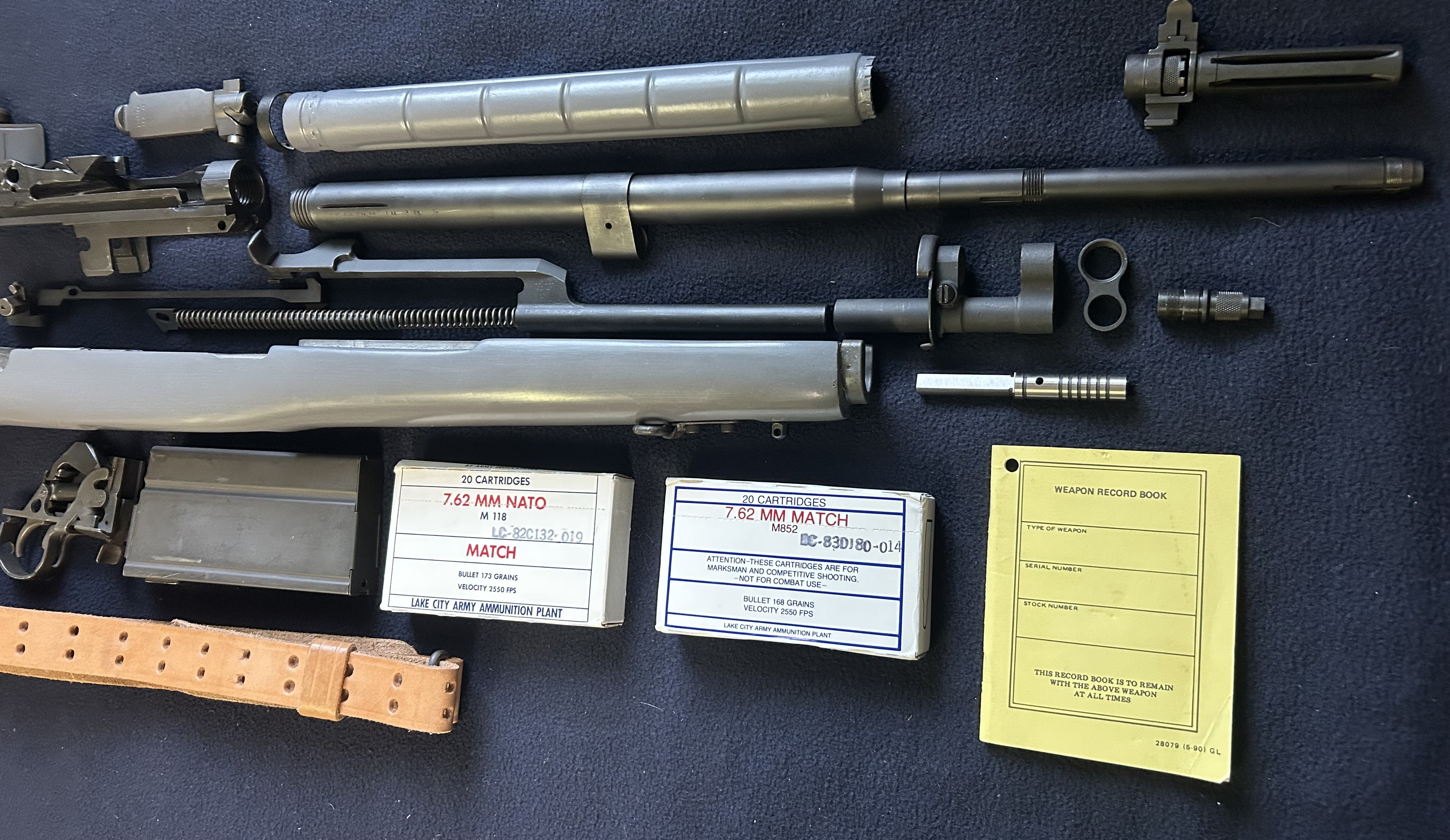

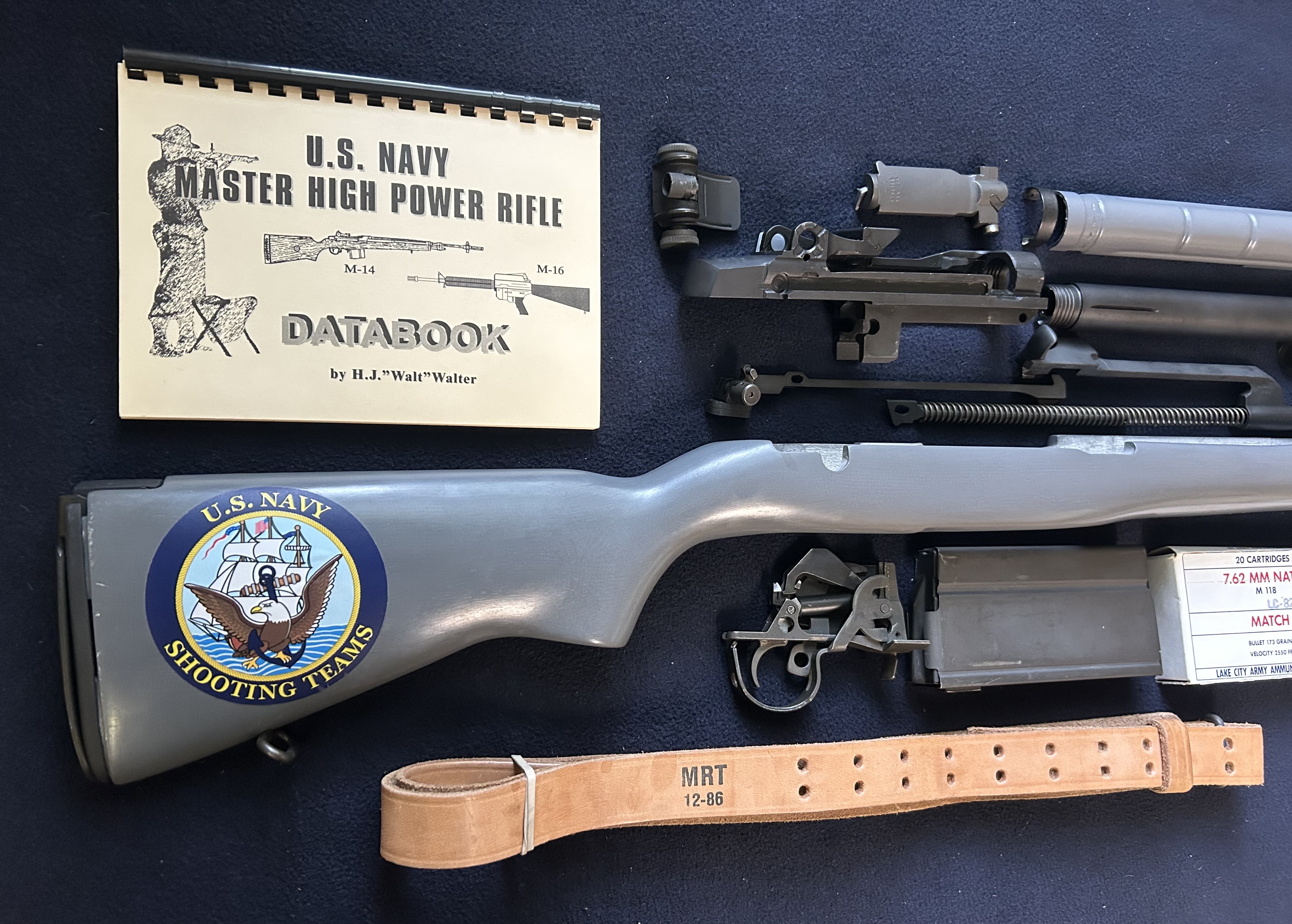

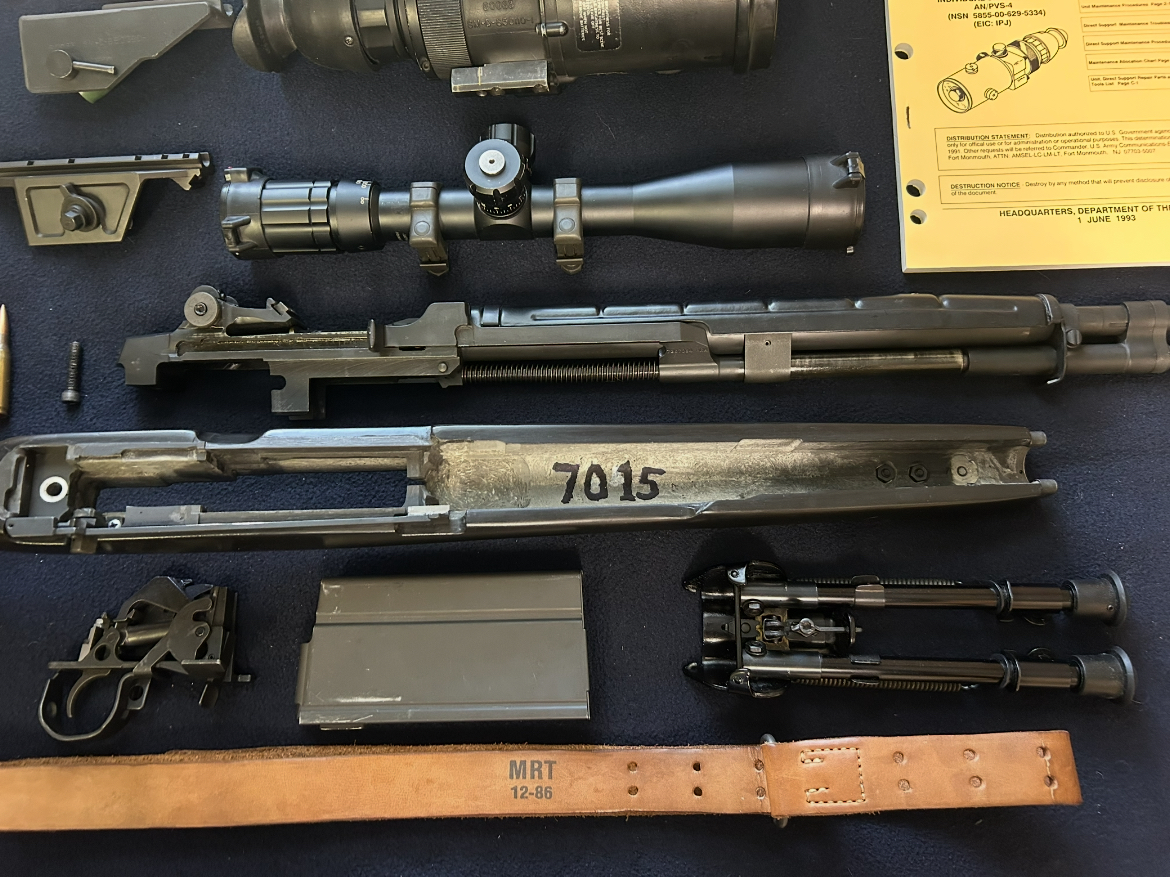

U.S. Army/Navy/USMC M14-based sniper and DMR/SDM rifles circa late-1960s to late 201Xs

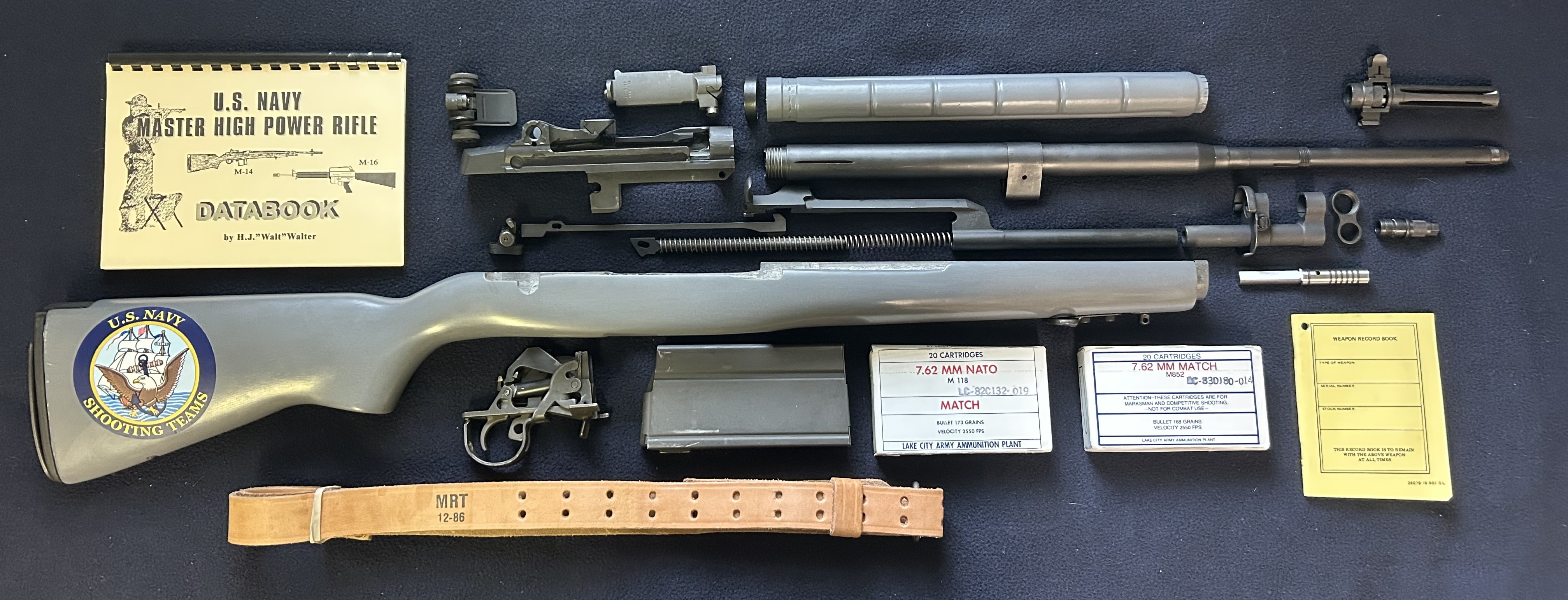

Next M14 project for anyone interested: replica of a 1990s era Navy “Grade A” double-lugged match rifle with a vintage (early 1990s) Navy stock in the unique “battleship grey” that McMillan made for the Navy. Hope to have it built by Forceman out in AZ this autumn (welded-on front and rear lugs w/ torque screws, mounting a 1993 dated USN marked heavy barrel, etc):

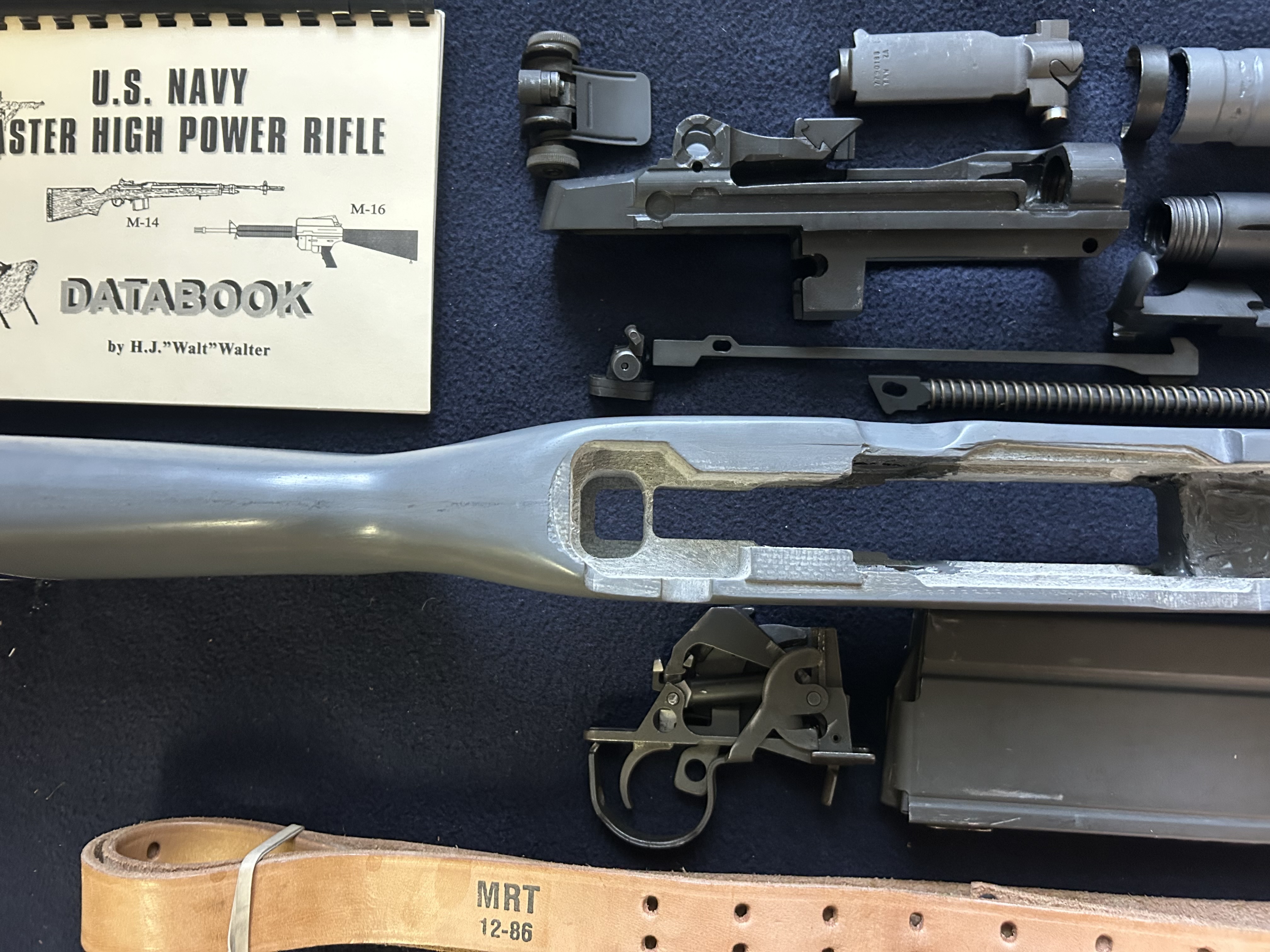

Note unique inletting for rear lug with pillar-based torque screw set-up:
…just a random project update for anyone interested in the old M14 platform.

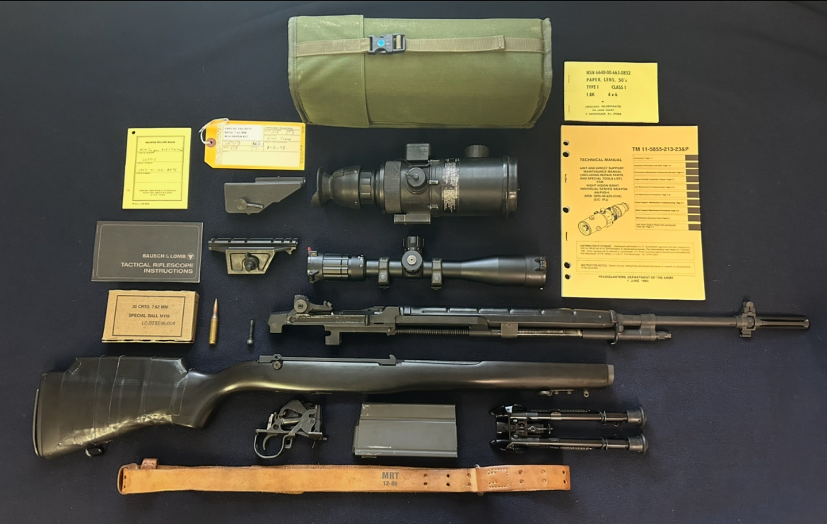

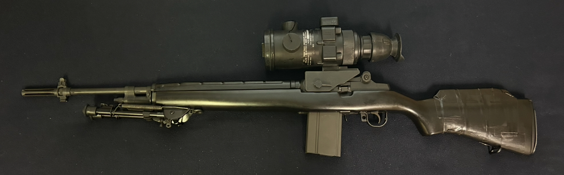

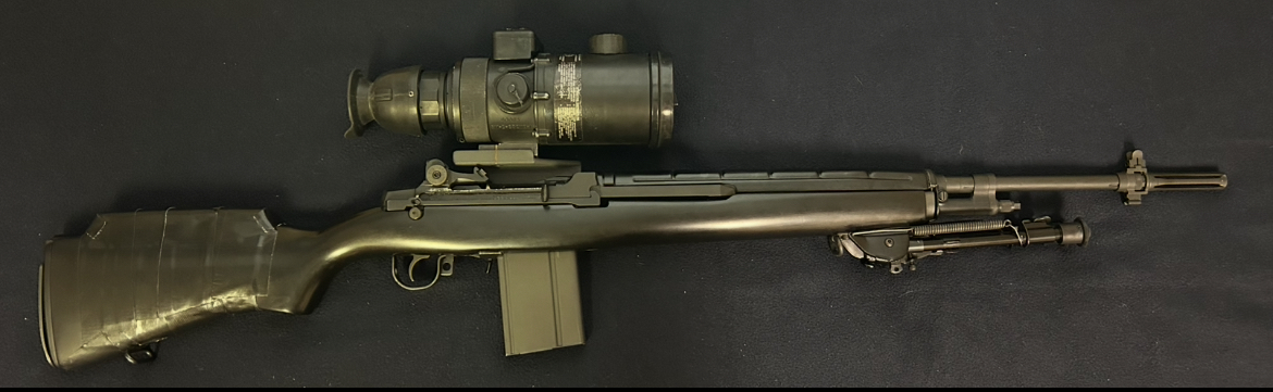

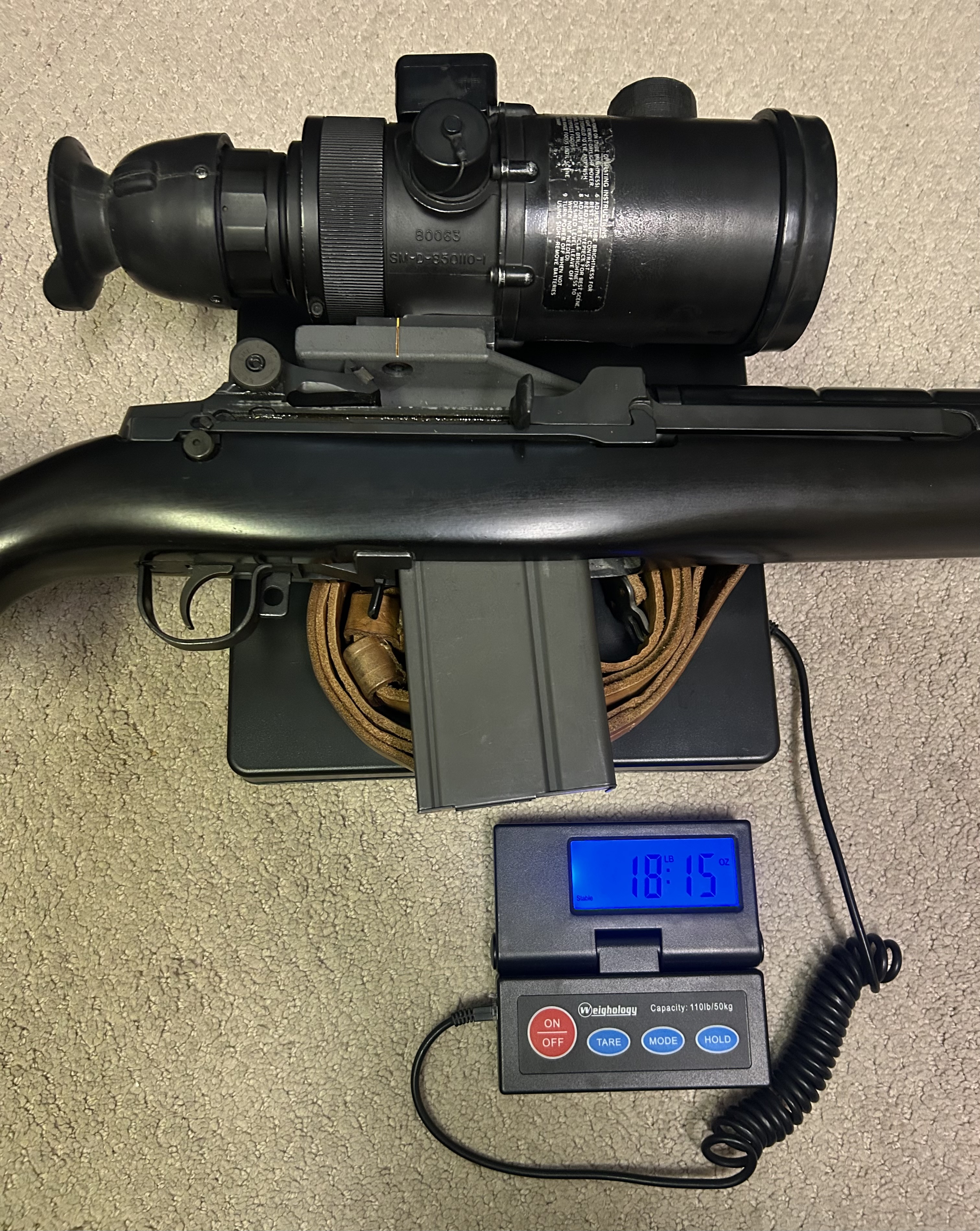

In keeping with the theme of this sniper rifle forum, I also did some work to my replica Navy M14 PSSR sniper rifle recently. I decided to mount my old school working AN/PVS-4 night vision optic, since I had the rifle out of the safe and had removed the BPT scope mount. Ergonomics are kind-of poor/suboptimal with such a high position, but that’s the night vision optic what was available in the 1980s-90s-early 200Xs. FWIW, the M14 scope mount for the PVS-4 came in packaging dated 1987. Note the weight w/ PVS-4 (which by itself weighs 4.5 lbs).
…now, if I can only get my old PVS-2 to work…
