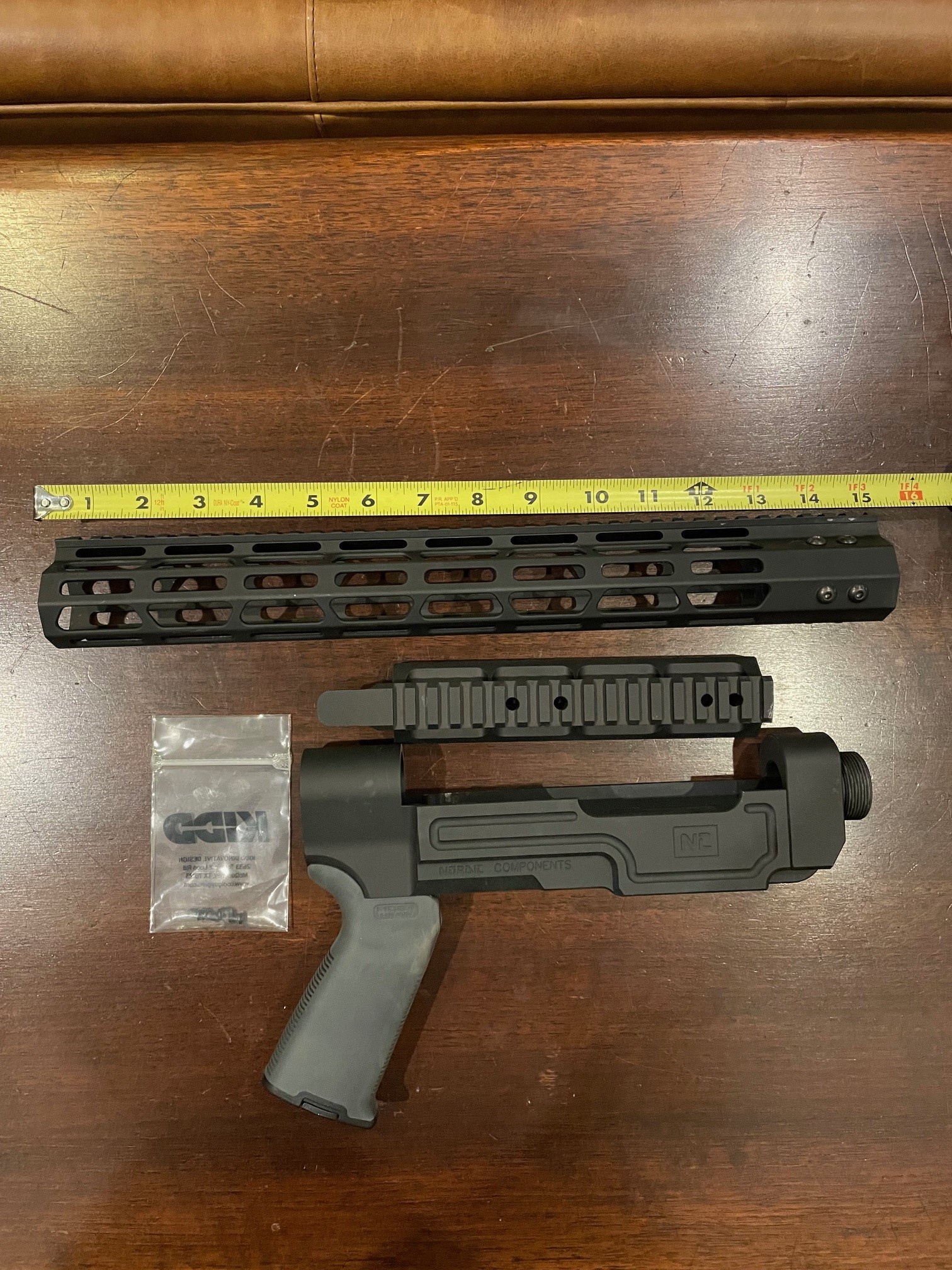

AR Novice handguard question
Looking to replace the handguard in the image and not sure what I need. Will a new handguard come with everything I need to install/mount? Pretty sure I have all the tools needed I just don't understand how the handguard mounts to the upper based on what is in the image. I'm also having trouble removing the gas block., I've loosened the allen screws on the bottom but it only slides about a 1/4". Is there a specific handguard where the Pic rail on the upper mates with the pic rail on the handguard?

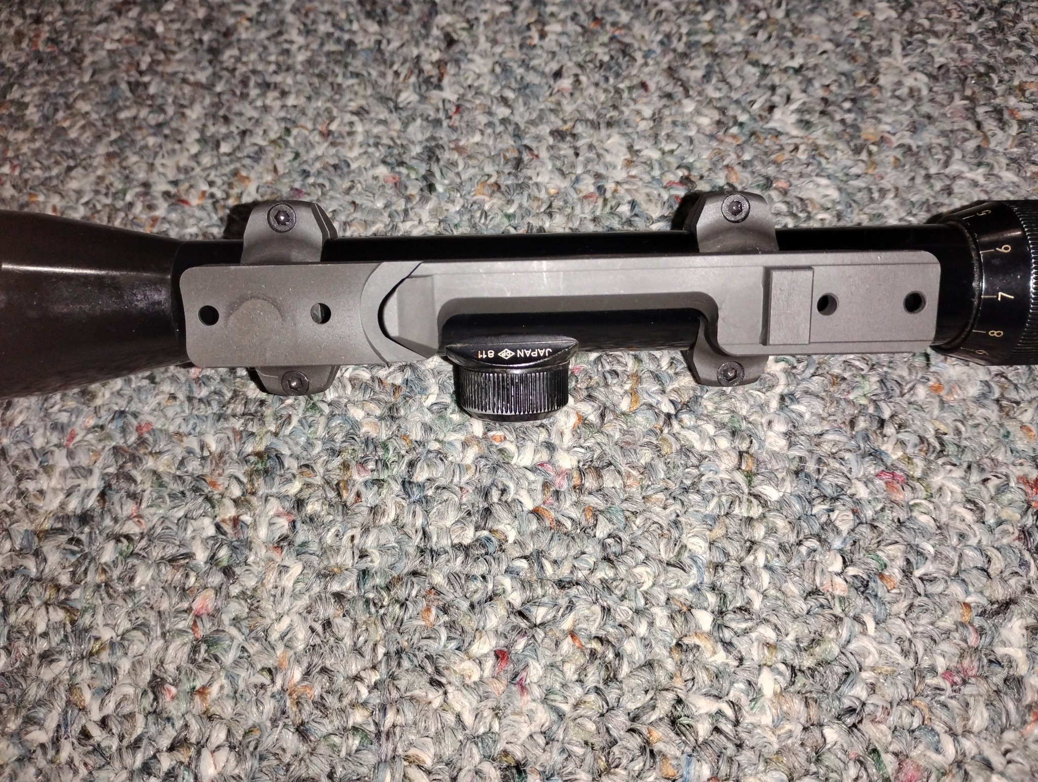

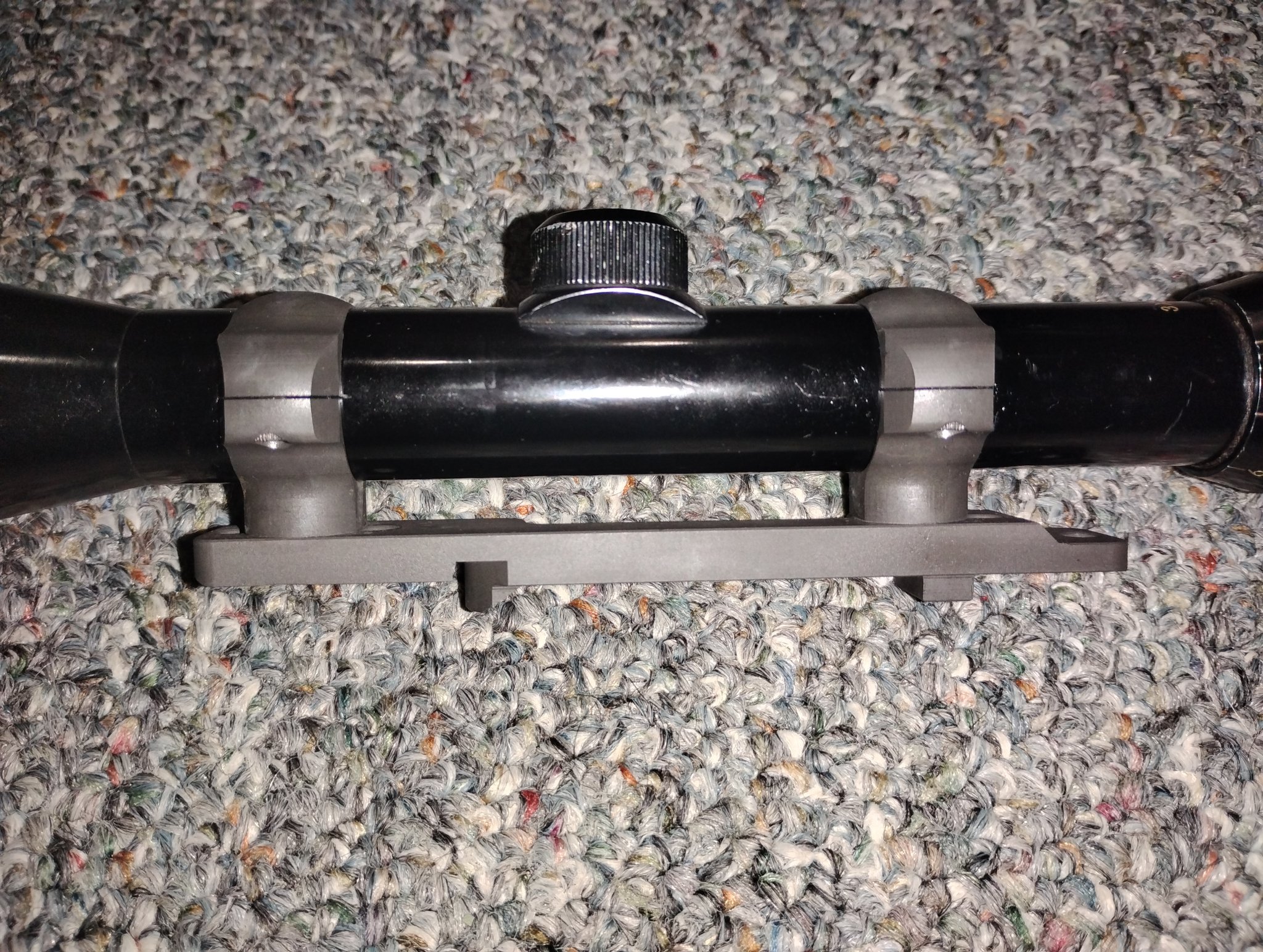

M40A1 repo mounts and rings
Along with the mounts from ICE.....
Here is another option for everyone. The first batch will be ready in 2 weeks.
I showed the mount to Marty at Badger and to George at GA Precision as well. They both liked it and said it looked great. George put a order in for 25pcs direct to the maker this week.
From the two I looked at... I'll say ring gap is .015". I grabbed a older 1" scope I have laying around and thru it in the rings and tightened the rings down to measure the ring gap. When I took the scope out of the rings nothing got crushed and only faint ring marks but no gouges etc... The only other scope I have that's a 1" anymore for the tube diameter is my Unertl and for me shooting my M40A1 I need the eye relief that the Badger scope base gives me and I'm using the M40A3 rings on it.
I took one of the mounts and test fit it to two receivers. I needed to take about .003" off each side of the rear lug and .030" off the backside of the rear lug. After doing it that it dropped on to a factory clip slotted 40x receiver. I needed to take a file and bevel the back corners of the rear lug to get it to go onto my GAP built M40A1 rifle and it fit pretty snug. A little snugger than the 40x.
Price on these will be $540 plus $11 shipping to the lower 48 states.
After this initial offering I will turn it all over to the manufacturer. Retail right now it's at $600.
No drop in mounts are available on these ones. No left handed mounts are available either from this maker.
Here are some pic's.
Later, Frank
