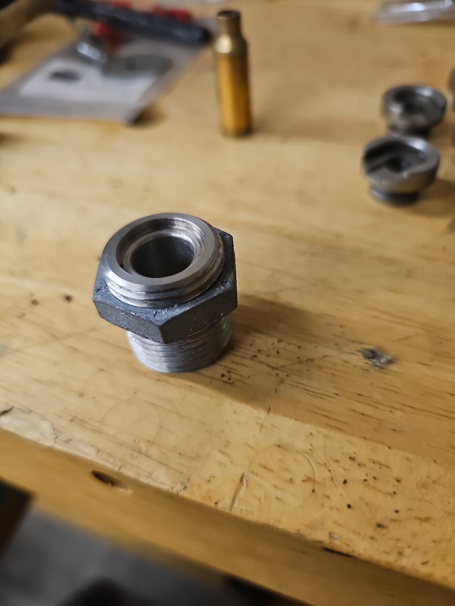

Hello all. In the process of cleaning and organizing my reloading room, I have come across this tool/device I cannot identify. It fits a tool head, is chambered for the neck and shoulder of 6.5 Grendel and is spring loaded for a short distance. I have a ton of Grendel brass and have had several rifles over the years. I feel like it is associated with trimming but I'm not sure. Anyone have an insight? Much appreciated yall!

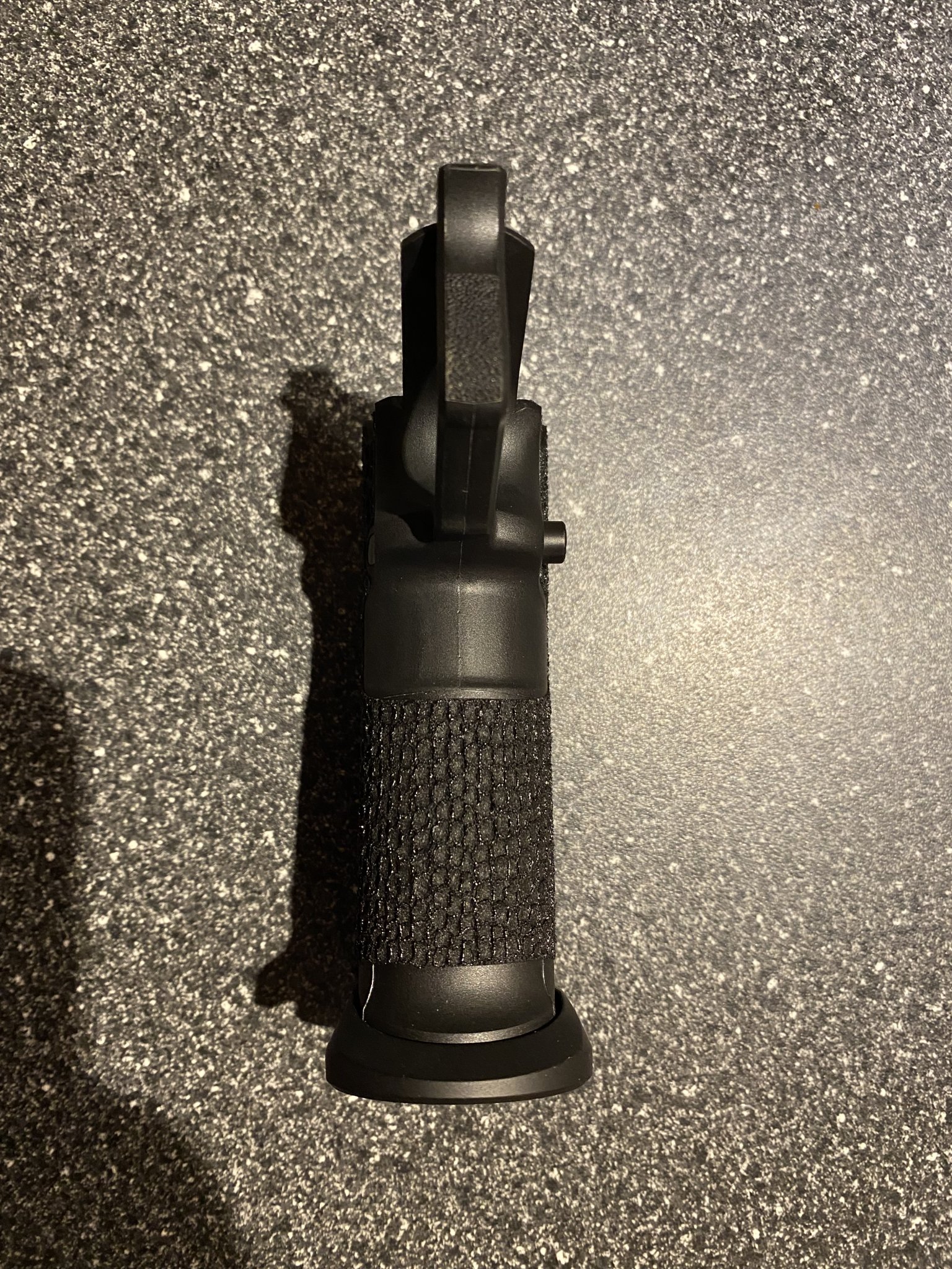

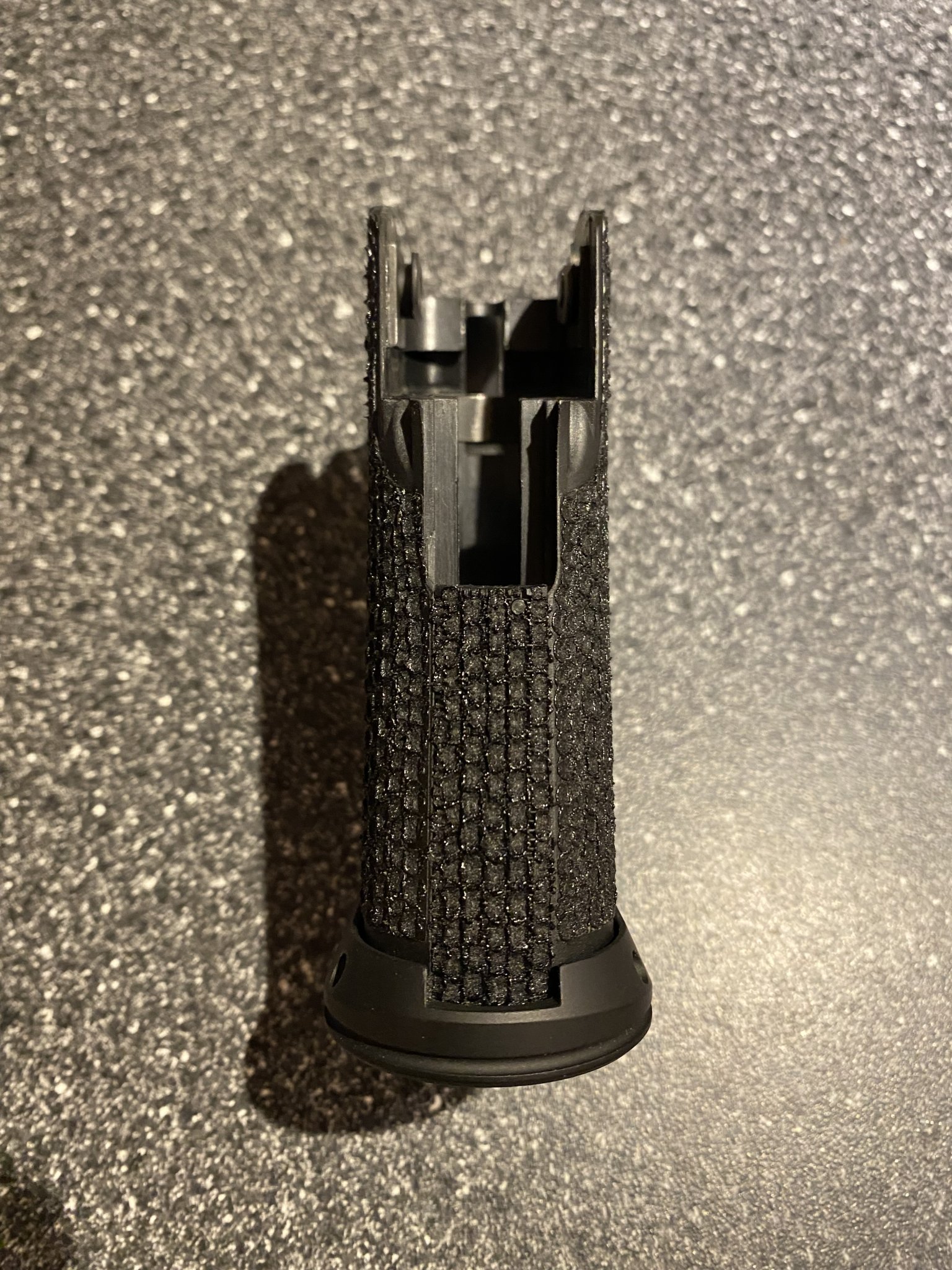

This is a new takeoff Prodigy 2011 grip that now has the tree bark texture. This grip comes with the factory mag release, grip screws and mainspring and plunger. I am also throwing in a new mag well with it. I accept VENMO, Cash App or PayPal. Buyer pays all fee’s if not using the friends and family option.
$225 shipped
