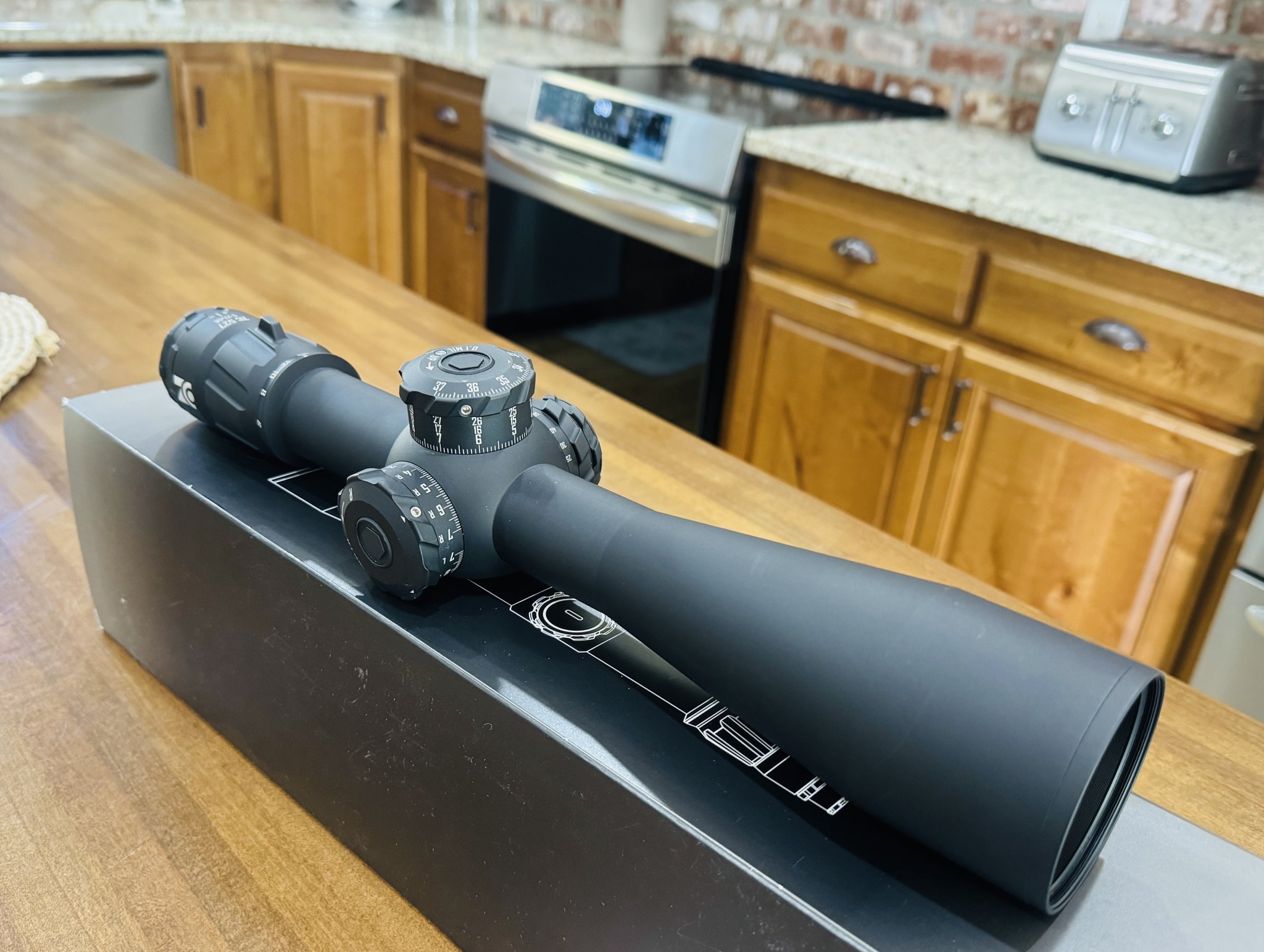

THE SCOPES​
March FFP 1.5-15x42 - Athlon Helos BTR Gen2 2-12x42 - Nightforce ATACR 4-16x42
Why these scopes? Because the March is a 42mm design I wanted to compare with other 42mm designs and there aren’t many in the FFP world. The Nightforce is not an MPVO by definition but serves as the baseline for performance of a standard erector design while the Athlon represents a “budget” line made in China that would definitely fall into the more affordable category vs. the alpha class price of the March. So in some ways this is not a comparison of peers (since there are none to the March as of this writing), but a comparison of extremes. I had considered trying to obtain the new Leupold Mark 5HD 2-10x30 but being a 30mm objective I felt was too far away from 42mm and I do not feel the Leupold reticles are ideal from a true MPVO.

TURRETS​
This review does not cover the accuracy of each scope but covers the functionality – since any manufacturer is capable of producing a lemon it’s always a good idea to test your scope to ensure its mechanical accuracy.

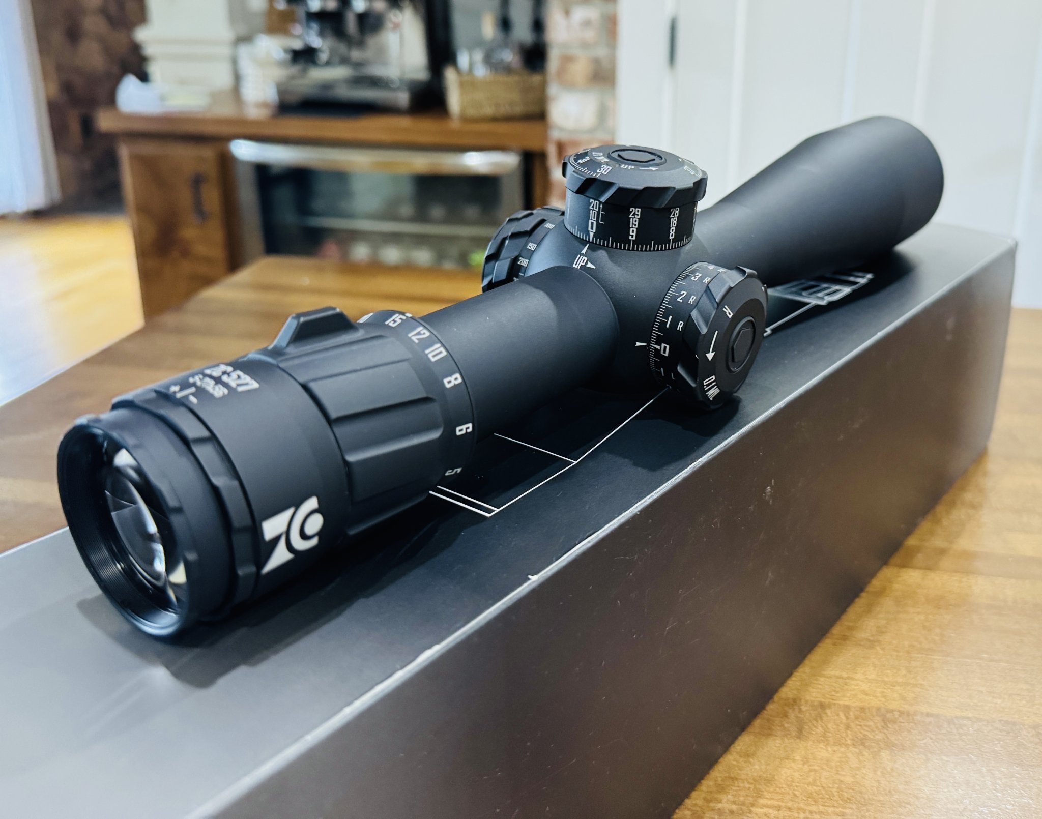

March FFP 1.5-15x42 Shuriken Lock Turrets​
March has aptly named this unique turret locking mechanism “Shuriken” which is the Japanese term for what we would call a Ninja Star and these turrets perform on the same level, each click is very distinct and very audible with no noticeable play, in fact, it is my personal opinion that these turrets rival the Tangent Theta and Schmidt DT II+ design in overall performance – high praise indeed! But there’s more to this new turret than meets the eye, while the top of the turret resembles a ninja star a quick twist of this device reveals that it is an integrated locking mechanism, if you see white it is unlocked and if you see red it is locked and when it is locked nothing moves.

The March Shuriken locking mechanism is one of the best I’ve seen as they allow you to turn the locking feature on or off with a mechanical plate separate from the turret housing itself; whereas, the locking mechanism of the Athlon uses a pull up to unlock and push down the turret to lock, this method can “fall” into lock depending on how you spin the turrets as well as causing a potential shift in POA when locking/unlocking. Nightforce offers the lock button which I really like but this only works at zero so isn’t a true lock with regard to hindering the turret from moving after you’ve set it to position.

The new Shuriken (Ninja star) locking turrets are the real deal, these are Schmidt DT II+ and TT challengers. The scope is amazingly short and ideal for those interested in NV/Thermal clip ons and the scope does exceedingly well from 1.5-8x which is where night hunters will spend the majority of their time. The dual focal plane design is really unique and offers very bright daylight center dot illumination with a FFP design that lends itself to longer range shooting; however, the dots in the tree are unusable even at highest magnification (March has already designed a new reticle with thicker tree dots that will be available soon), but a different illumination dial design for easier manipulation of settings especially if wearing gloves would be welcomed. Finally, March needs to design non-translating turrets, that is - turrets that do not rise and fall as you spin them up or down, almost every manufacture not named Nightforce does that these days, I will likely harp about this issue until the cows come home.
