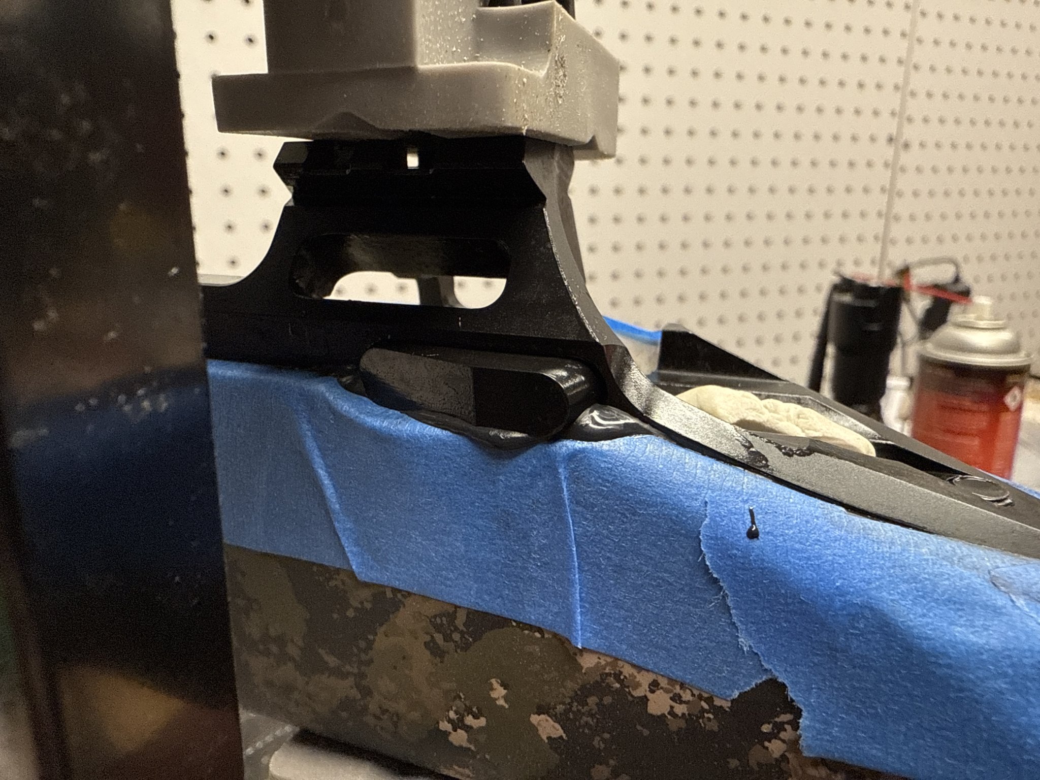

Bedding oozed into bolt release, how to get it out before it cures?
Second ever bedding job on a kelbly action. When I pressed the action into the marine Tex a little bit oozed up around the bolt release. I have good release agent in there, but I’m trying to decide if I should try and wipe it out before it dries or if that will just just push it further in and cause problems. I haven’t touched it or moved it yet. Thoughts?
