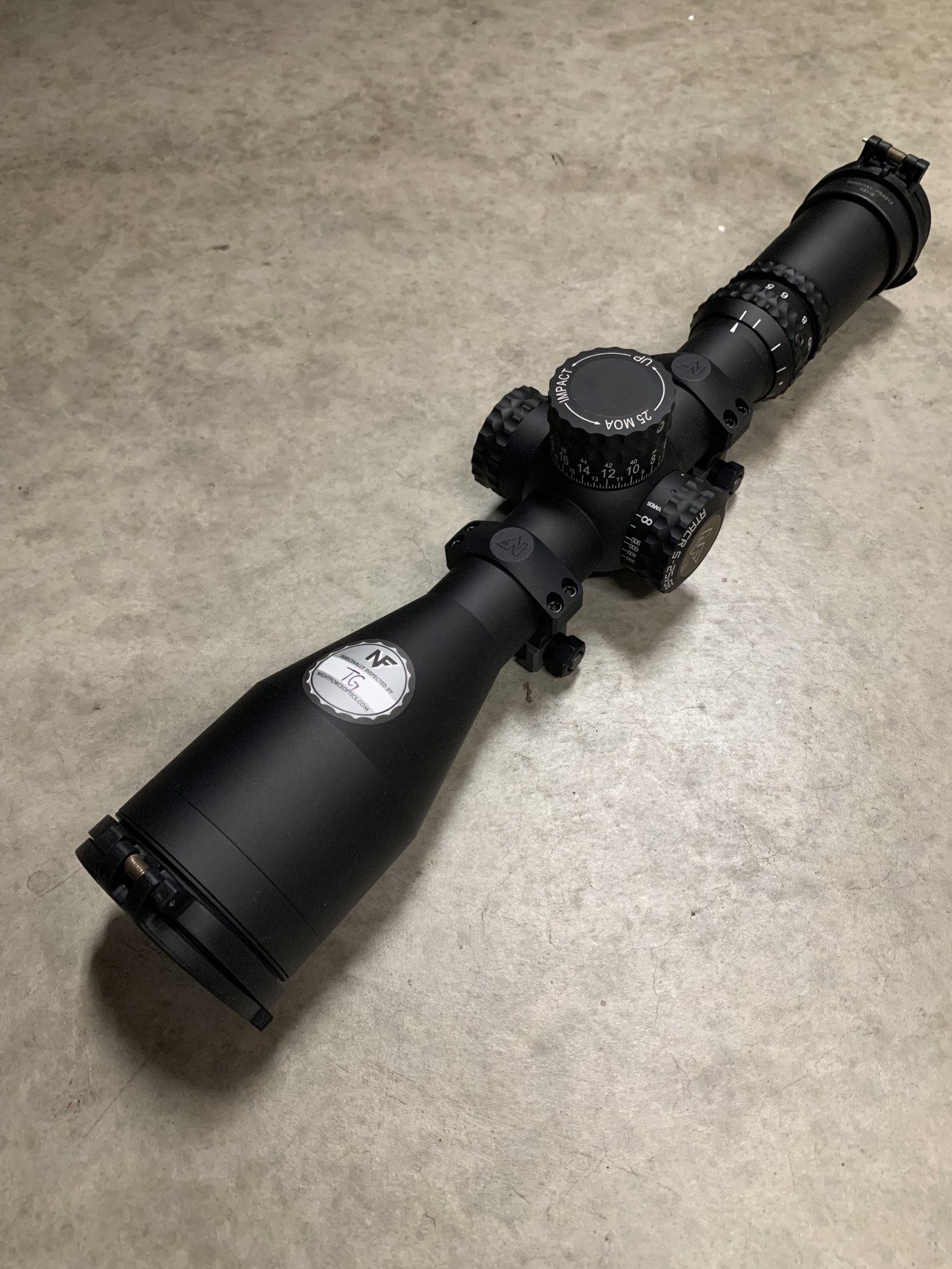

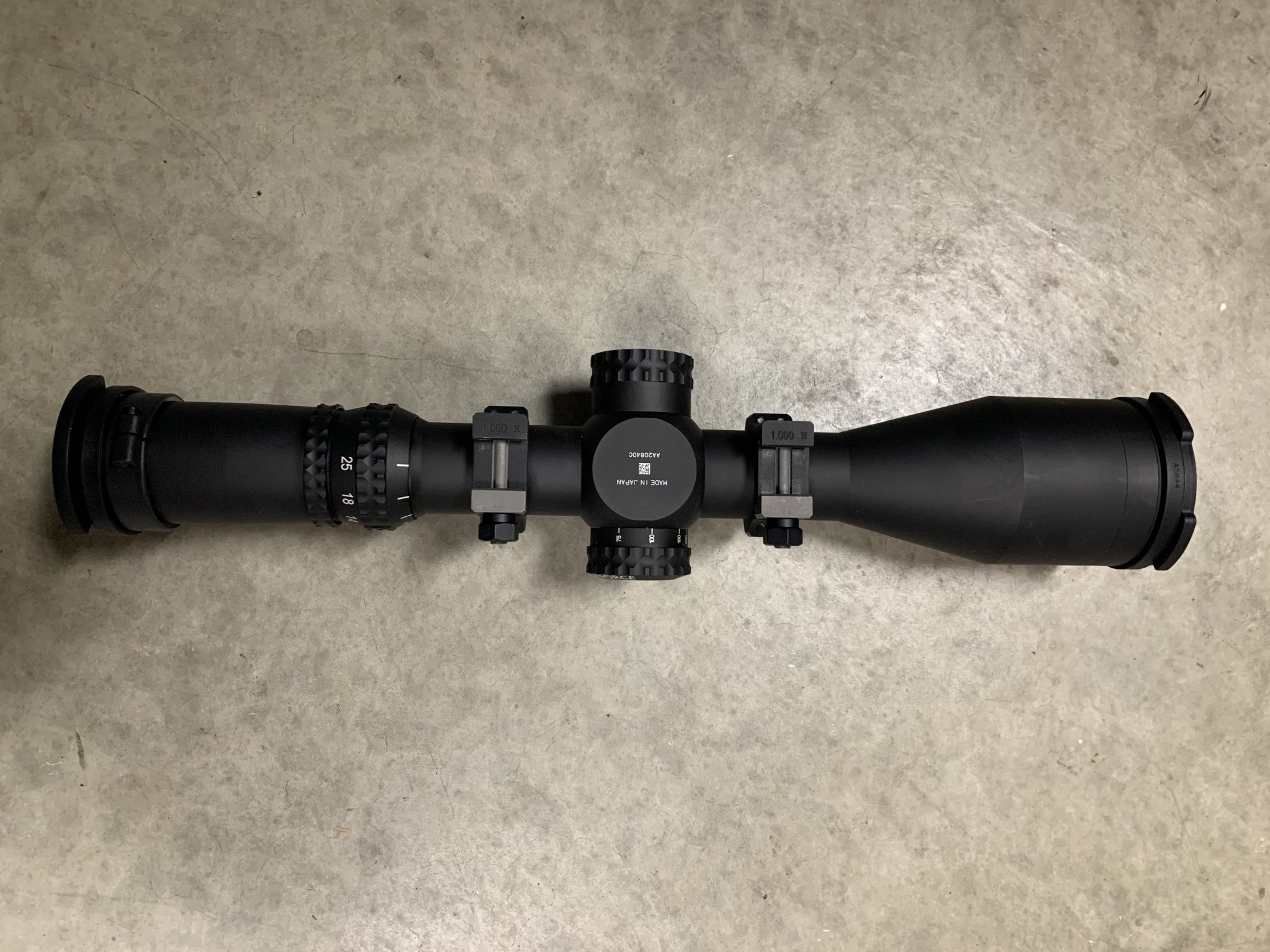

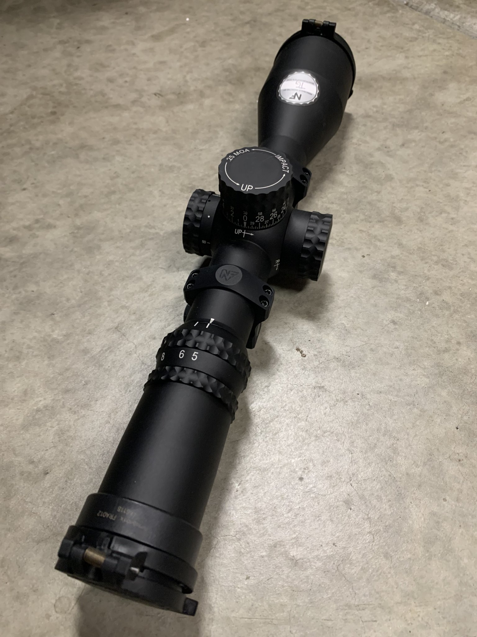

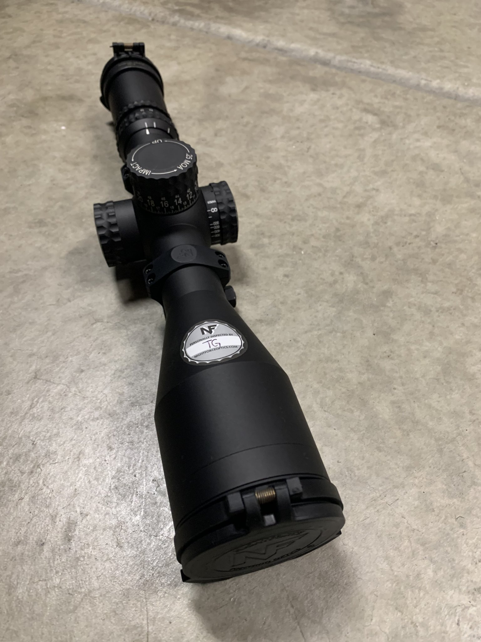

SOLD Nightforce ATACR 5-25 F2 MOAR C553
Excellent condition. Just a couple range trips, never hunted with.
Nightforce ATACR
5-25x56
MOAR
F2
C553
$2000 scope only
$2140 scope and NF rings (A223, 1” height)

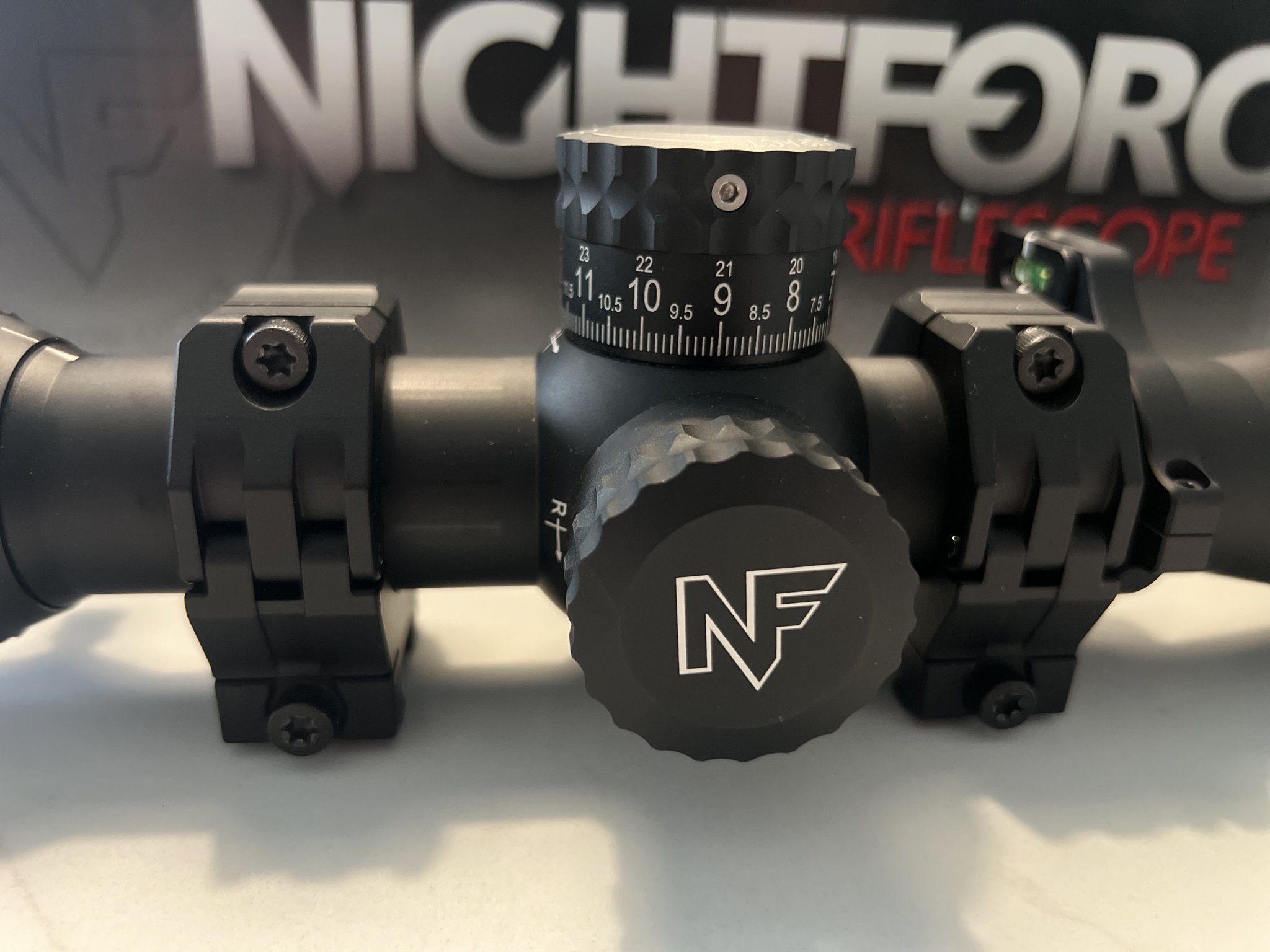

SOLD NF ATACR 7-35x56 F1 Mil-XT C613 w/ ARC Rings + Level
Nightforce 7-35x56 Mil-XT F1 (C613) sitting in ARC Medium (1.1”) M-Brace rings and Mk Machining 34mm XLP Billet Scope Level.
Excellent condition. Slight ring marks that are barely noticeable. Range use only with less than 150 rounds. Never used in a match
Also comes with original box and new sunshade.
EDIT: SOLD
