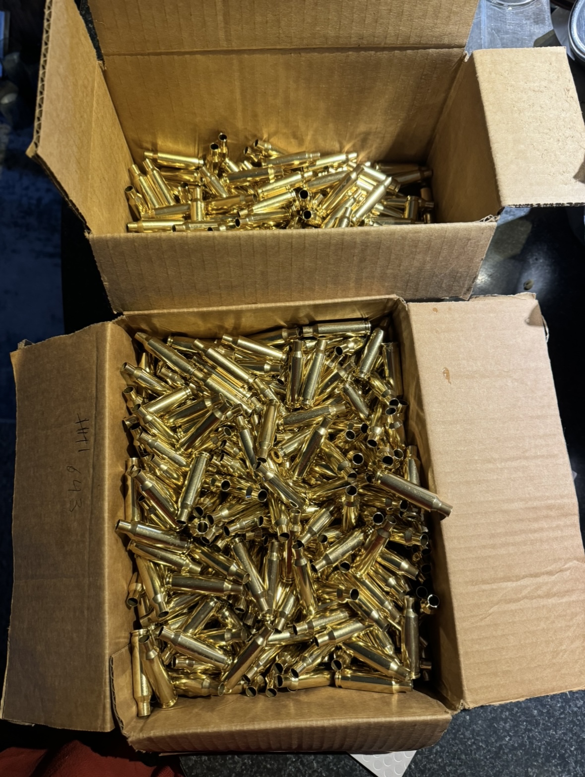

Accessories MRAD 33XC barrel and brass
Selling my Barrett MRAD 33XC barrel that I used for about 3 months of the ELR season last year. Selling due to having built a new ELR rifle and no longer using this barrel. It has 307 rounds through it, 75% of which were loaded with H1000 (the others were N565 and H50) so the throat is still in good shape. All gunsmithing done by Southern Precision Rifles/Bugholes. It does NOT come with a barrel makers kit, one will be needed in order to use in an MRAD.
Specs are:
-29” 9T Bartlein heavy taper (0.925” at muzzle) threaded 3/4 at the muzzle.
Also included is 178 pcs of Tubb 33XC brass.
-73 pcs of 1x fired, cleaned, annealed, sized, chamfered and de burred
-105 pcs of 2x fired un-processed (I can wet tumble if desired)
Asking $900 shipped for barrel and brass
