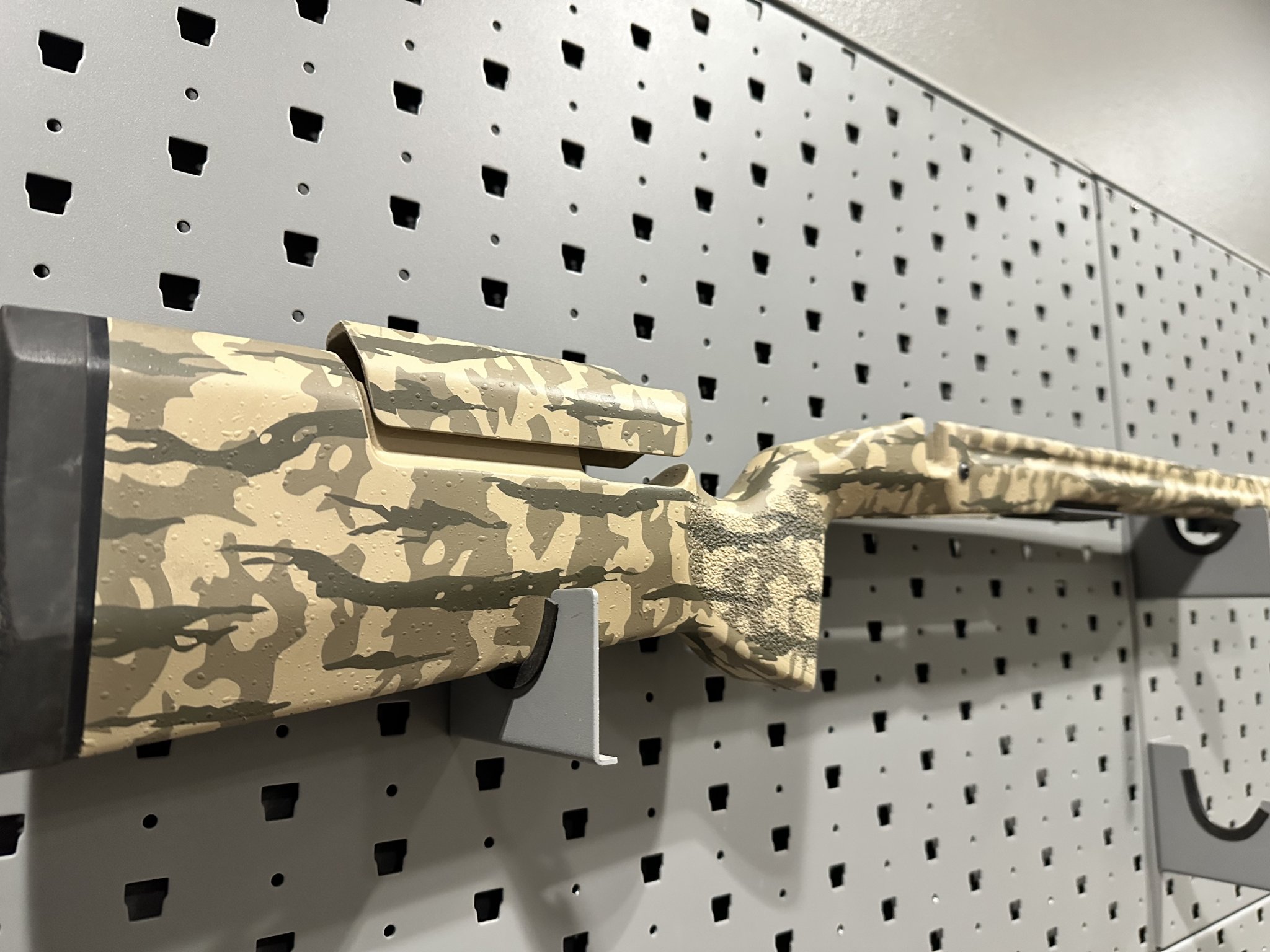

SOLD Manners LRH SA Custom Cerakote
Really nice Manners LRH SA inlet no mini chassis. Bedded for an Impact 737R by Radix Precision, the cerakote is TS Mirage done by Primal Rights. Finish is in perfect shape, one of a kind for sure.
$1000 shipped.
