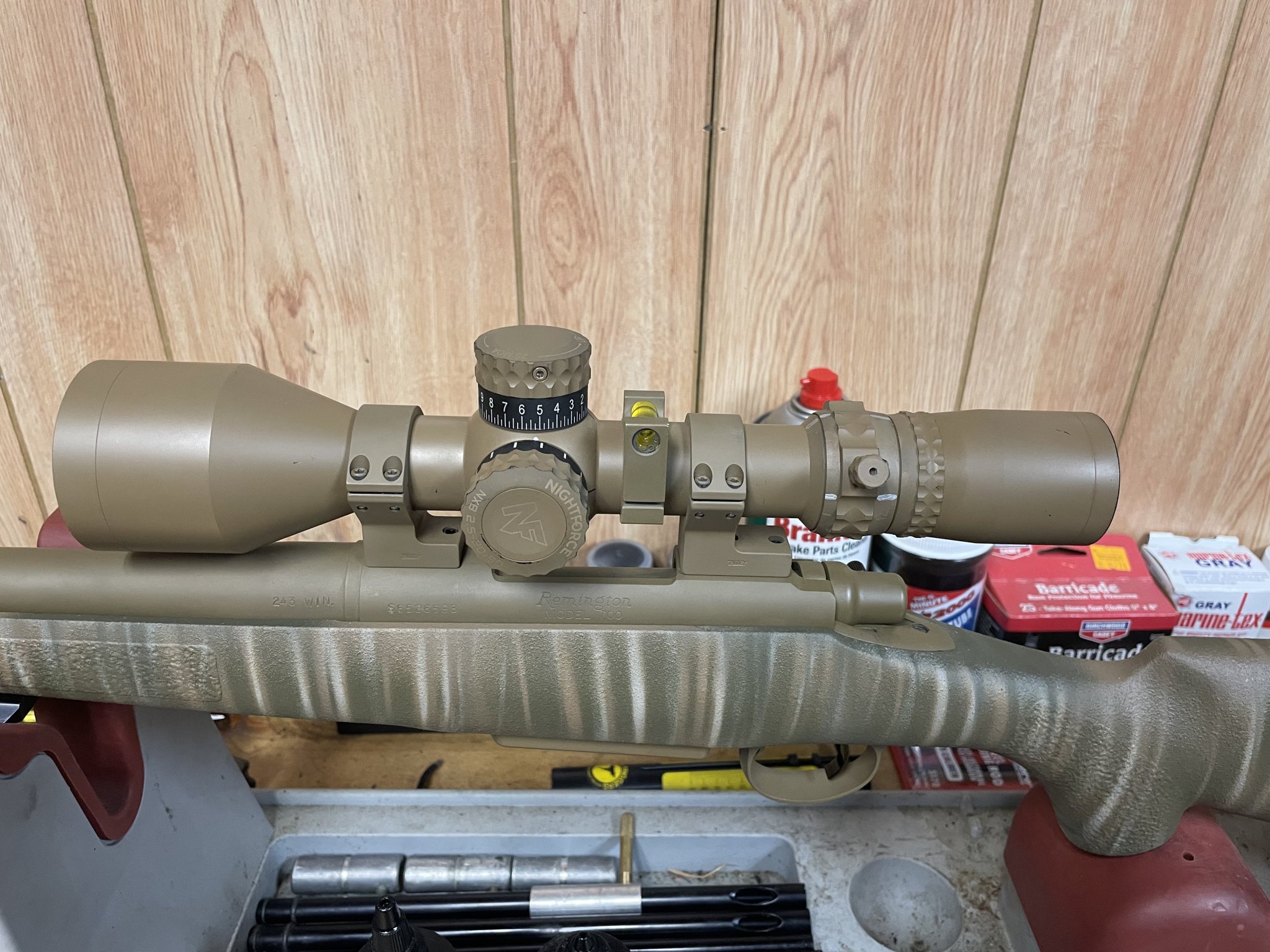

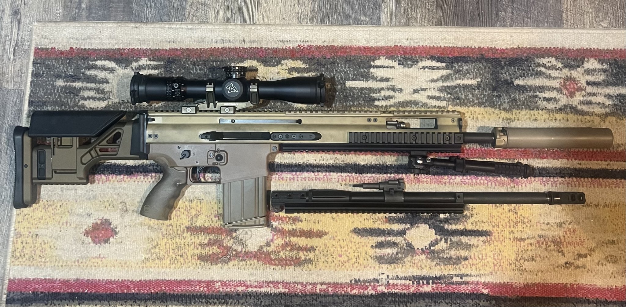

Here is a picture of the build:
The left group (FTF) of ammo is all AAC (115gr, 110gr, 125gr SMK) and the right group (Fired) is Hornady, Sabre, S&B Tactical, Winchester Super Suppressed and Ammo Inc. Not Shown is the Hornady black.
Sorry for the huge pictures, hopefully they give an idea. Here is what I tried:
