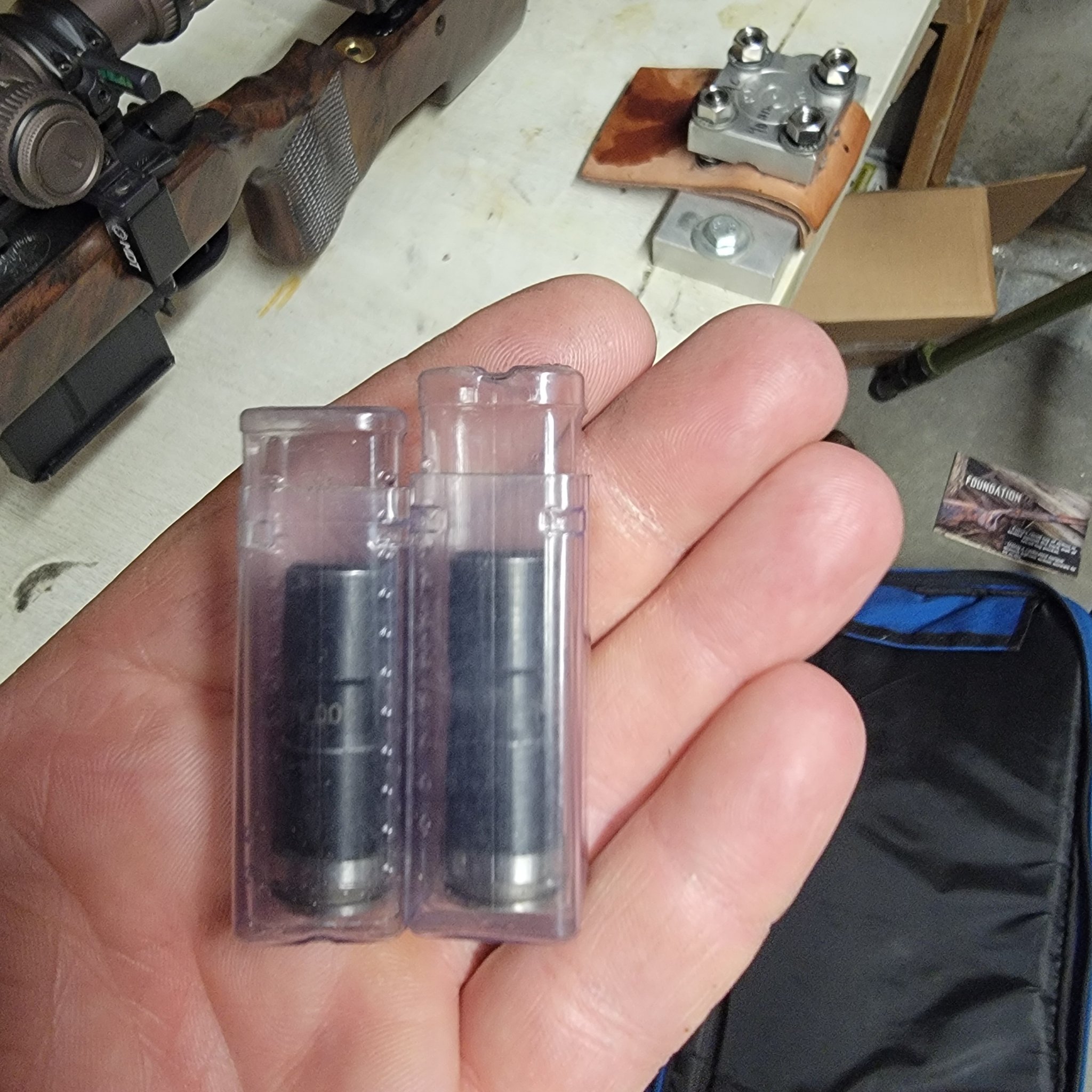

go / no-go tested the bolt

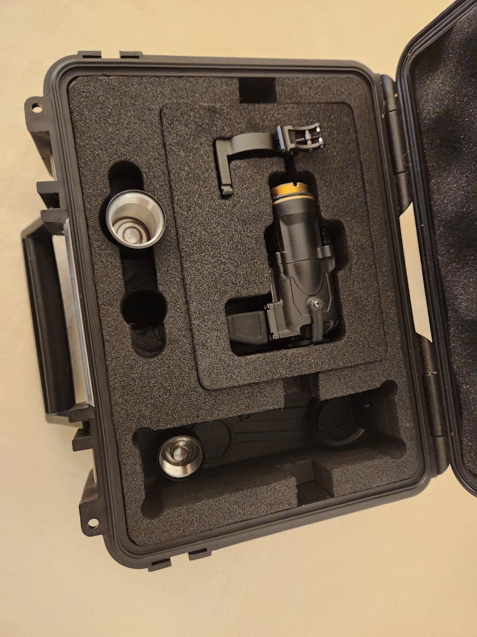

Night Vision Jerry C5 COTI NVG Fusion $3300
This is a brand new clip on thermal imager that allows you to clip on to a night vision optic so you can have the best of both worlds. It projects a thermal image into your night vision device. This comes with 640 resolution. Here's an example of how good it works.

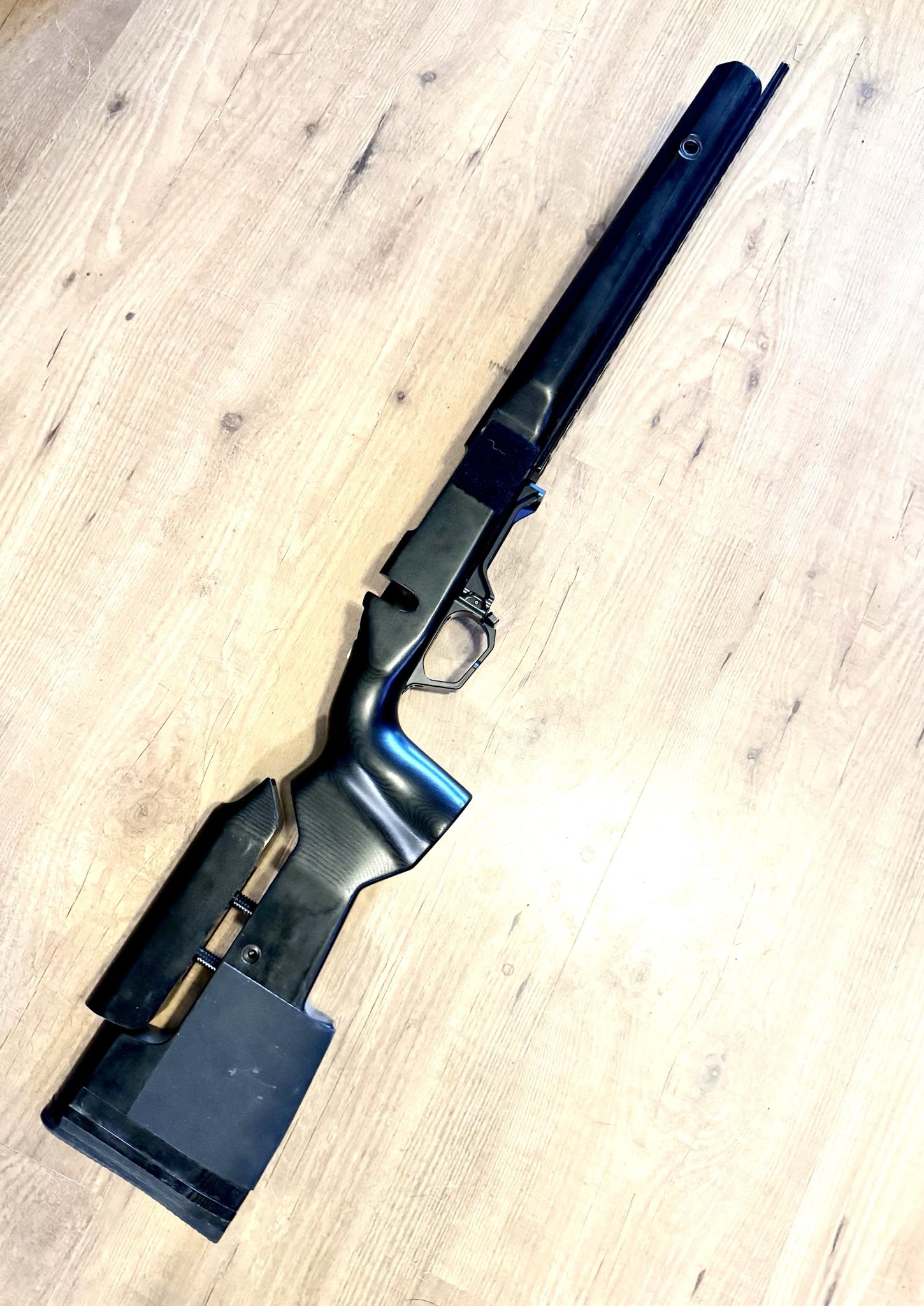

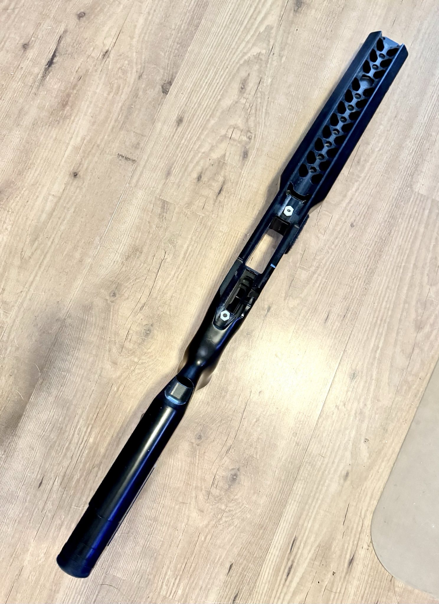

SOLD XLR Element 4.0 REM 700 LA and accessories
This Element is fully loaded and includes the following accessories:
Black XLR Element aluminum chassis with C6 buttstock
XLR Bag rider
XLR thumb rest
Ergo grip 1 vertical and 1 tactical grip
Element internal weight kit
C6 buttstock weight kit
XLR adjustable DBM
Short and tactical long mag latch
XLR long and short C6 buttstock LOP adapter
One 5 round 3.850 300 WM magazine (used for 7 PRC)
Everything in excellent condition. The smudges you see in some of the pictures is grease from the LOP adapter that I got on my hands when installing. This is perfect as new condition with zero blemishes.
$975 shipped

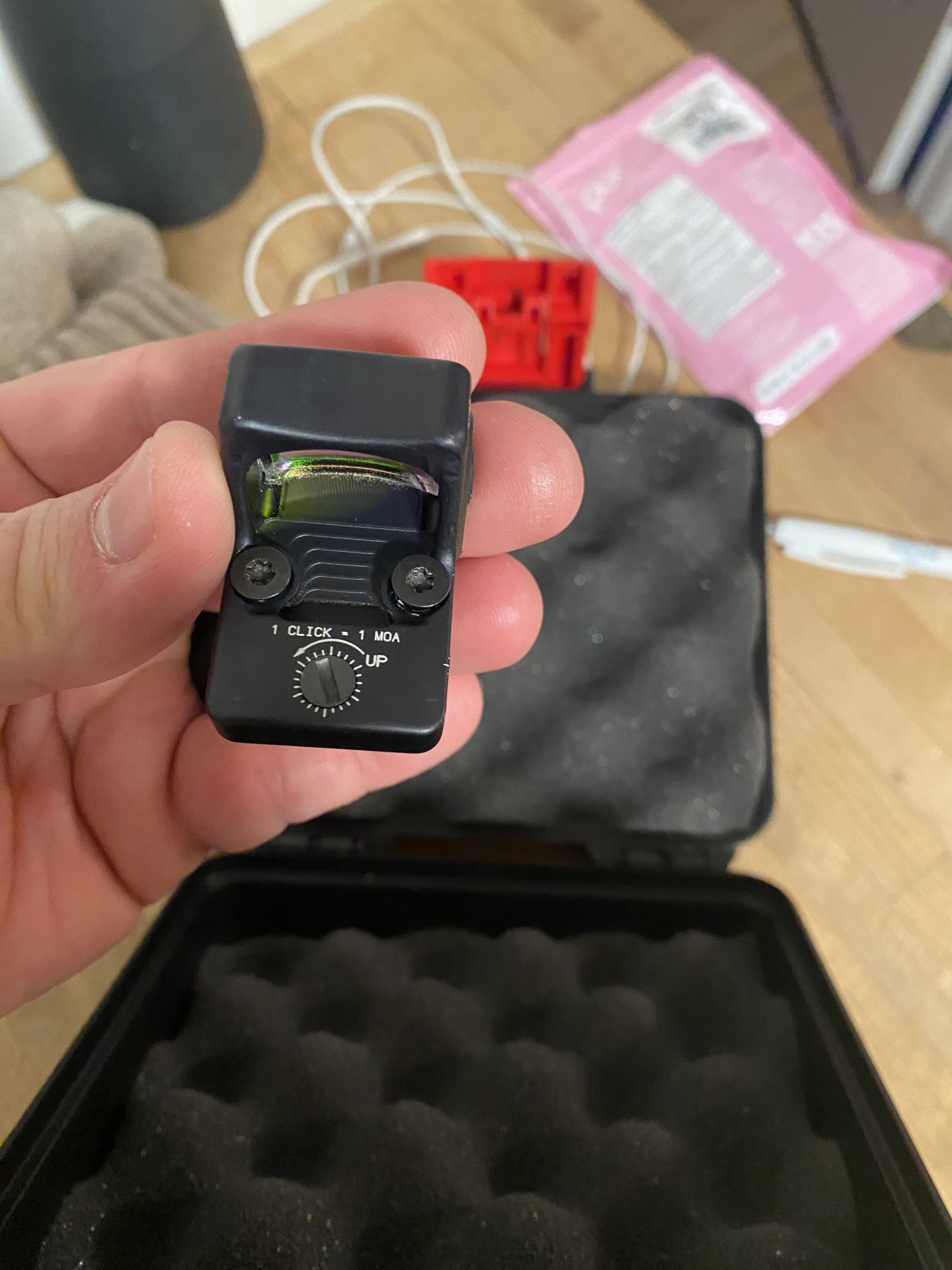

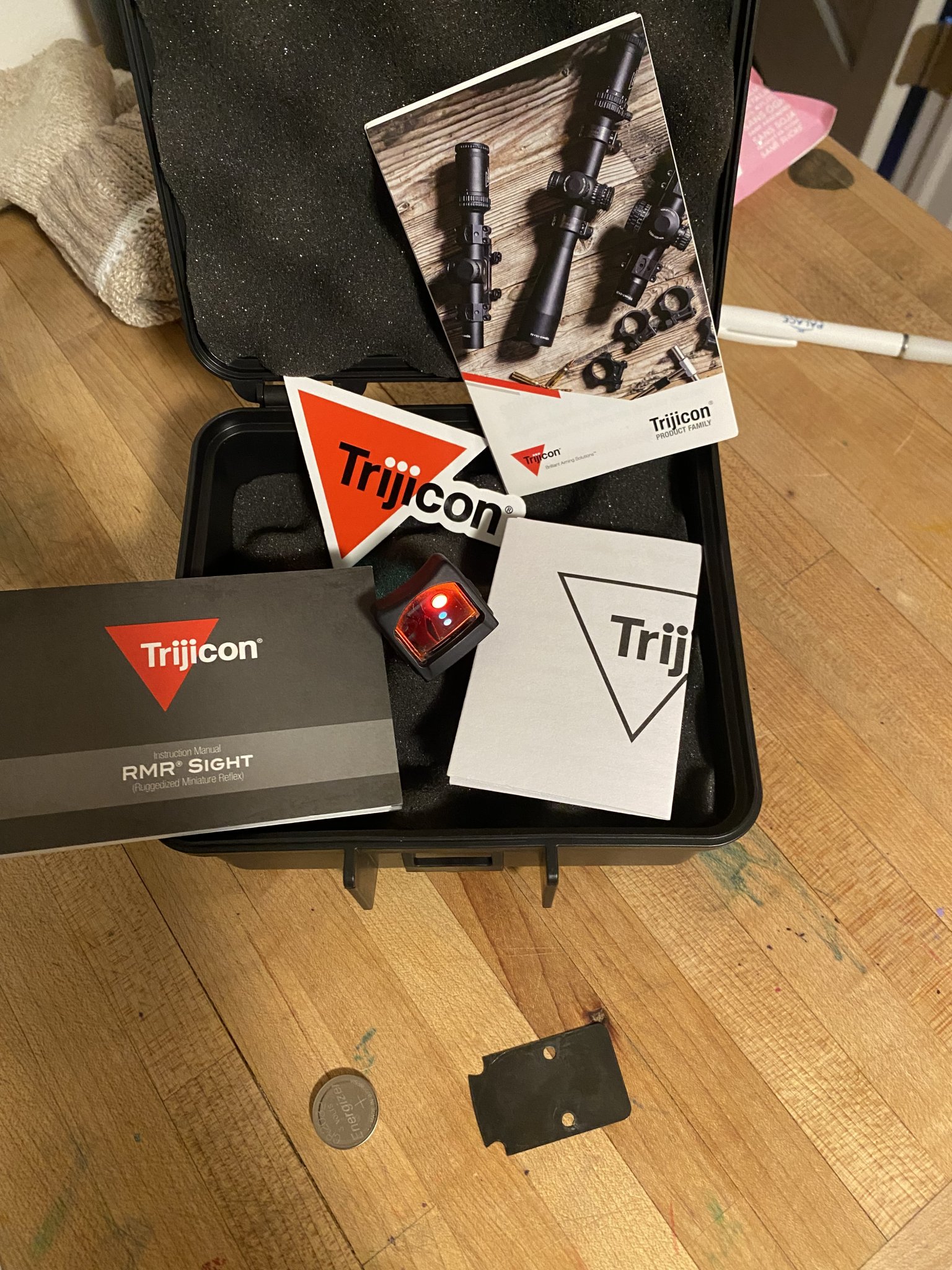

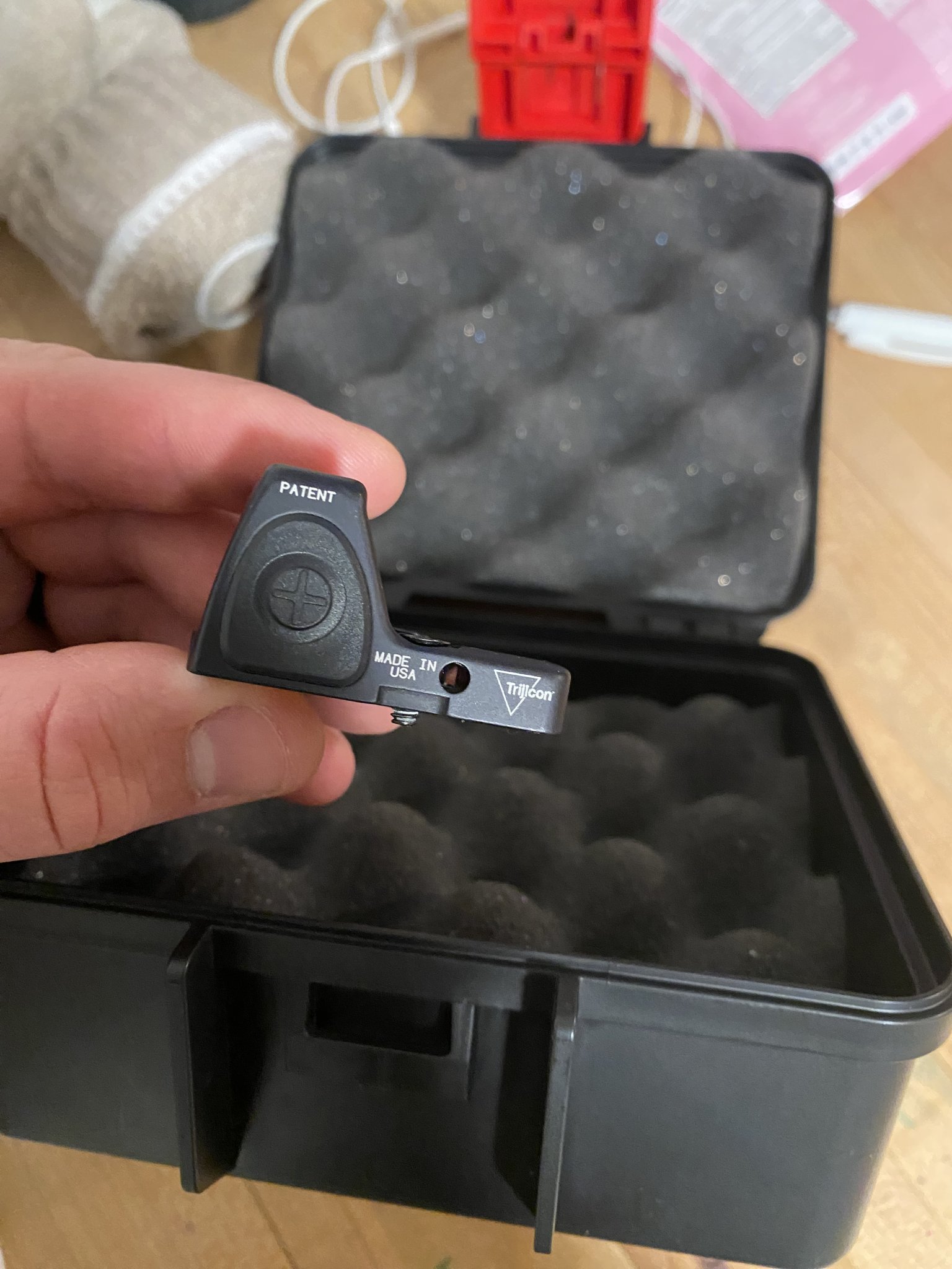

SOLD Trijicon RMR Type 2
For sale is an excellent condition Type 2 RMR (black).
Has the original box and papers
Will include a sealing plate
Asking $425 shipped OBO
for more pictures or info please PM me

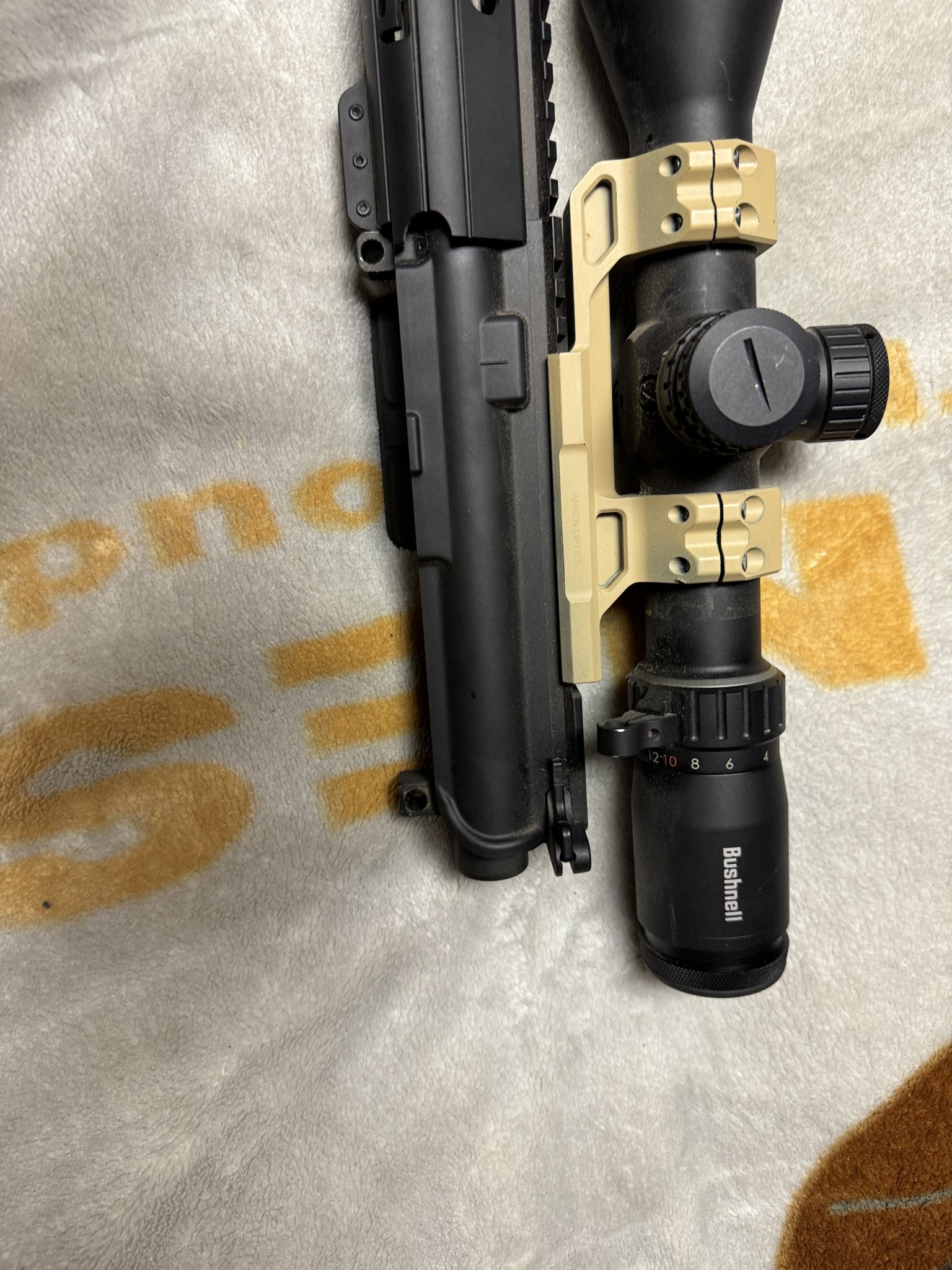

SOLD 2 complete ar-15 uppers mk12 mod h’ish
Still culling the herd! These two uppers are on the chopping block.
Payment by PayPal f&f please with NO comments. Or you cover the fees.
Trades? Maybe …. But am really just needing the cash.
Luth ar-15 223 Remington upper. Comes with the bcg and charging handle. 1/9 twist 20” fluted heavy barrel. The a2 flash hider is somewhere in my parts bin…. If I find it? I’ll send it along. If not? I’ll include the cheap thread cover. Put about 200 rounds through it. I did purchase it new. Bipod rail,scope and mount not included. 300.00 shipped SOLD!
6mm arc mk12 mod h’ish upper. Don’t know much about it. It’s just sat in the safe since I purchased it. It’ll come with a new 15 round mag. Asking 650.00 shipped. Here’s the original thread where I purchased it. The badger riser is not included.
Cool upper only shot to test fire and confirm function after grabbing it on the hide
Pri hand guard and optics rail
Missing one screw for optics rail can order form pri but never did didn’t seem to cause issues however
Arca rail
Mcgowen barrel chamber 6mm arc with correct collar mounted great with my otter ocm 5
Willing to potentially separate
Upper w/ bcg $850 price drop $650
Arken sh 4 gen 2 6-24 $250 add $50 I will include griffin sprm rings
Barrel info in pictures
