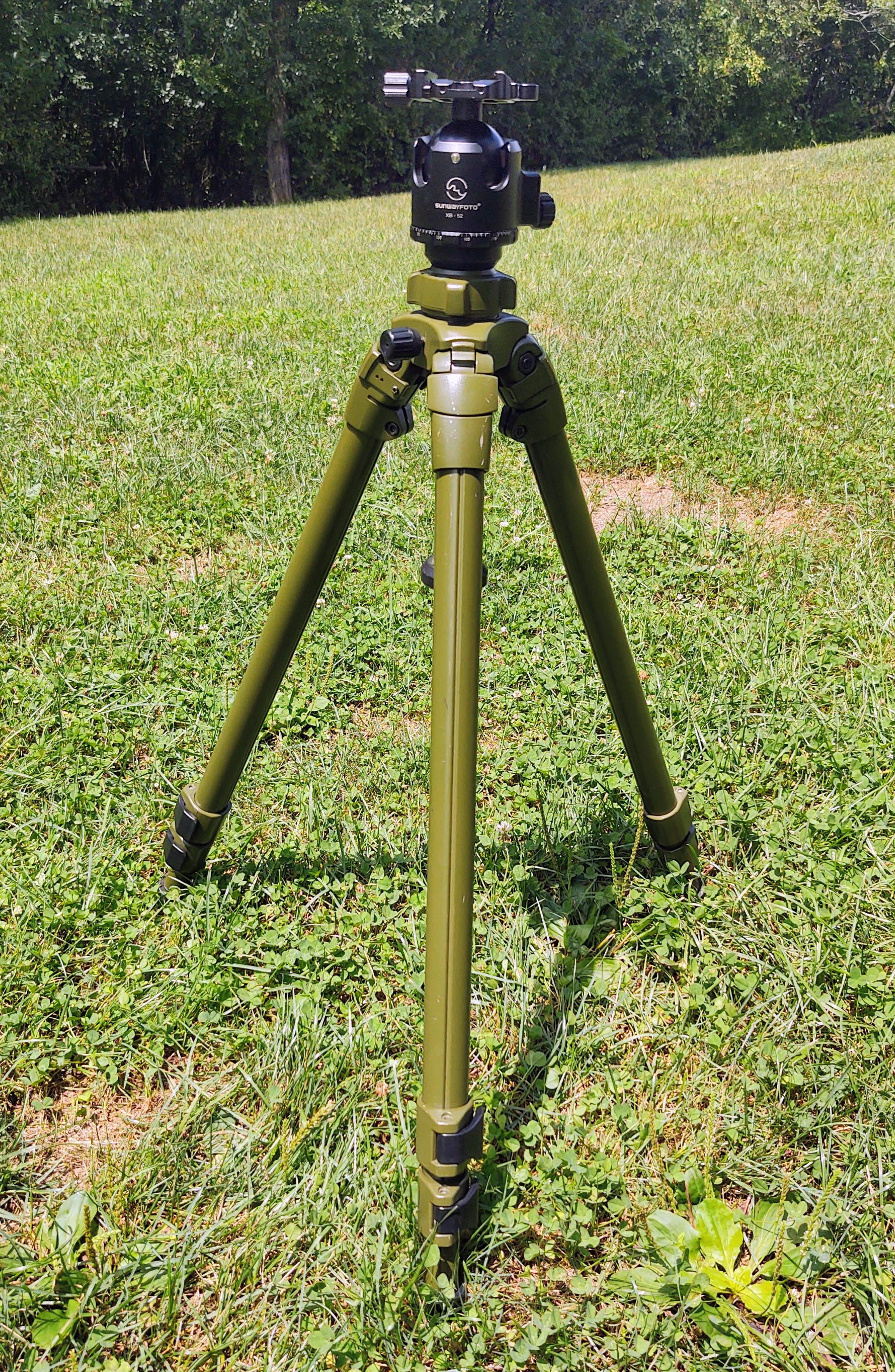

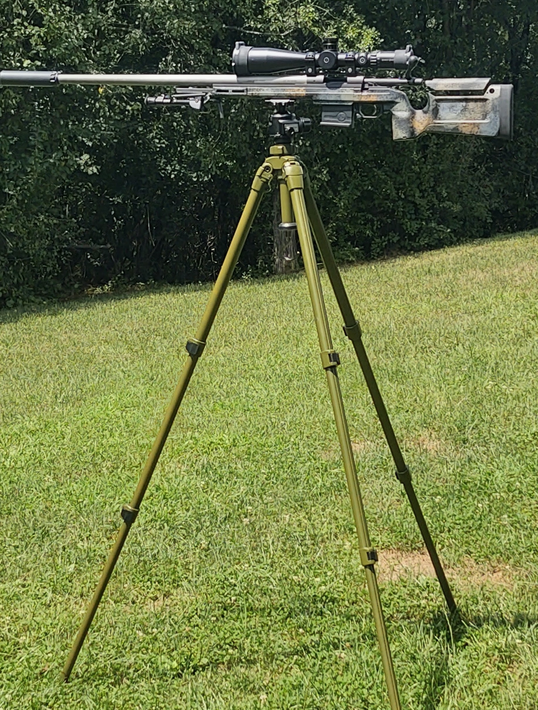

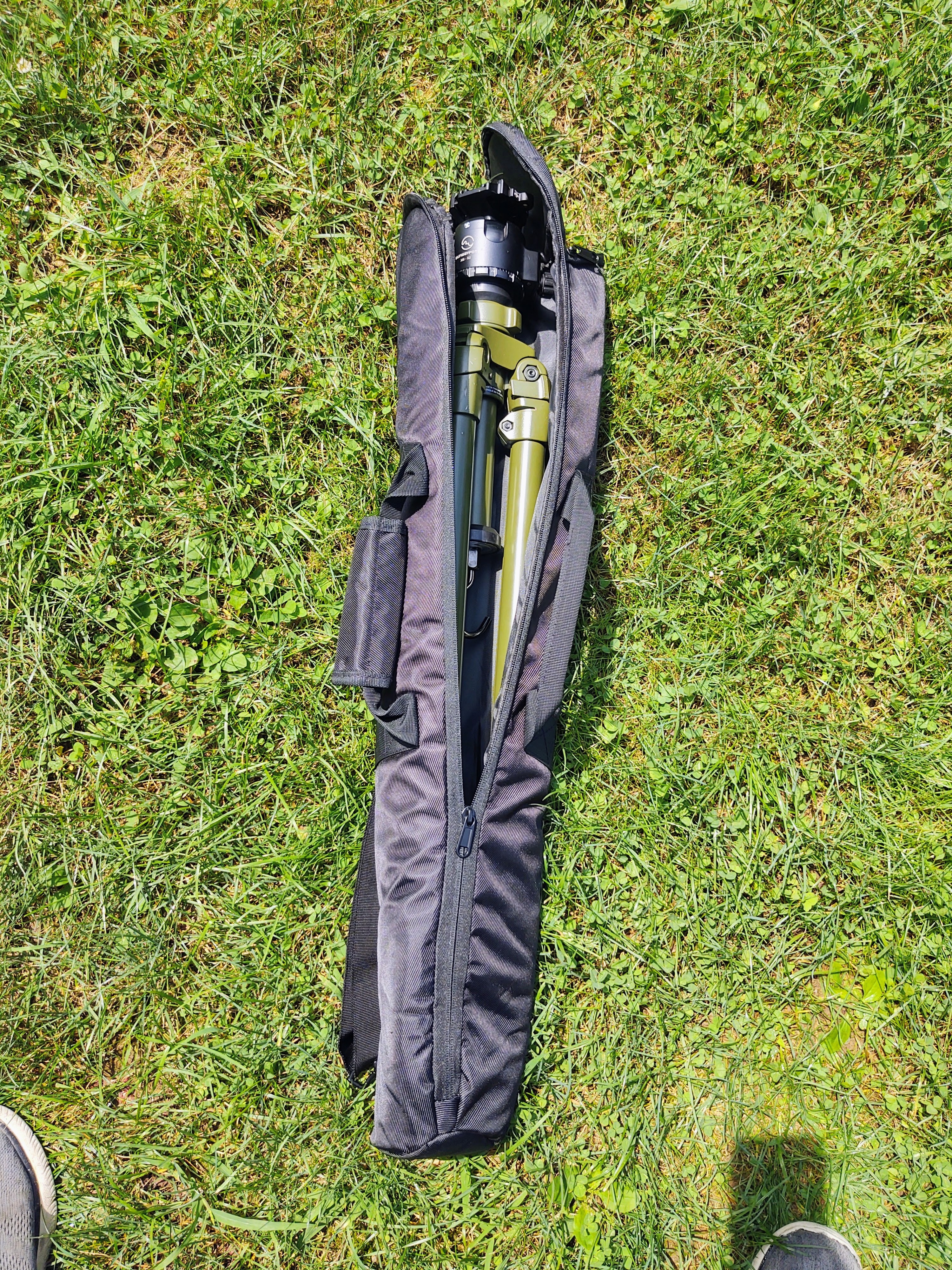

SOLD Really Right Stuff TFA-01 Ultra, BC-18 Ballhead and L Clamp
Like new. Over $440 if you buy new before taxes and shipping…
Really Right Stuff TFA-01 Ultra Tripod
Really Right Stuff BC-18 Ball Head
Really Right Stuff L-Clamp with Dovetail Jaws
$300 TYD USPS Priority and Insured.
PayPal friends and family with no note (message me shipping information on here)
OR
Gifts and services but add 4% for fees and I ship to the address on file with PayPal.
