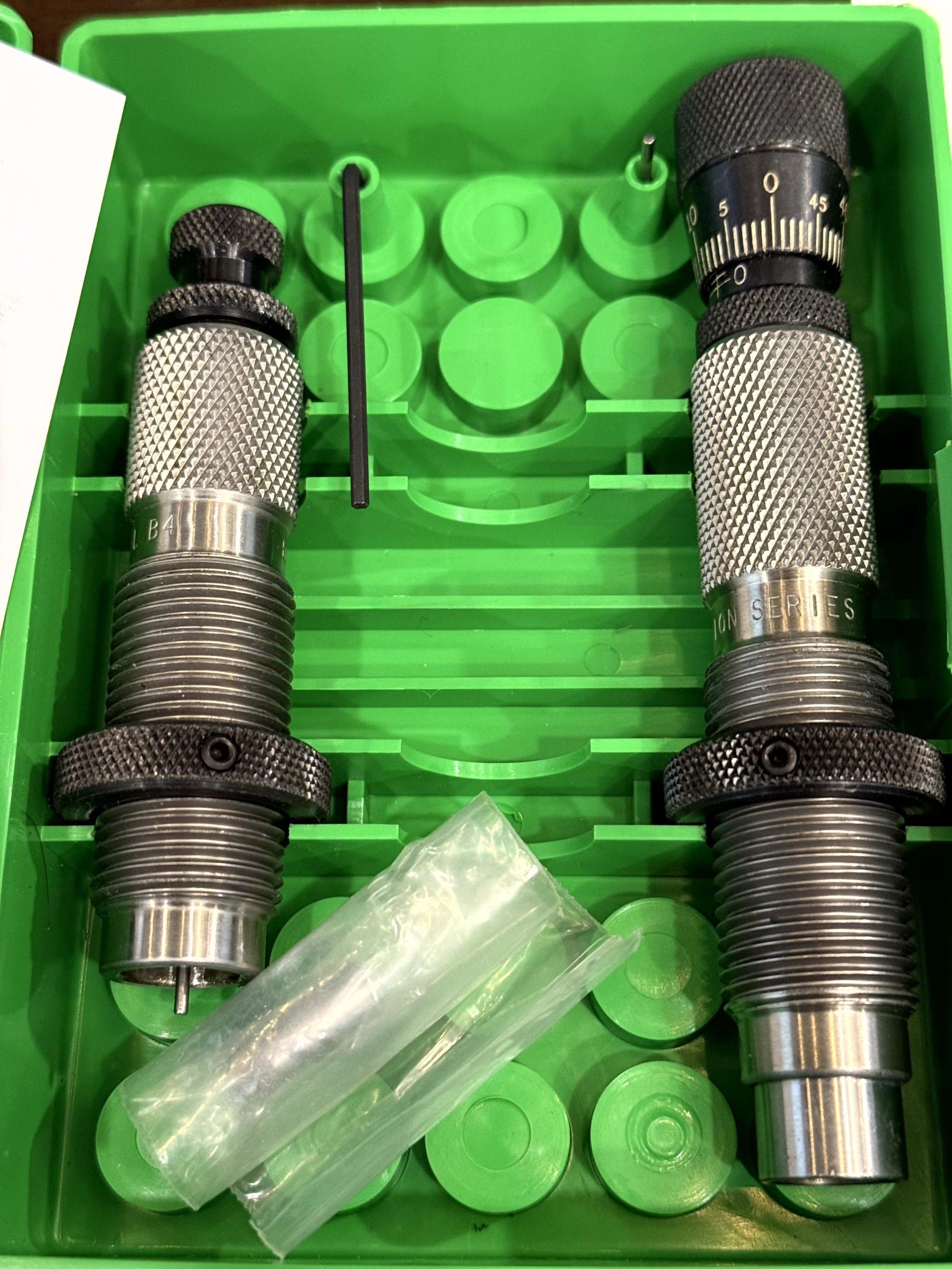

SOLD 7 PRC Redding Type S Match Die Set, #36936, lightly used. $170 tyd. Will include a Hornady 7 PRC Case Gauge, cuz why not! PayPal or Zelle preferred.
