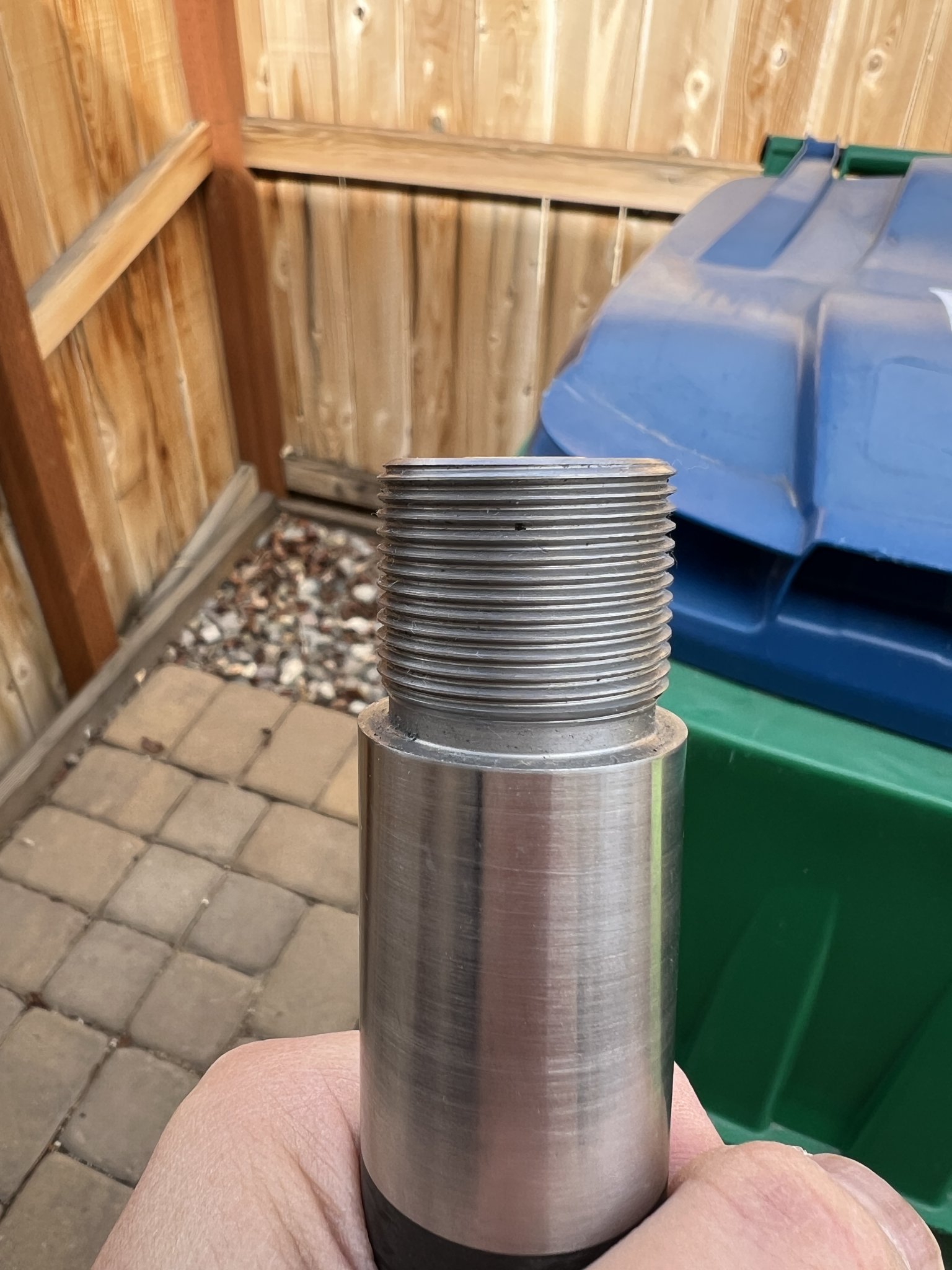

SOLD Bartlein .338 1.35" Blank Gain Twist 34"
Sold pending funds.
I have a Bartlein barrel blank up for sale. It's a custom contour, similar to a heavy palma with 0.1" added to all diameters with a longer 5.5" shank and a 34" finish length. The shank is a 1.35" diameter. It is a gain twist, starting at 1 in 8.75 and ending at 8. It is also 400 MOD BB steel. Perfect barrel for a 33XC, 338 Enabler, 338 LM IMP, etc. The additional length, material, gain twist and diameter made it pricey. Price is $850 shipped in conus.
