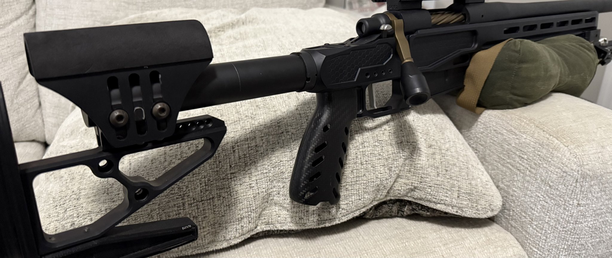

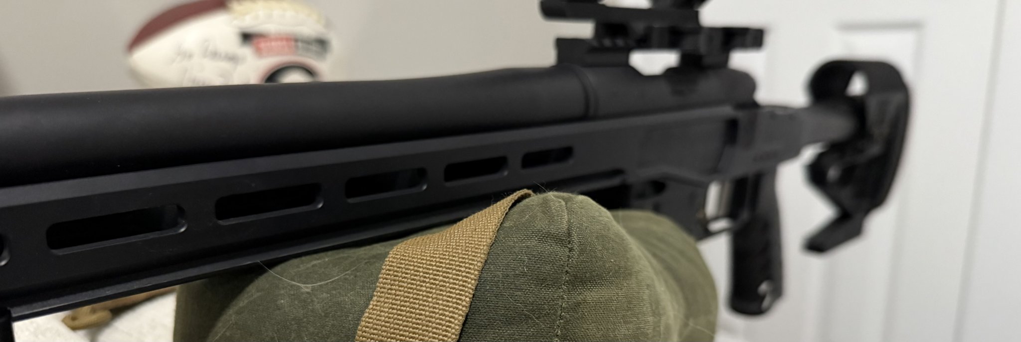

SOLD XLR Element 4.0 MG SA with TR2 buttstock
Viking armament Apex/ XLR Element 4.0 MG 700 SA chassis, only used for 2 matches, with a TR2 Buttstock and carbon Grip. I also have the XLR Carbon Fiber grip for it. $800 shipped with the carbon Grip. Only thing for sale is the chassis and buttstock. I’ll try to get better pictures up later. Still have original box the chassis came in.
