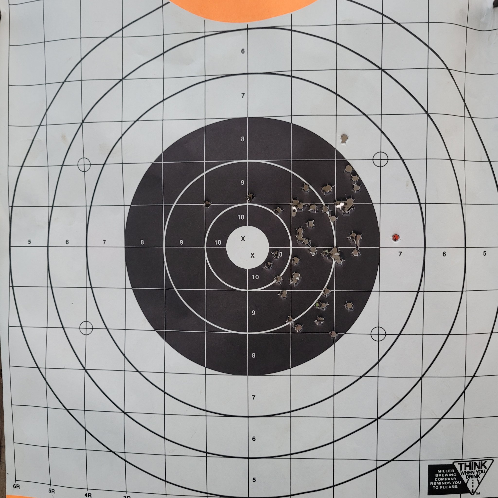

200 yards with rimfire
Winchester 40 grain copper washed Power Points, 1280 fps, old production
That ain't supposed to happen! Supersonic transition won't let that happen, right?
Well it would seem the transition doesn't affect the lowly 22lr....not at all.
That's as good as I can do with my Lilja and I have to use subsonic match ammo.
Daaaaaaayyyyyyyyuuuuuummmmmm! :D

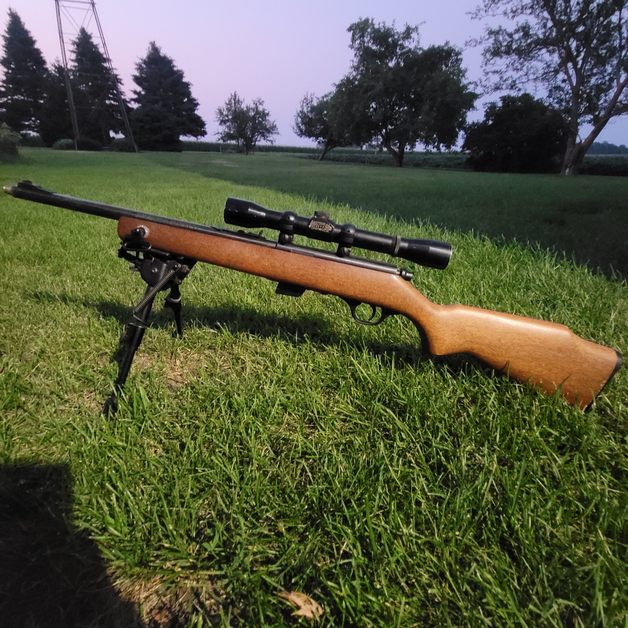

Well I thought I did it right and failed. For some reason I thought it was 100 meters.
Well I'll set up targets and re shoot tomorrow.
At 100 meters my little Marlin Model 25 with micro-groove rifling shooting Eley Club. With a 4x "All American Perma-Center" Lyman scope.
Not to bad for a free gun that was set up to shoot decoys off of hahaha. Not a match gun by any means nor was it designed to be a target rifle.

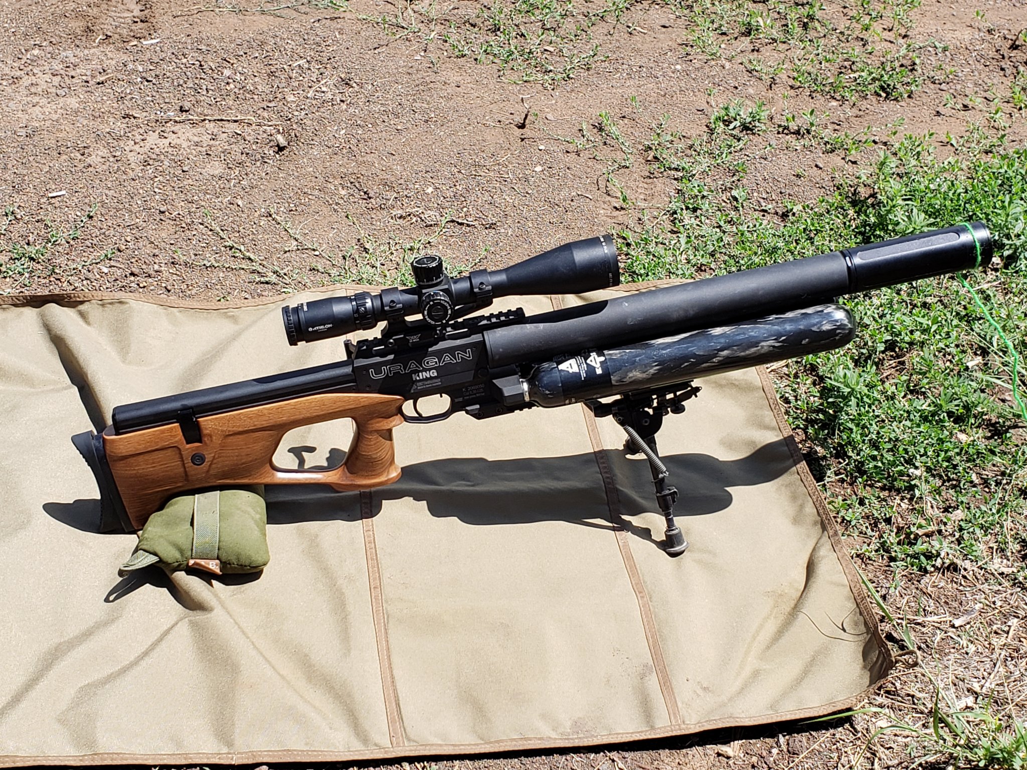

Here's two 5 shot groups at 200Y with my AGT Uragan 25 cal pcp air rifle. Keep in mind these are only .07 G1 BC 29gr "slugs/swaged lead bullets at 922 fps.

Here's two 5 shot groups at 200Y with my AGT Uragan 25 cal pcp air rifle. Keep in mind these are only .07 G1 BC 29gr "slugs/swaged lead bullets at 922 fps.View attachment 7682494
I’m not sure what the size of that target is, but if those are four inch boards, that’s unbelievably impressive performance at 200 yards. It would be unbelievably impressive even for rimfire.
Airgun he has is pretty consistent in its muzzle velocity, much more so than good 22 match ammo. My AirArms s410 pcp will group .2 or smaller most of the time indoors at 50 yards with pellets it likes off a rest. I wish my rimfires were as accurate, or rather I wish my rimfire ammo was better in quality.

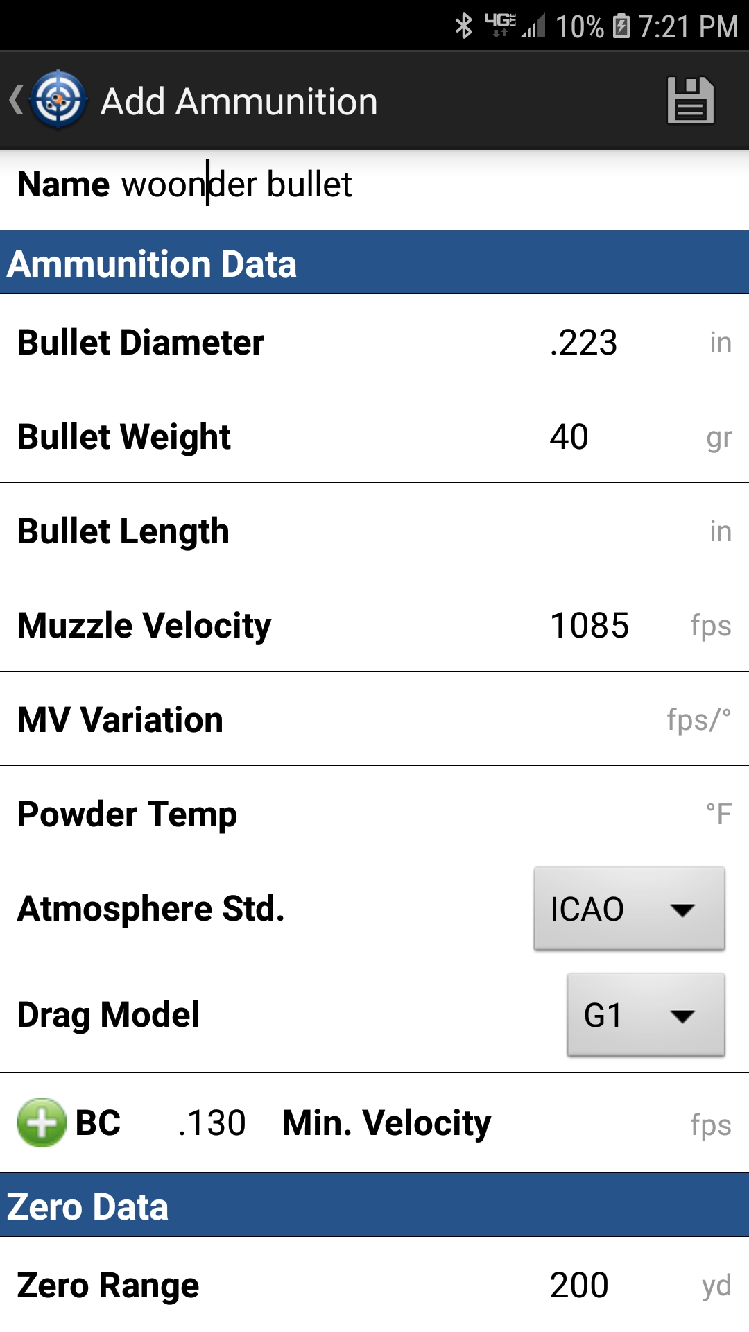

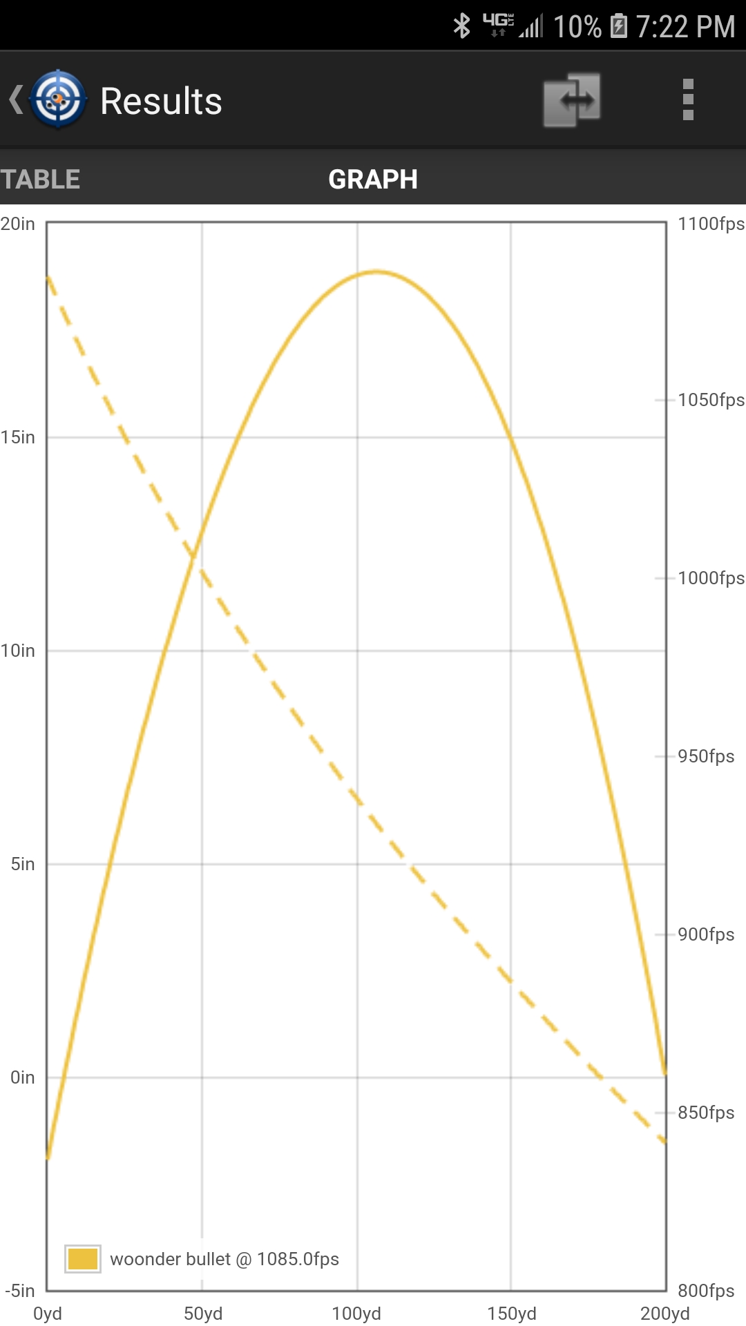

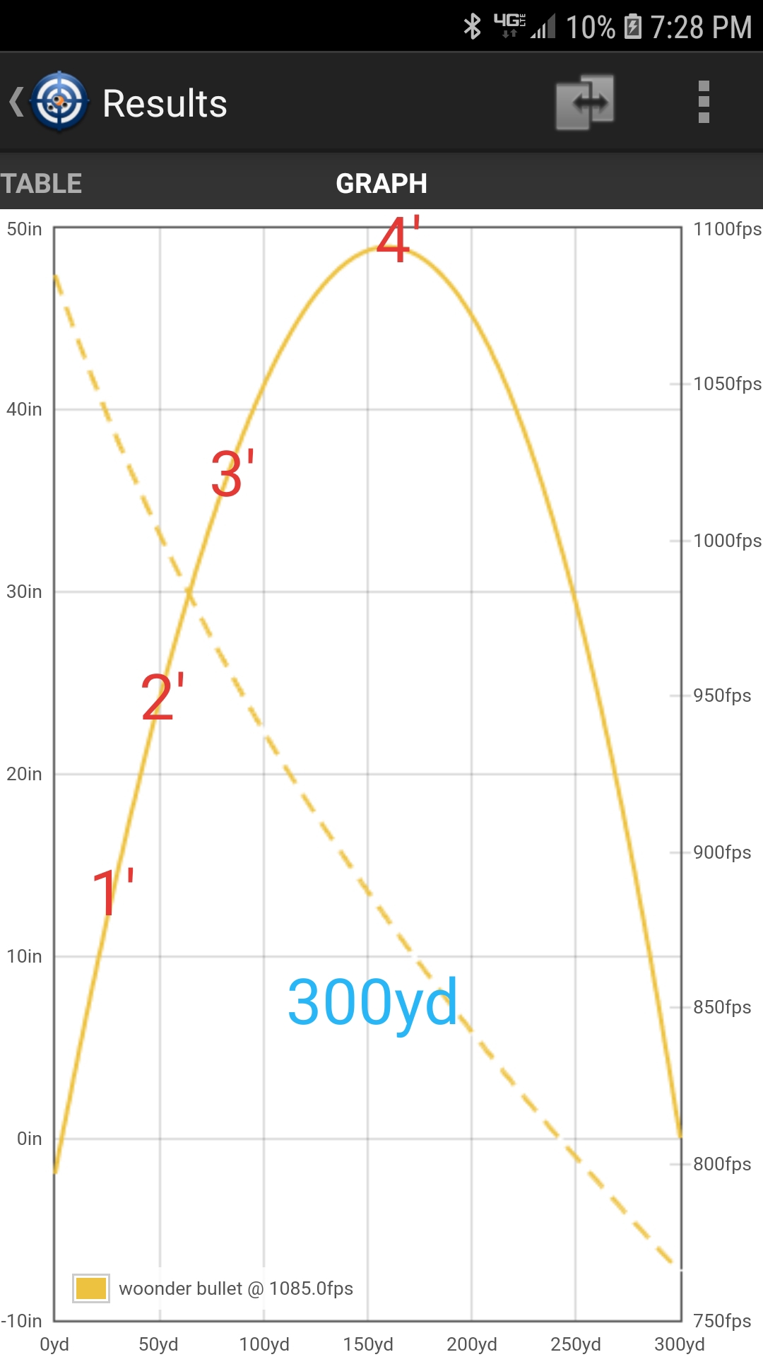

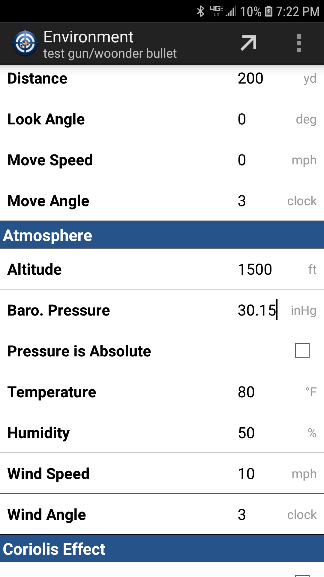

7 mils of drop is not the vertical climb of the bullet. It is solely the drop from gravity.
If you want to easily see the max ordinate of the round....its physical peak of trajectory....
Go into your solver and set the zero range (normally 25yd or 50yd for most people) to the distance the target is away (in this case 200yds). Then just run your program the same as usual. If you look at the graph section in say Shooter for example.....it will show you max ord.

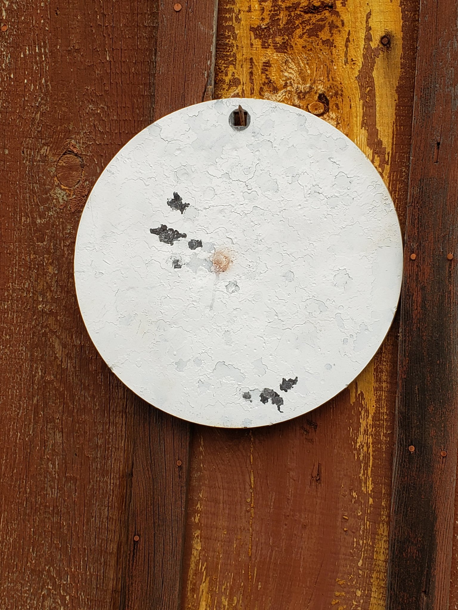

My dope is 10.4 mils at 200Y with a 50Y zero. The ES is pretty low, around 10 fps.
The round steel is 15.5" wide.

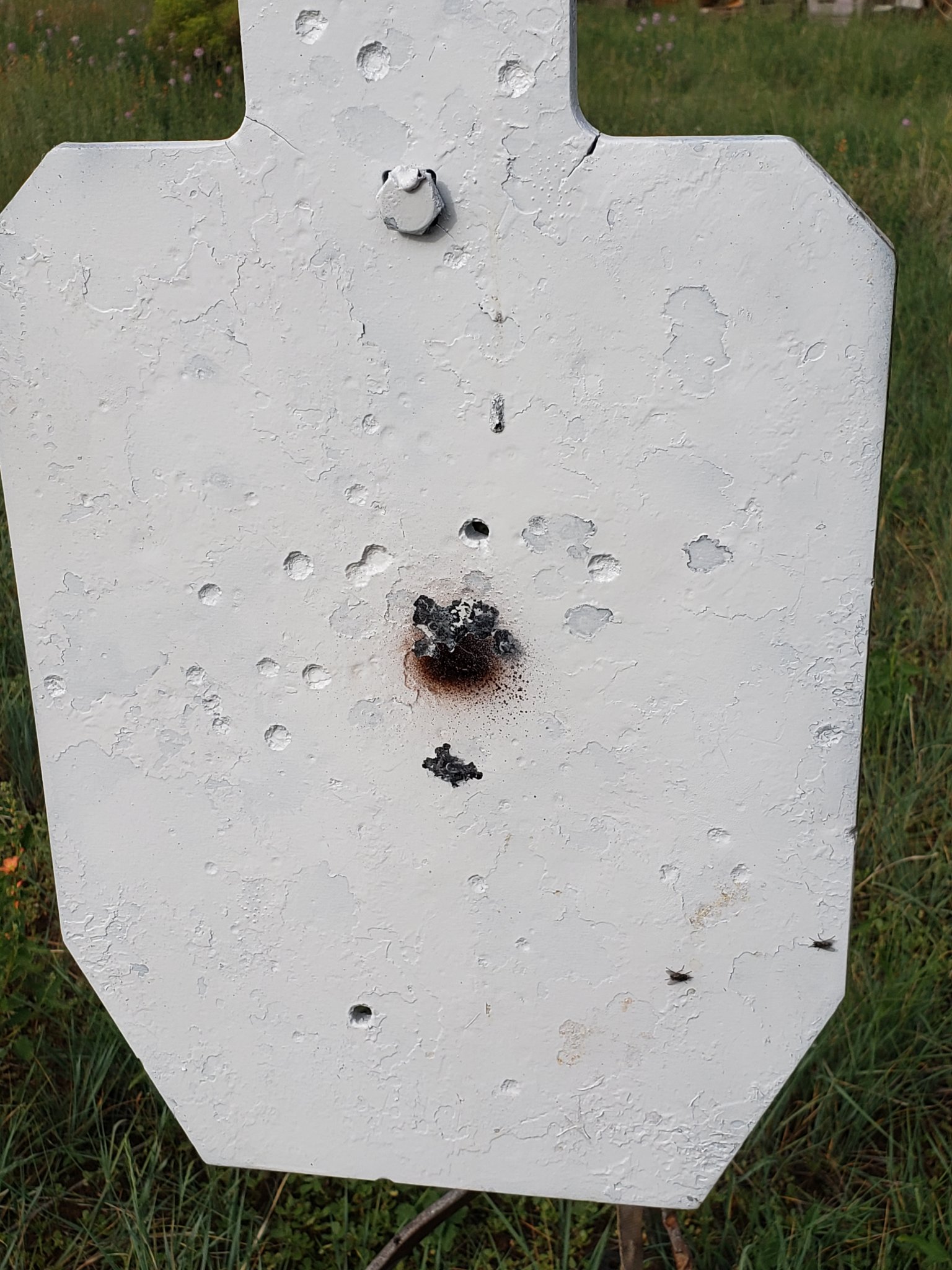

Here's 5 hits at 175Y on the 2/3 IPSC that I shot this morning, three of them were shot one after the other all in the center. There's one more right there with those three as well, then that low one. BTW there's holes in this steel from an AR from years ago so ignore those.

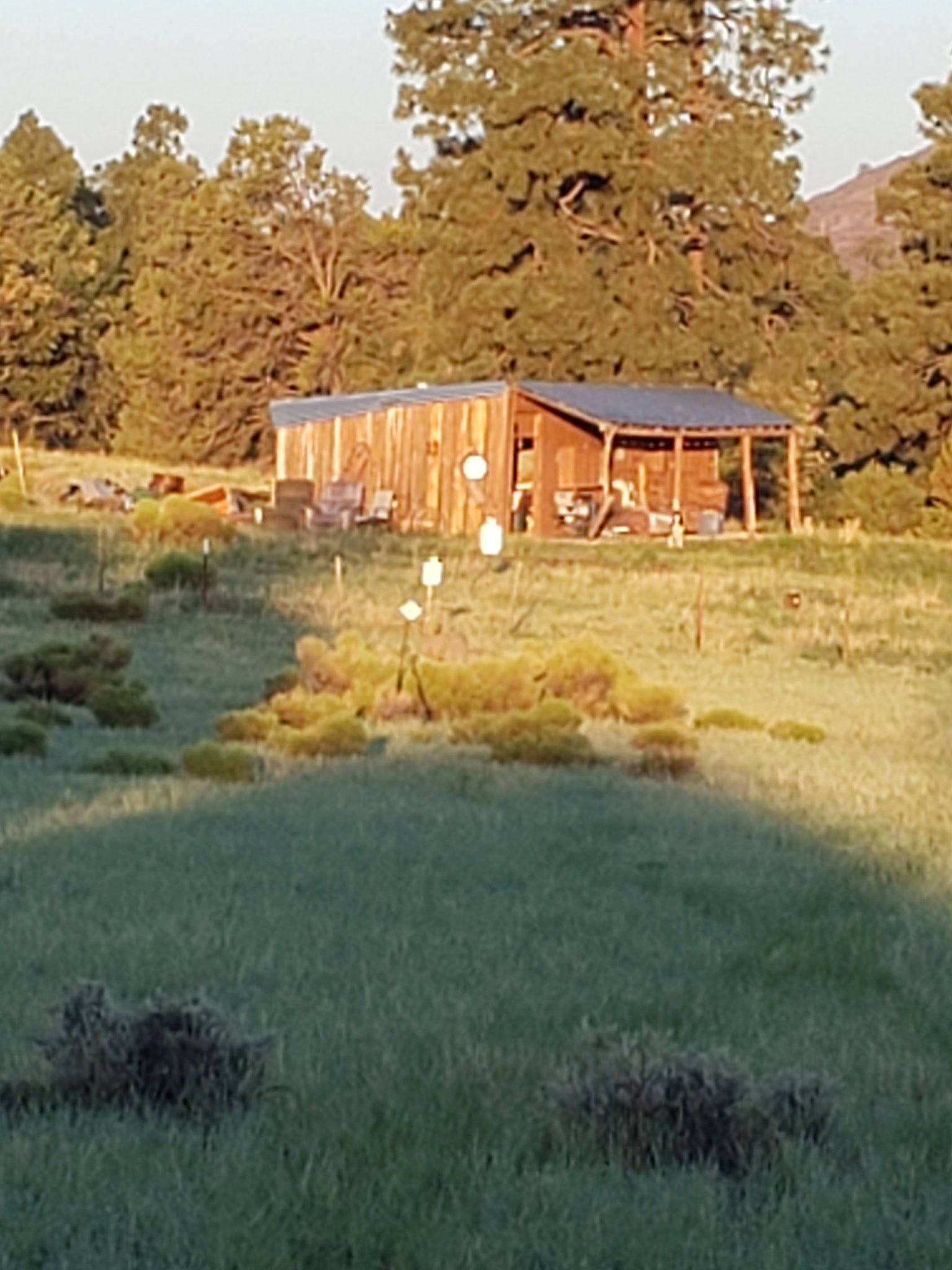

I had steel at 50Y, 125Y, 150Y, 175Y, and 200Y. I mention this because those two particular hits were shot while engaging each distance twice using holdovers. The dope is on the money I'd say!

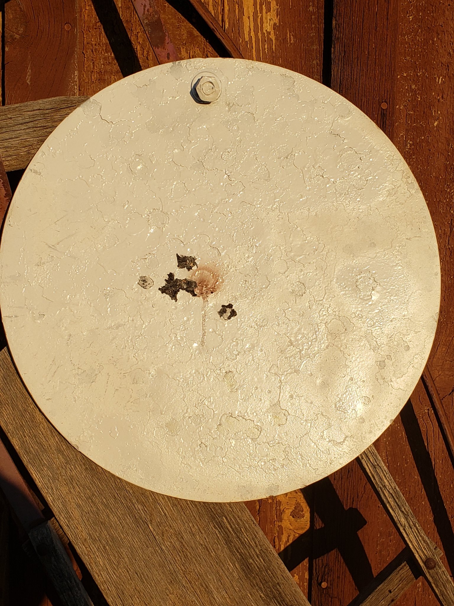

5 more at 200Y on the round plate.
Yep those are my hillbilly recliners.

A few cartridges had dings on the drive bands
but otherwise decent looking ammo.
ES right at 40 fps, quite good
AM-JKLVGNqdpqm7WtoFBuBgd5KKZGr_n74pBpK6U2ltEC000fRXaQAbxLxlKJCY88jaKcS7pNxJNr-ocye0KeZssXcI8DfaLFcLxCglRBU_1Nwt7HvdQNAyq-A5fyMyyJ8K3bOheLRTrUSM5iP5NJrxvzhwZ=w472-h643-no
Except for a few ding related strays, not bad for a less expensive Eley product.
