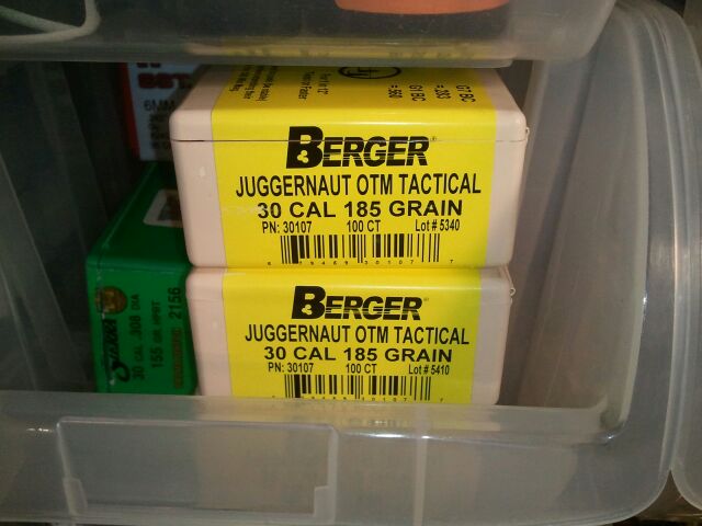

That's why I gave part #'s, because the names are sometimes confused/mis applied, I'm especially guilty of this.
To confuse it even more, I have several boxes of the OTM Tactical that are labeled "Juggernaut OTM Tactical"

From Bergers FAQ section of their website -
What is the difference between the 30 Cal 185 Grain Match Juggernaut Target and OTM Tactical? (30418 vs 30107)
These are simply different naming conventions that we use to clarify that the bullets can be used for each application. The military requires that OTM (Open Tip Match) bullets be clearly defined as OTM in the product name for clarification. There are no differences between these two bullets.
When they first came out with the rebranded 185gr LR Boat Tail aka Juggernaut there a slight difference in the degree on the heel of the bullet
OTM had 7degree heel vs the 9dregee heel of the boat tail on rebranded 185gr LR Boat Tail. Now of course they are they are the EXACT SAME bullet.
