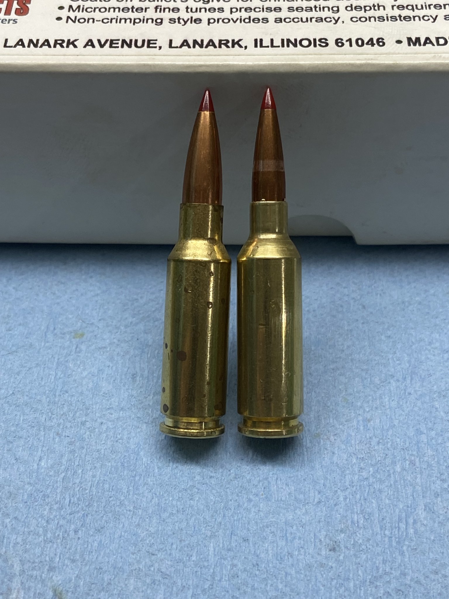

To not completely derail this thread. I'm hoping to raise the goal post for 22ARC this weekend.
Shooting the new Hornady 62gr ELDM-VT from the 18" Valkyrie.
Lever
XBR
H4895
Staball Match
Then we'll see how the 22 ARC stacks up.
It wont be fair since Hornady as of now is not planning to offer factory 62 VT loads for the Valk.
It would be very interesting if @Ledzep could load a comparison 224 vs. 22ARC with these 62 VT's at the 58K SPC pressure vs. 52K Grendel using their proprietary blended powder. That would have my full attention if the ARC in-fact rained supreme. I suspect speed would be close, but ARC likley would be easier to tune.

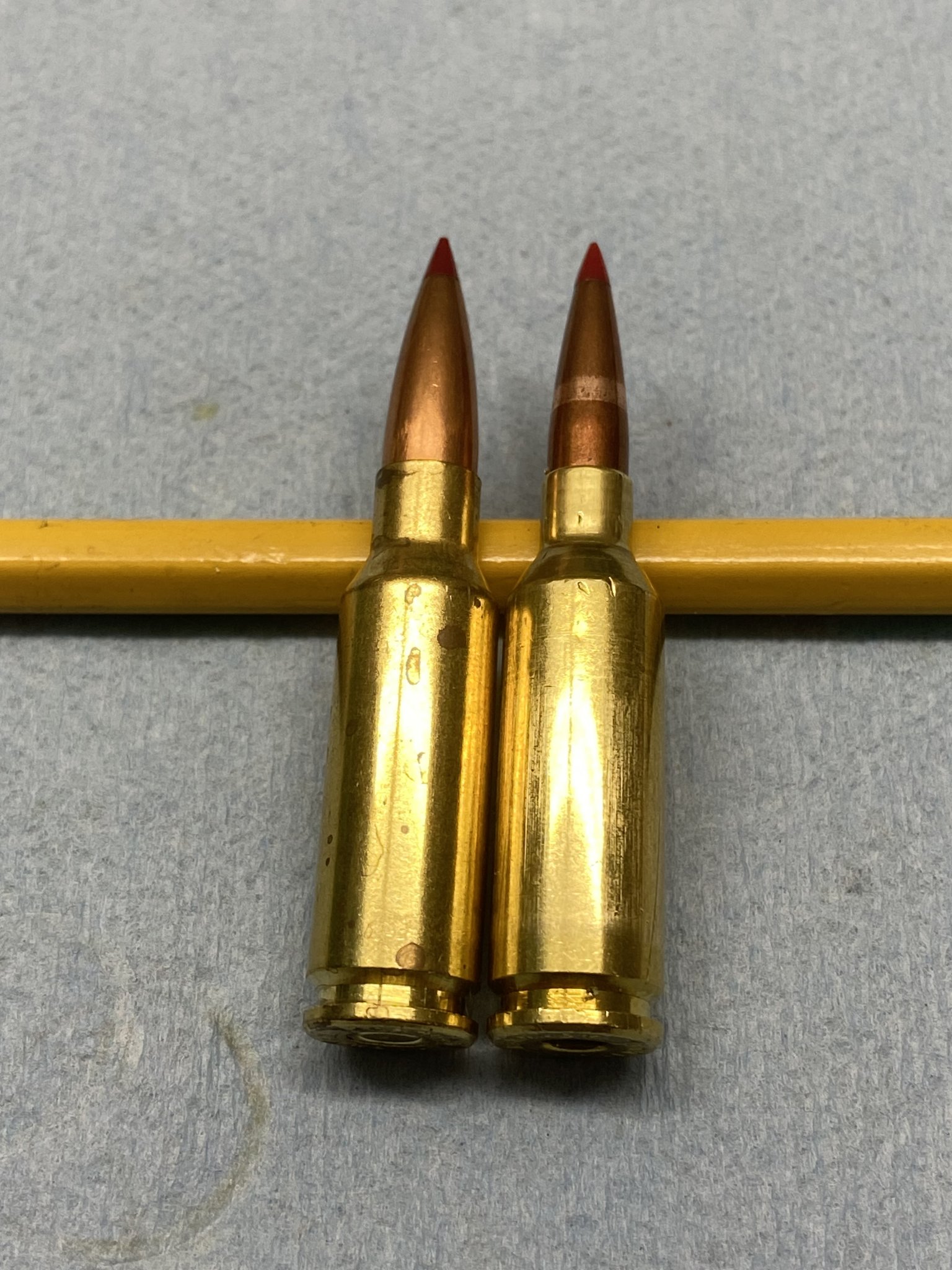

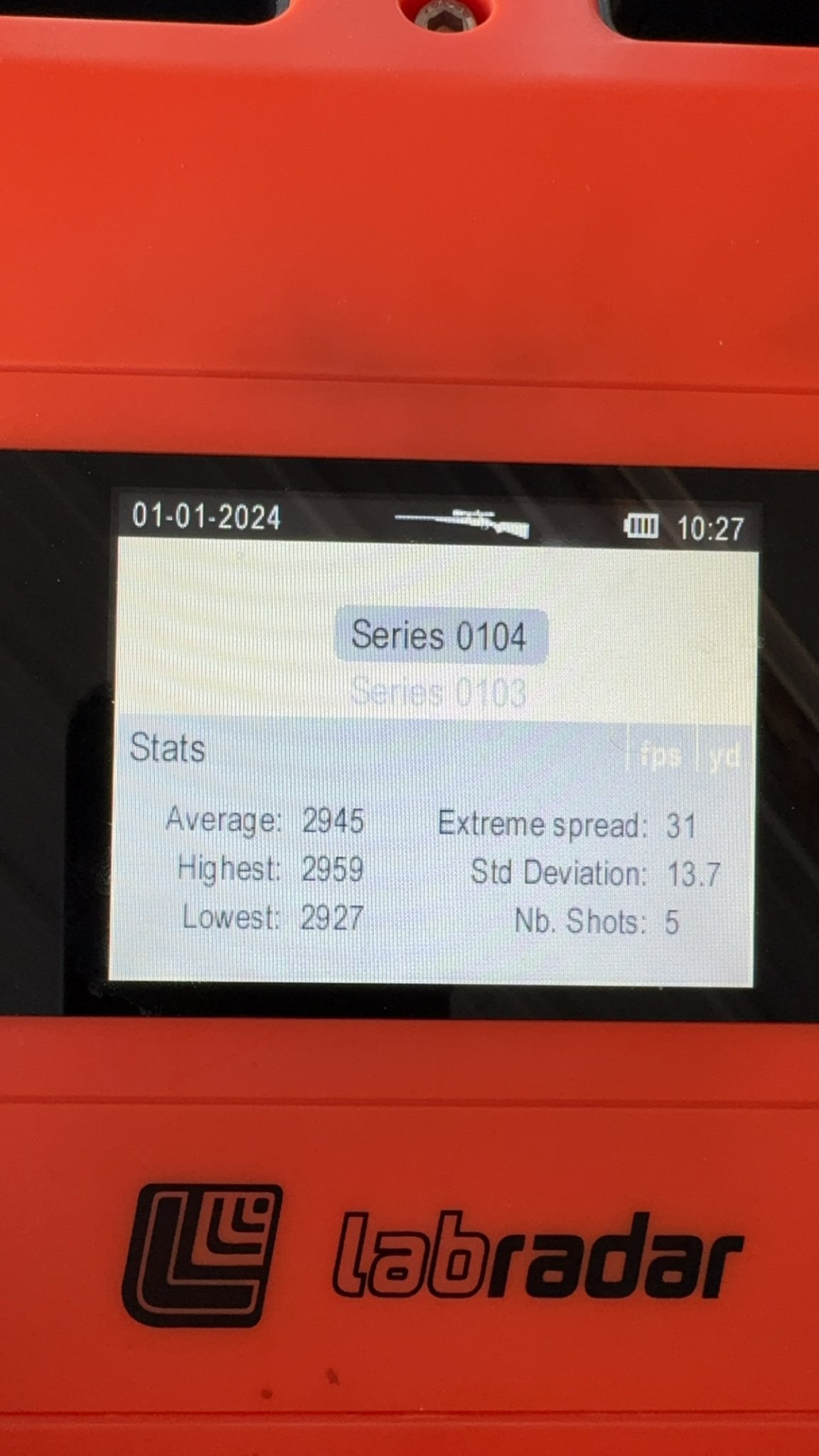

I was goofing around at the loading bench this AM…
In case anyone needs motivation….
Valkyrie is awesome, our Valkyrie bolt gun is a sensational shooter at base pressures. Like the looks of your shooting lane.
How was your accuracy?

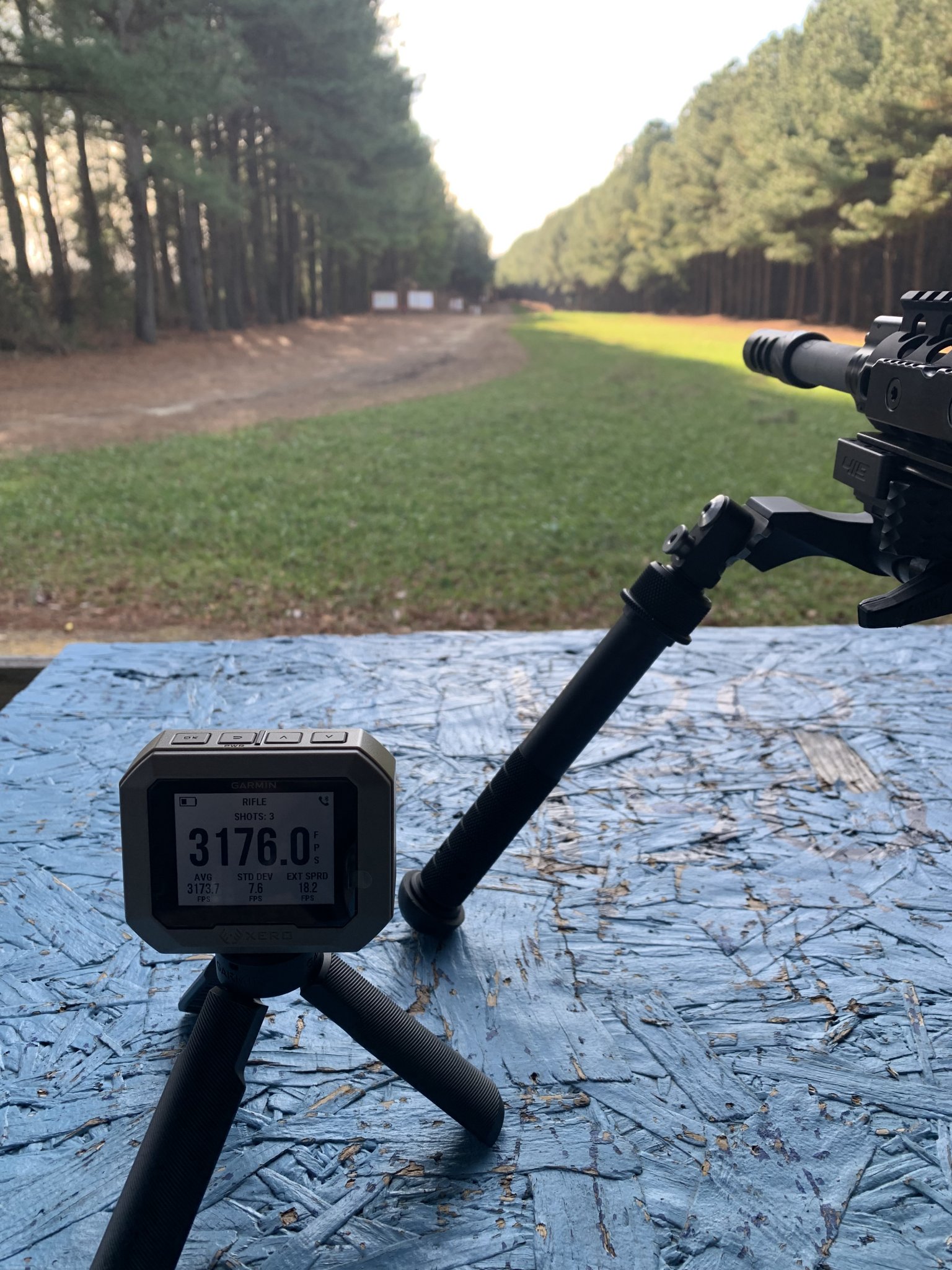

It was good with 2 of the 4 powders & decent with 1. Lever & XBR were best & within 3fps of each other. I’ll measure some groups tomorrow. The Lever load has some head room to go higher, but 3175 is pretty damn fast from an 18” & I’m trying not to kill brass. With the XBR I’d consider 3175 max, but it shot very well & brass looked good.
All loaded 2.285 since all my 6.8 mags allow 2.295-2.3”
BTW the Valk is a 7T

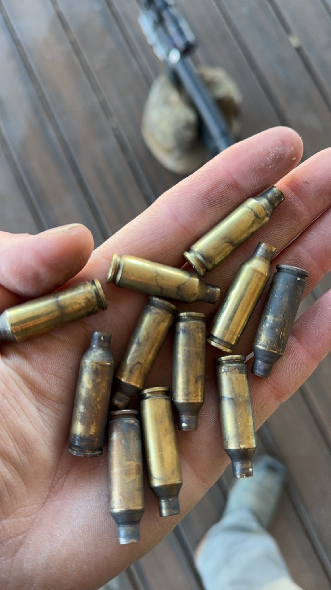

Ya. I'm using a +2 in a 22 Grendel. Had to use a JP Variable Mass with all the tungsten buffers to minimize the brass gouging. Don't know why 22 ARC would be different.
I predict a lot of posts on the forums about guns destroying brass when the lower end companies start producing 22 ARC barrels and uppers. Between Hornady brass, .22 bores, and cheaper rifling.

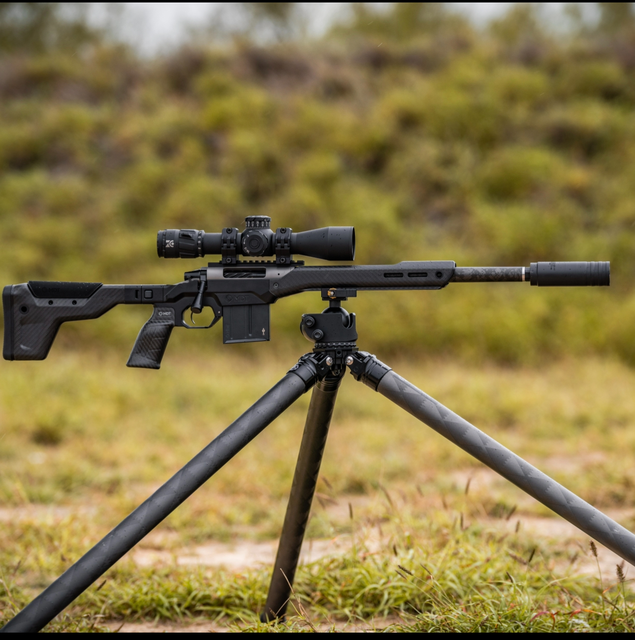

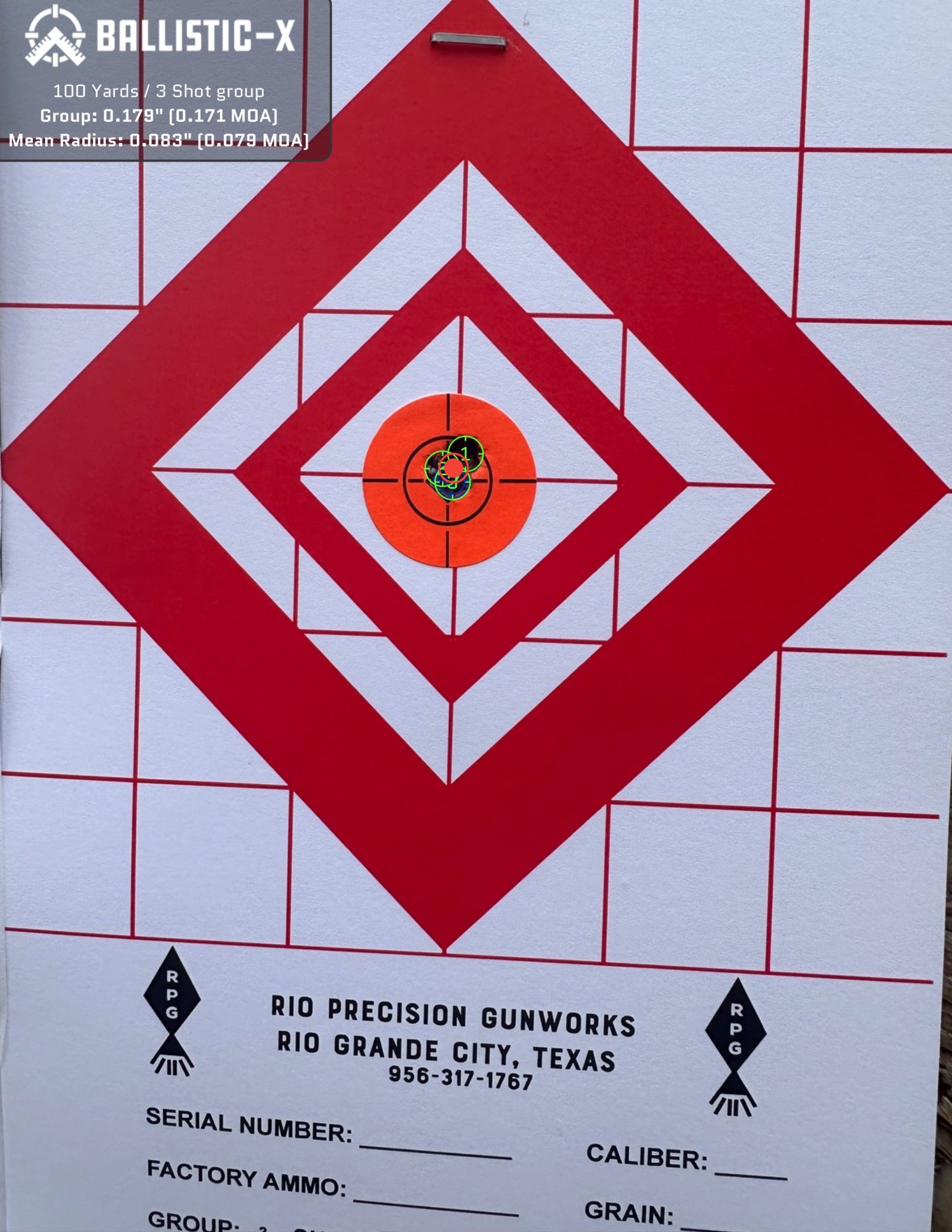

Pretty sure we aren’t even gonna load for this rifle. 16.5” proof carbon, mdt hnt26, mac bros evo II action. Alpha 22arc reamer.
88eldm Factory ammo

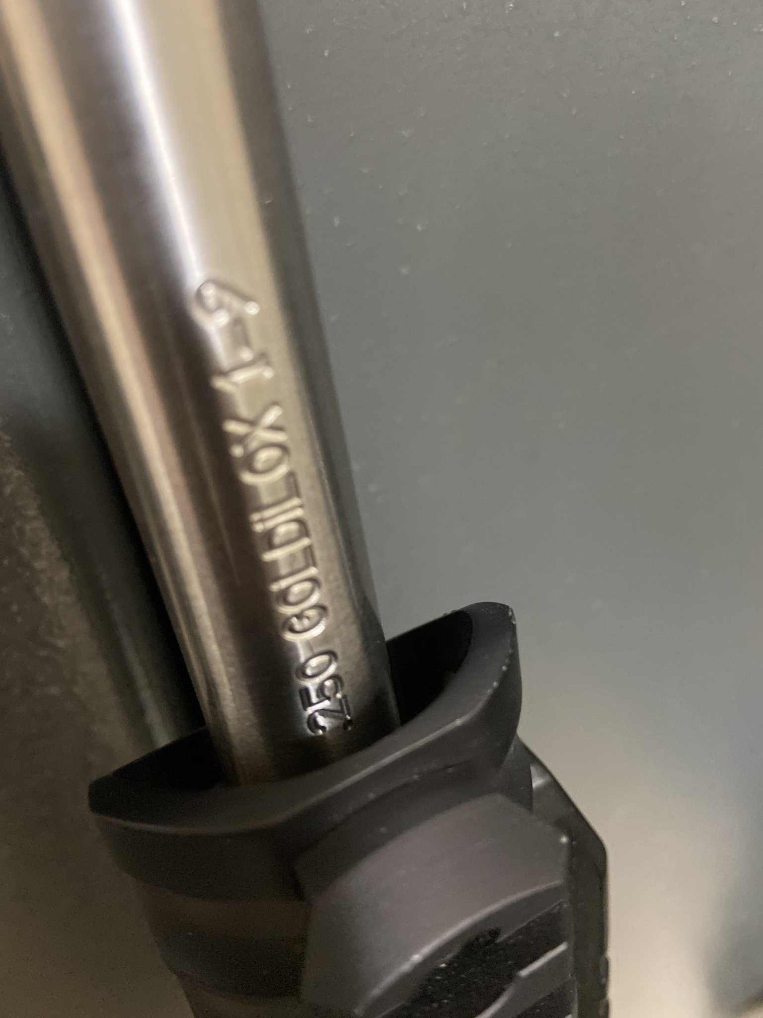

6GT is the Goldilocks of mid capacity .473 based cartridges. Not too small, not too big. Neck up to 25, neck down to 22. Great barrel life and enough capacity to push heavy-for-class.

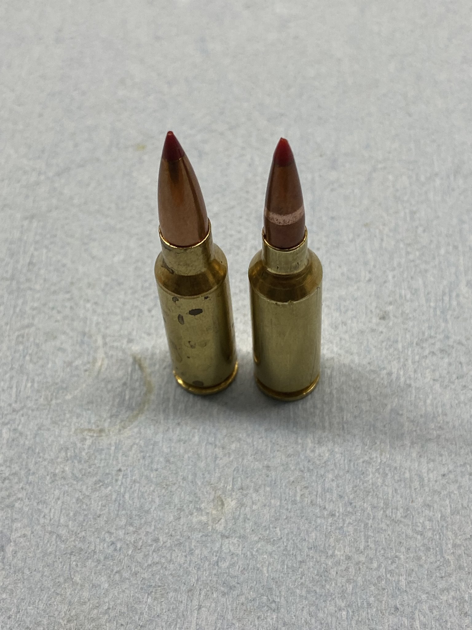

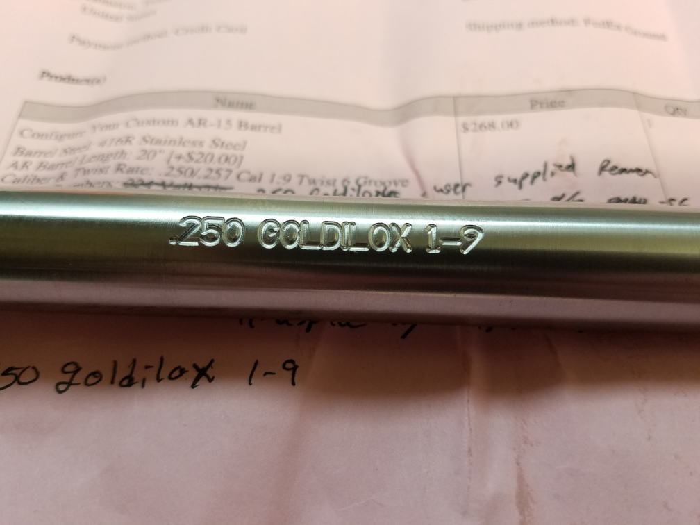

The 250Goldilox is the Goldilocks in the AR15 platform which was created before the 6ARC was released…. It has the ability to push the .257 110gr ELDx/ 110 Sierra Game Changer 2600fps from 20” tube and 90gr- 100gr well over 2850fps… I love when someone works on something that brings more innovation..Thanks for the 22ARC because it brings the REMEDY!
You’ll never see a pro golfer shoot the whole course with one club!!
