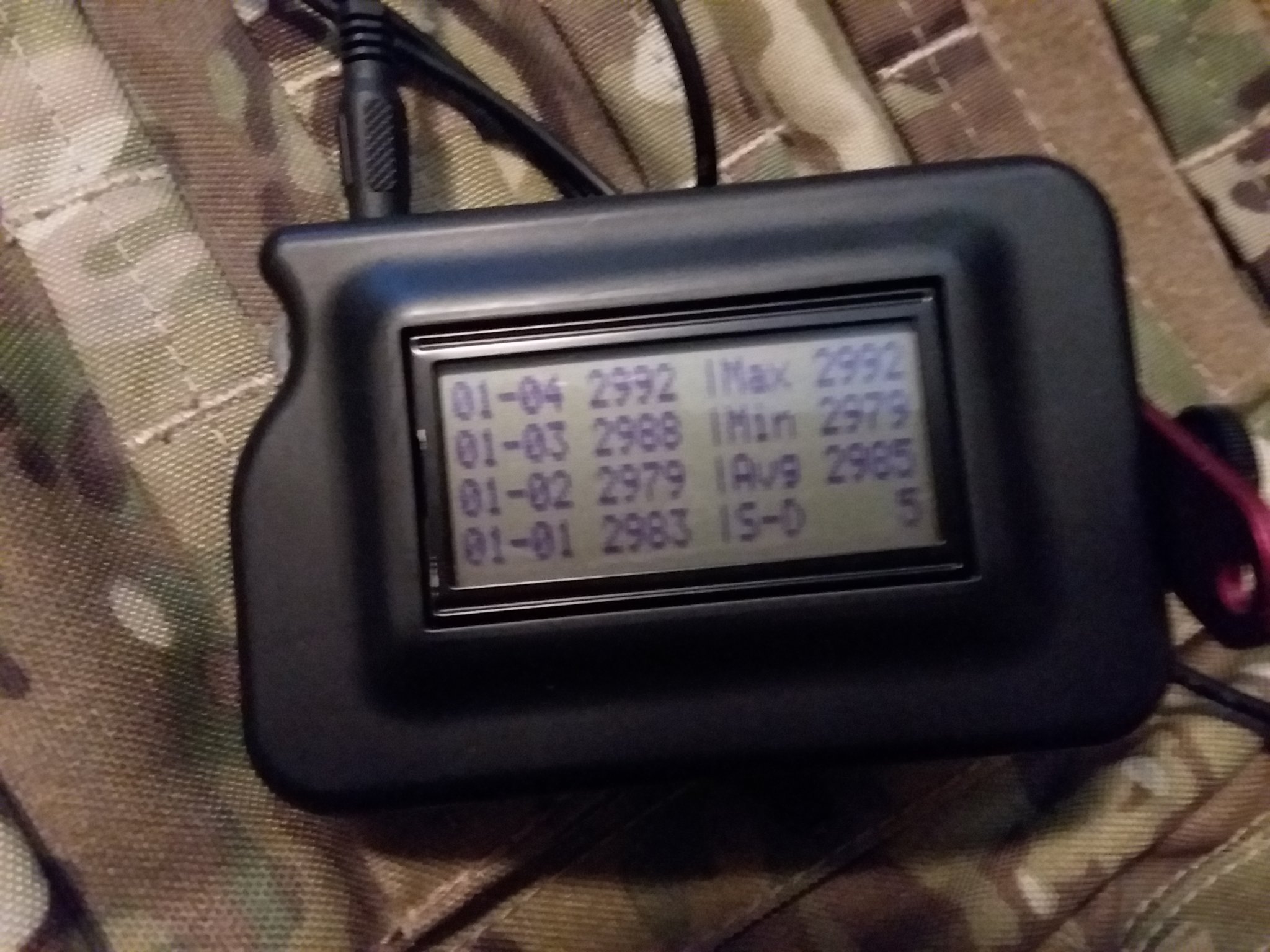

Did a cold weather test with my usual load. 4°... real feel -16. Ammo sat out for about 30min if that really does anything, they sure felt cold as ice cubes. Winds were horrible so just rang out 4.
73 eld
29.2gr powerpro2000mr
Cci450
18" rc 7tw
7037566
According to notes, fps is same as initial load testing, sd here is a little bit better but I shot a 2 more rounds the first time around, notes show 6 rds at an sd of 9 fwiw.
Avg fps is down by about 40fps according to the F1 I used after the rifle had about 500ds or so thru it at 3022fps avg. Notes show all calibers chronyed that day had an increase of 40-50fps so it may have been the F1 playing games...it finally broke a few weeks ago. That sucks because I was looking for something definitive.
Thats all I got.

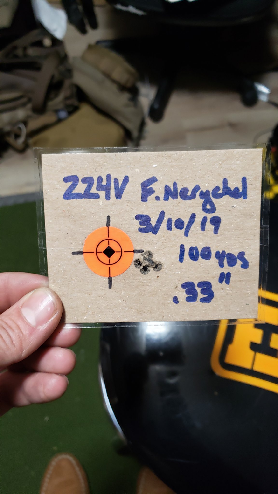

Finally got the 224V out of the closet after a busy month and was able to confirm a good load with H4350 at 100yds, 400yds and with multiple shooters. I think this will be my go to for the next 1000rnds or so until I need to switch bullet lots.
26.8gr H4350 2.300" OAL
88 ELDM @ 2750fps
Had my buddy shoot this one:
7040470
And I shot this at 400 (4 shots):
7040472
Along with this one (5 shots) at 400:
7040474
Next trip is to the 1k range for long range confirmation.

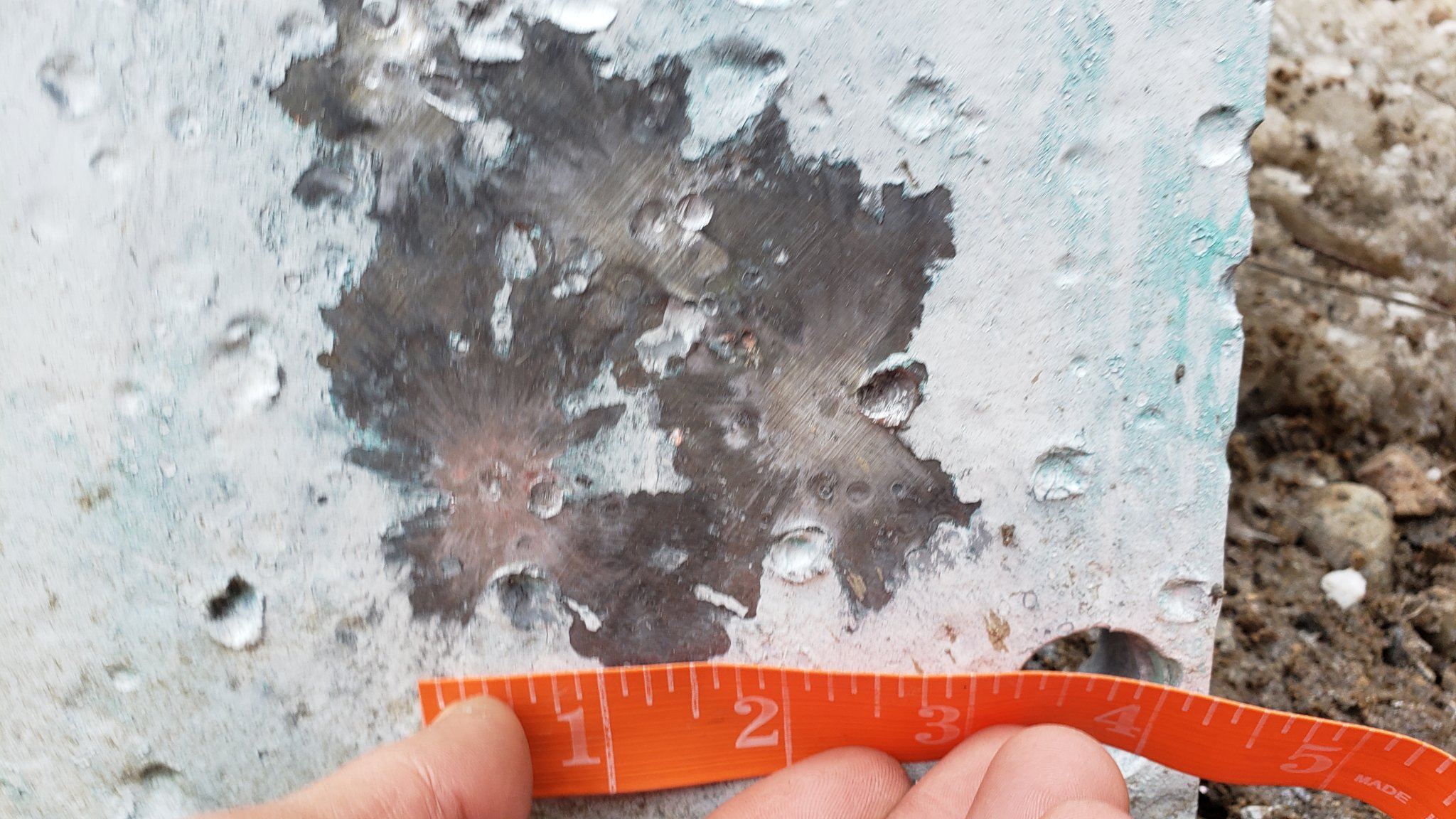

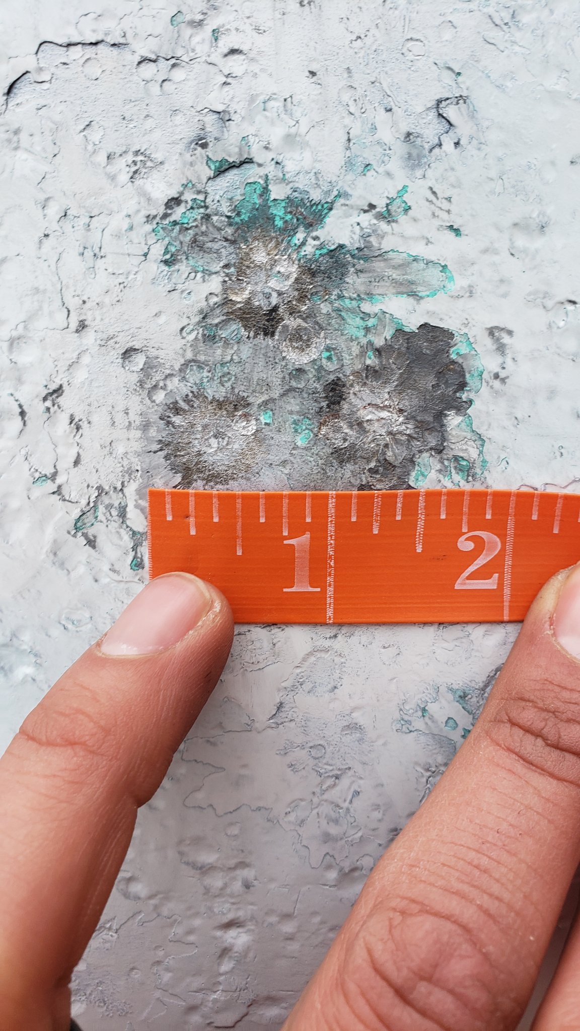

Needed to post this here as a service to any 224 Valk gas gun shooters using the 88ELDM : polish your seating stem to fit the bullet EXACTLY so it doesn't leave any rings on bullet nose...here's why.
Same charge, same bullets, same brass, same powder, same OAL and Ogive when seated... Two different seating stems: one polished with Valve grinding compound and lapped smooth. The other is new straight out of the box, unmodified.
This is a compressed load to maximize the effect of hard seating.
Shot at 388yds with a round robin, mixed pattern (no two bullets of same type shot back to back) to spread barrel heat over all groups:

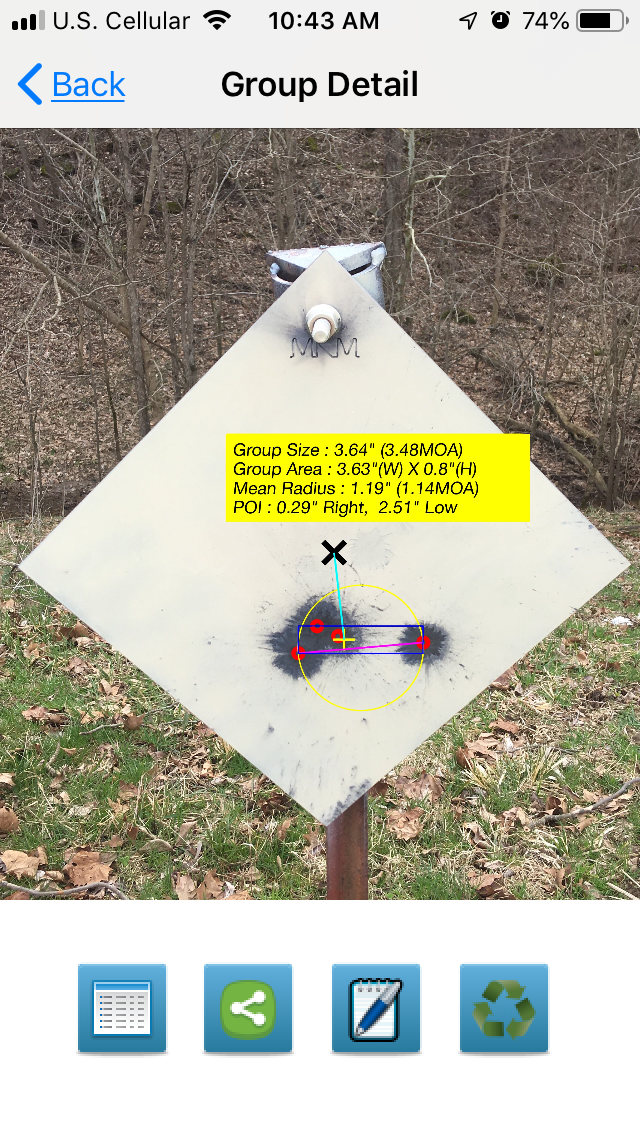

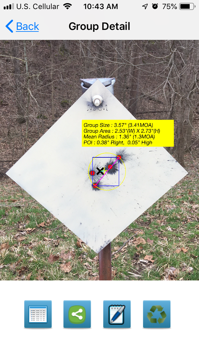

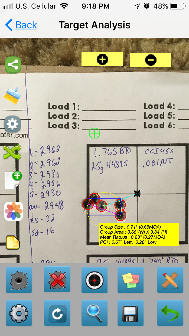

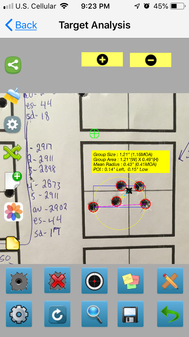

Well had a looooong work week and finally had time to shoot some loads that was suggested to keep trying on and it payed out!!!! I loaded 15rds of 25g of H4895 cci450 .001NT at 1.775bto, 15rds of 25g H4895 cci450 .001NT at 1.765bto, 20rds of 25g H4895 cci450 .002NT at 1.740.....0.035” off( I know was supposed to load more but I ran out of primers)
A6190897-CC58-41FB-AFD9-D7AB1CCF9215.pngCF9C1273-FAC7-42A8-A788-FDD83AA267F3.png9BC1BB1C-F41A-4970-A1DC-70E6C2A877E9.png3A8105C2-08E0-47AE-88C7-5EF734A8AEF9.png
NOTICE: I had my head up my ass and measuremented the plate wrong on the app.....I up dated the the groups

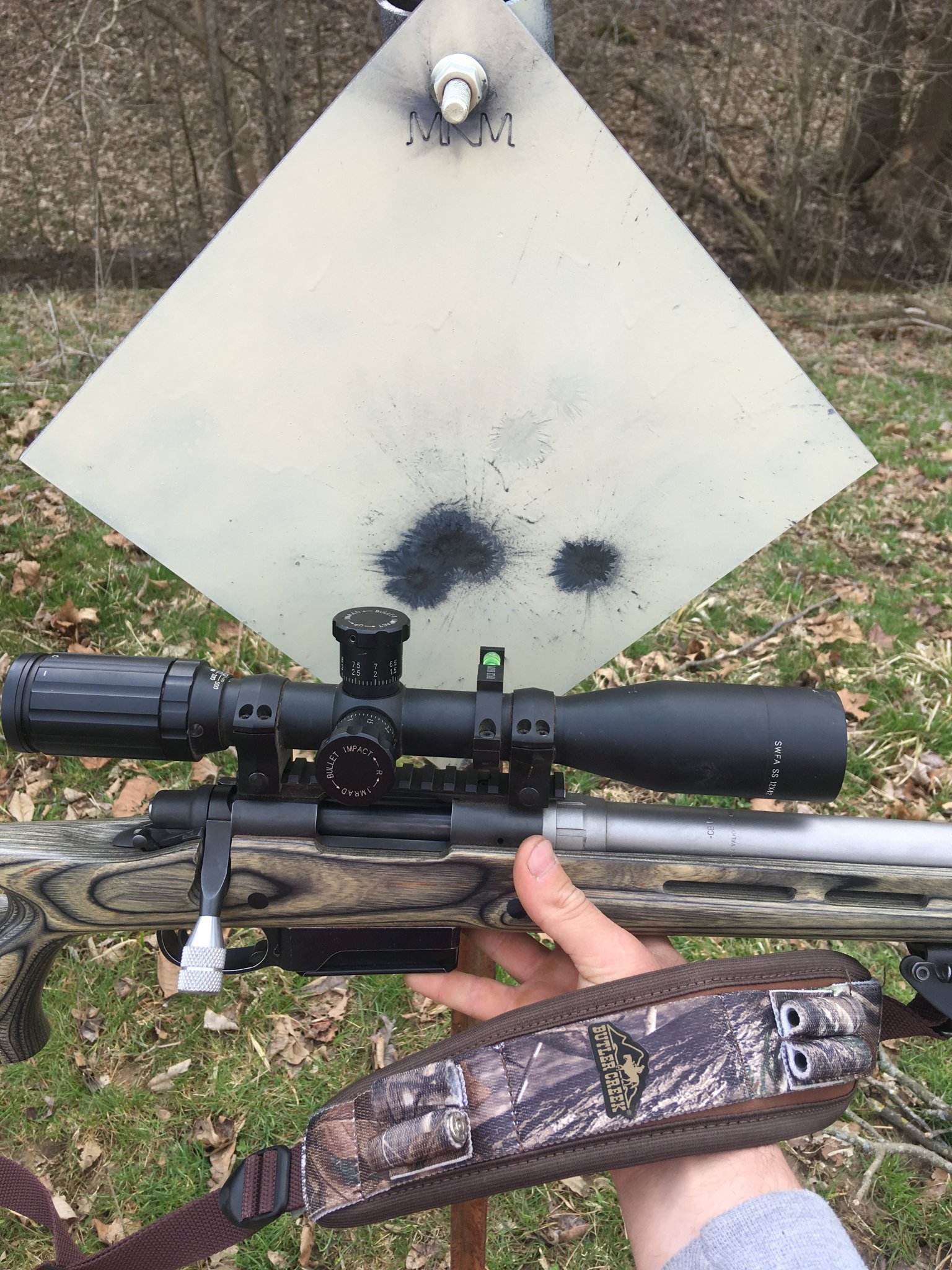

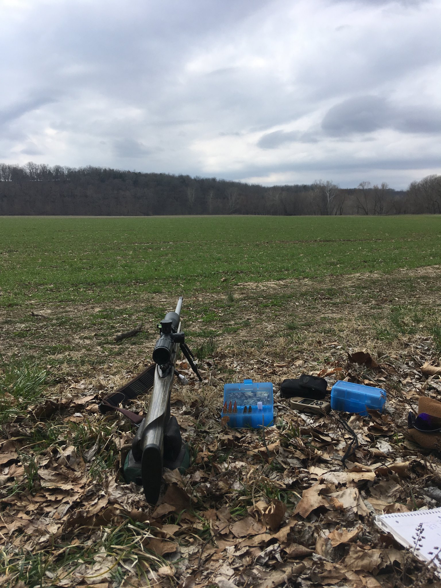

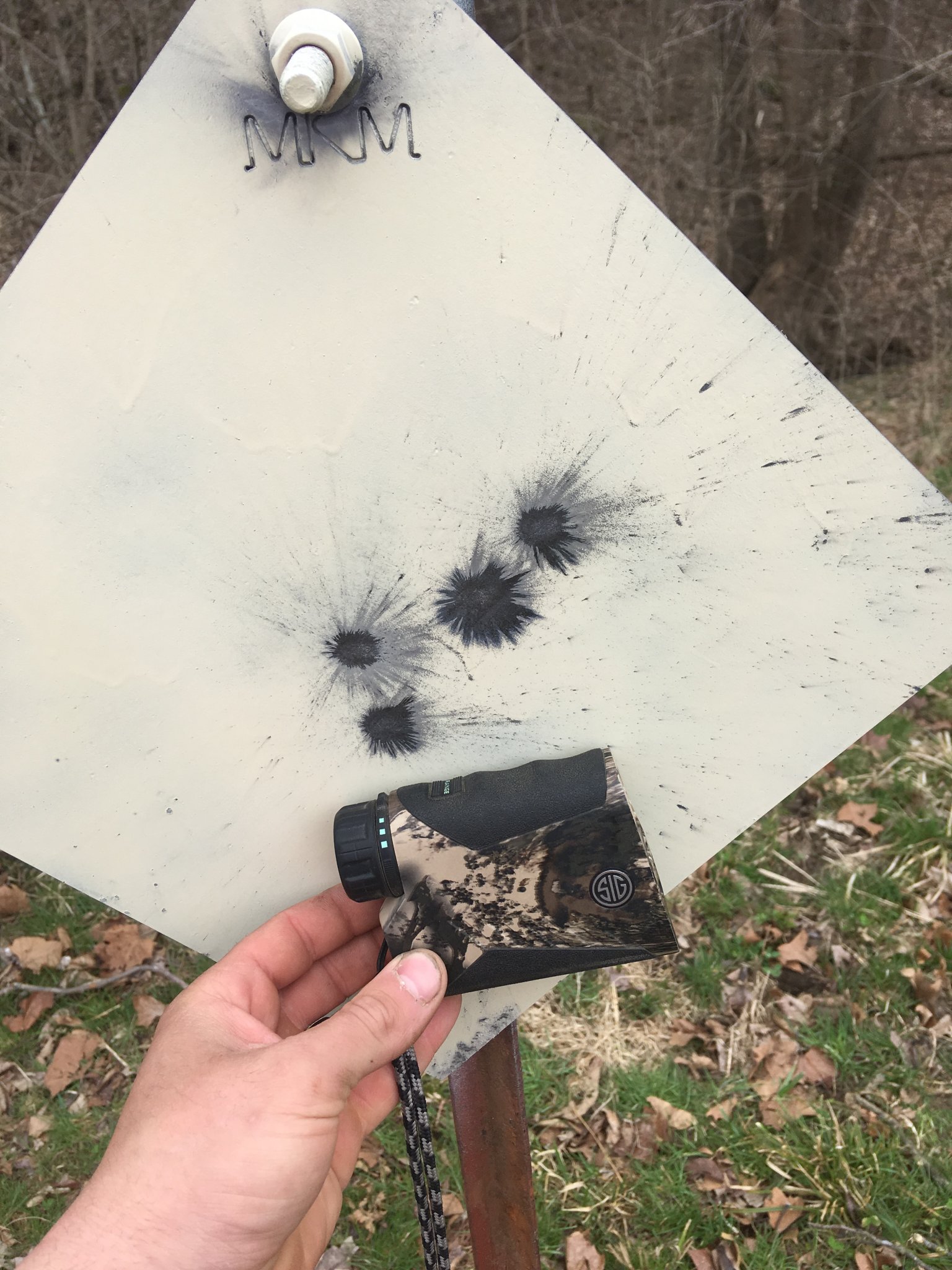

Now for the pay off!!! Got time to set up a 12”x12” plate at 600yrds. Very nice day, had a 3-4mph 3:00wind, wind really didn’t affect it too much really.
7049092

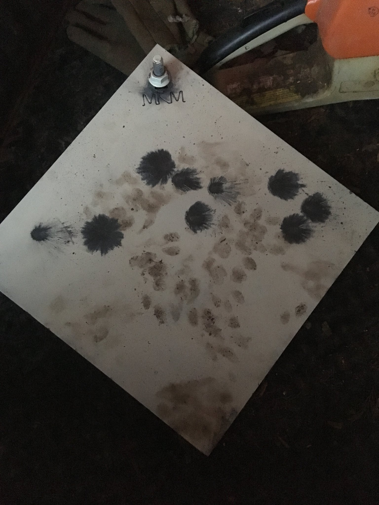

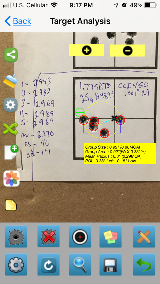

I missed the first shot, adjusted and bingo!!! Top and the below was the 25g H4895 .001NT 1.775bto cci450
7049094
This is the 25g H4895 .001NT 1.765bto cci450!!! I was pretty pumped and I’m not sure what happened to the 5th shot, maybe me maybe mirage....not sure but still fucking awesome!!

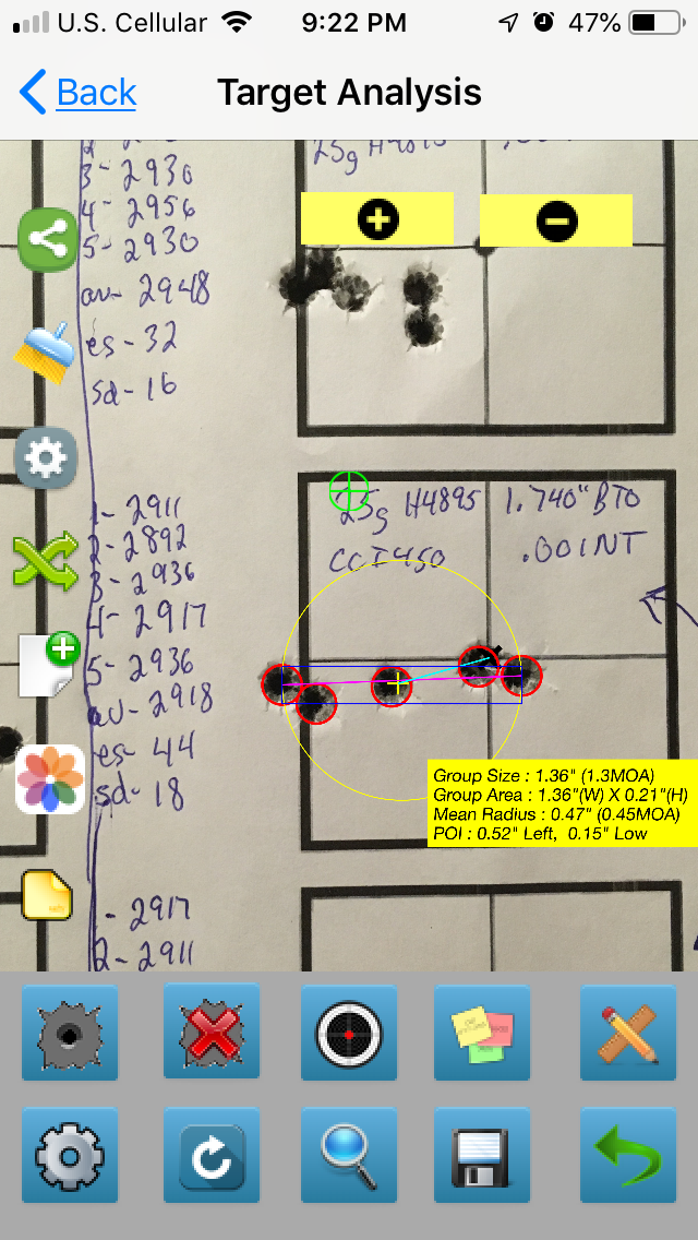

25g H4895 .002NT 1.740. First shot miss and connected with the next 9....buy now I’m surprised I hit the plate!! Not sure if it was me or if that’s how it actually grouped.
This was almost too easy!!
Remage bolt gun, criterion 1-6.5” twist 24” lt varmint contour, pillar bedded and detachable magazine done by me, ss12x42, 20moa seekins rail.
